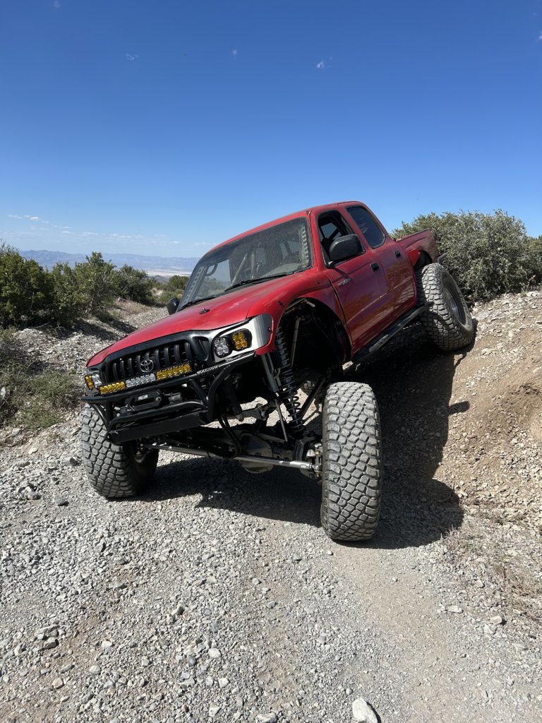

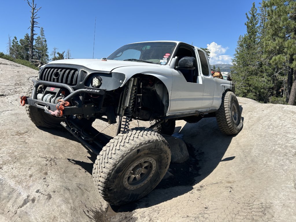

    My current truck is the white one (build thread on here) and I finished the red 4door not long ago for a buddy. Both solid axle with the intents to go fast. Bypasses. Coilovers. Lots of uptravel etc. IMG_6500.jpg IMG_5569.jpg

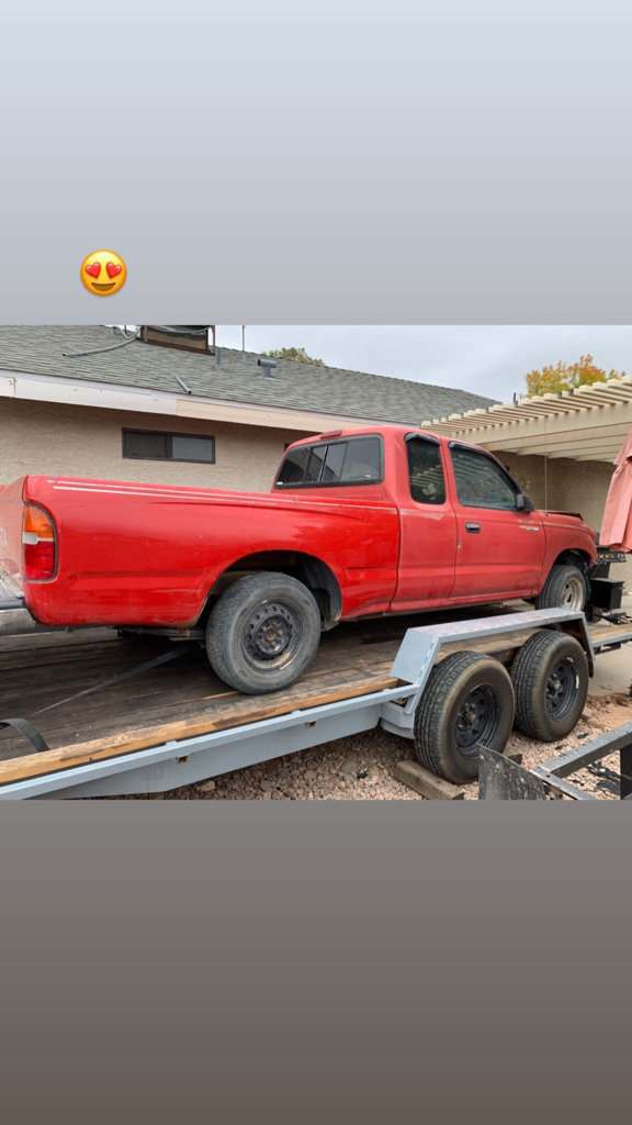

    Day I hauled it home BEC47FD0-10EB-46C2-97F8-5CDFB0388BCA.jpg 42CD32E0-1FAA-4CBF-9BBC-54B29510D605.jpg

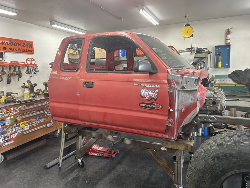

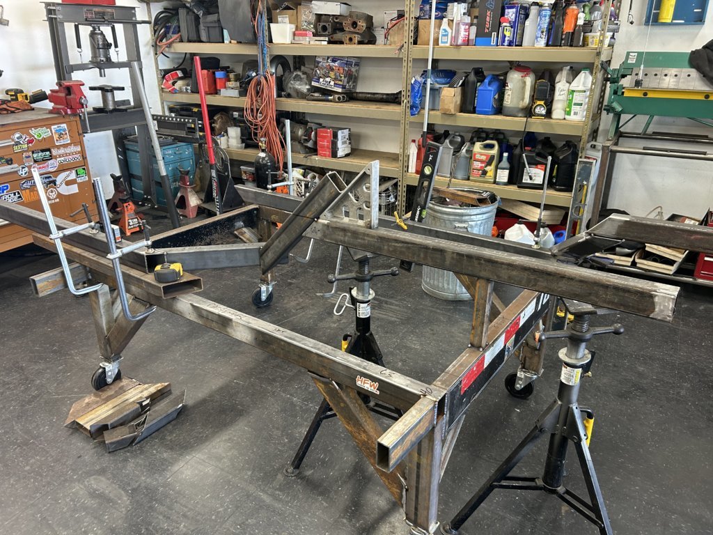

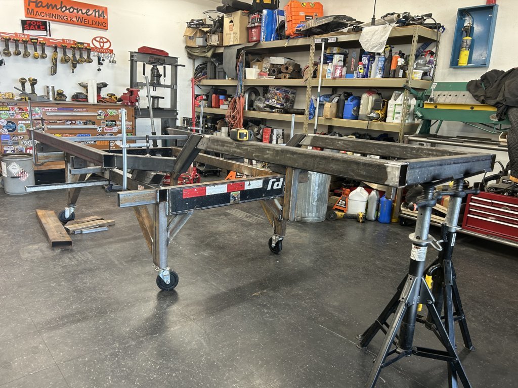

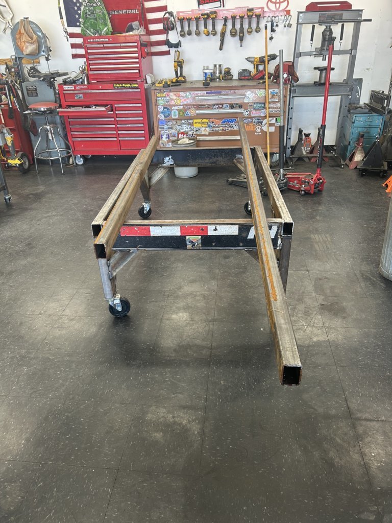

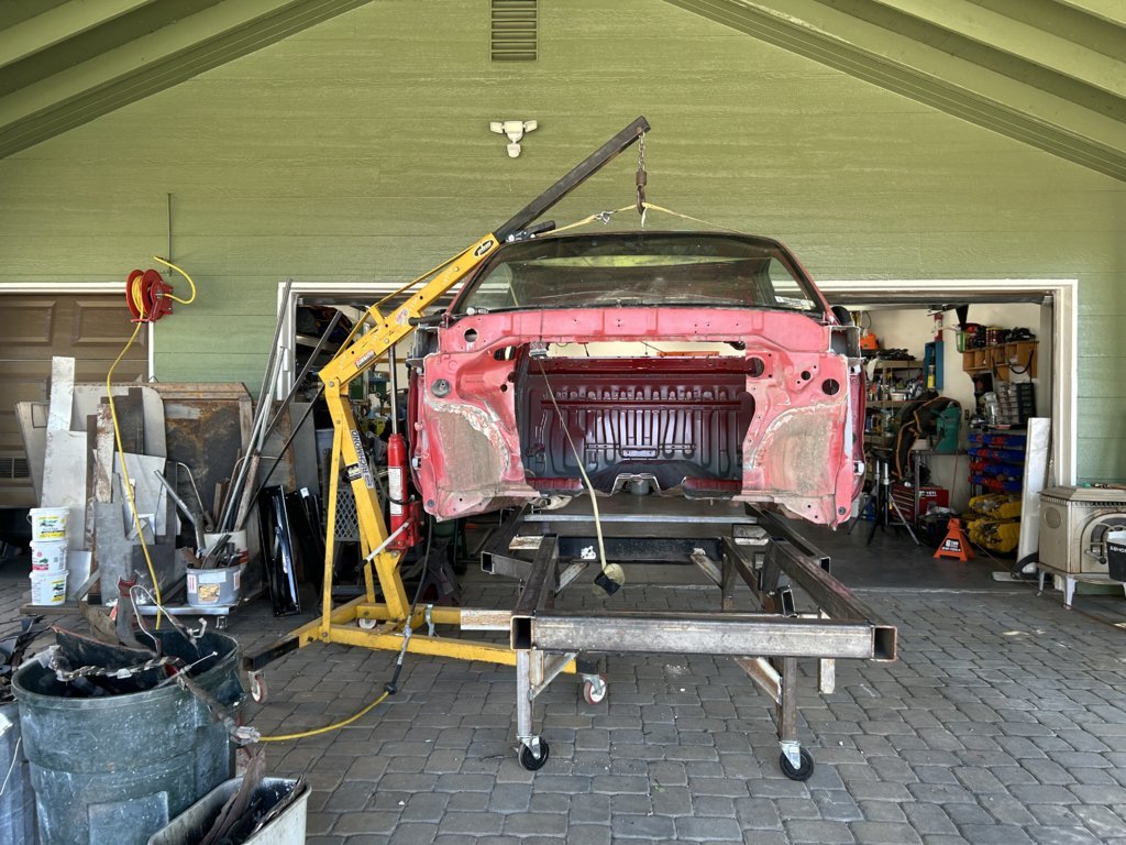

    I quickly stripped the interior and trans (motor was missing) after I got it (December 2021) We moved to our new house early the next year and it sat till the following winter when I pulled the cab and started a cage. It got pushed back outside onto the frame when the red double cab project came up and I started on the new frame middle of August 2024.
    the frame looks odd but will make sense later

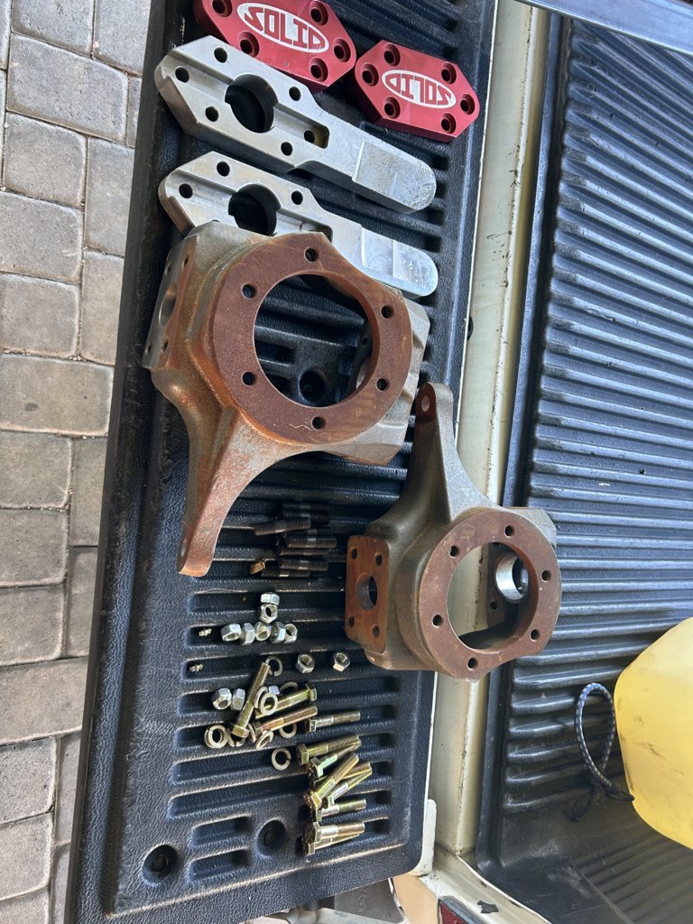

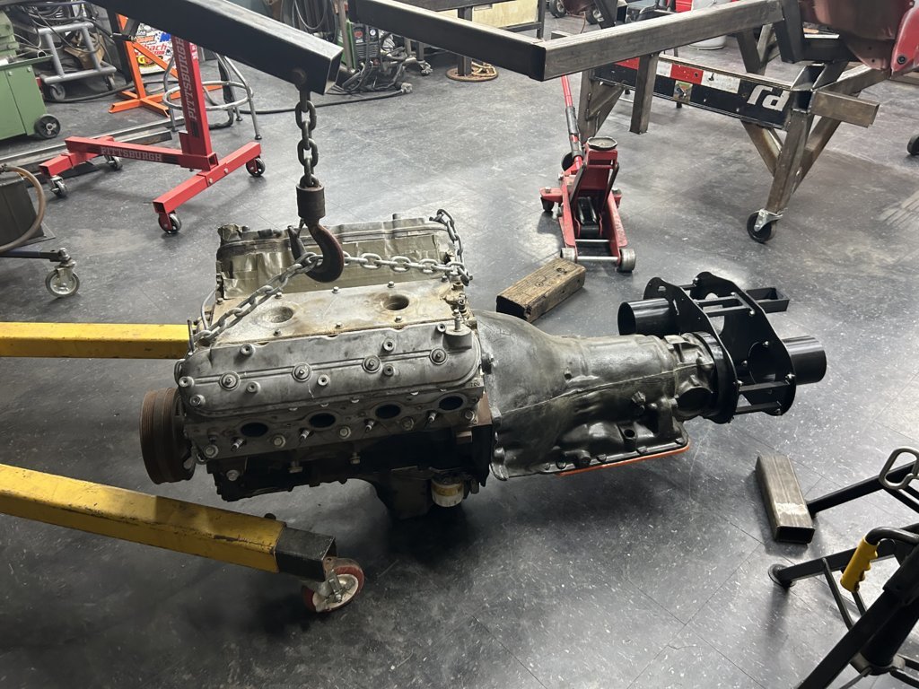

    I slowly collected parts. Picked up two stock 5.3s that needed some work from one of the sketchiest marketplace deals I’ve ever done. A cam, new lifters, a gasket kit and more for the motor, a core of a th350, a foam th350, 3D printed atlas, knuckles and a bunch of other stuff. IMG_6823.jpg

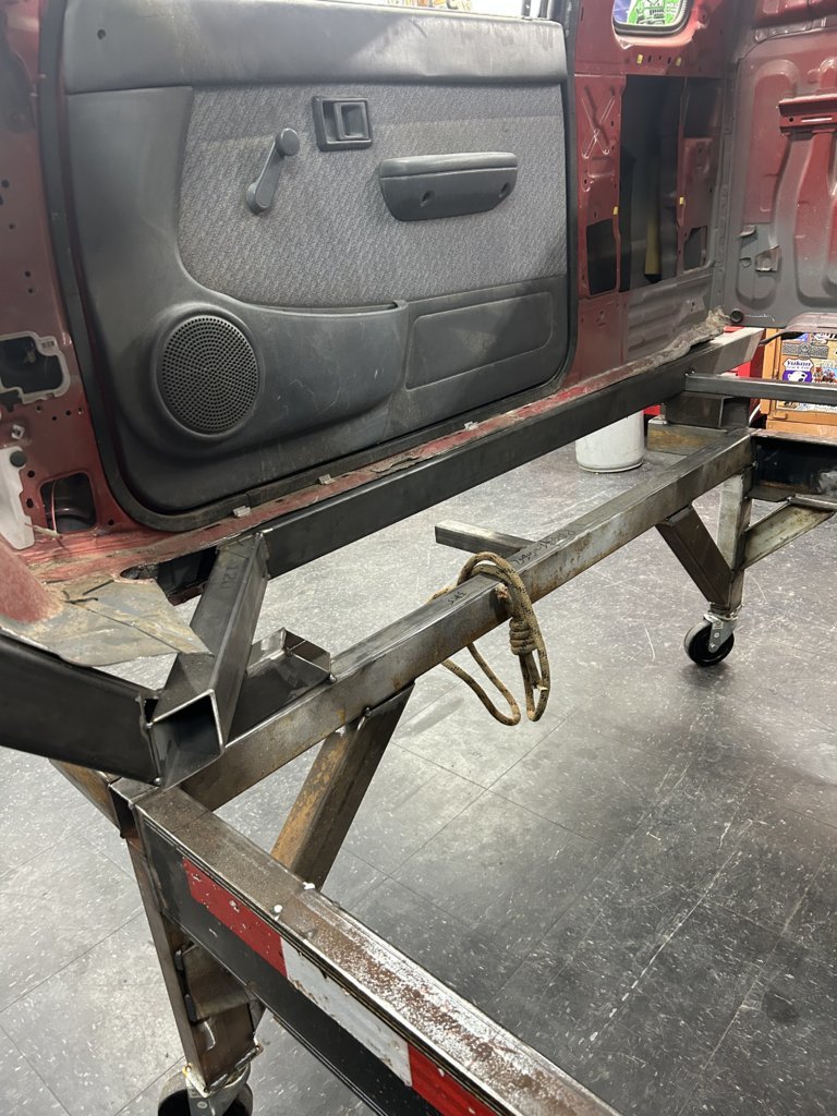

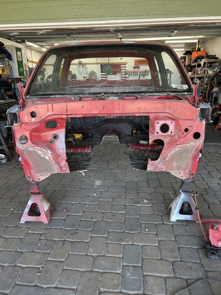

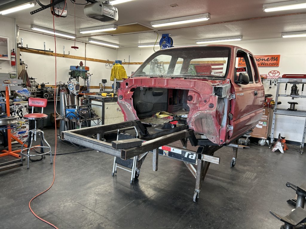

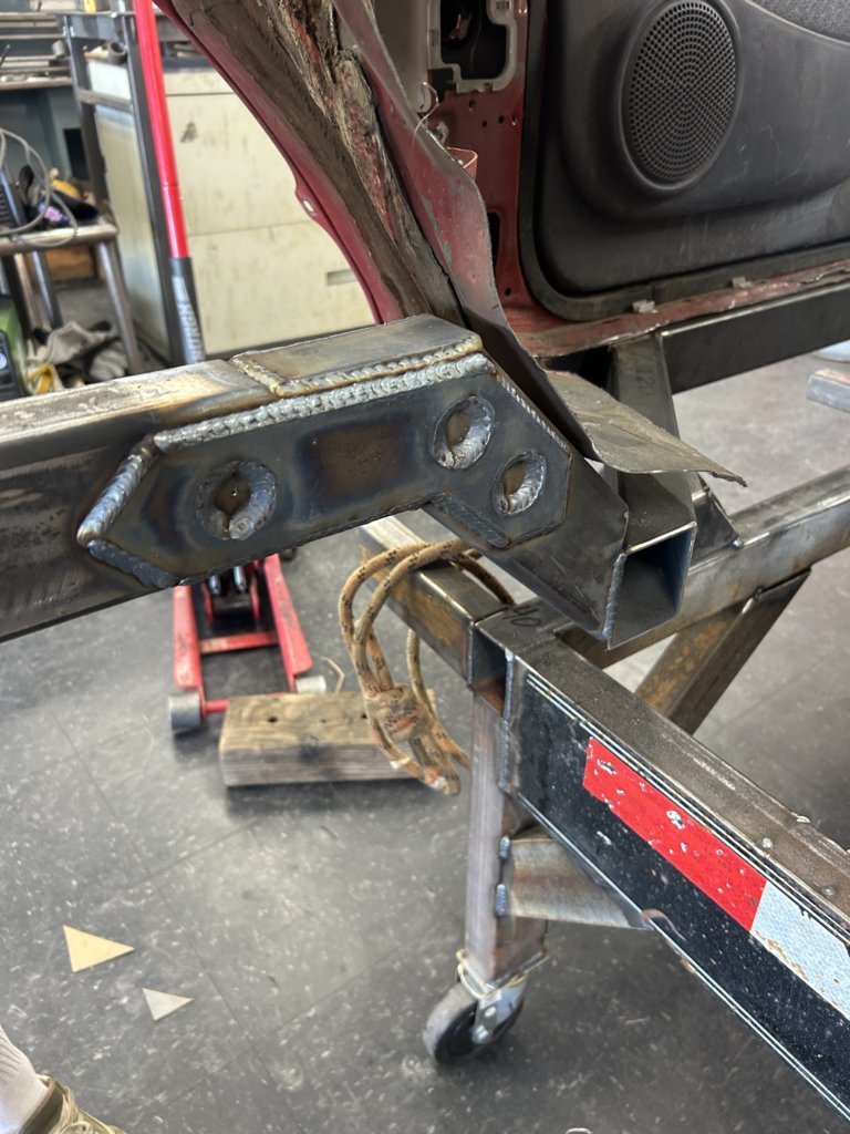

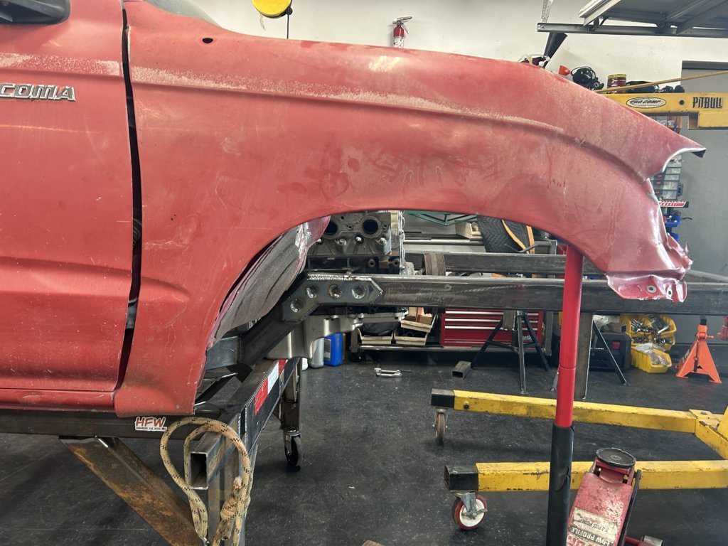

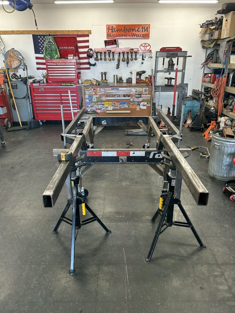

    I then got to cutting. The plan is just a Tacoma shell on a “chassis” essentially. The floor is cut out and a subframe will be made. The front section of frame rail are 2x3x.188 and the section under the body is 2x3x.120 wall. Most the cage will be 2 in dom wirh 1.75 dom gussets .
    I started small but things escalated quickly

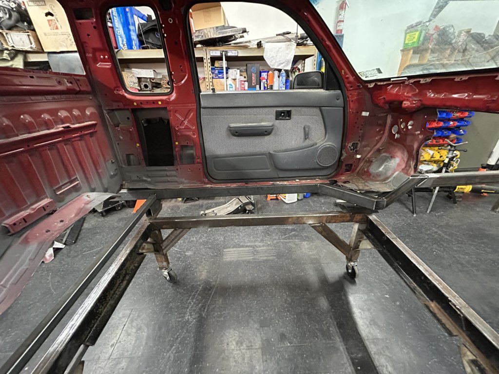

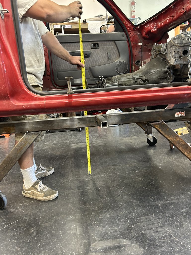

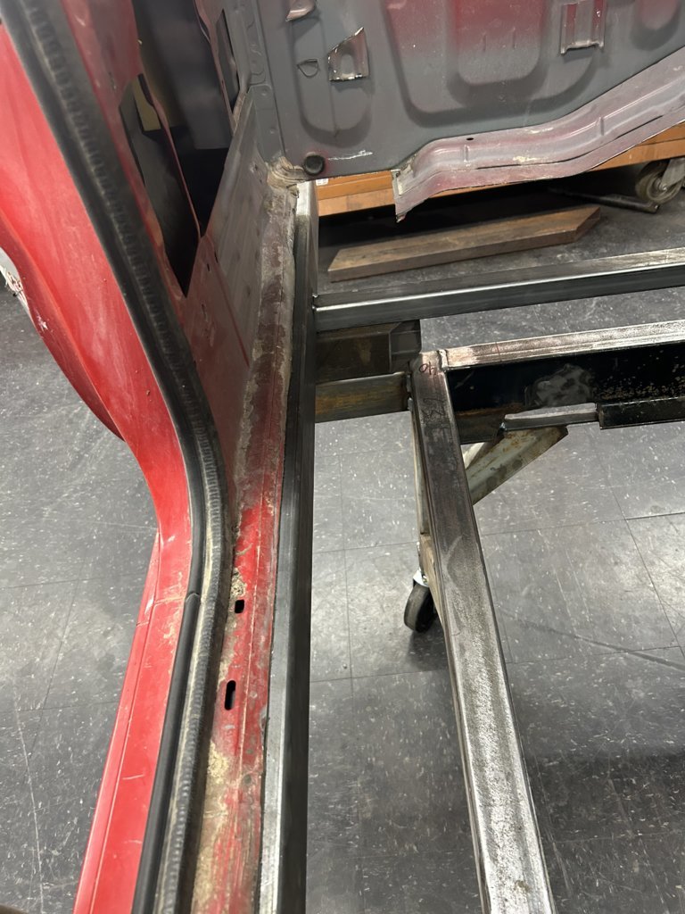

    The frame rail sits just inside the body seam under the door. So I cut all that out to get the body sitting how I wanted IMG_6895.jpg IMG_6896.jpg IMG_6897.jpg

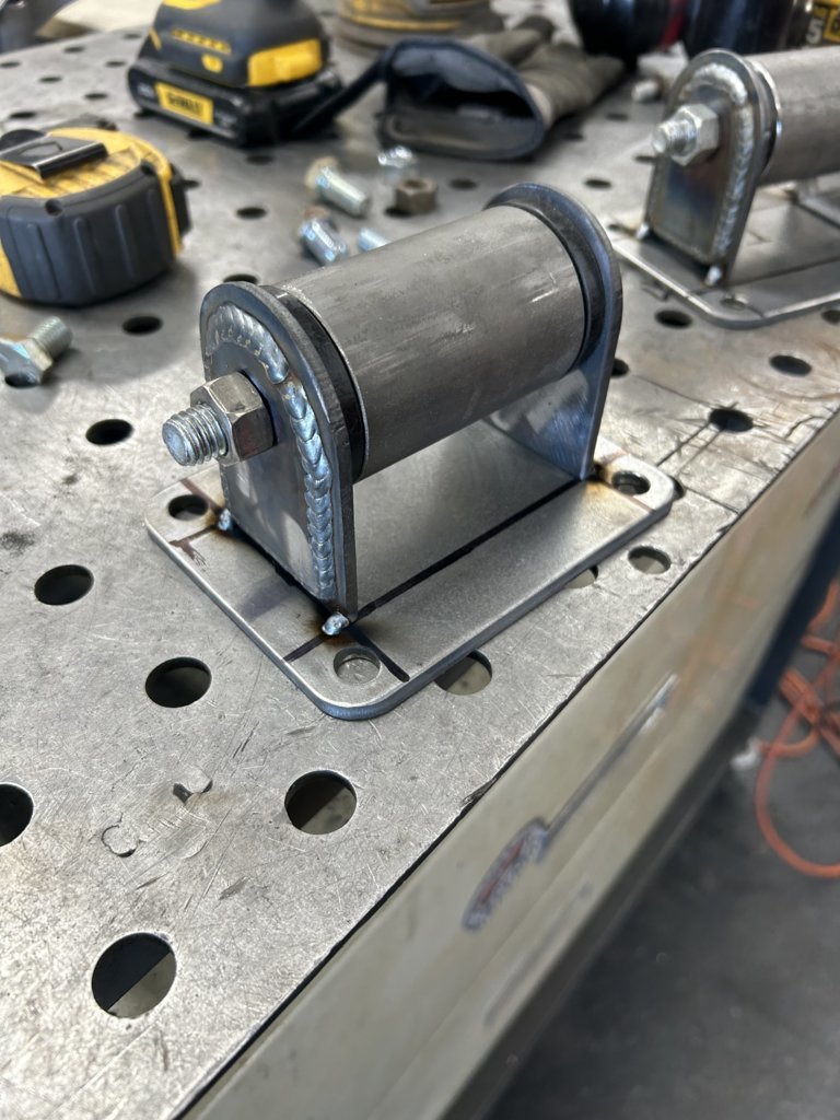

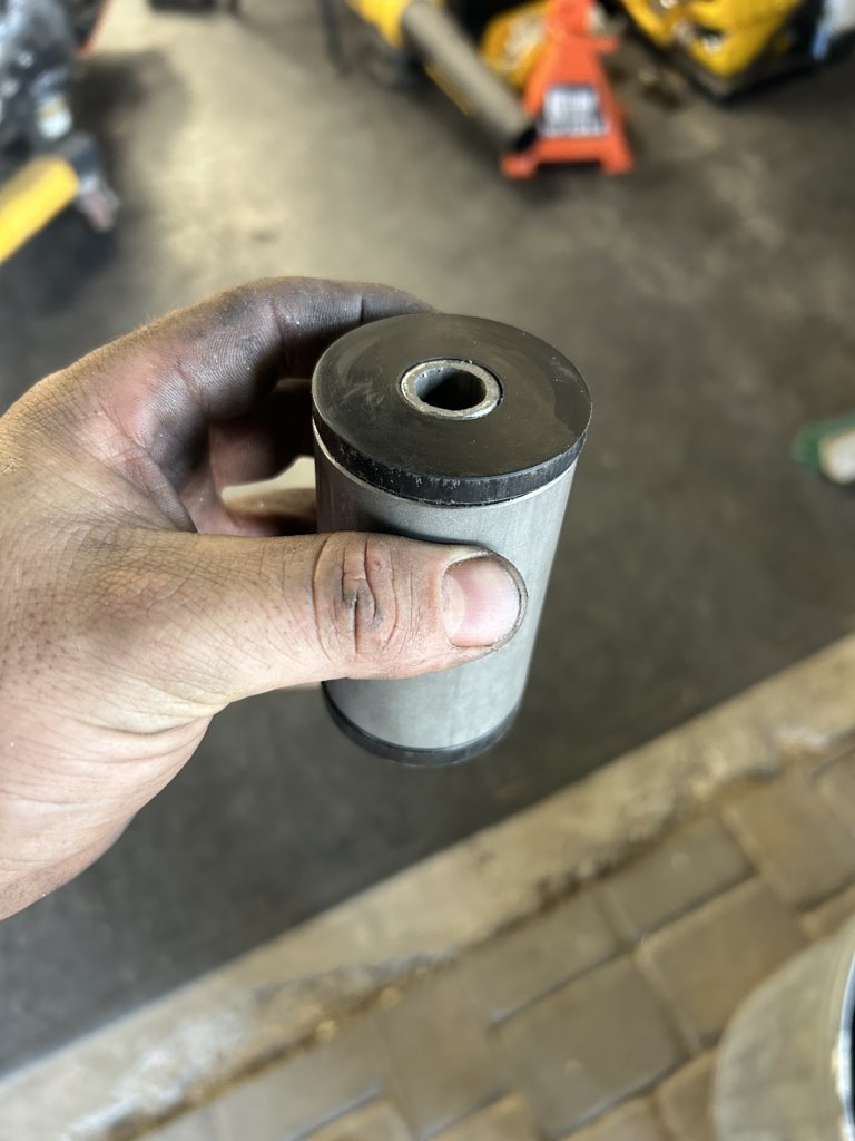

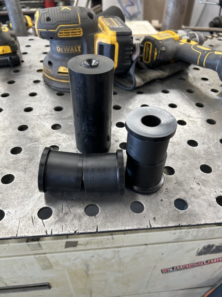

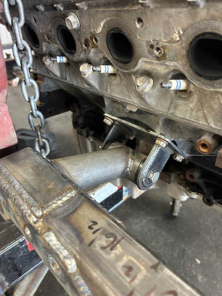

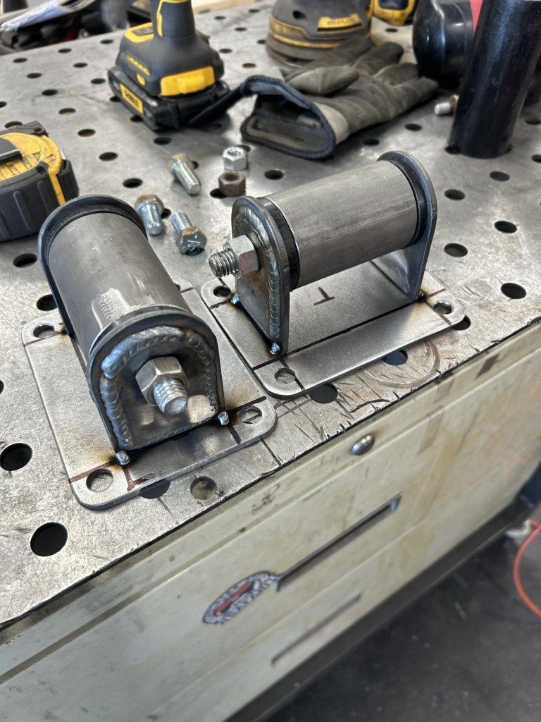

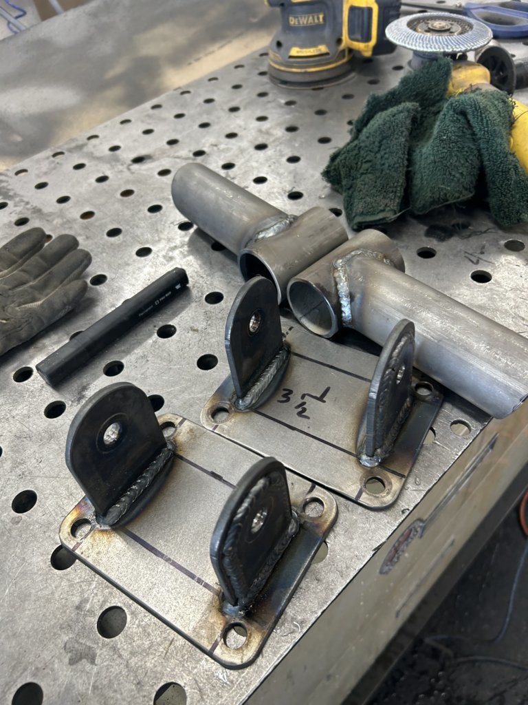

    And then made some motor mounts. Turned the bushings down from delrin and sleeved with 3/4 dom for a half in bolt. Most things will be cut out of 3/16 and then plated with 1/8 for strength. I find working with 3/16 is easier over 1/4 and my cnc plasma table cuts 3/16 way better.

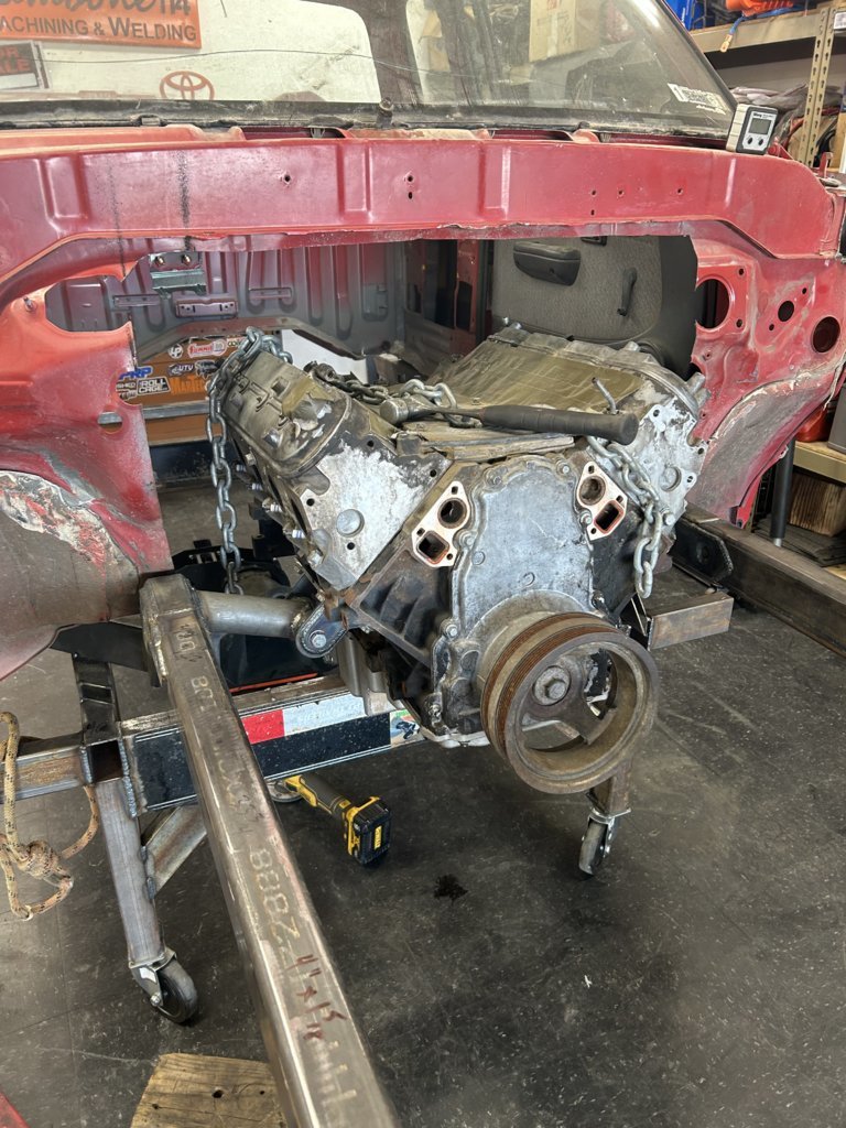

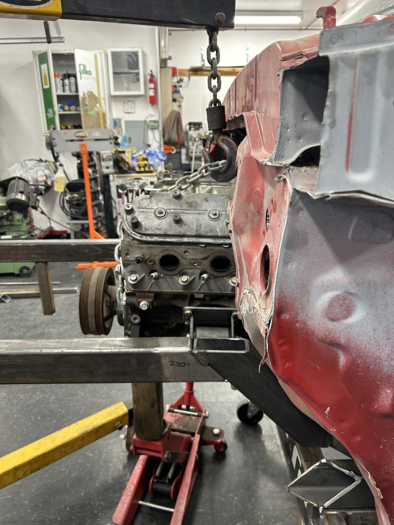

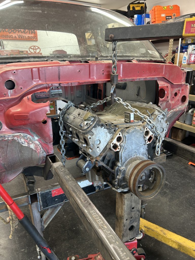

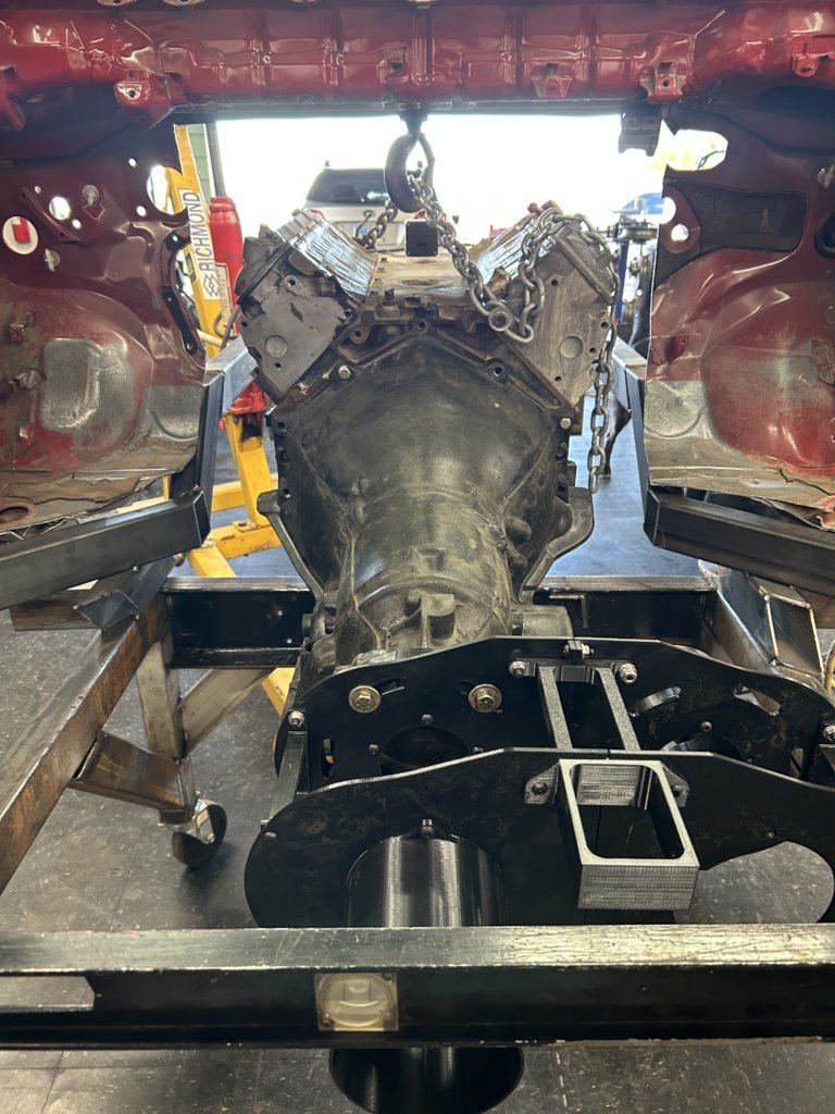

    And that brings us about up to date. I’ll try to find pictures of the rest of the parts I’ve acquired but I still have lots left to buy/find and make. Goal is to make koh 2026
    this is pre Labor Day weekend. I got the motor where I’m happy and about to start making the motor mount tubes. IMG_6937.jpg IMG_6927.jpg IMG_6933.jpg IMG_6939.jpg IMG_6929.jpg

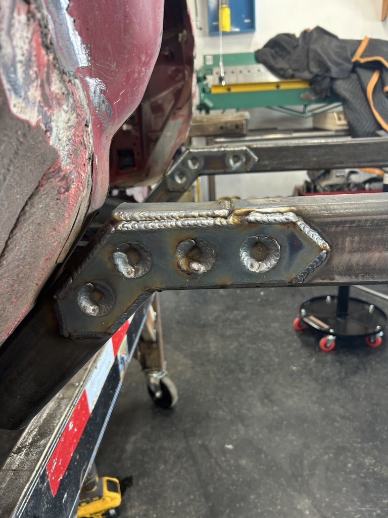

    Needed to get the frame strong enough to support the motor to start working on everything else. So got it welded and the top section plated and the motor mounts in and welded. I don’t normally like to fully weld anything till I’m done but I need all this strong enough to support everything without crushing me. If I need to move it later, I’ll just embrace the suck and go to town with the grinder. I also started to try and figure out how I want to do the subframe and link mounts. IMG_6963.jpg IMG_6965.jpg IMG_6967.jpg IMG_6973.jpg IMG_6974.jpg IMG_6978.jpg IMG_6977.jpg

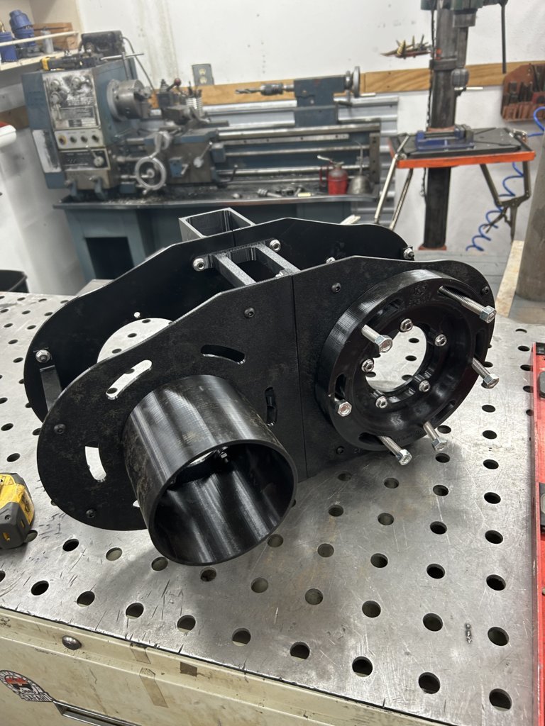

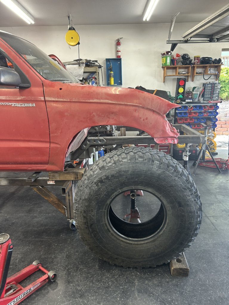

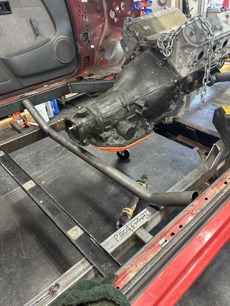

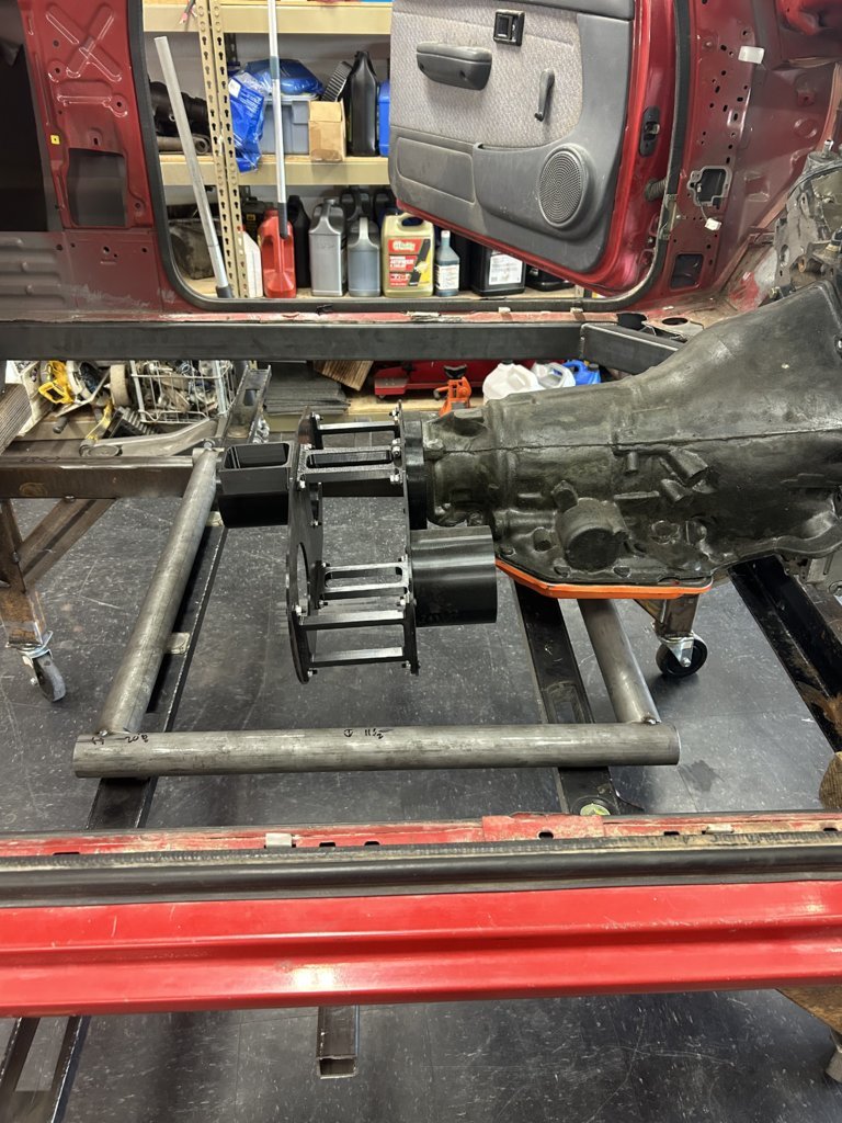

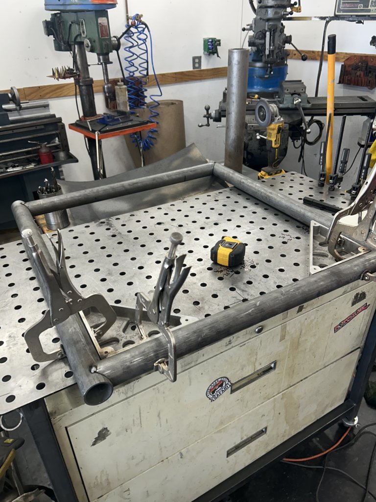

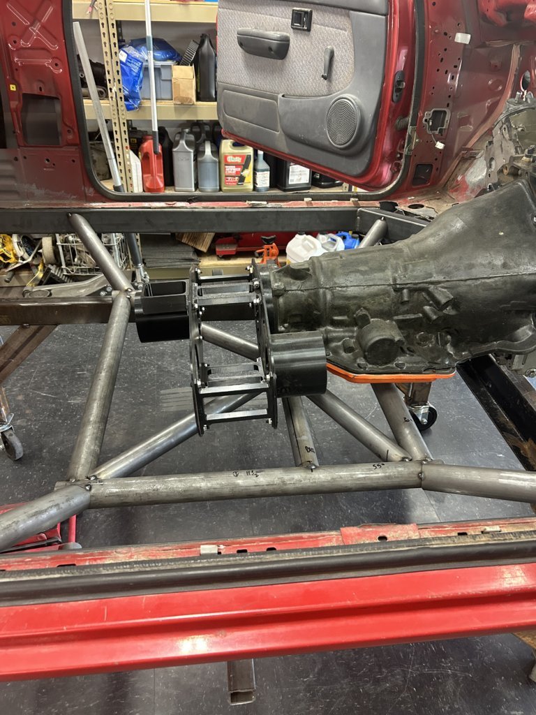

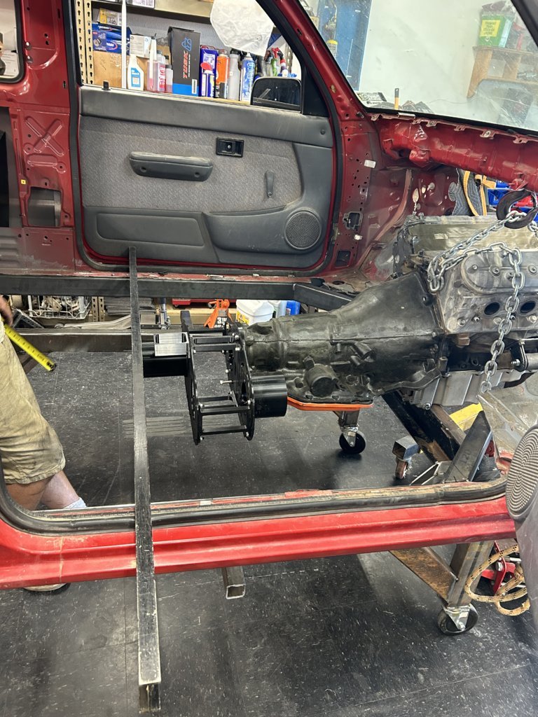

    More cutting. Got most the upper cab trimmed for the cage. Started on the subframe to get the trans mounted. Housing should be here tomorrow along with heims to start laying out the links. Subframe will weld to the 2x3 frame and it all lands in line where the cab cage will be so should be plenty strong and all the cage/subframe will be supported by each other

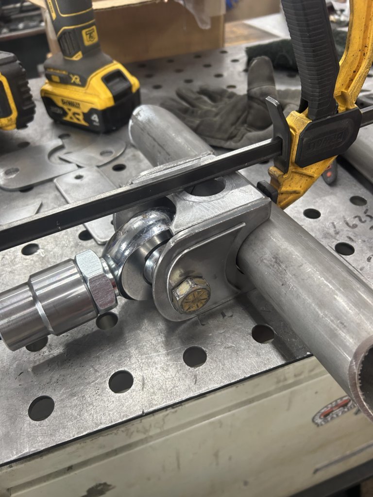

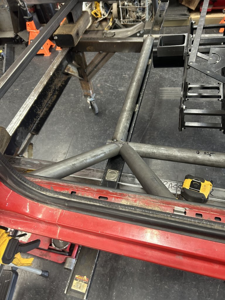

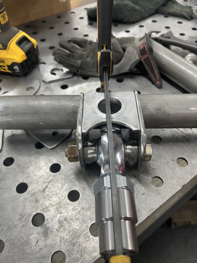

    More work on the subframe. Heims showed up and housing should be here Monday. Poly performance has been helping me out big time so make sure to hit them up for any part needs. IMG_7021.jpg IMG_7022.jpg IMG_7024.jpg
    I need to redraw and cut the overlay and extend the top plate for the lower link mounts and I think I’ll be happy with them.

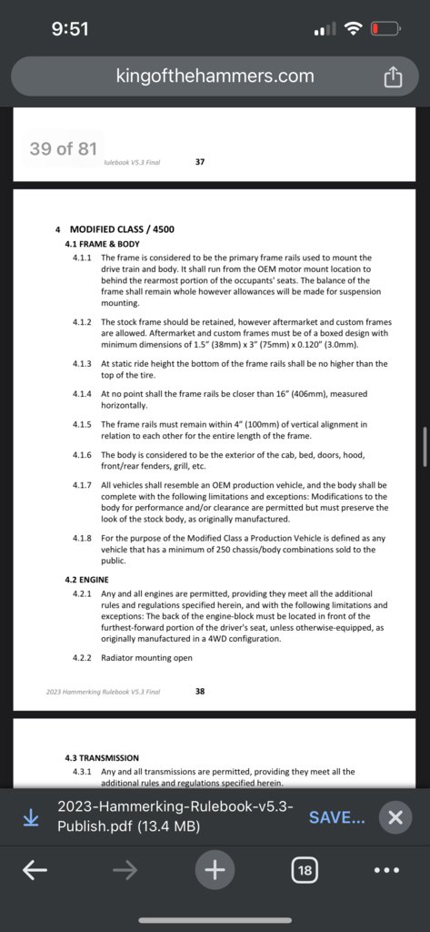

    Innocent question;
    I know 4500 is front mount engine, is there any rules on set back?
    malburg114[OP] likes this.
  19. Sep 6, 2024 at 9:52 PM
    #19
    malburg114
    malburg114 [OP] Well-Known Member
    Dec 26, 2012
    #93766
    3,816
    Las Vegas, NV
    2001 Toyota Tacoma TRD
    Rules are pretty lose. Just has to be in front of the driver seat essentially. Mine will still probably be more “factory” than a lot in the class considering there’s full jimmys chassis and tube buggies that just have a square frame rail under the “cab”
