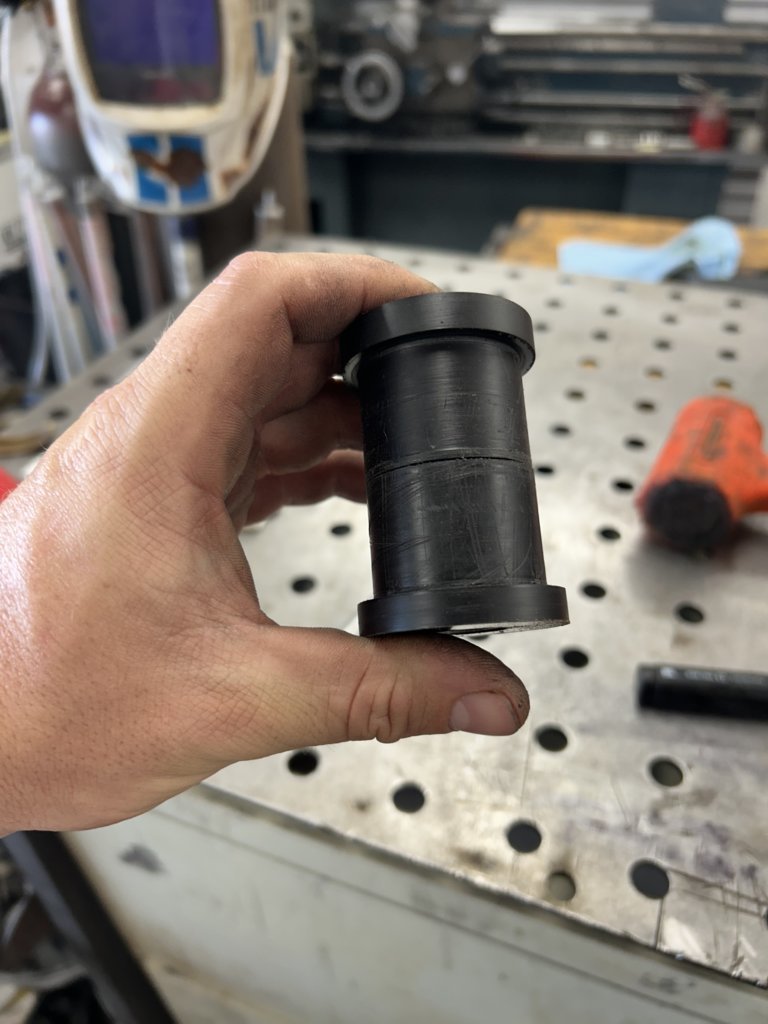

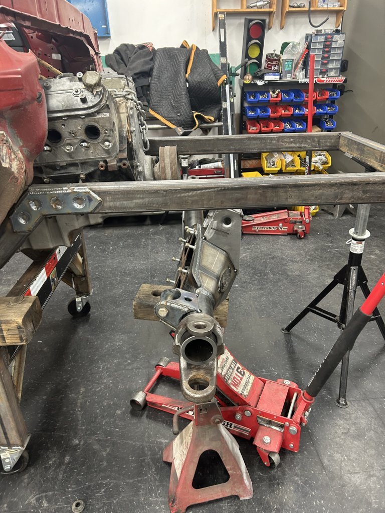

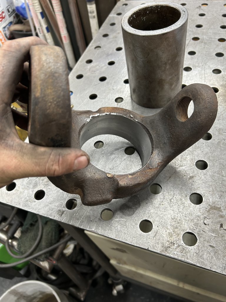

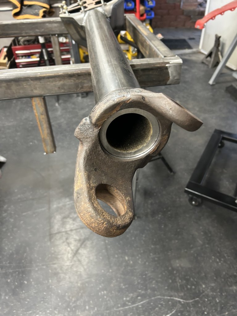

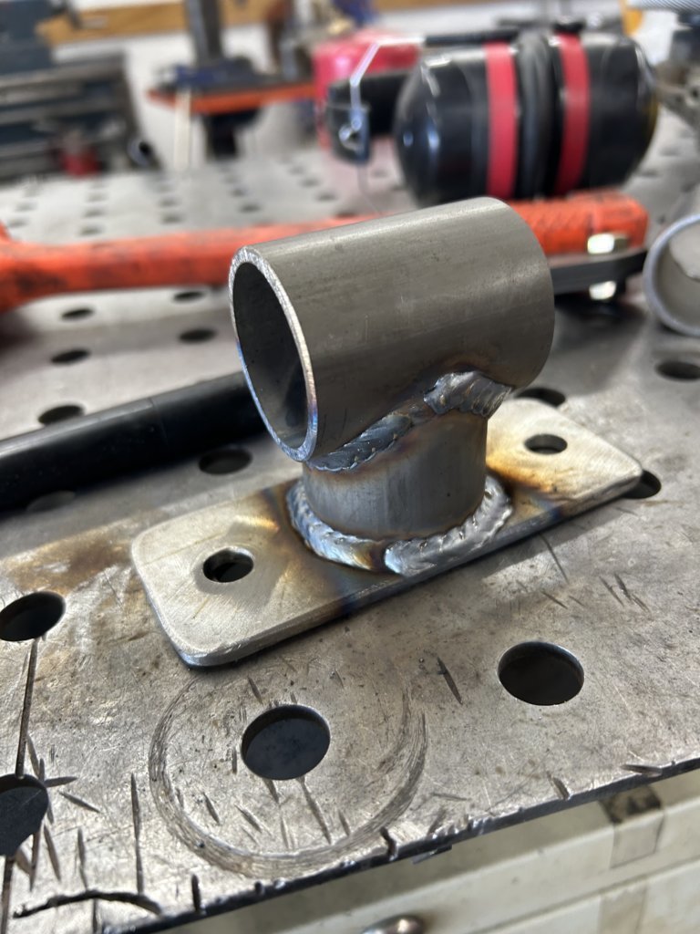

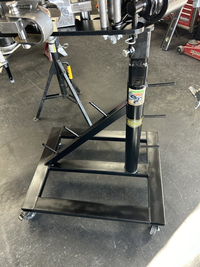

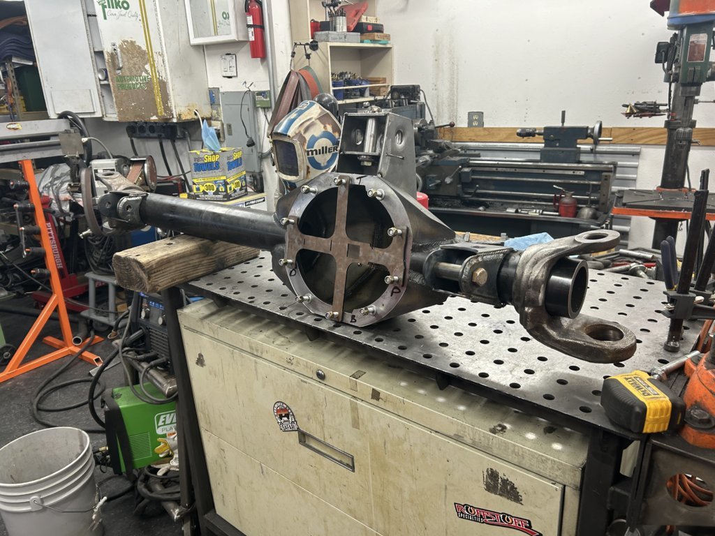

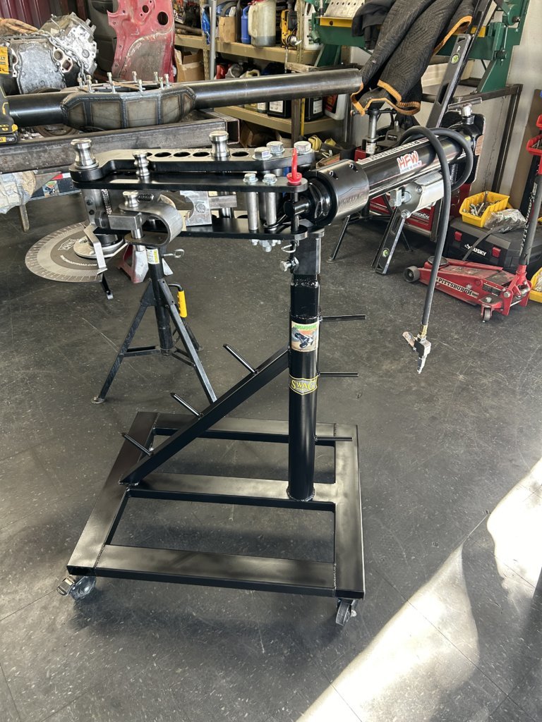

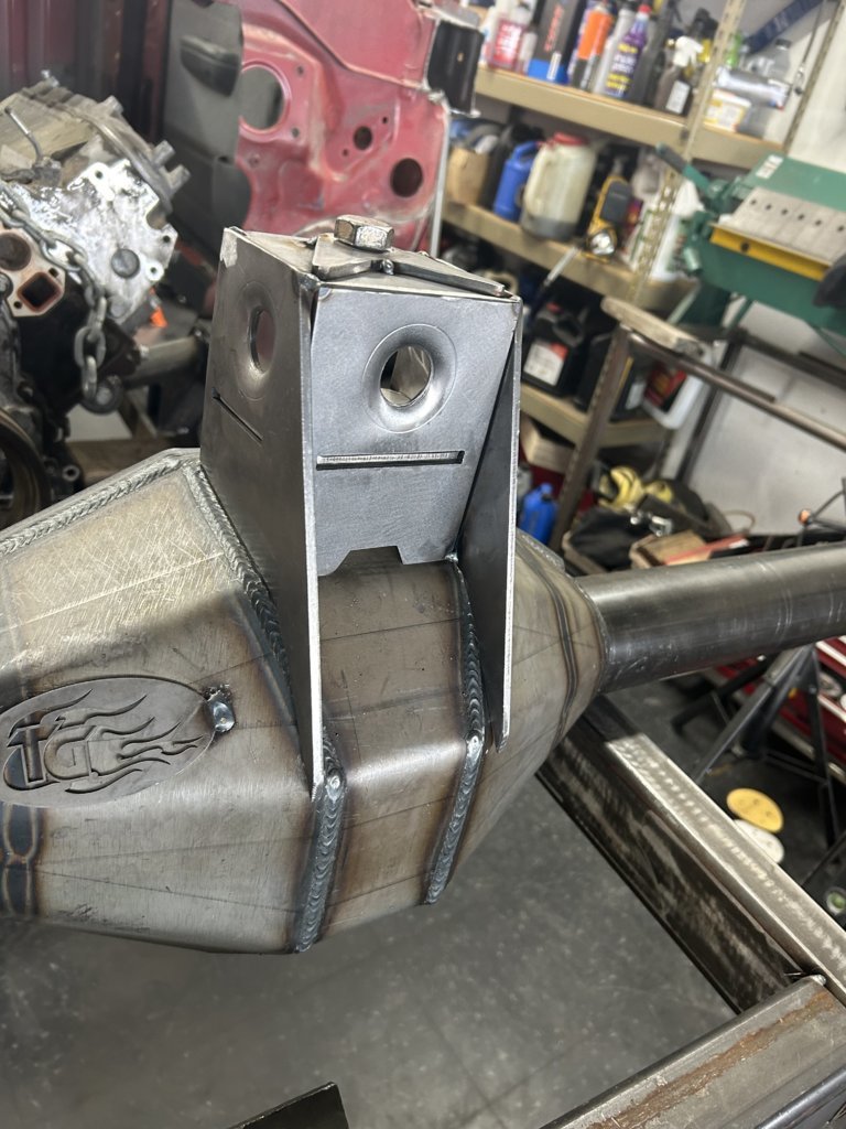

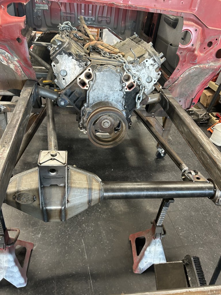

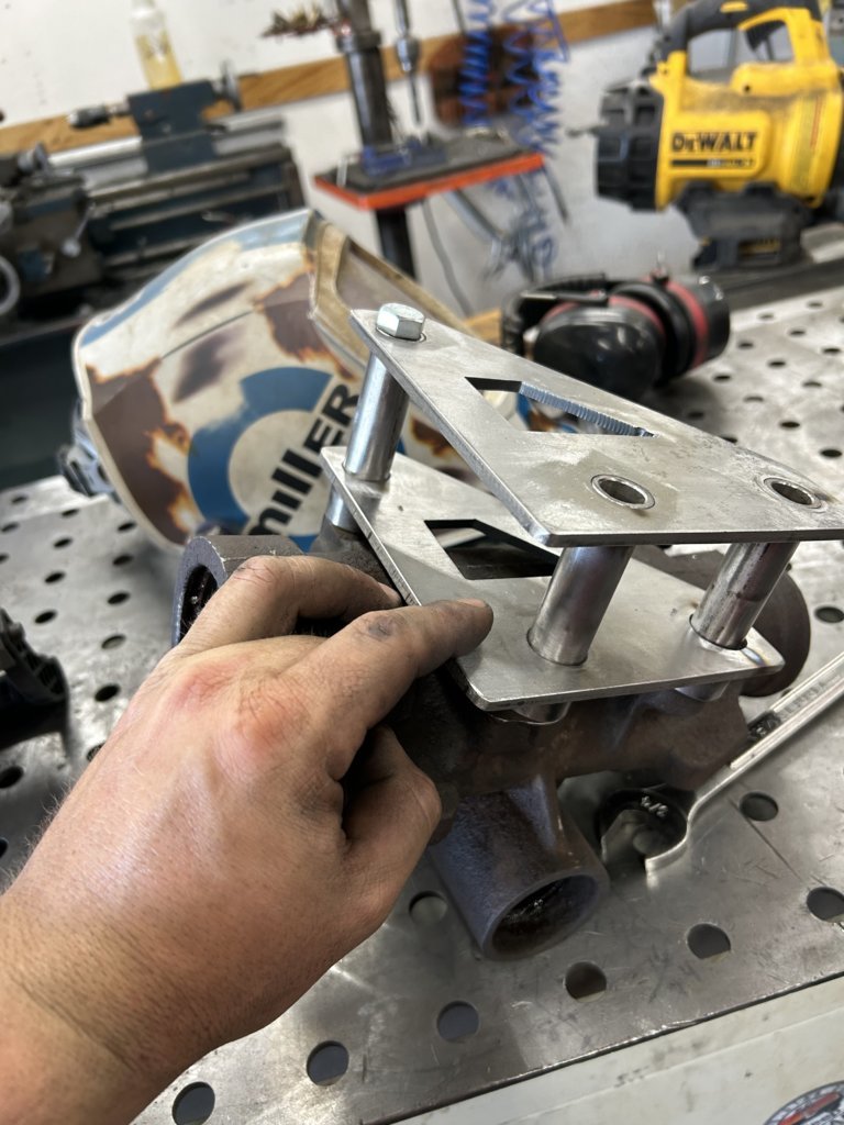

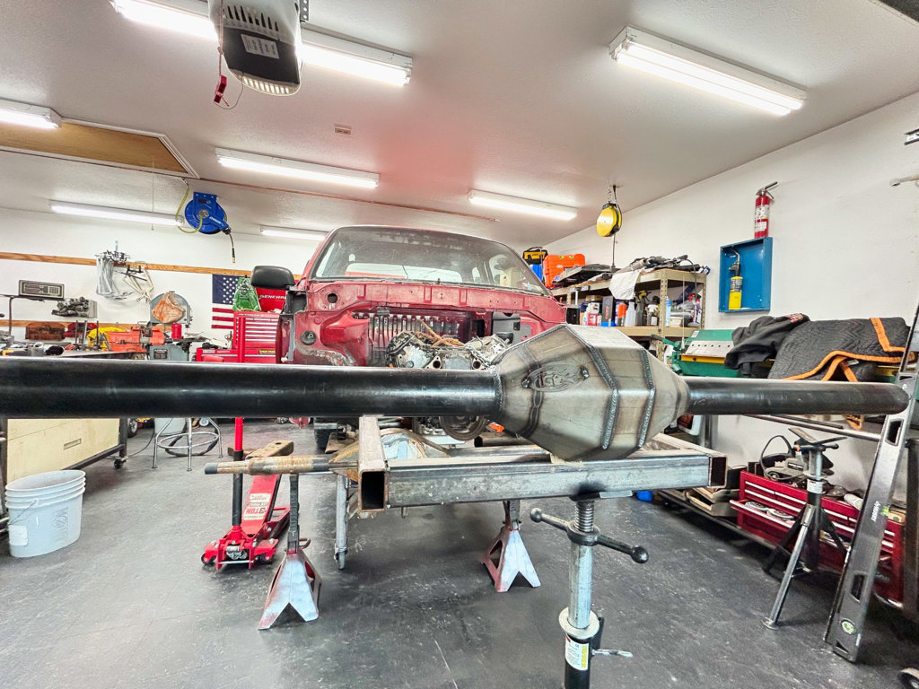

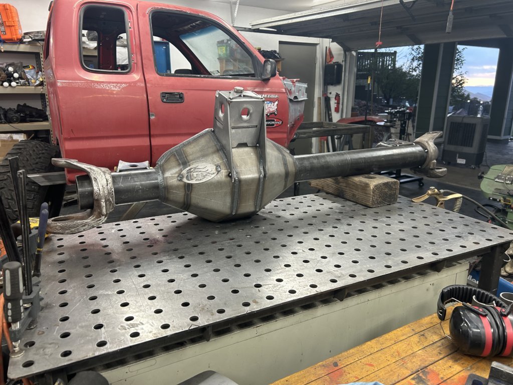

    New swag tube bender showed up. Last bender didn’t like going 2 in dom so had to upgrade.
    and got the cs turned down to fit the housing

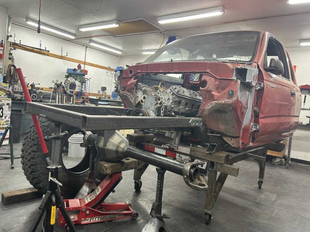

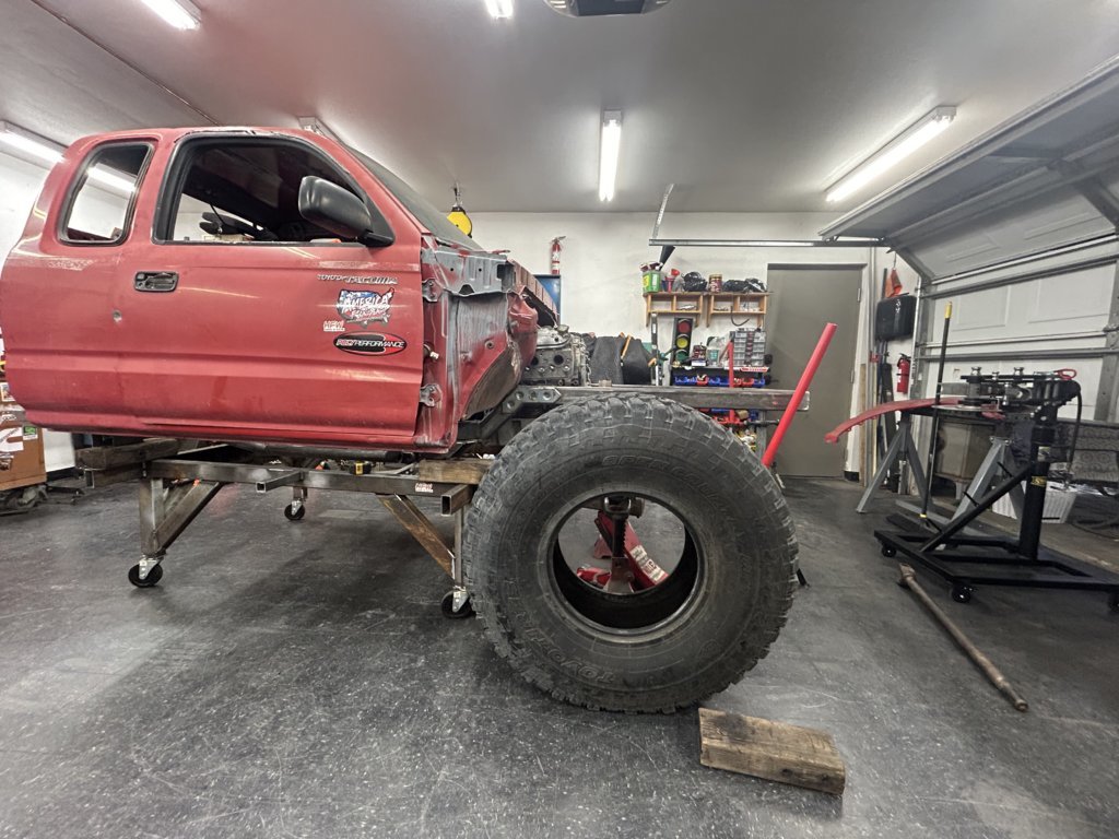

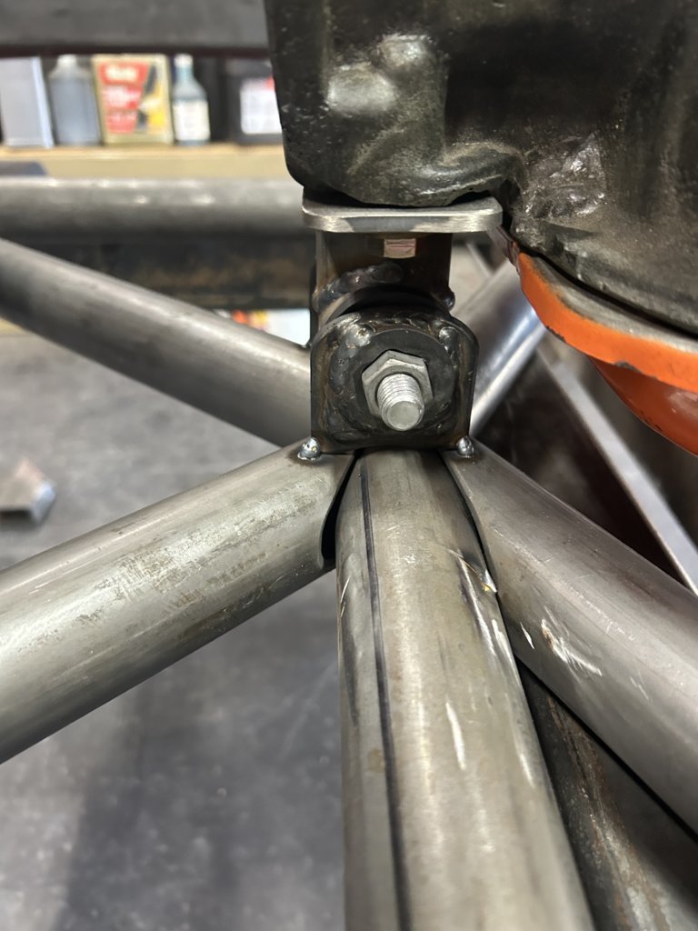

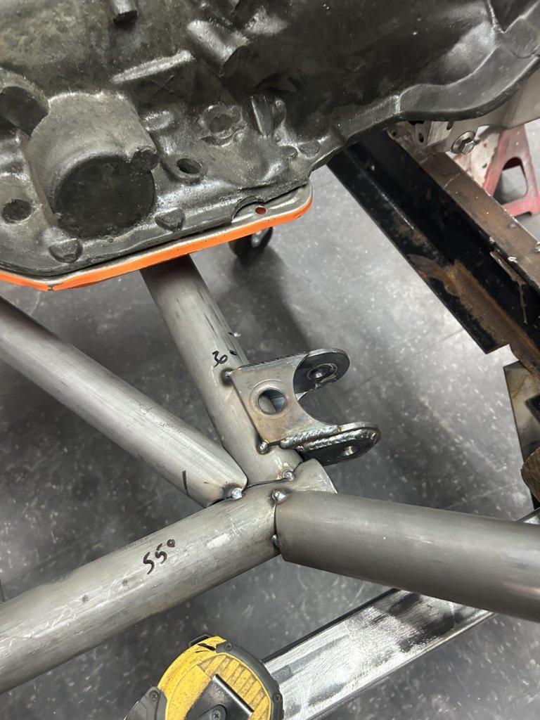

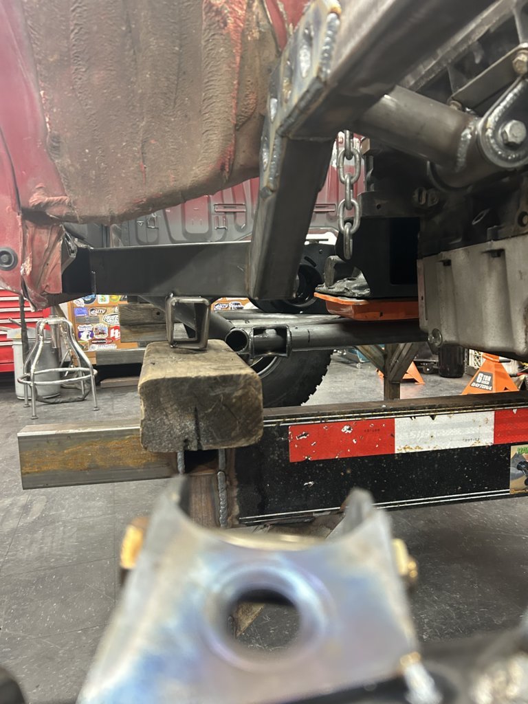

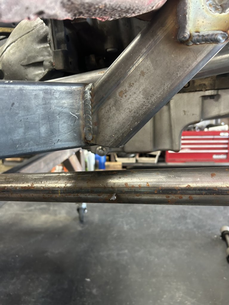

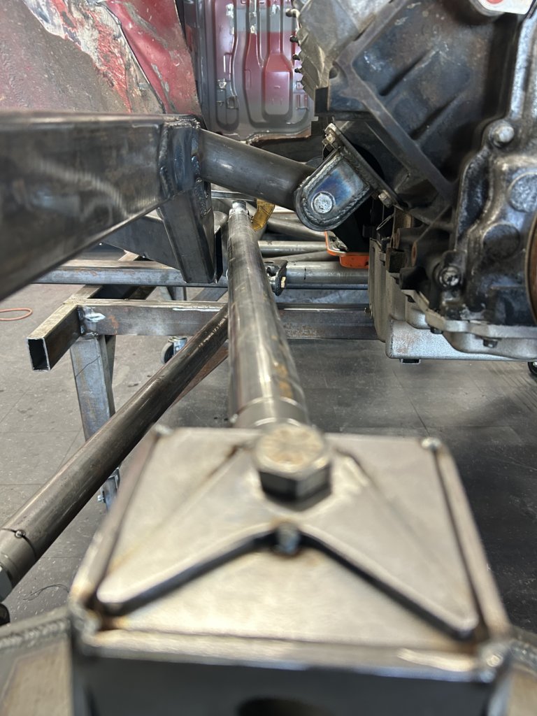

    Got the trans mount done. Not sure how I feel about the tabs after seeing it in pictures.
    And then got the frame side link mounts cut and welded. Will get the axle end lower link mounts and upper link mount cut and welded tomorrow to hopefully get on the axleIMG_7124.jpg IMG_7126.jpg IMG_7130.jpg IMG_7131.jpg IMG_7132.jpg IMG_7134.jpg IMG_7135.jpg IMG_7133.jpg

    It's less Tacoma and more mod
    Trans mount tabs look good to me, those don't see a huge load anyway.
    sparkystaco likes this.

    I’ll probably just box them. Half people say it looks good. Other half says it looks funky. I’m kind of in the middle. No real reason to bend them other than I didn’t want the tabs landing in the center of the node for no real reason.

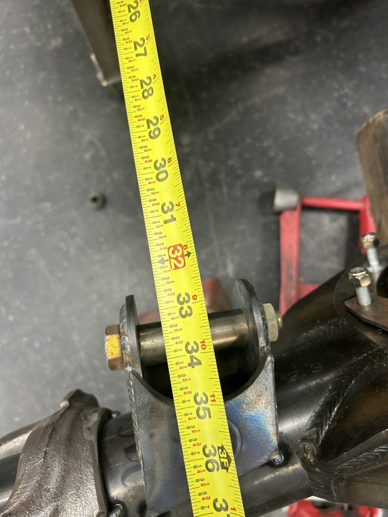

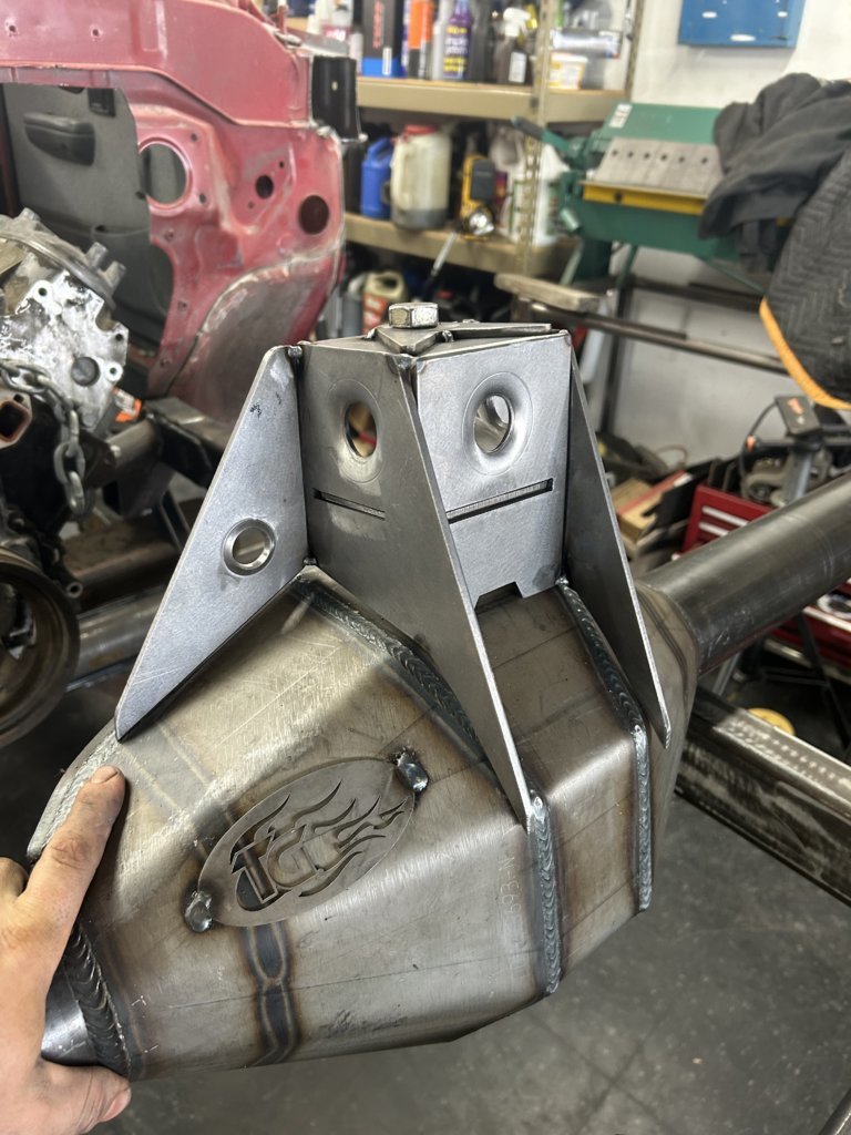

    Cut a big pile of tabs today and got the axle side lower link tabs welded and got the axle side upper link tacd together. Ended up cutting the housing down but left it about an 1.5 long till I get hubs to measure exactly what it needs cut down too. I put the cs where I think they will end up and got the link mounts tacd to the frame and axle. Pretty happy with everything so far. Front links are looking like 33.5. I was wanting 36 ish so I’ll probably push the axle the 2.5 inches forward to where I want it.F70D63D1-9929-4AB7-AA35-BEF530EB2F7B.jpg IMG_7138.jpg IMG_7139.jpg IMG_7142.jpg IMG_7145.jpg IMG_7148.jpg IMG_7150.jpg IMG_7151.jpg

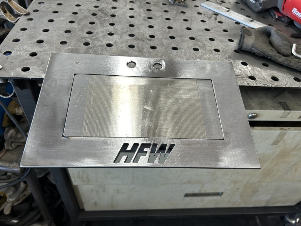

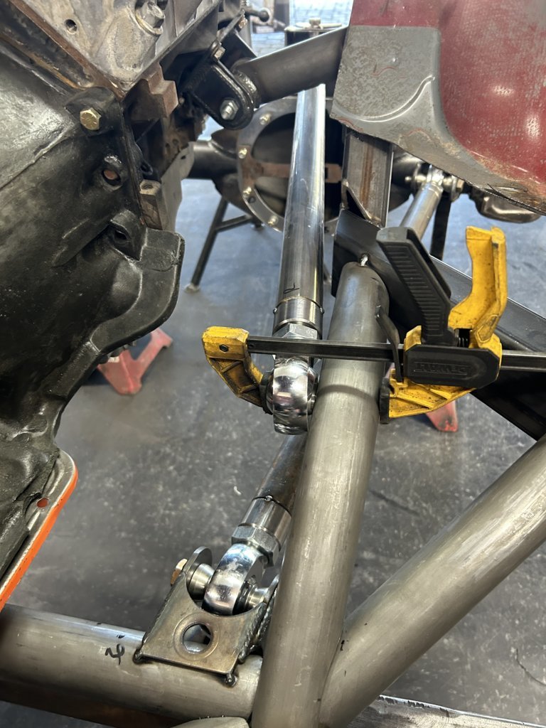

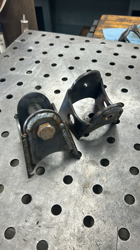

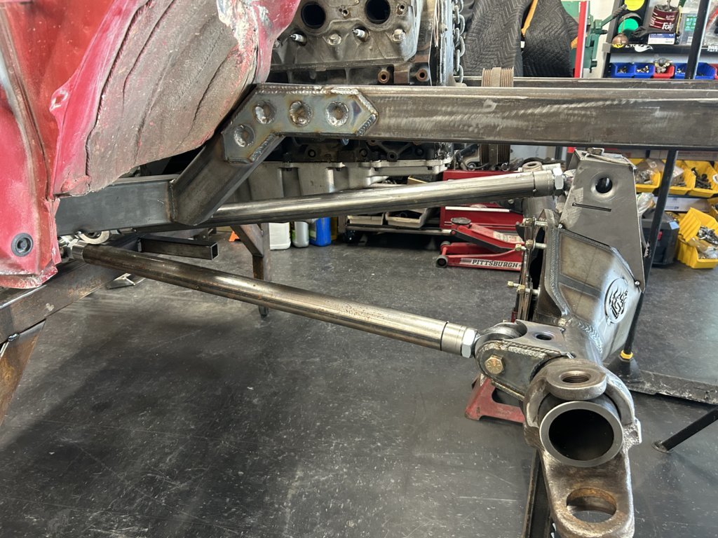

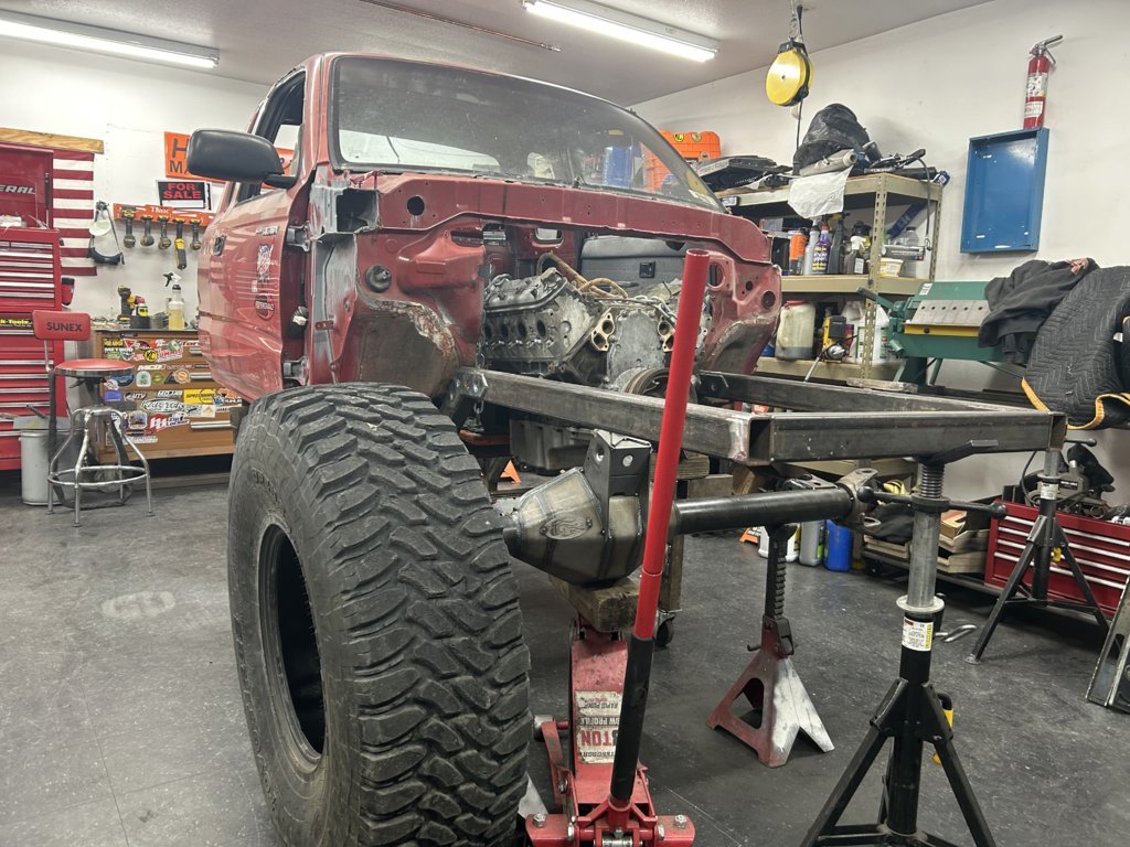

    Cut some tabs and made some hub tools for a few guys. Also got the mock up links cut and tacd and then got the tube I’ll mount the upper link off of cut and notched. It took forever with the 45 degree cut at the frame and 4 intersecting tubes to notch around at the bottom. But should work well.

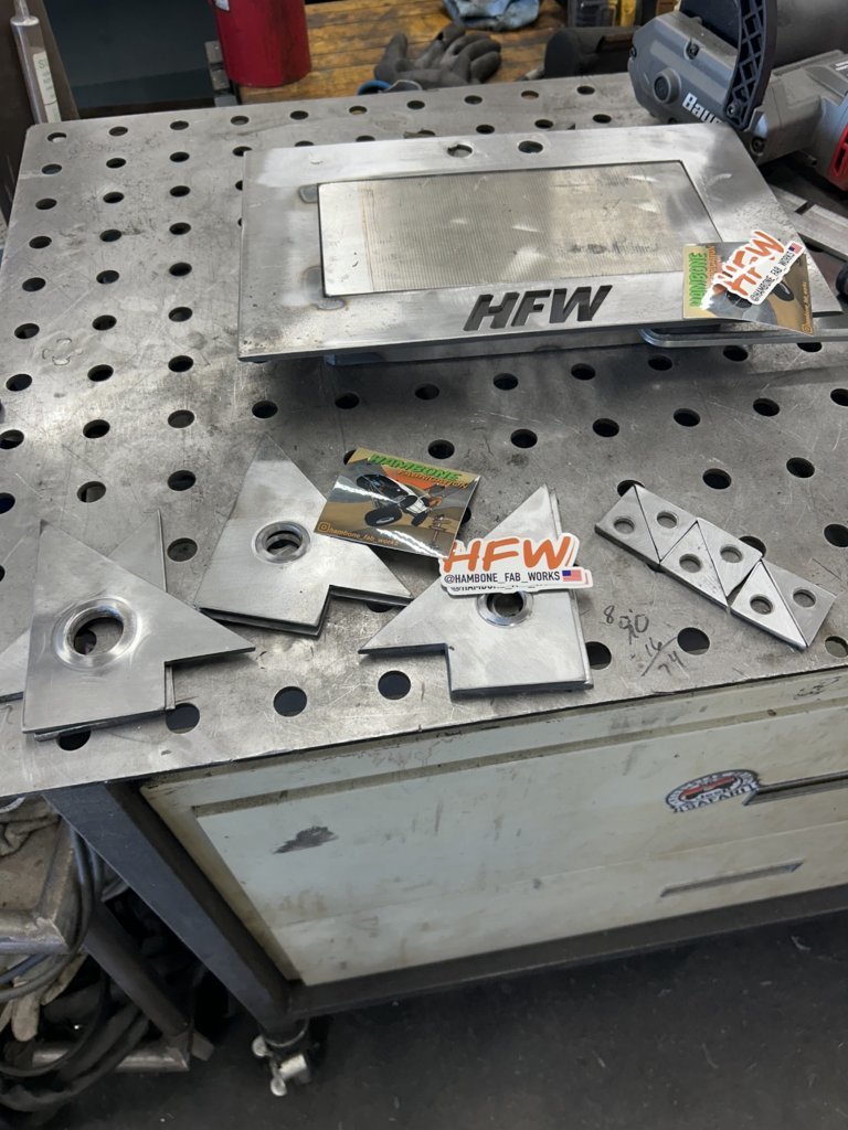

    Also made a magnetic grinding table to help hold tabs and clean them. IMG_7225.jpg IMG_7231.jpg IMG_7235.jpg IMG_7236.jpg IMG_7238.jpg IMG_7240.jpg IMG_7241.jpg

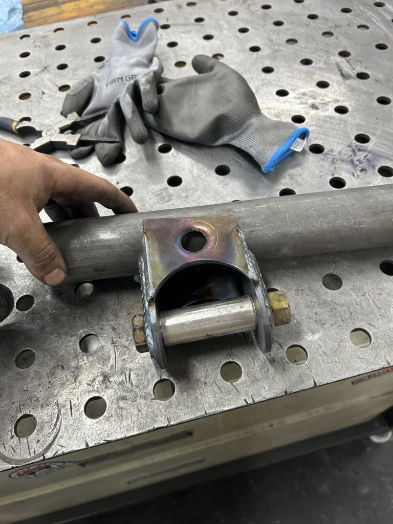

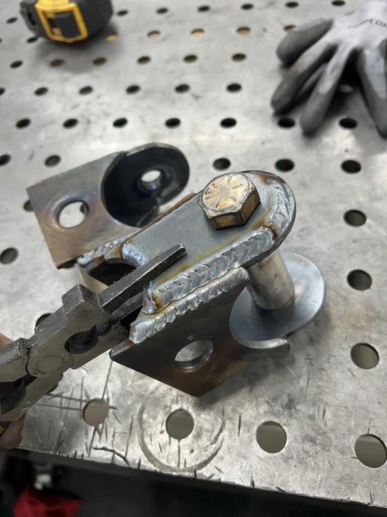

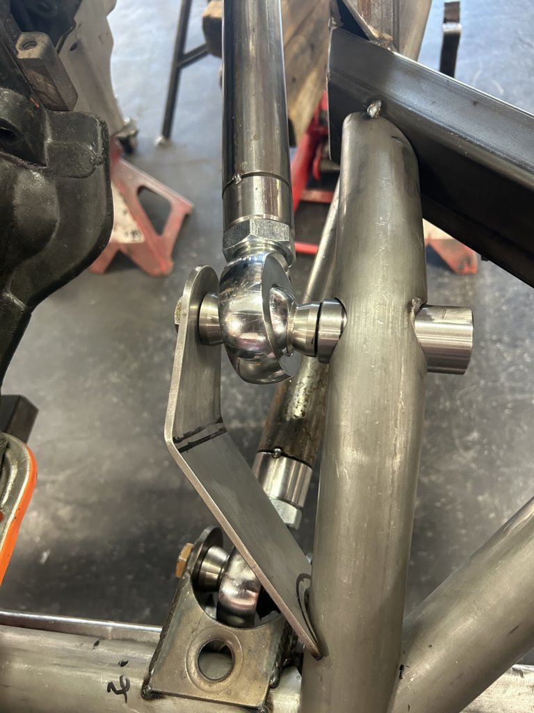

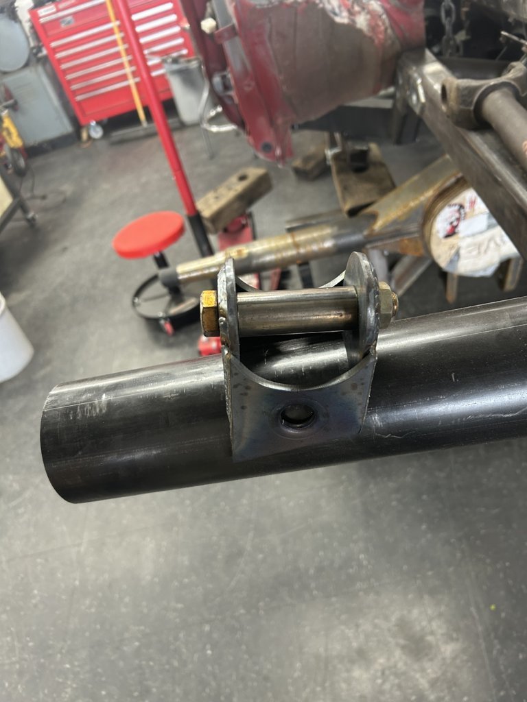

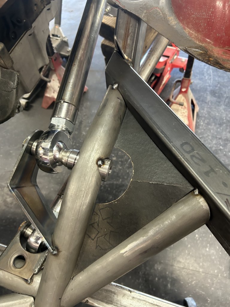

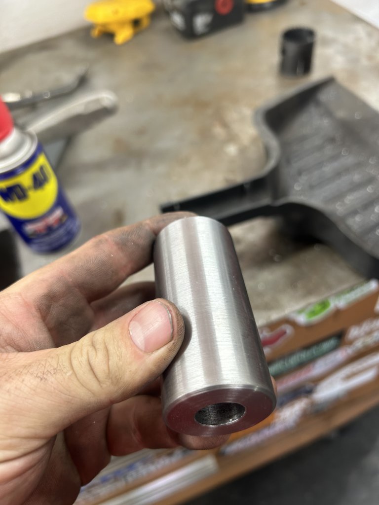

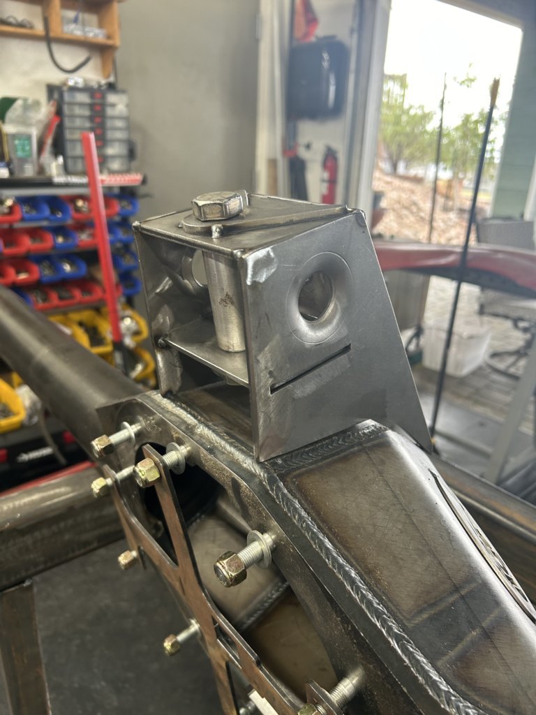

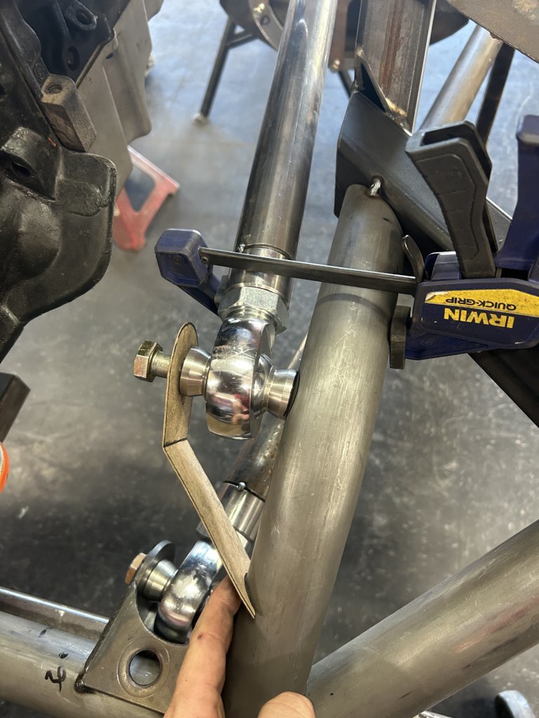

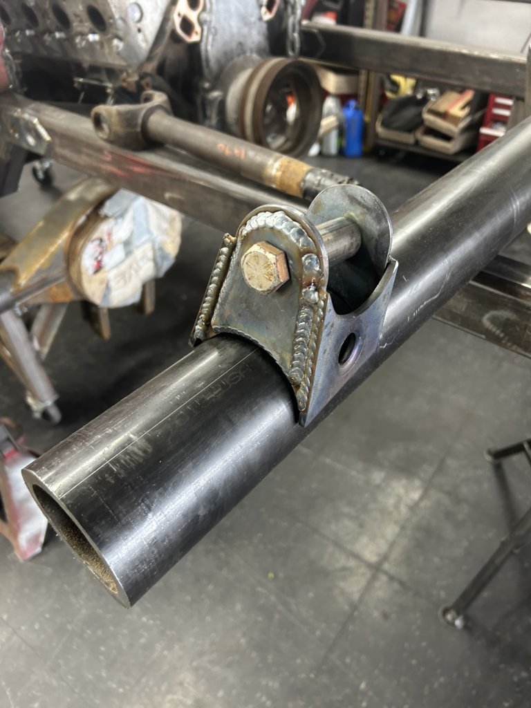

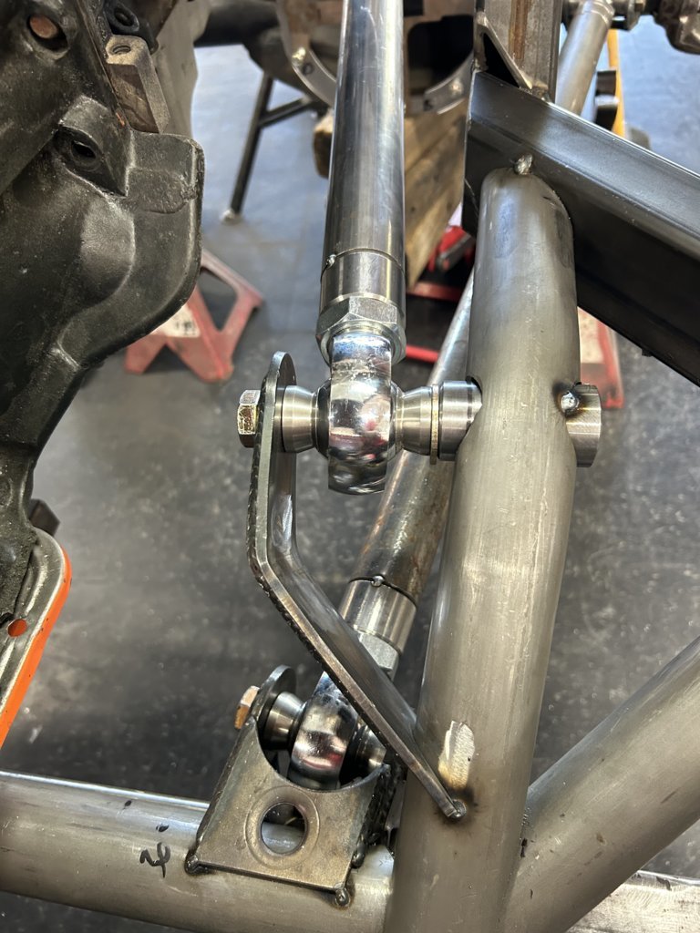

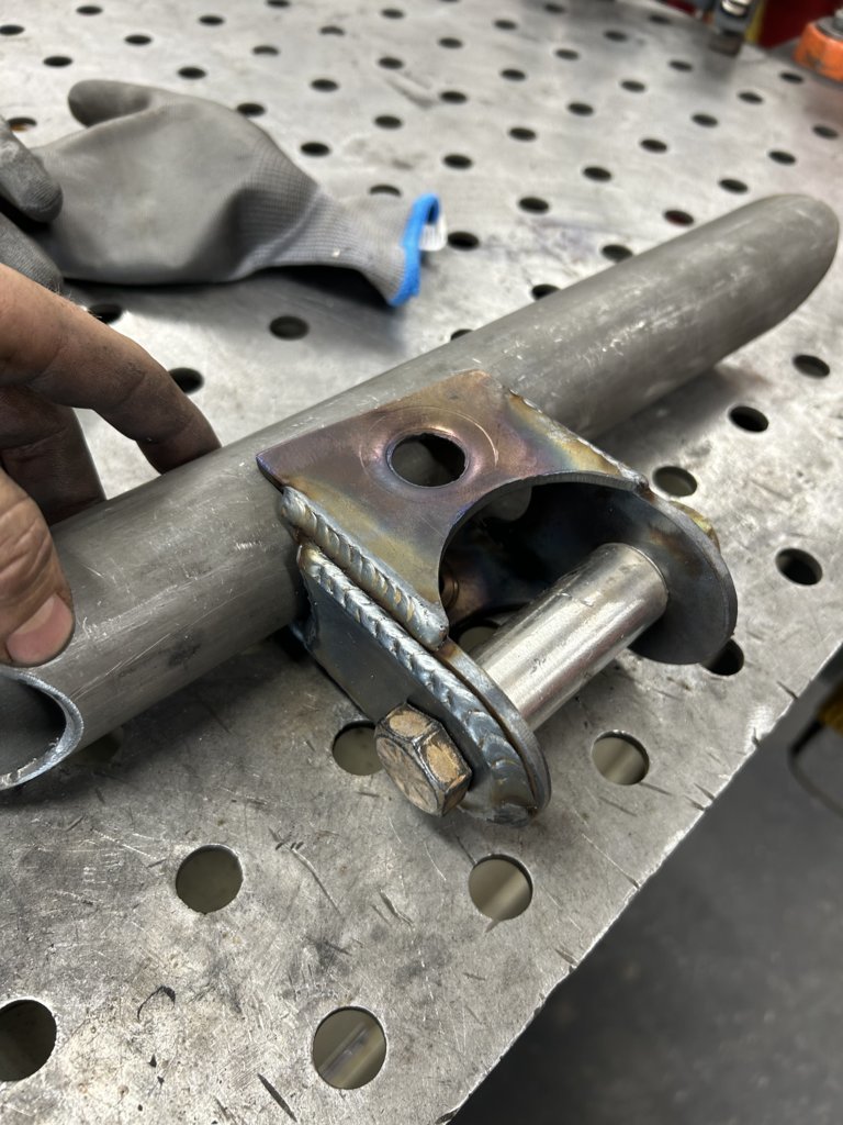

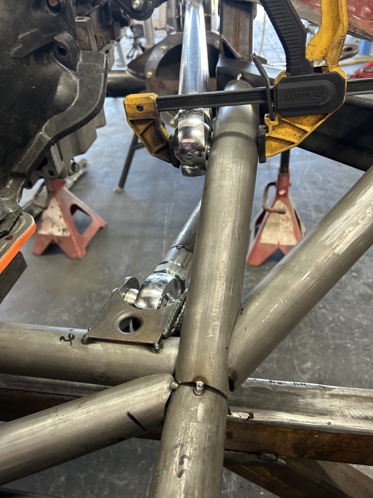

    Got the upper link tacd in place. Drilled a 1.5 hole in the tube for a sleeve and then built a bracket to make it double shear. Itll all get covered in gussets and supports. Wasn’t till I got it all tacd up I realized I need a 7 in bolt but would only fit it I dropped the trans or sleeved the frame. So ordered a piece of chromoly rod I’ll turn down and tap for 5/8-18 threads and use the longest bolt I can fit in there.
    The first set of pictures are how I had it at first and after staring at it, I didn’t like the way the bracket was sitting so ground and bent some more to get the heim in the center of its travel.
    IMG_7248.jpg IMG_7244.jpg IMG_7259.jpg IMG_7269.jpg IMG_7271.jpg IMG_7272.jpg

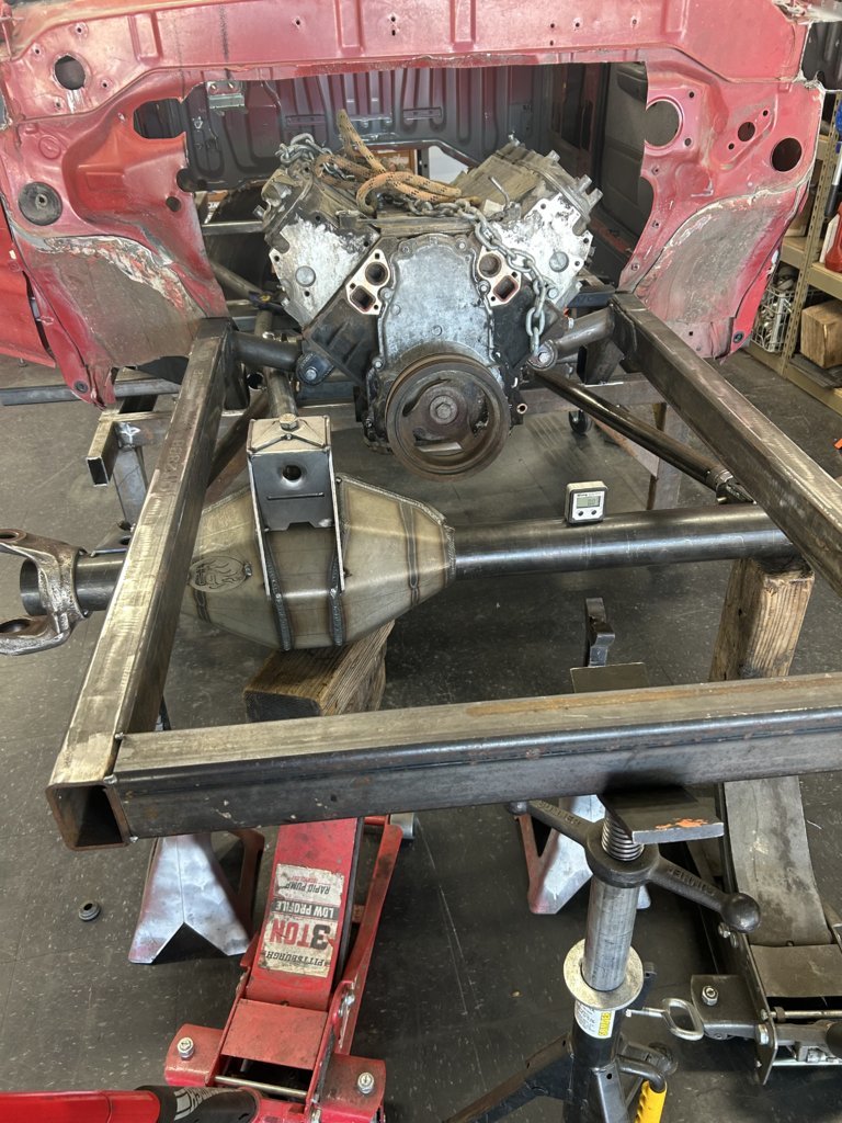

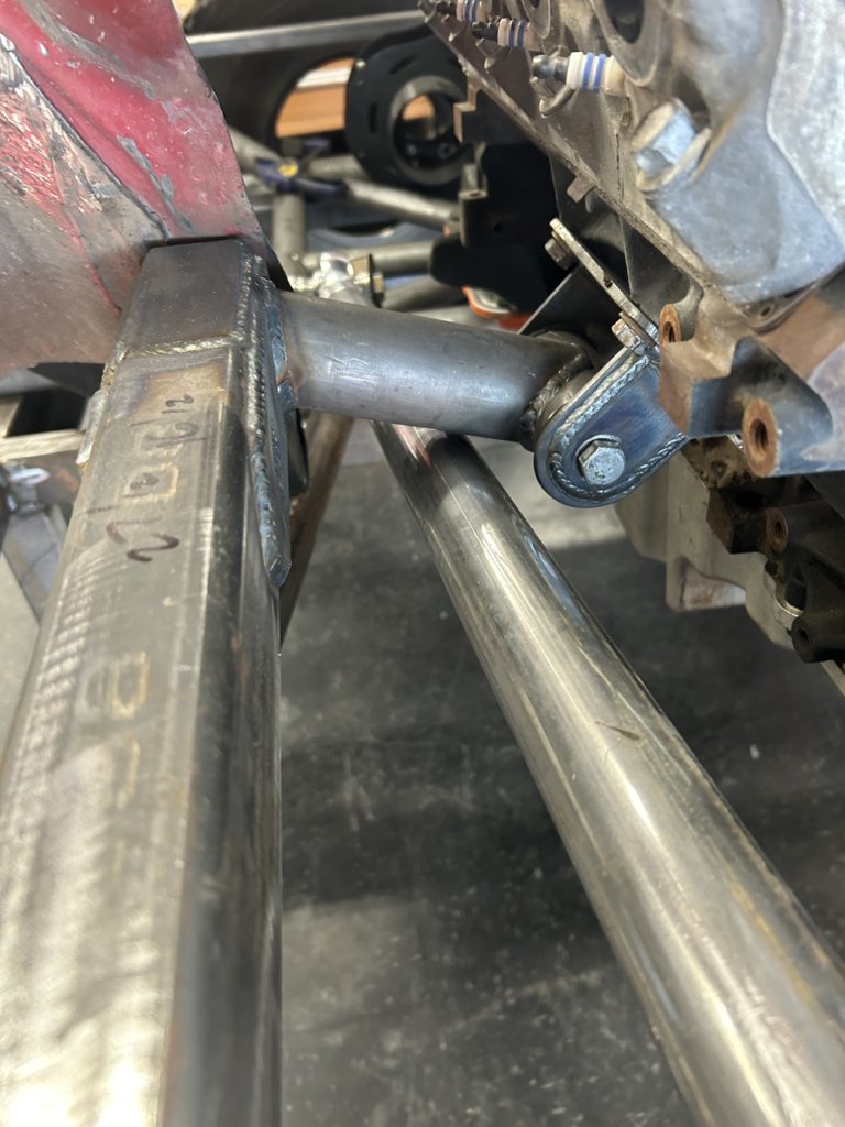

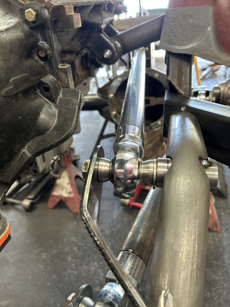

    Put the axle at full bump and the upper link hits the motor mount so that will have to get redone. Currently it has 6 inches of uptravel. The lower links will hit the frame in an 1.5 and the housing will hit in 2.5. So I’ll change the motor mount and then probably cut the bottom of the frame to get the housing to bottom out on the frame. Shooting for 7.5-8inches of uptravel.IMG_7255.jpg IMG_7256.jpg IMG_7257.jpg

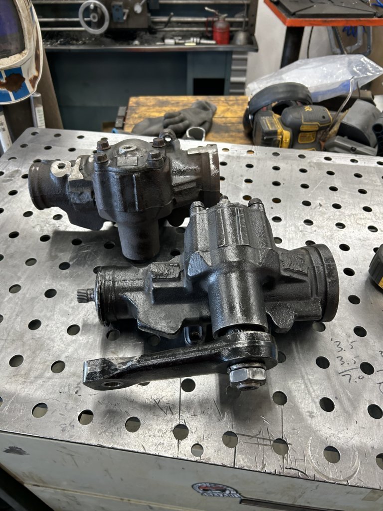

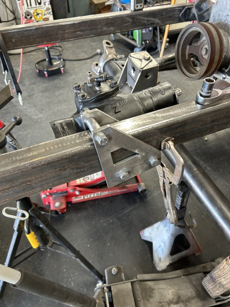

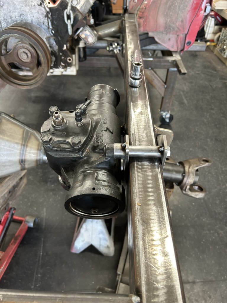

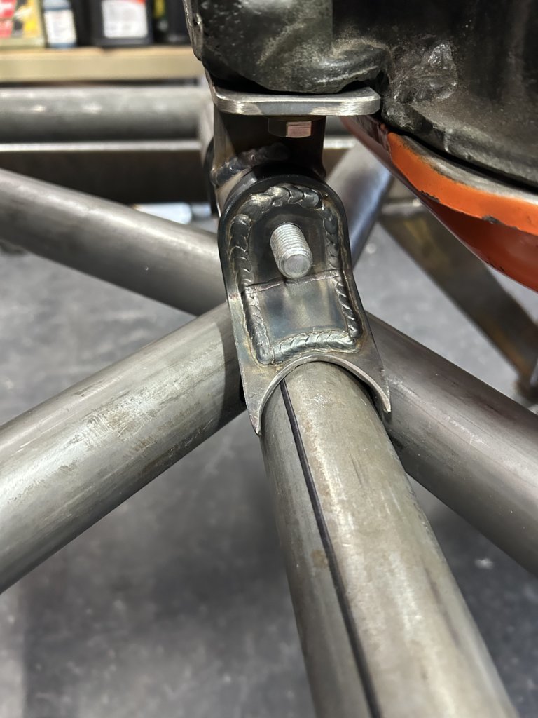

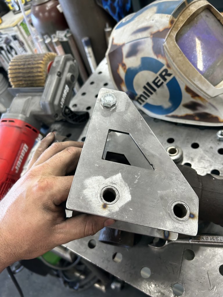

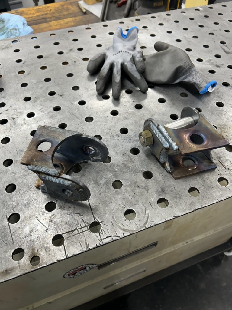

    When I picked up the steering servo from a guy on Instagram. He gave me a few steering boxes. One was a depowered Saginaw box that was missing the sector shaft and the other was a complete box. So I took the complete one apart and put the sector shaft in the depowered one and made a template to cut a frame plate. I’ll order a rebuild kit and do the depowered box just to make sure it’s good and if I can find another sector shaft I’ll build the second as a spare.
    And the trans tabs being bent bothered me so I remade them.IMG_7273.jpg IMG_7267.jpg IMG_7268.jpg

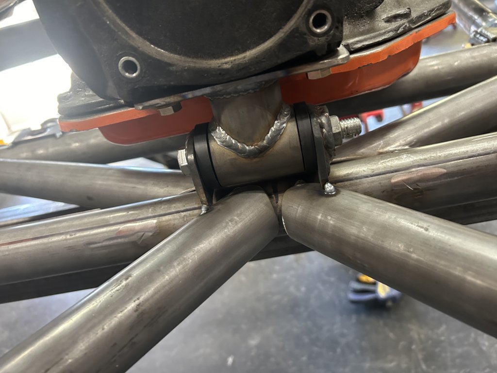

    Got the Saginaw box mount made. IMG_7296.jpg IMG_7297.jpg IMG_7298.jpg IMG_7299.jpg
