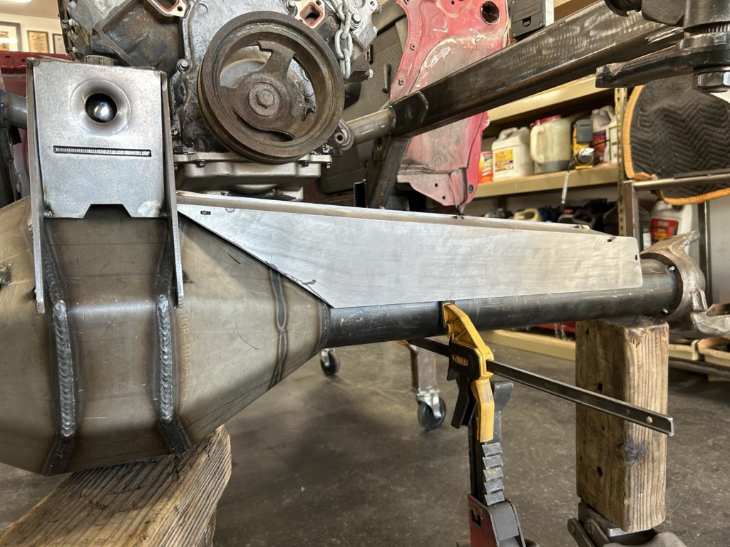

    And started in the truss for the front axle. IMG_7303.jpg IMG_7305.jpg IMG_7310.jpg IMG_7311.jpg IMG_7313.jpg IMG_7314.jpg IMG_7316.jpg

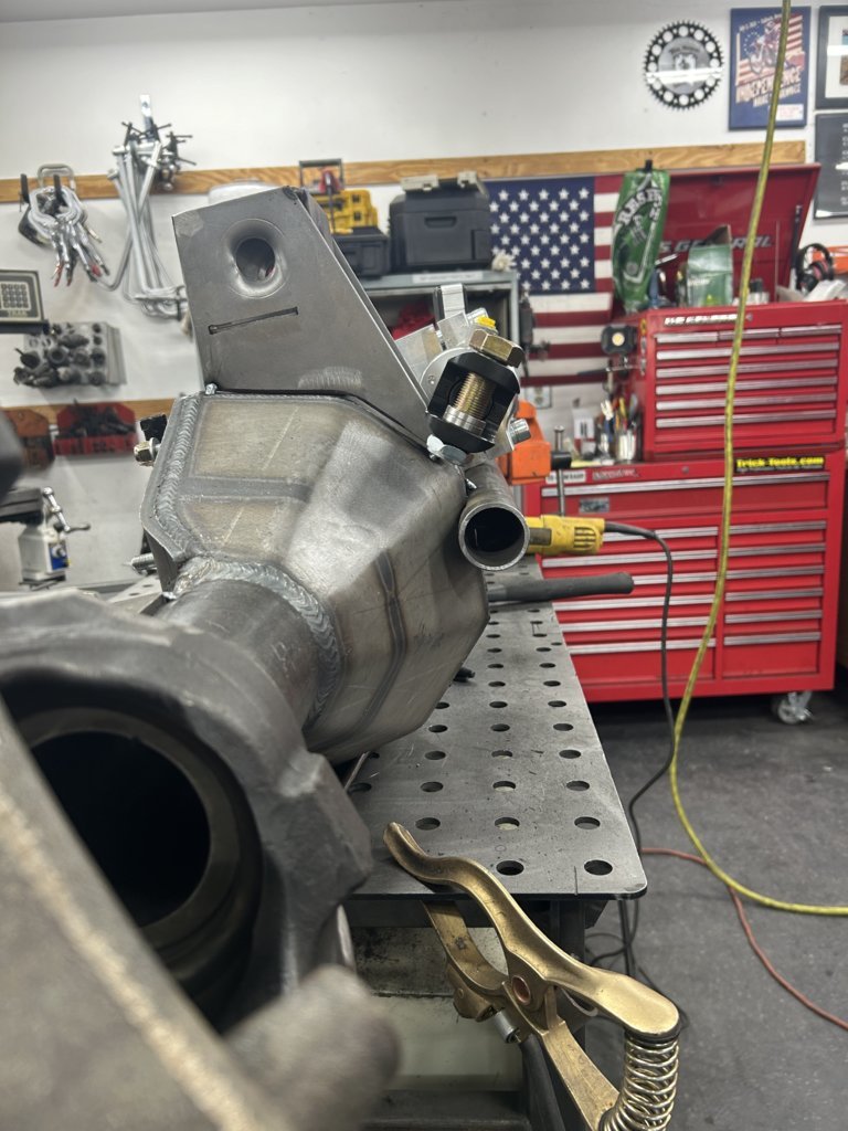

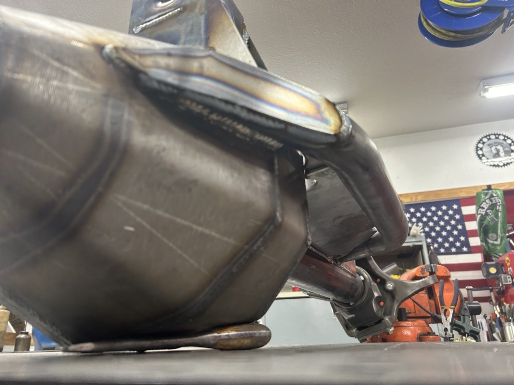

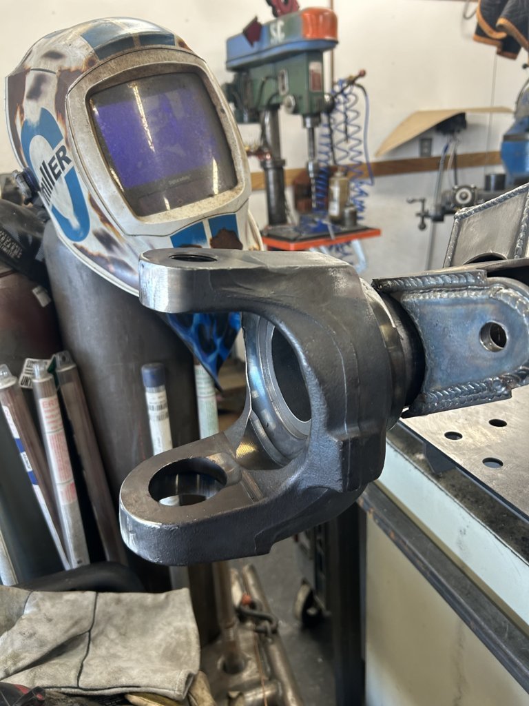

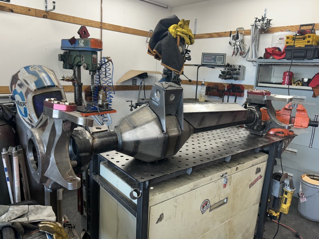

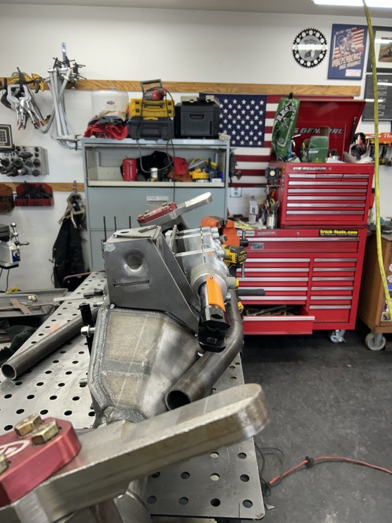

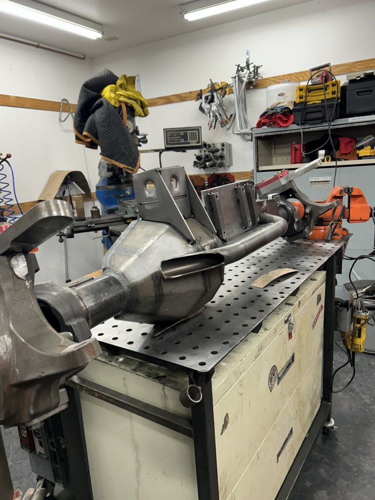

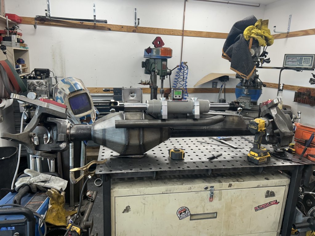

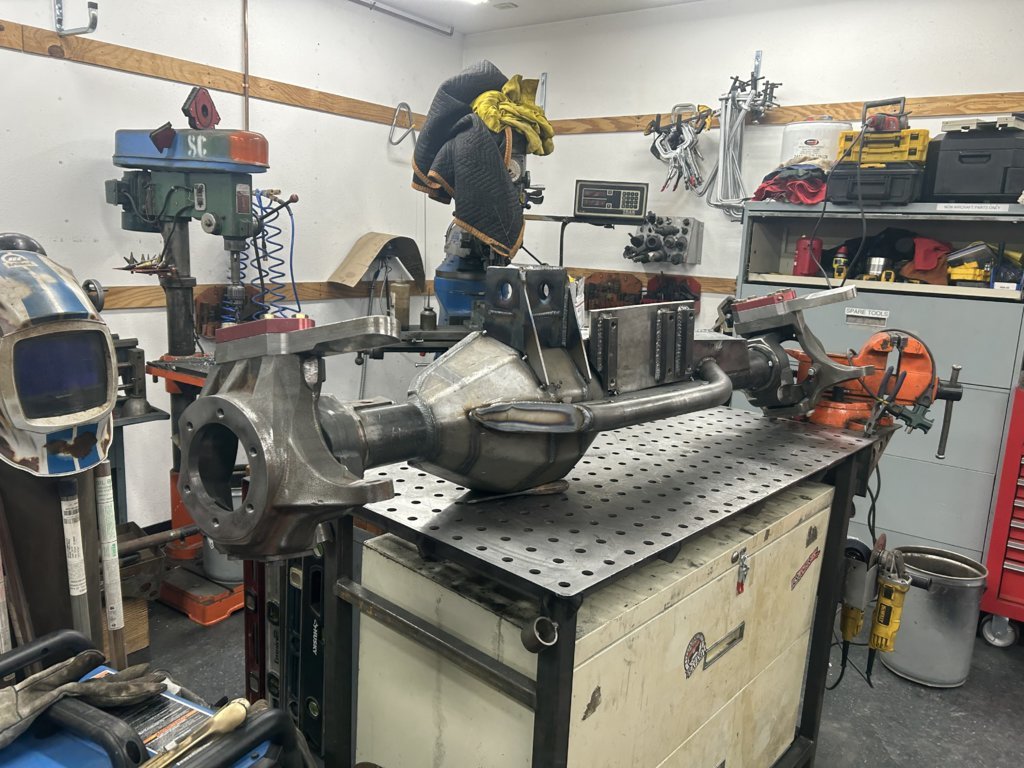

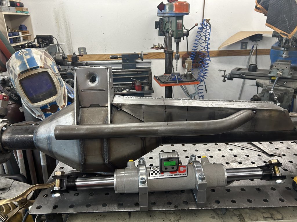

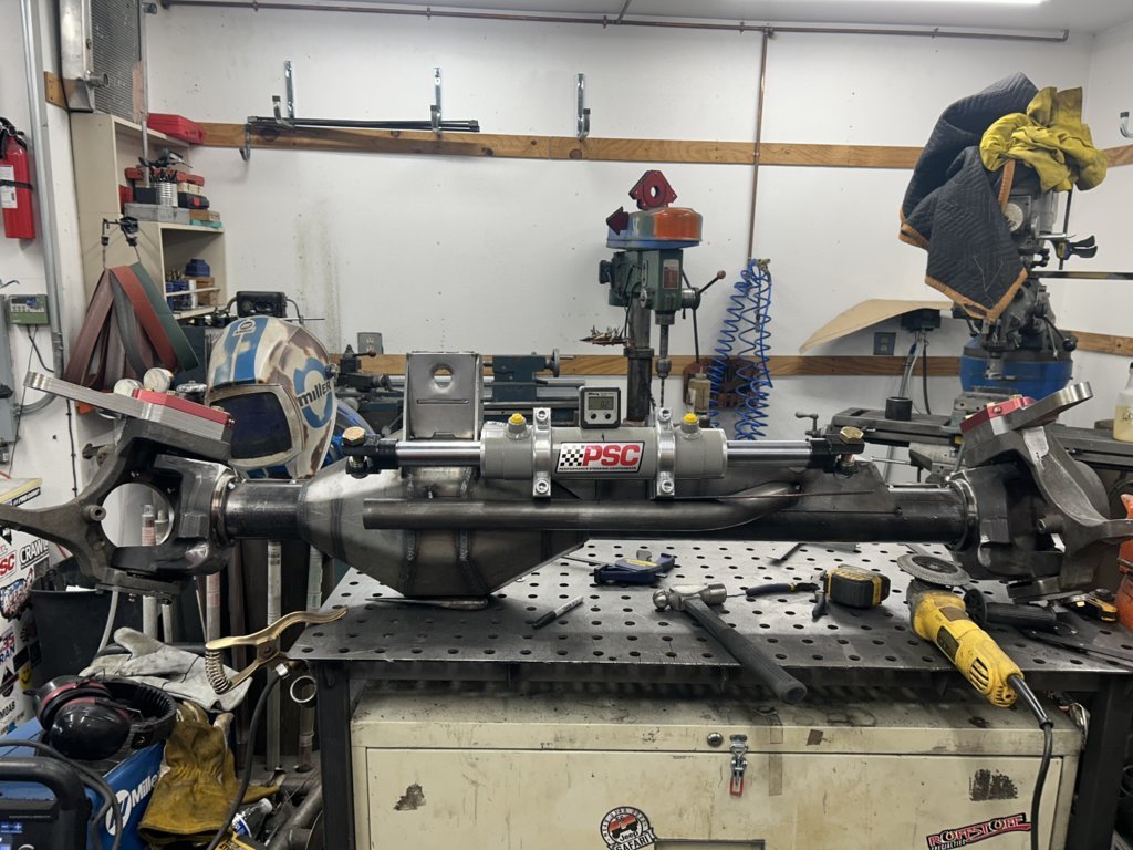

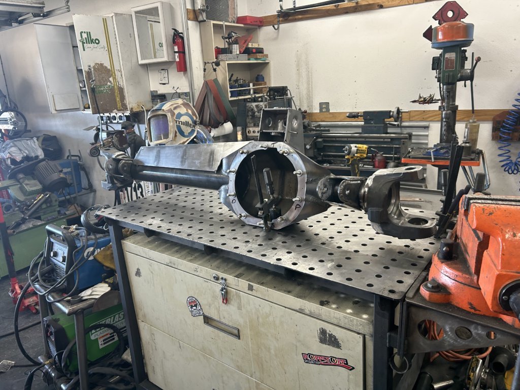

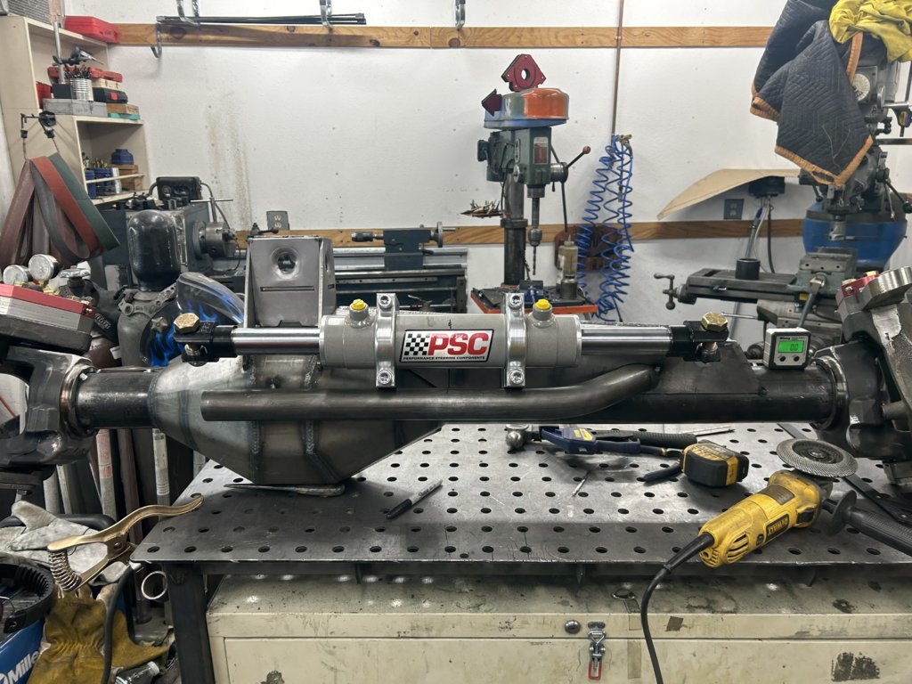

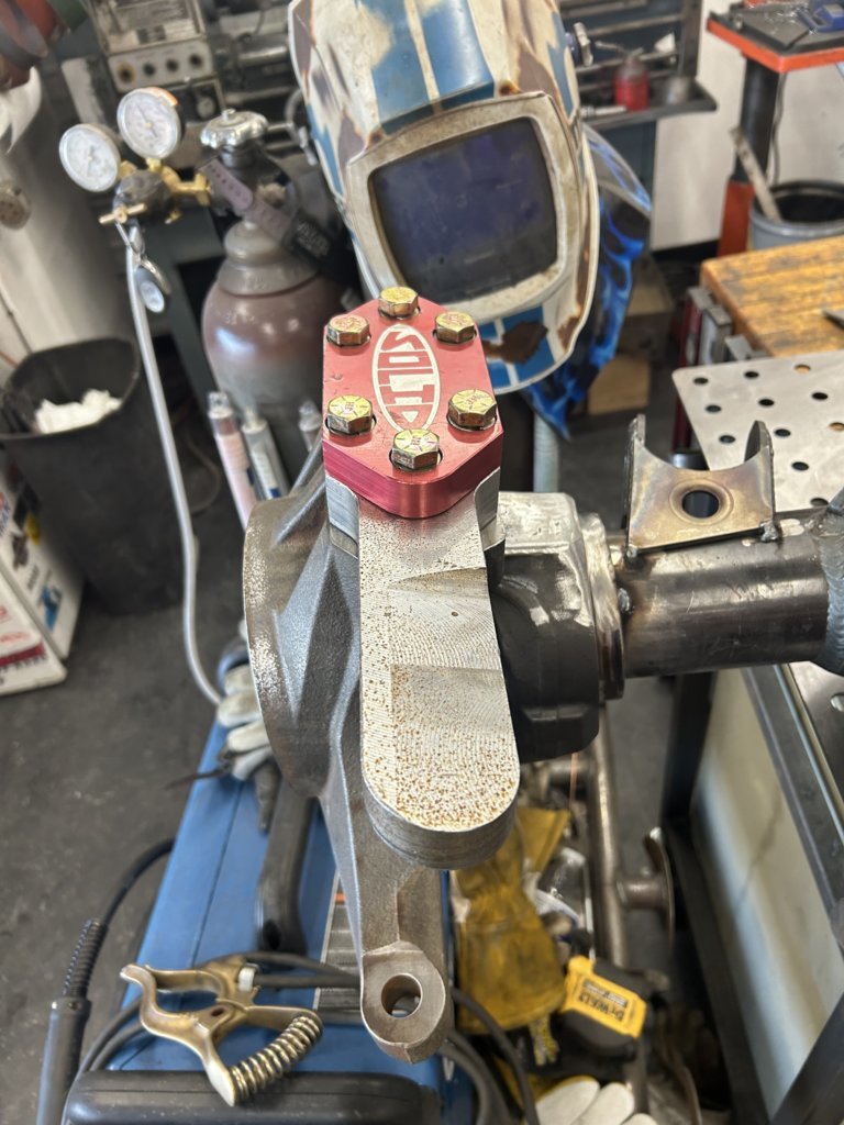

    Spent yesterday getting the housing cut really close to length. Won’t know if it’s correct till I order spindles and hubs. I tried putting the solid axle industry cs on. Used a hone to clean them up some and heated them in the grill and sanded the tube. Same way I did my last axle but something was off and they wouldn’t go on. One got stuck and I beat the shir out of it to get it back off and called it a night.
    Today I just threw them in the mill and spent the time to get the boring bar centered and a single pass made it so they slip on with the tap of a hammer. This let me assemble the inner c and get the knuckle on so I can start to figure out the steering ram. Need the steering ram on so I can figure out the panhard and get the steering box in place before I throw it back under the truck.

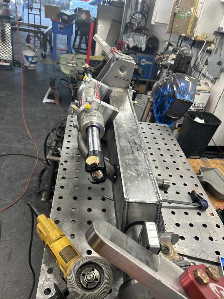

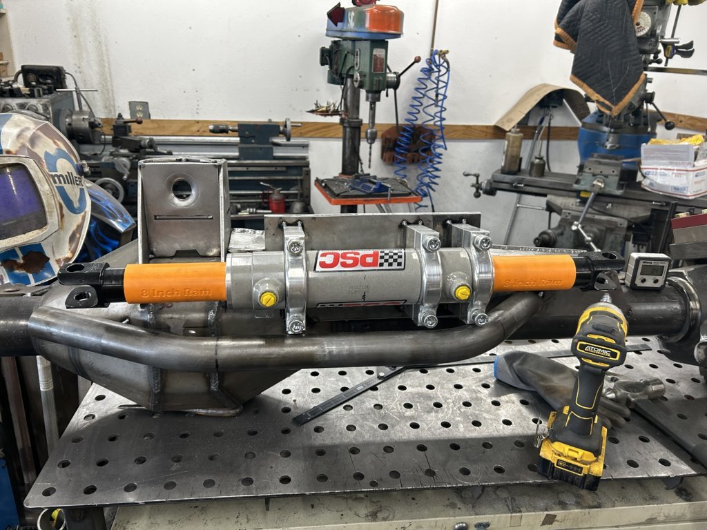

    This was what I started with to mount the ram. Just a piece of 1.75 bent at a 45. I didn’t like the ram hanging over the front and how high it was.
    IMG_7690.jpg IMG_7691.jpg IMG_7692.jpg IMG_7693.jpg IMG_7696.jpg IMG_7698.jpg
  13. Nov 8, 2024 at 7:30 PM
    #53
    malburg114
    malburg114 [OP] Well-Known Member
    Dec 26, 2012
    #93766
    3,816
    Las Vegas, NV
    2001 Toyota Tacoma TRD

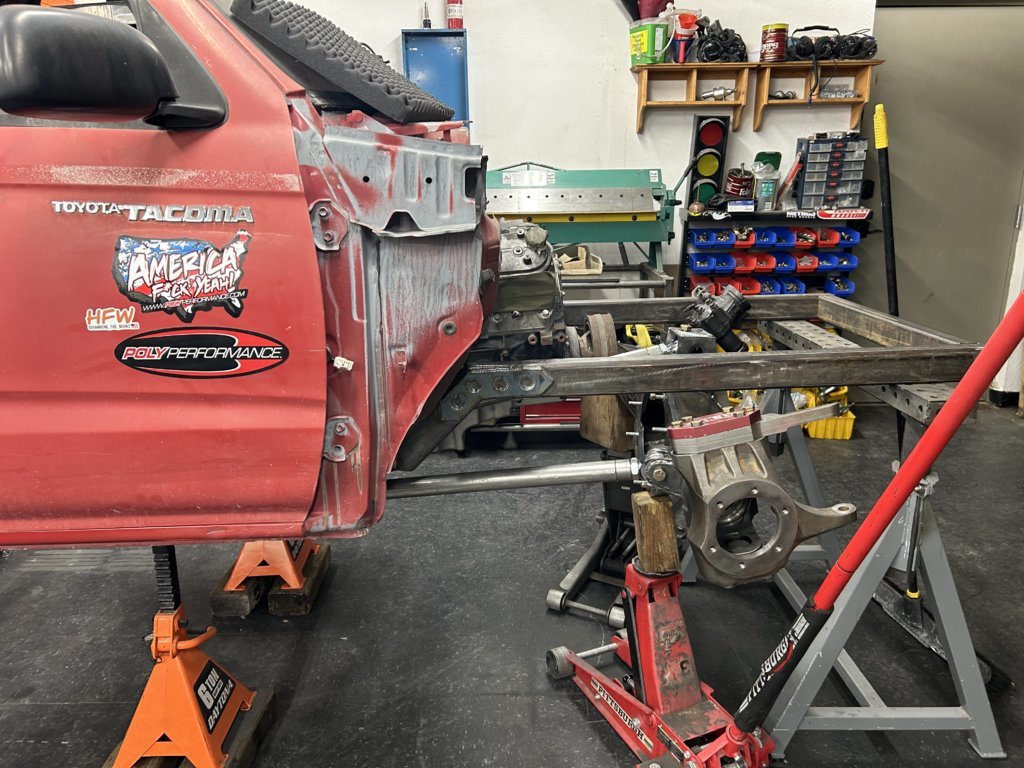

    So I notched the tube around the center section and lowered it some and placed the ram at an angle. I honestly have no idea what I’m doing just using some pictures as a reference. Tomorrow I’ll measure how much steering I have on my other truck as it’s identical besides the knuckles on it are stock dodge ones. But that’ll give me an idea of how much steering I’ll get and if I need to move the ram closer to the housing to get the shaft inline at full steer.
    If anyone has any input I’m all ears. I’ve never set up a double ended ram before.

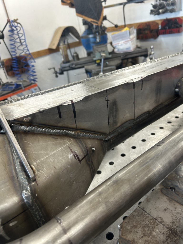

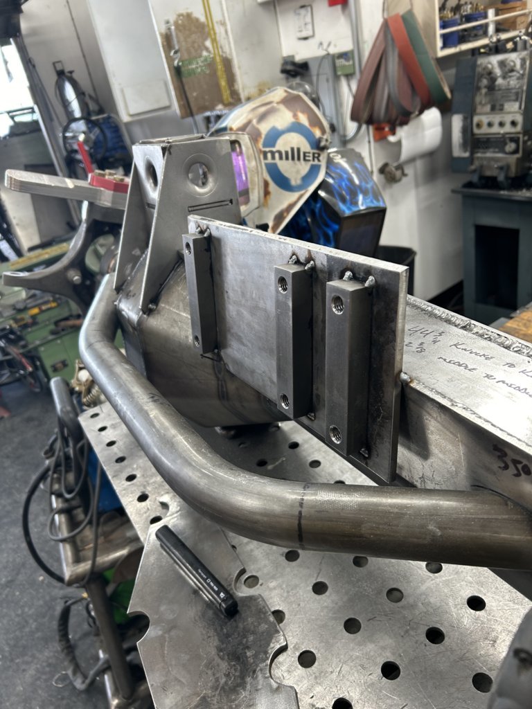

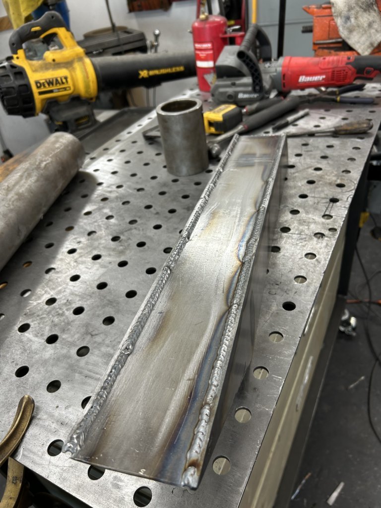

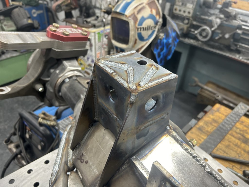

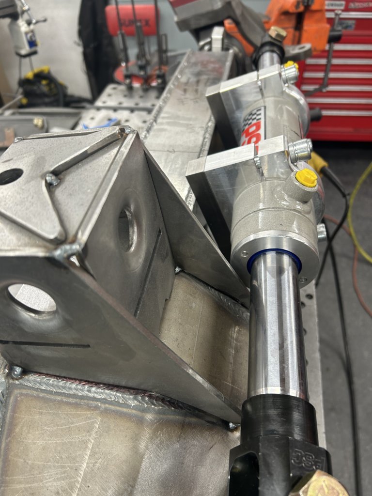

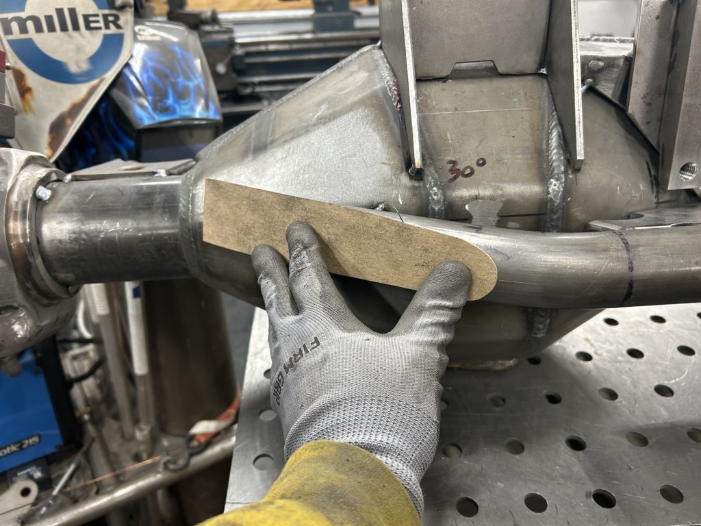

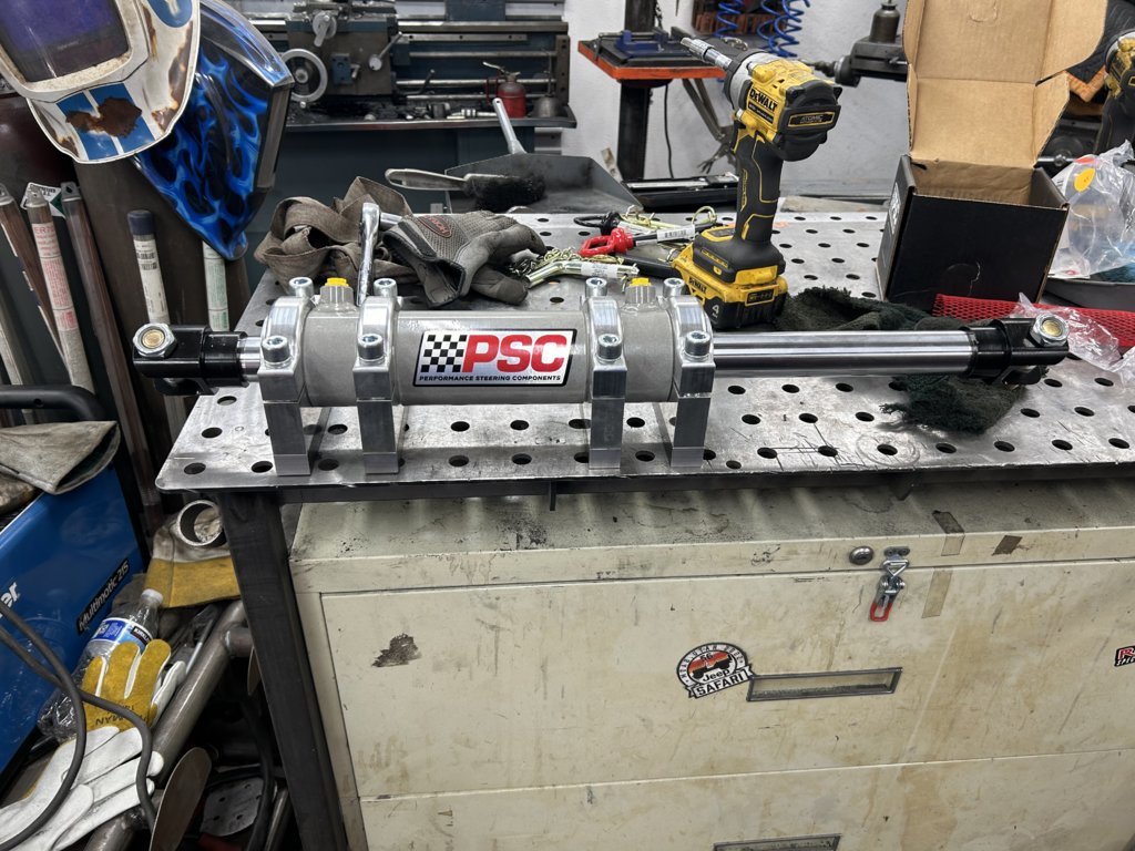

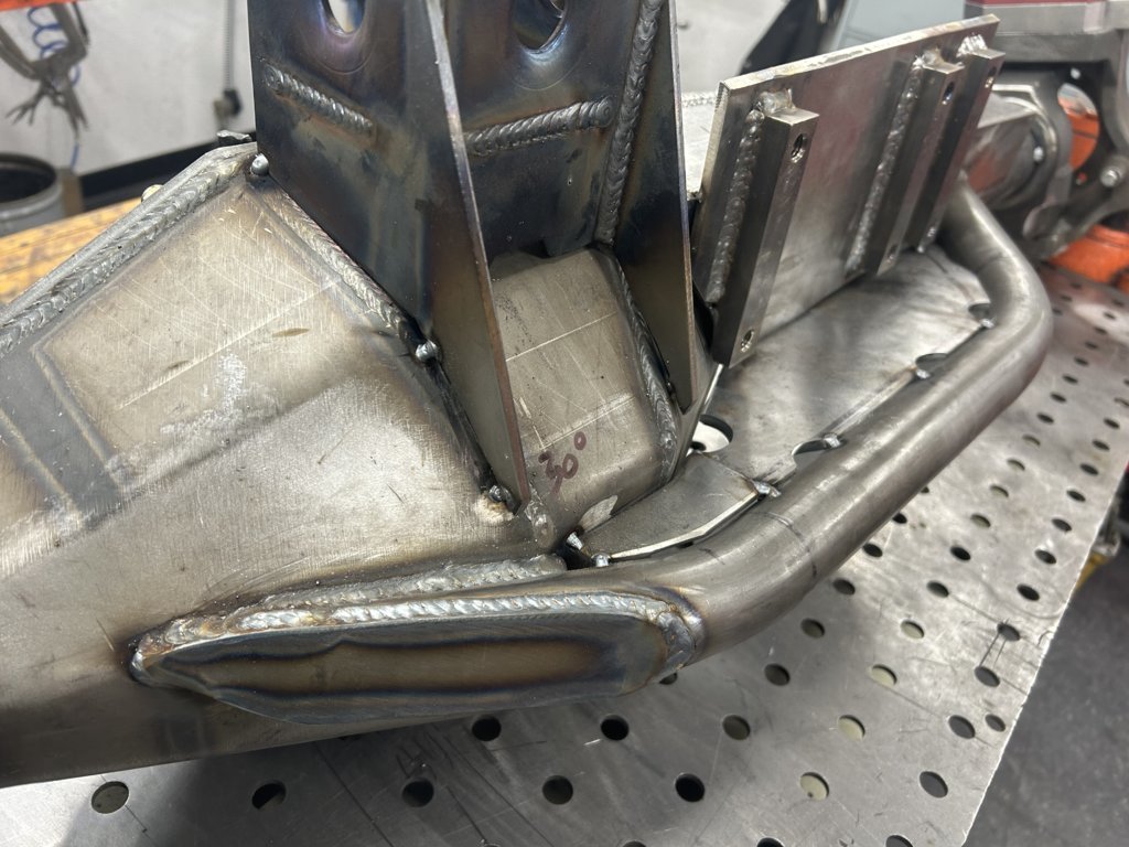

    Finally some more progress on the Ram. Rebent the tube on the front for more protection and extends a little farther out. Drew and cut a plate to mount the weld blocks and will probably weld a nut incase the blocks ever strip out. Needs a few more gussets on the back and a cap plate and some more plating and it’ll be done. Kind of wish I put more a bend in the tube to cut the back side and have it flow into the housing vs how I did but with a plate to cap it, it’ll be good.IMG_7935.jpg IMG_7940.jpg IMG_7942.jpg IMG_7948.jpg IMG_7950.jpg IMG_7948.jpg

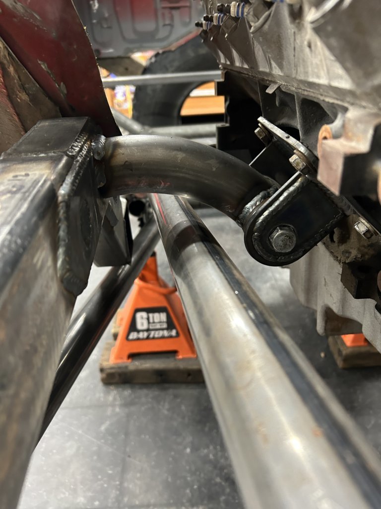

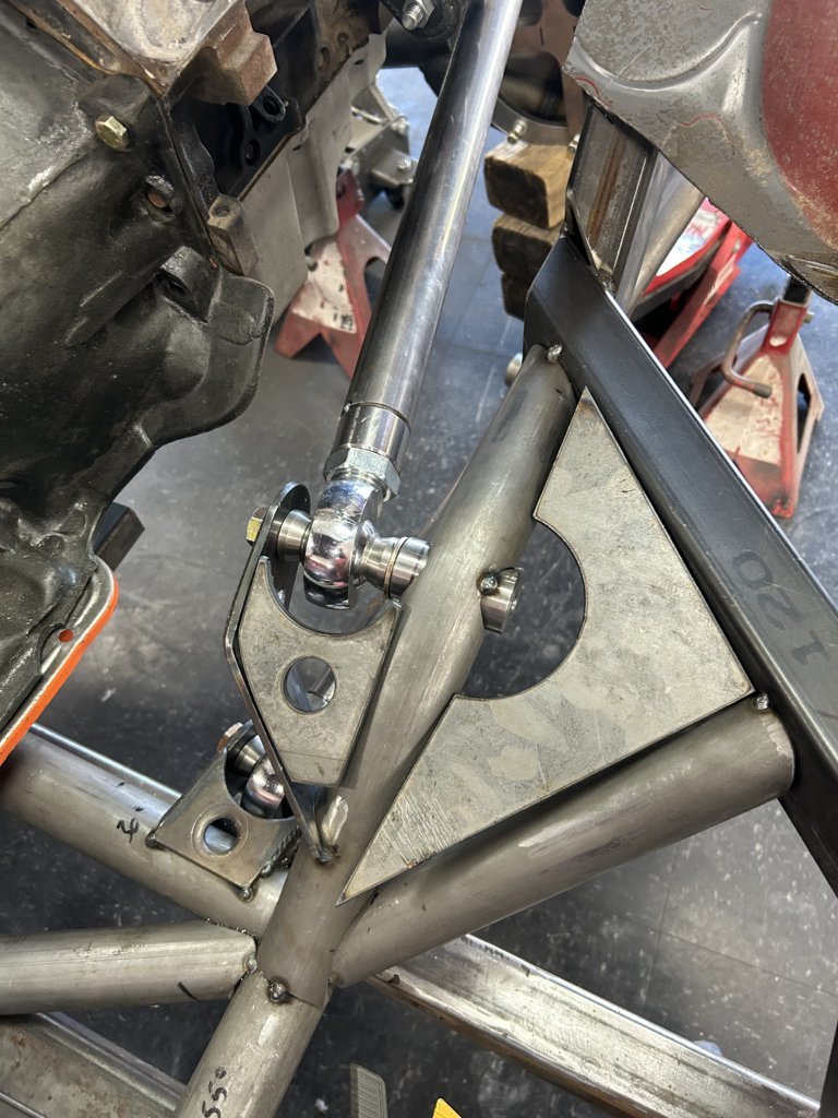

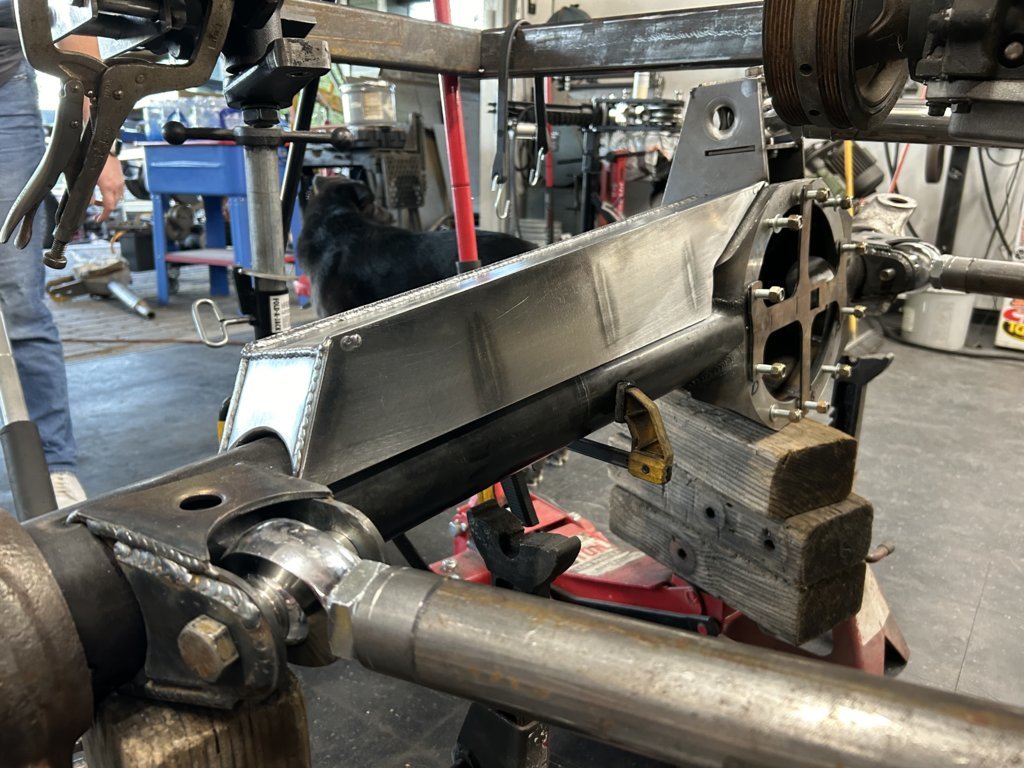

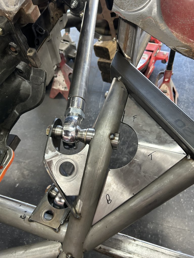

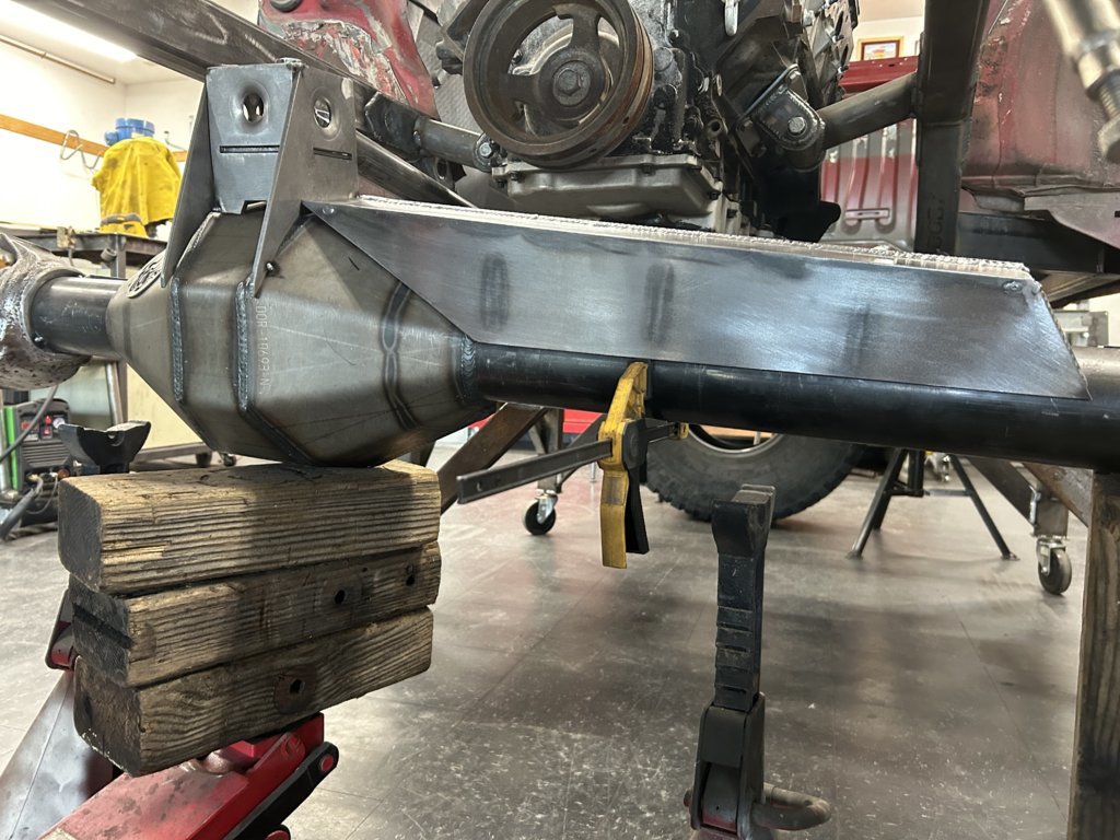

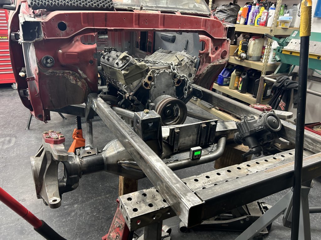

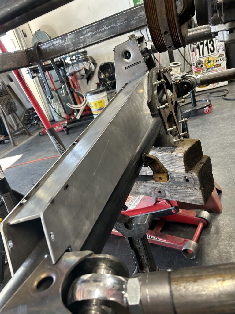

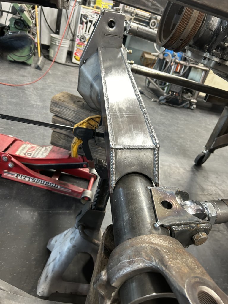

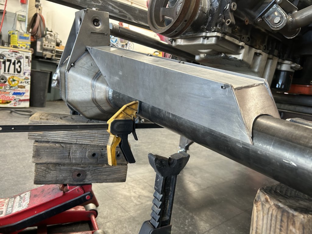

    Ended up welding the truss on and tacing all the steering brackets back on so I could get the axle under the truck. I’ll wait to fully weld the steering till I make the tie rods and figure out the drag link. I also took the time between welding the truss to fix the passenger motor mount to clear the upper link and ended up fully welding the upper link mount. Still only tacd to the housing though.
    I also cut a bunch of triangle supports for the back of the plate the ram clamps bolt to along with a cap. Should look pretty good all done.
    Not a huge fan of how I terminated the tube in the passenger side. It wasn’t till after I made all the braces and support that I realized I should have bent that side more and notch the back side for a cleaner look. With another plate or two and some paint I don’t think it’ll be noticeable though.IMG_7960.jpg IMG_7964.jpg IMG_7966.jpg IMG_7967.jpg IMG_7968.jpg IMG_7970.jpg IMG_7972.jpg IMG_7975.jpg

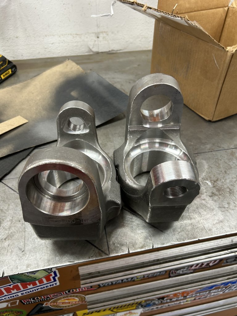

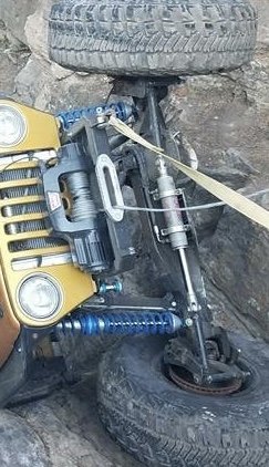

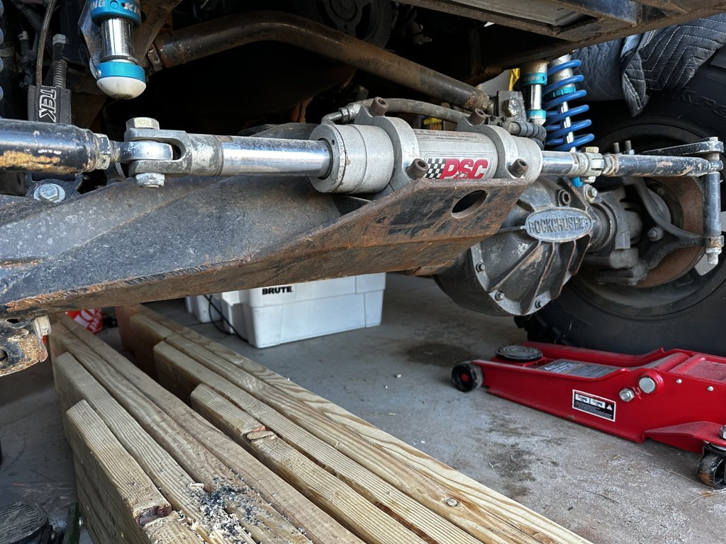

    Outstanding craftsmanship. I like me some Solid Industries Axles too.

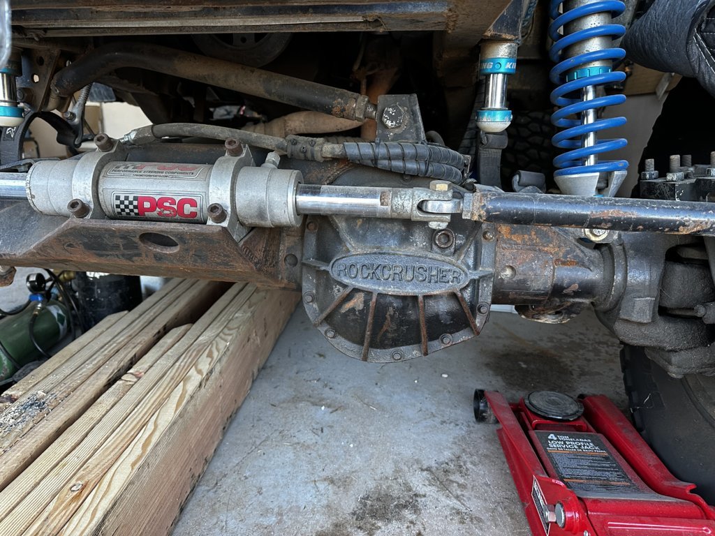

    Sorry, if I had seen this earlier I would have just went to the garage and got you better pictures. It's cold out. Don't judge me. :D

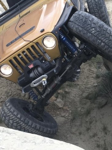

    Here are "more better" pics.
    this has 6 hard years of use.
