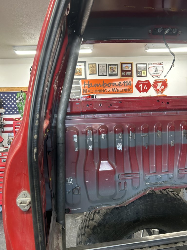

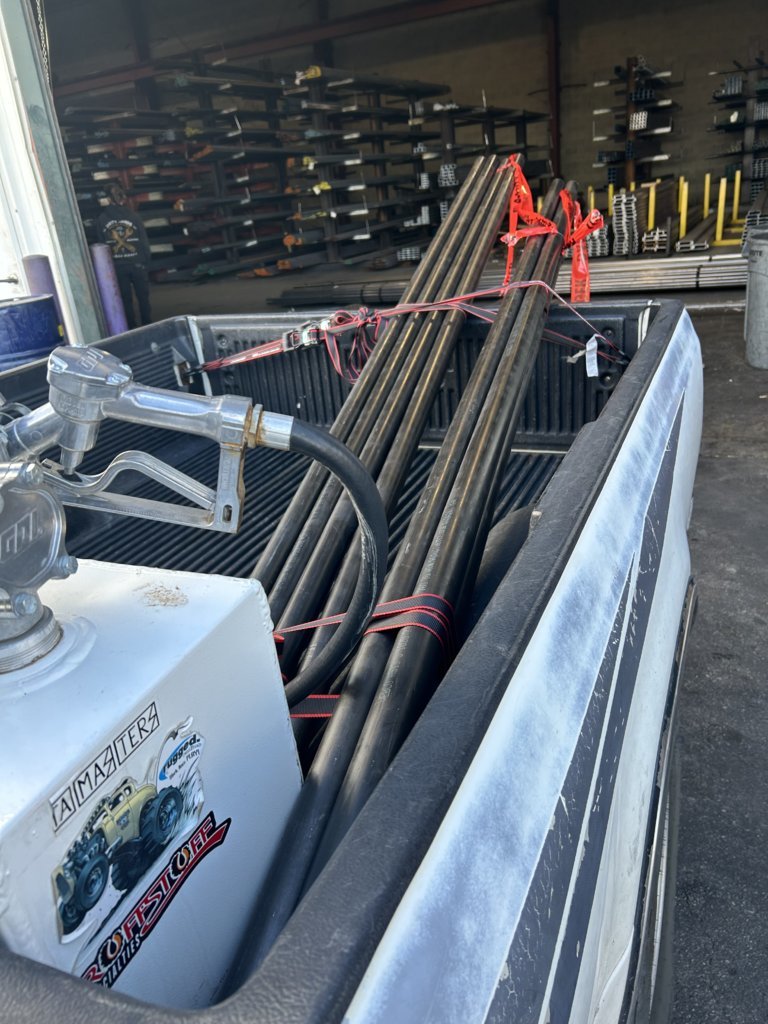

    When I got metal for the trailer I picked up another stick of 2” dom. The cage main tube still bothered me so spent some time redoing that and extremely happy with it now. That pretty much used a hole stick so I’ll get some more material next week and work on something else in the meantime.IMG_8667.jpg IMG_8668.jpg IMG_8669.jpg IMG_8674.jpg IMG_8677.jpg IMG_8676.jpg

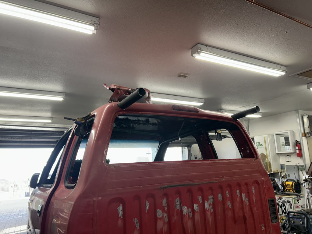

    I did some stuff for a buddy and some house projects so only got the c pillar done today and now I’m out of tubing. I’ll pick up some more this week after work and continue on the cage next week. Also slapped the headers on just cause and the driver clears but passenger v band gets into the motor mount. May have to find a different set.IMG_8710.jpg IMG_8711.jpg IMG_8712.jpg IMG_8713.jpg IMG_8714.jpg IMG_8716.jpg

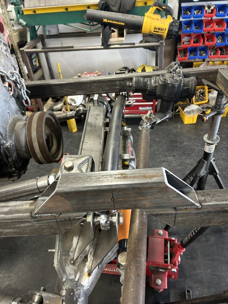

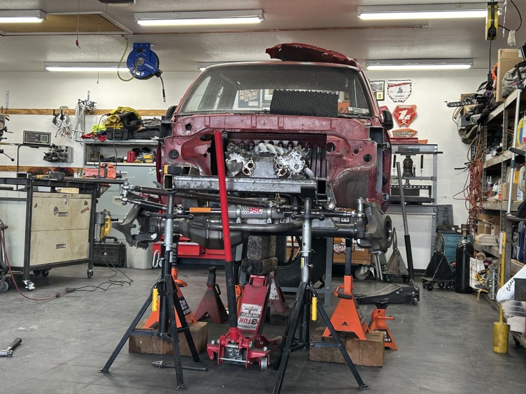

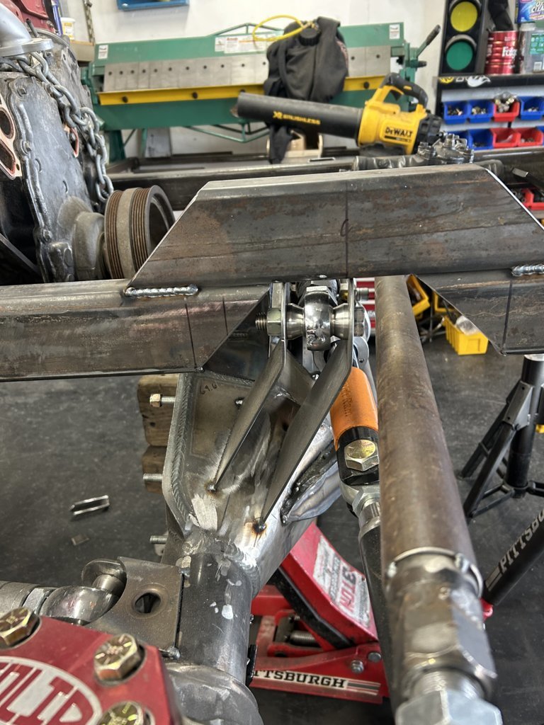

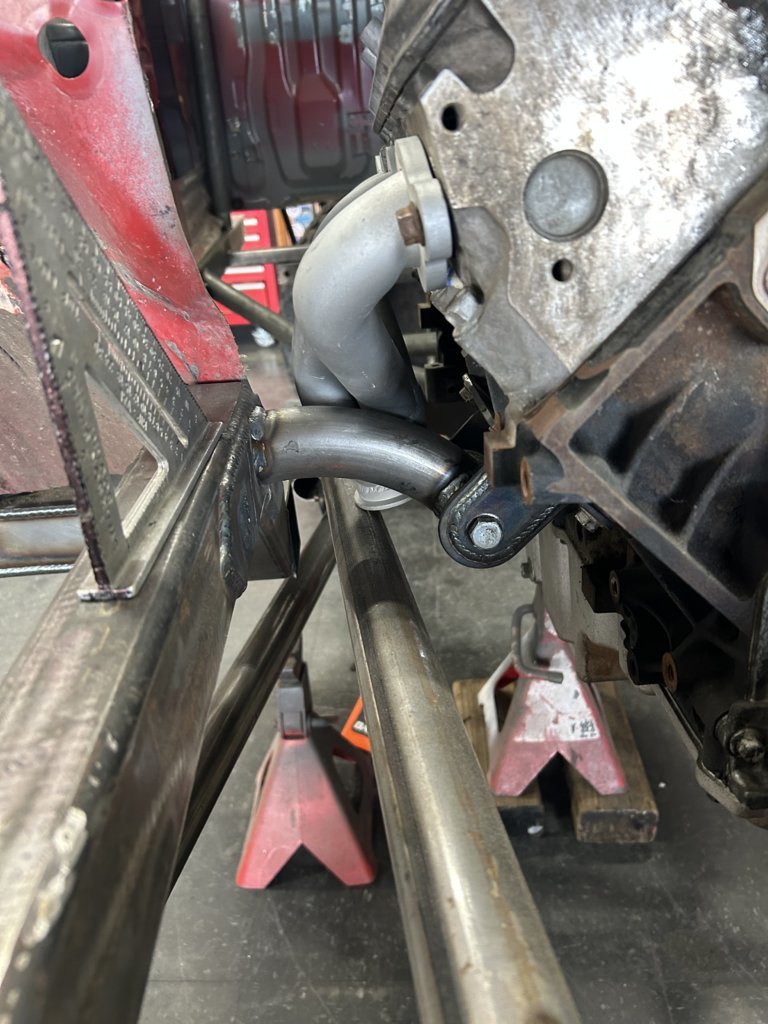

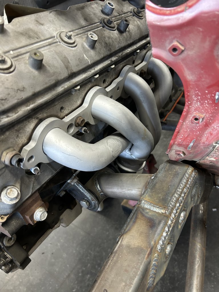

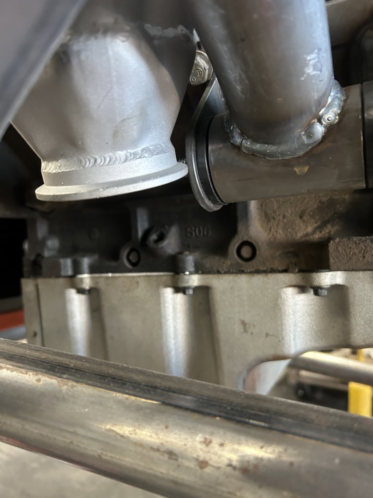

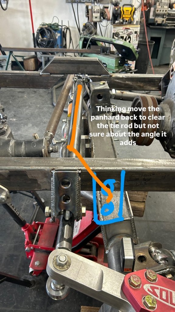

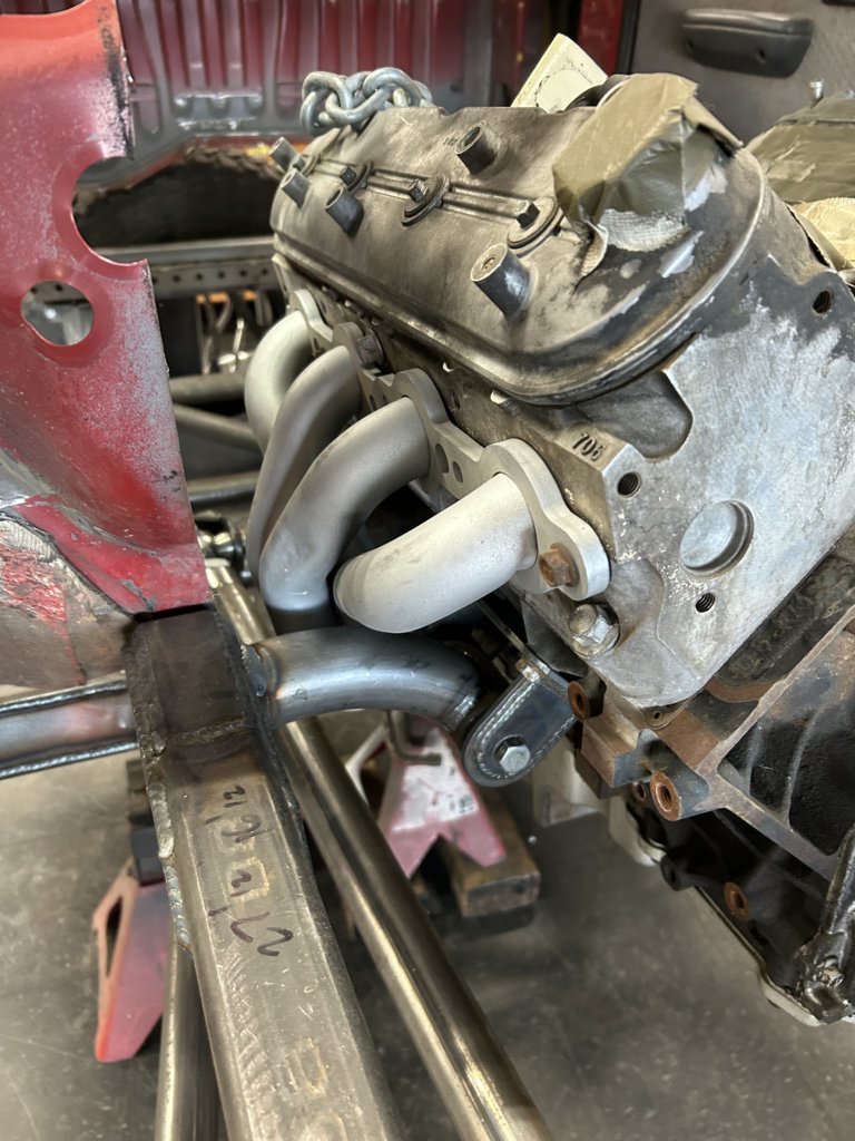

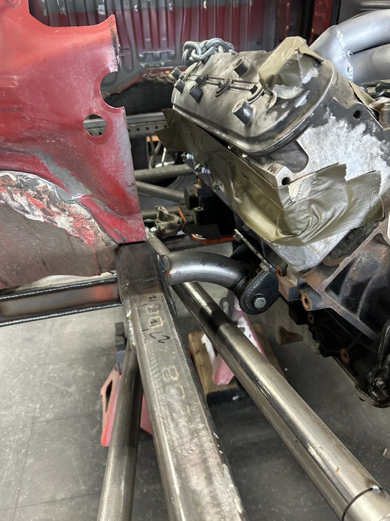

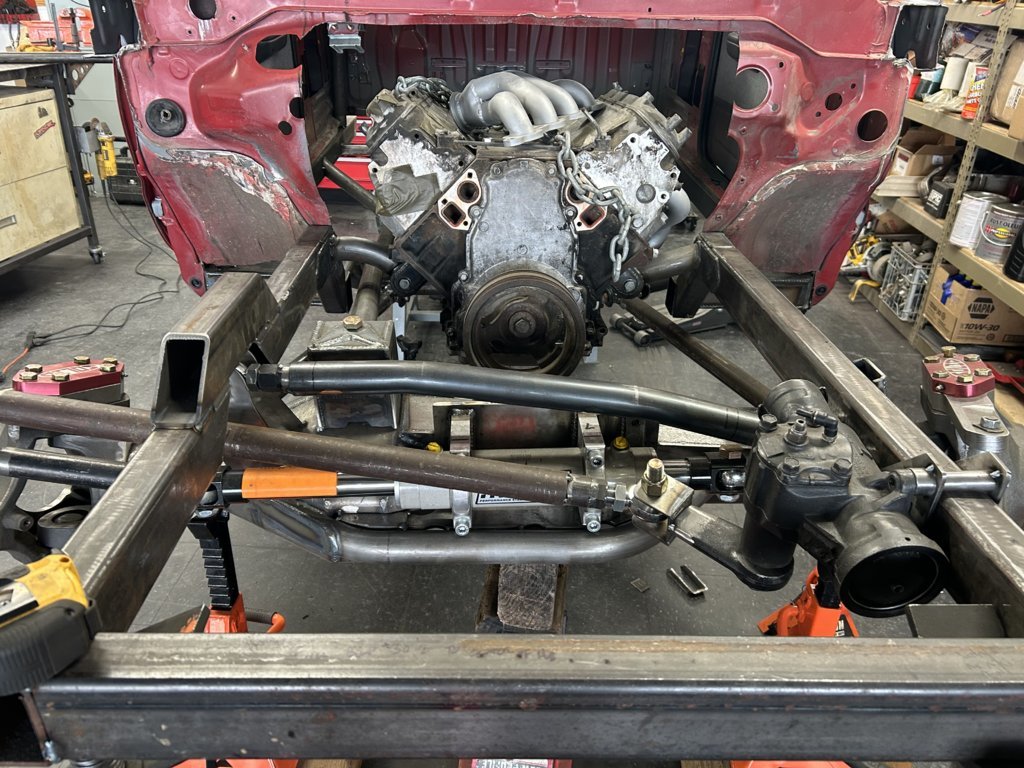

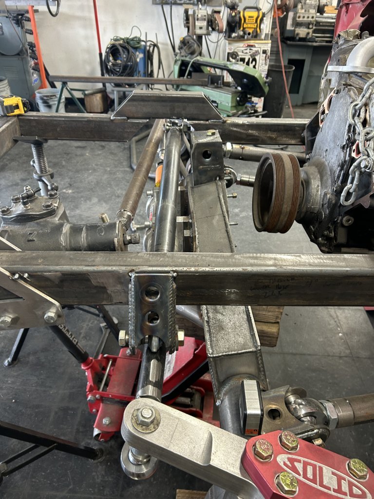

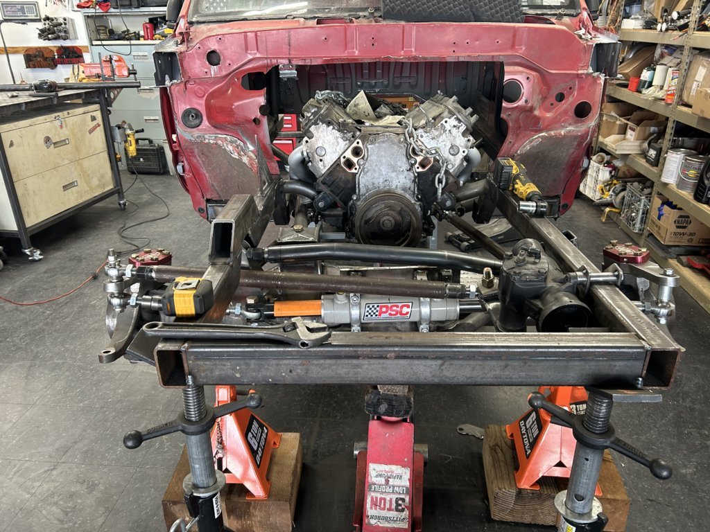

    Was just going to have a lazy day but reading forums and looking at pictures decided to go out and mess with the panhard for a little bit. I’ve been putting off adding bends to the panhard and ended up adding (2) 12 degree bends on either side where the ram ends as at full bump the panhard hits the ram. I then notched the passenger side from for the panhard bracket to go into and draglink to go into. Regret putting it off as it worked well and now everything clears. 12 degrees may have been a little much and I can probably get away with 6-10 which I’ll try later. But this will allow me to lower the axle side panhard some as well so it’s not a giant lever. The draglink just barely gets into the bolts on the ram so I either need to move the steering box forward a 1/4-1/2 inch or add a bend. Not sure adding a bend will solve my issue but I may try it just to see.
    And the upper link ends up getting into the headers so I’ll have to do something about that.
    What’s everyone’s thoughts on offsetting the frame side panhard mount back as right now my limiting factor is the frame side panhard heim is hitting the tie rod.IMG_8724.jpg IMG_8725.jpg IMG_8732.jpg IMG_8733.jpg IMG_8734.jpg IMG_8735.jpg IMG_8736.jpg IMG_8738.jpg 2AC2E13B-203C-46D1-97C2-296513D1F10F.jpg

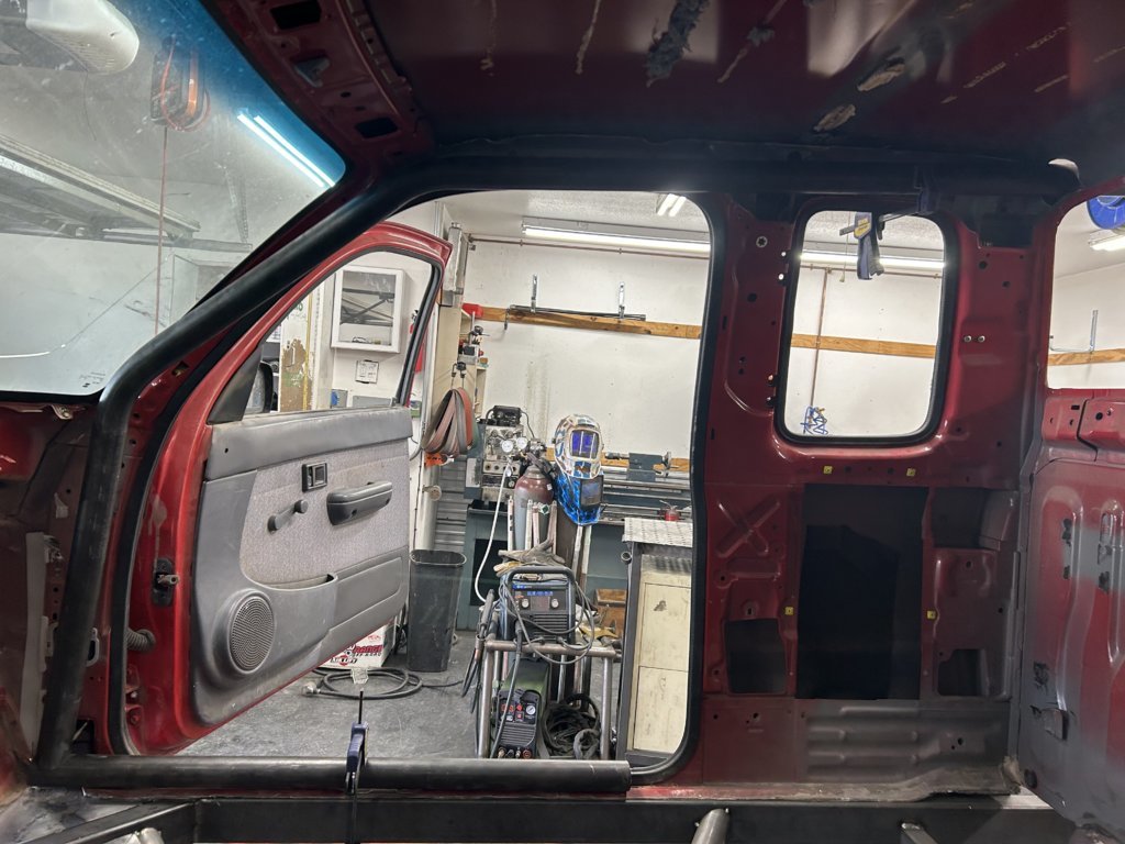

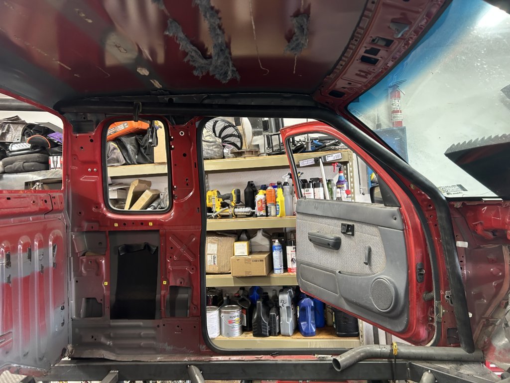

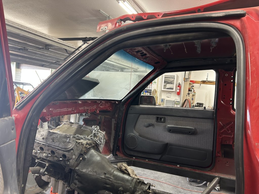

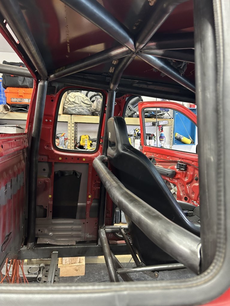

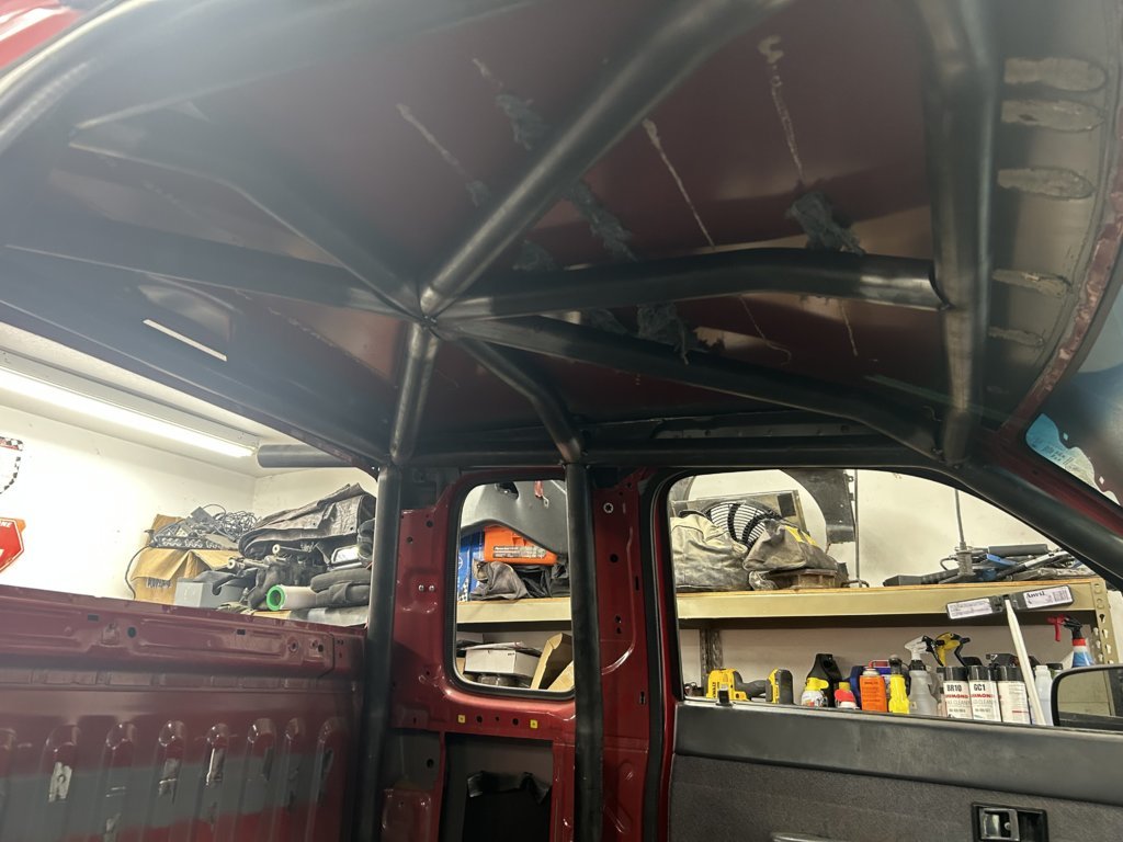

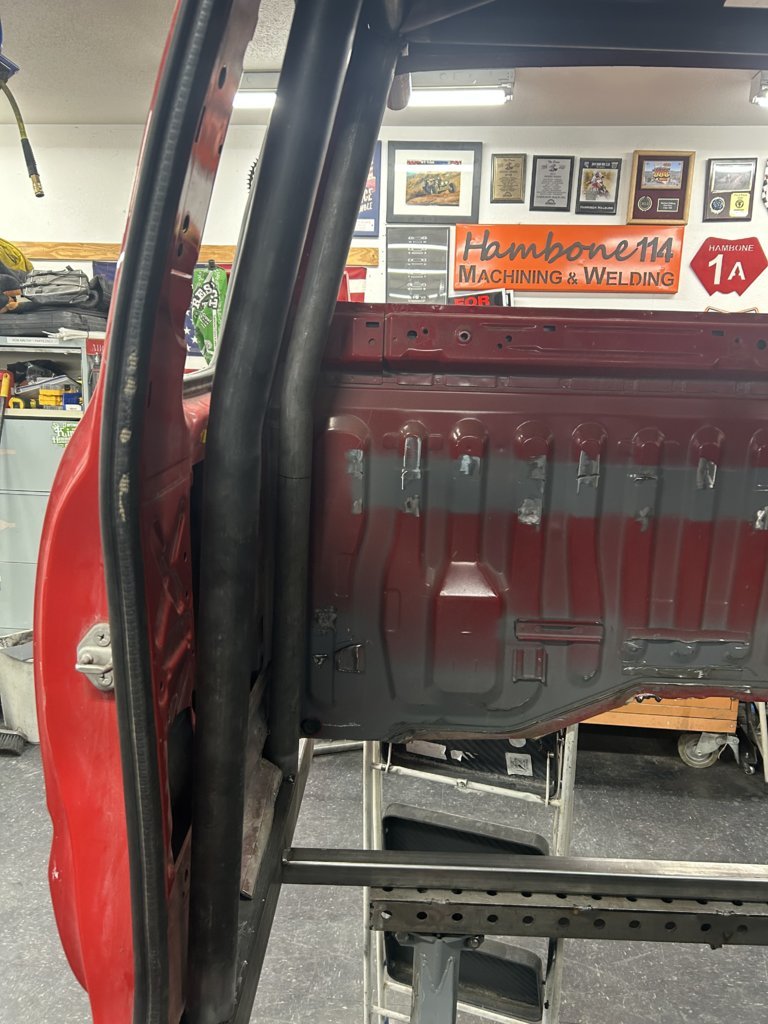

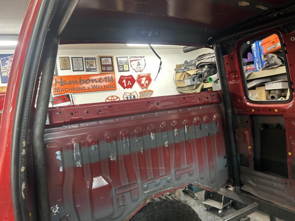

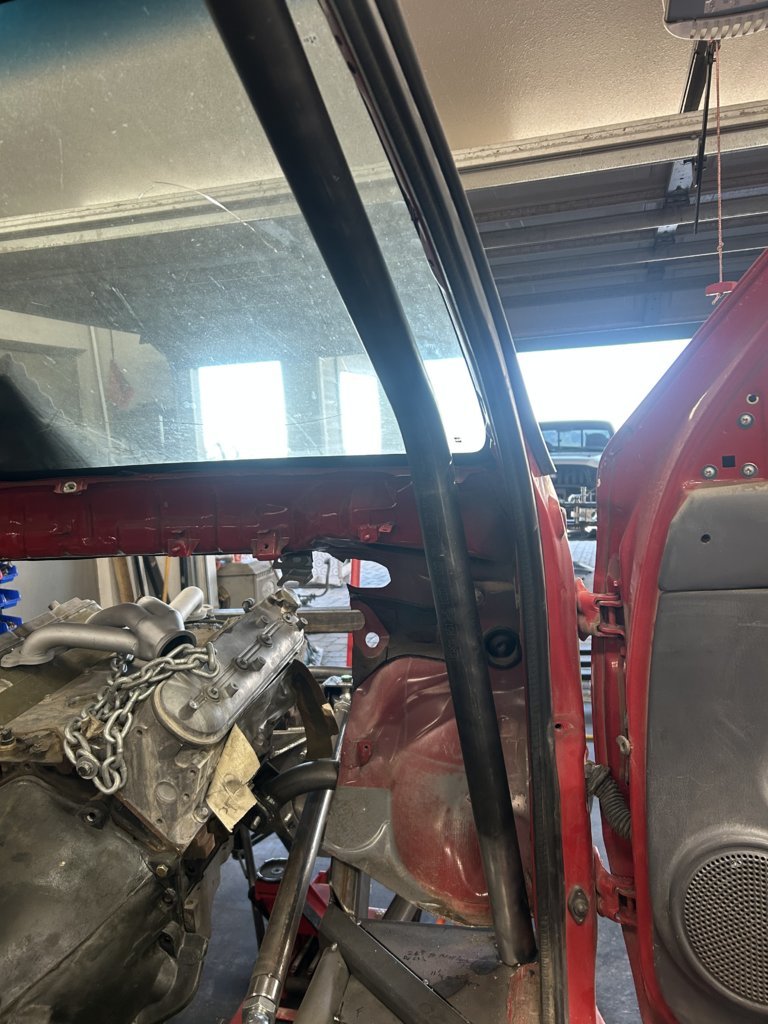

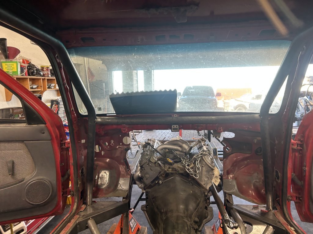

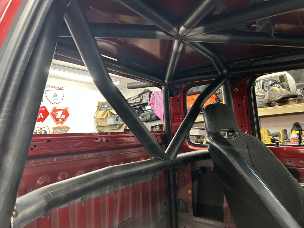

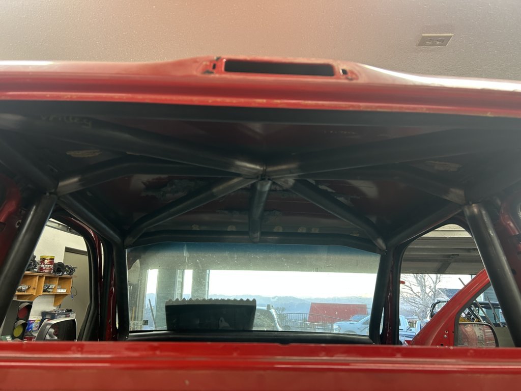

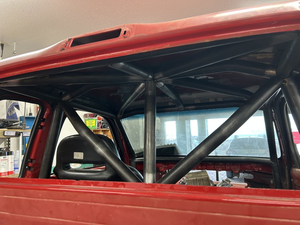

    Picked up more dom and got the c pillar knocked out and made a dash bar. Posted some pictures on Instagram and had a guy message me asking what happened if I swapped the a pillars side to side to minimize the gap between the sheet metal. I ended up doing it and made a big difference. Good chance I got them mixed up when I had them out last so I swapped them and made a big difference. Ended up tacking them back in after swapping them but need to make a new dash bar.
    I think I’m over complicating the cage with to many bends. I have plans probably after the roof and b and c pillars get beat to cut them off and maybe even just run a hood and fenders and bedsides. So to simplify the cage, try to do a flat roof “x” and minimal bends so it doesn’t look goofy with the roof off.

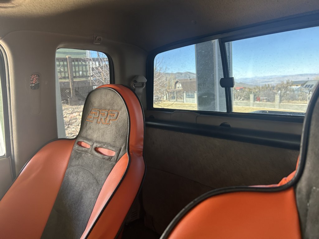

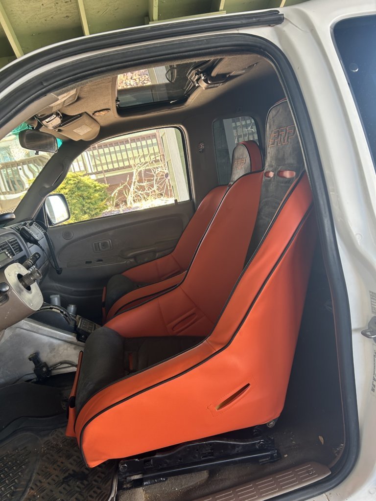

    I also got a set of prp seats my parents got me for Christmas a few years ago installed in the other crawler. Think they turned out good. Just waiting on harnesses. The harness bar is against the rear wall under the window.
    First picture is before. 2nd picture is after.IMG_8770.jpg IMG_8772.jpg IMG_8773.jpg IMG_8775.jpg IMG_8765.jpg IMG_8763.jpg IMG_8767.jpg IMG_8751.jpg

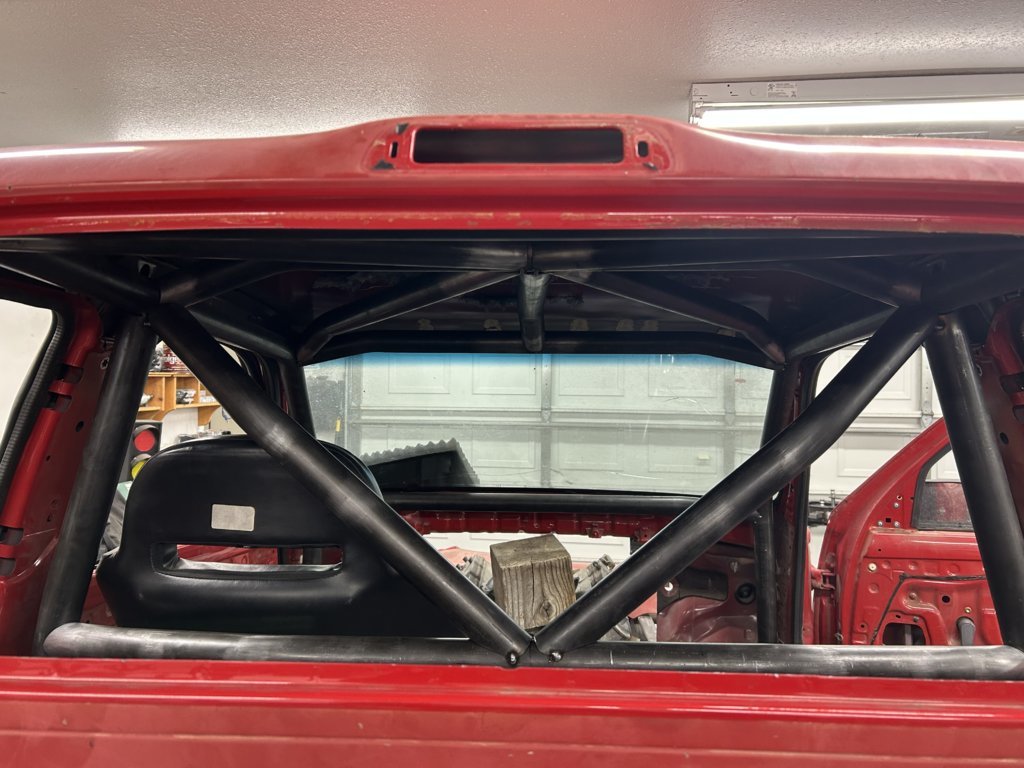

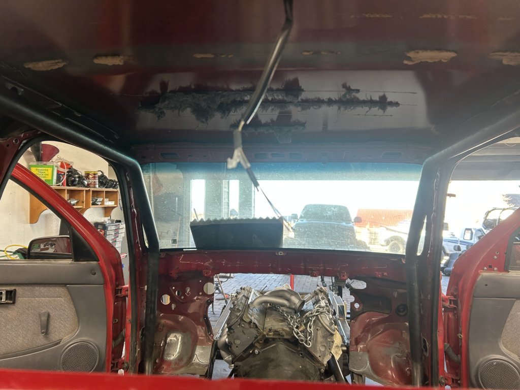

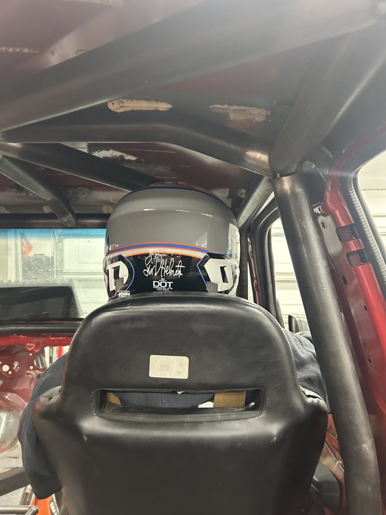

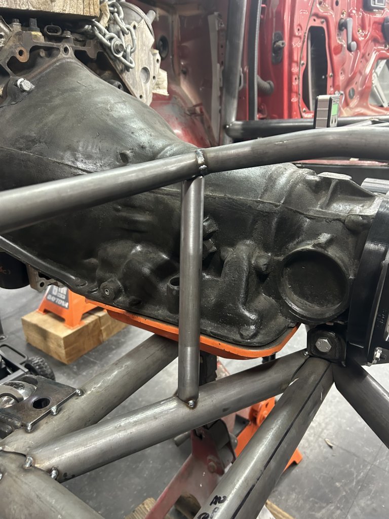

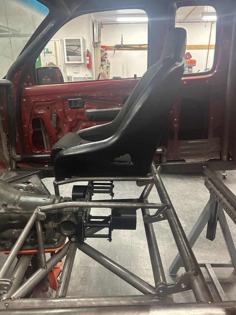

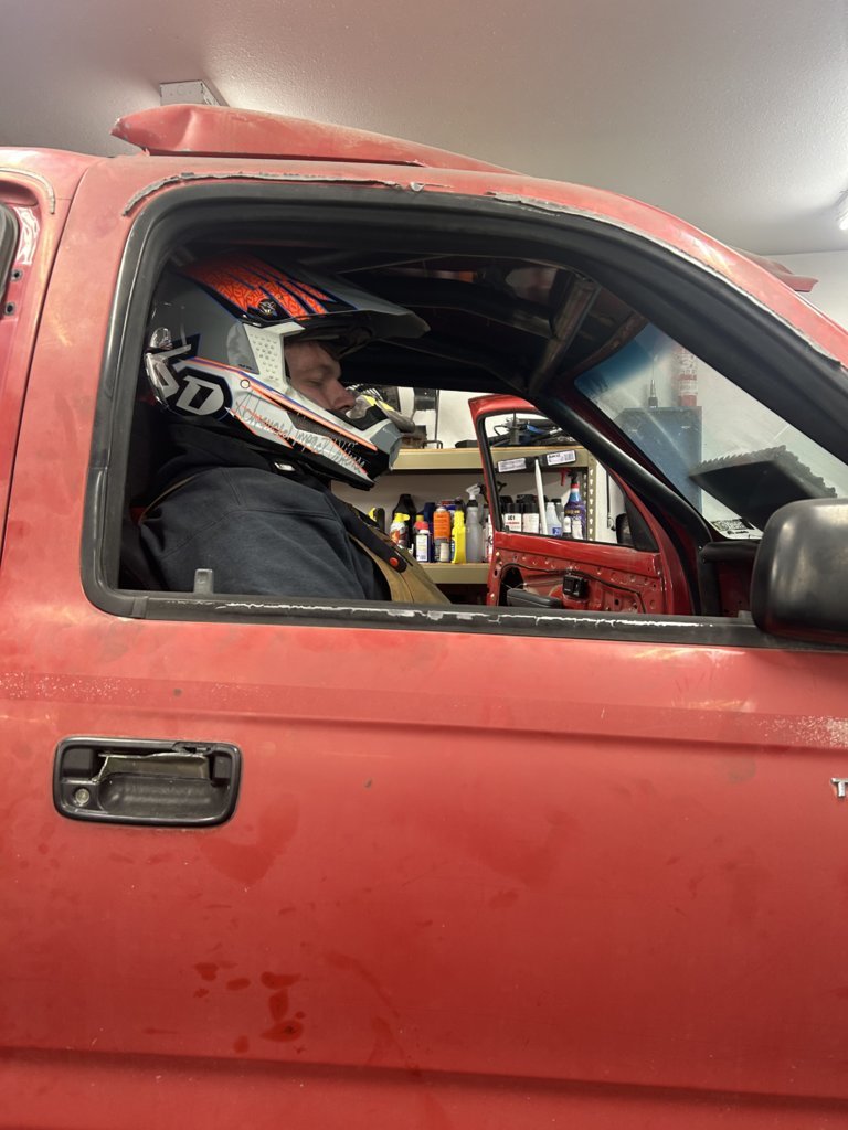

    Spent the last 2 days messing with the cage. Wasn’t planning to add as many bends to the roof bars but it was needed to get the headroom and still be able to see. Still need to do one more bar down the middle in the back and the intrusion bars but I’ll wait till I screw up something and have some waste.
    Next I want to get the seats mounted so I can do the b pillar. Plan is to run a bar between the an and b pillar and then run some tubes towards the trans but stop them short with some supports off the subframe. The trans needs to come out of the door so trying to make it easy ish to get out. Was originally going run tubes over the trans and atlas but my dad suggested just stopping them short.
    Also ordered rhe shocks.. think I’ll order a rear housing so I can start on that while I wait for the shocks.IMG_8870.jpg IMG_8871.jpg IMG_8872.jpg IMG_8873.jpg 57D4327C-2574-4E88-BCB8-5F692A083D49.jpg IMG_8869.jpg IMG_8867.jpg

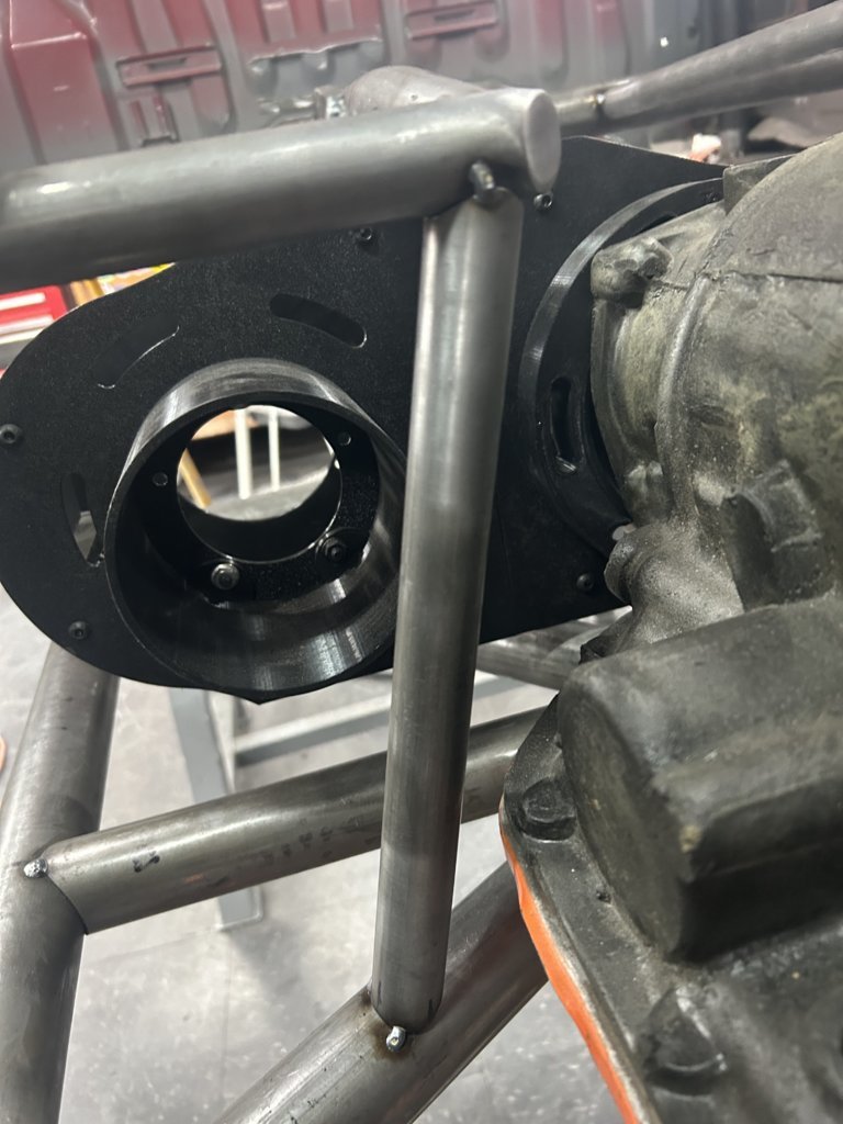

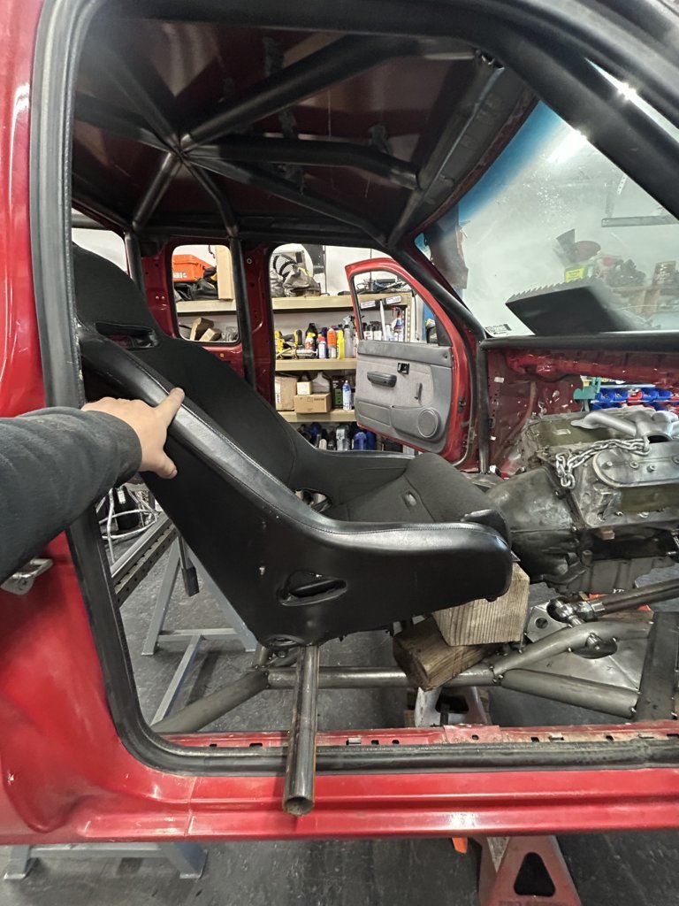

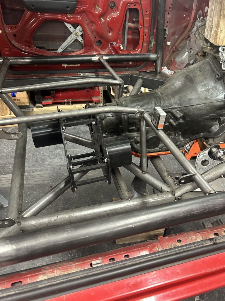

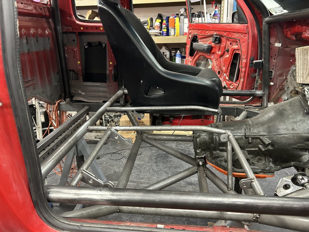

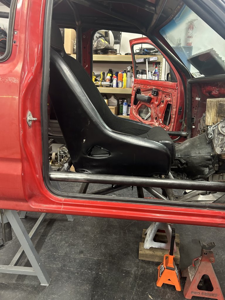

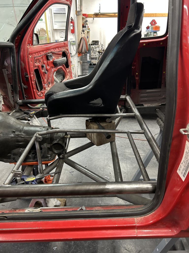

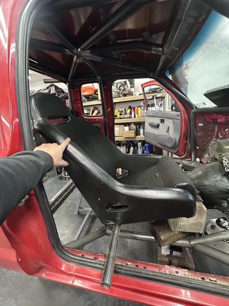

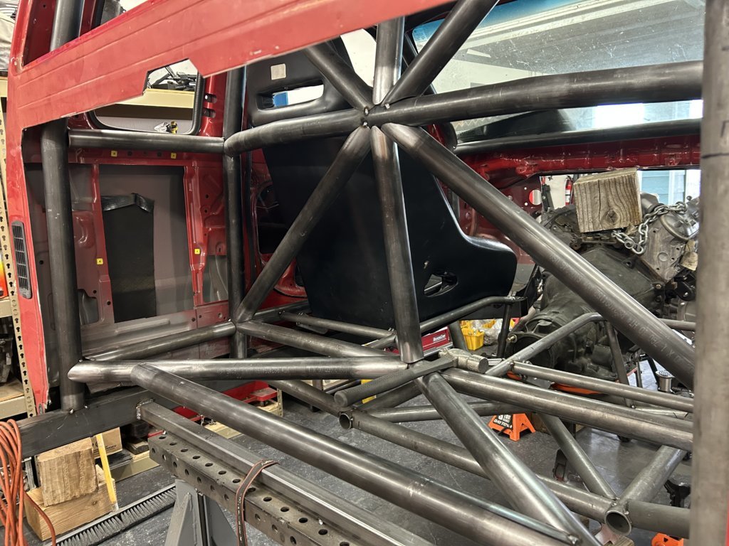

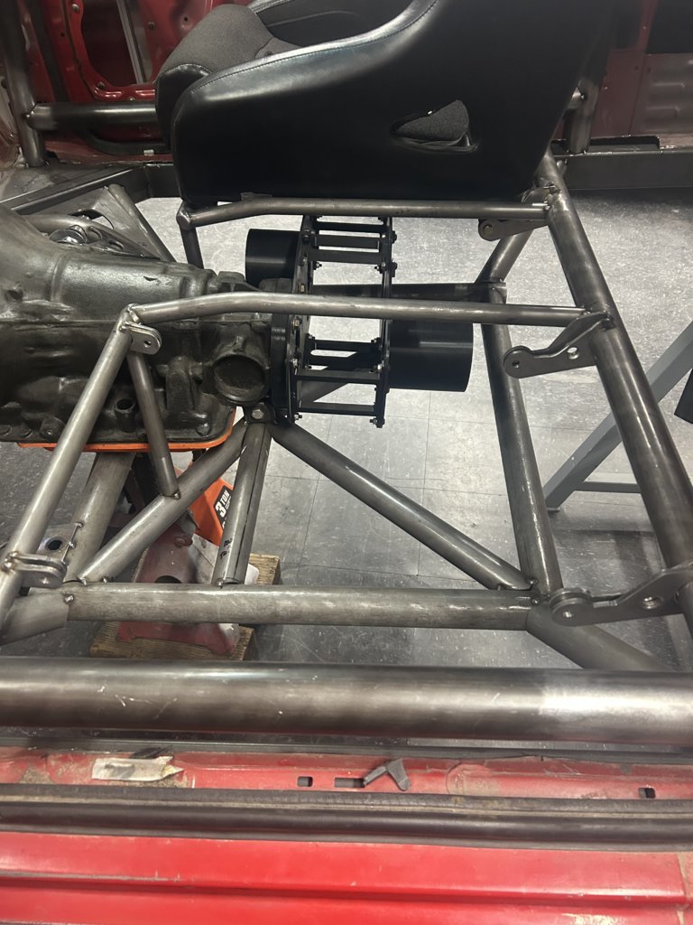

    Seat mounts have been kicking my ass. Sadly this took me two days and still not done. Trying to find something functional, looks good and allows my head to clear the cage has been a challenge but think I finally got it. Literally as low as they can go with the atlas. Should have maybe lowered the subframe some more but it’s done.IMG_8935.jpg IMG_8938.jpg IMG_8941.jpg IMG_8943.jpg IMG_8942.jpg IMG_8947.jpg IMG_8945.jpg IMG_8950.jpg IMG_8952.jpg IMG_8954.jpg IMG_8959.jpg

    Got the driver seat mounts in and adjusted the passenger a little more. Started making the harness bar till the hole saw stripped out on the arbor of the notcher so called it a night. Short day but happy to have the seats hopefully done.IMG_8961.jpg IMG_8962.jpg IMG_8963.jpg IMG_8964.jpg IMG_8965.jpg

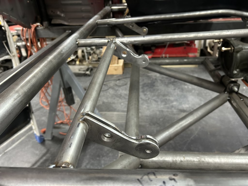

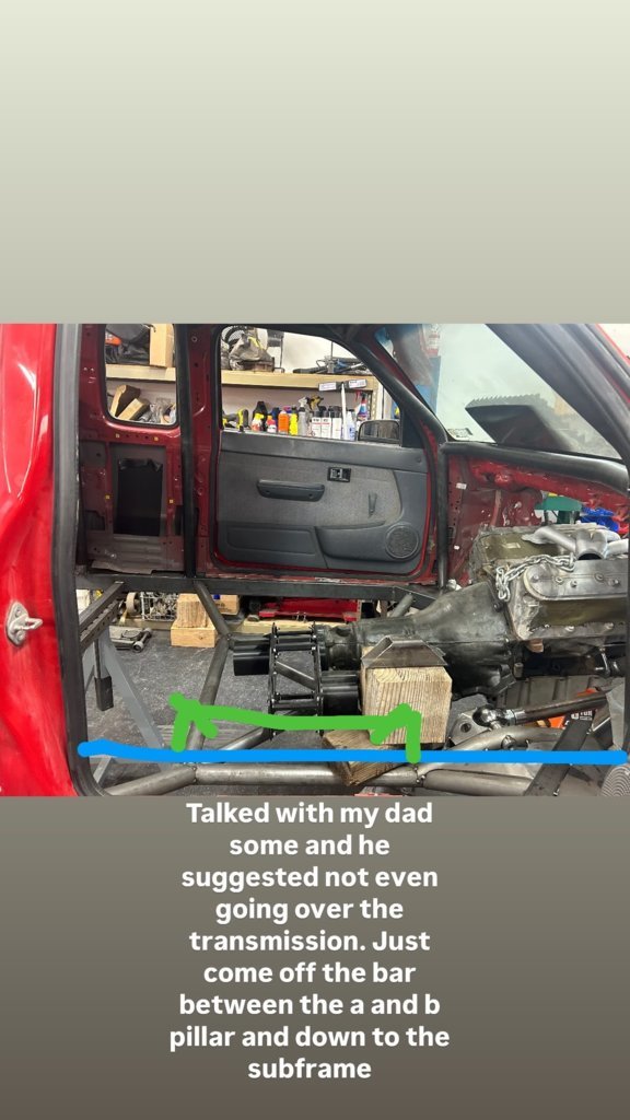

    Redid the seat mounts after a suggestion on irate
    Alright redid the seat mounts again. Got them a little lower by another inch or so and moved the one bar between the b pillar. So the entire seat mount is out of 1x.120 wall dom and 3/16 tabs. Between the seat cushion settling some (I’ve been told it’ll settle between 2-3”) and the harnesses pulling you into the seat. Should be more than enough room. Not really interested in going to composite Seats for now.IMG_8992.jpg IMG_8994.jpg IMG_8995.jpg IMG_8996.jpg

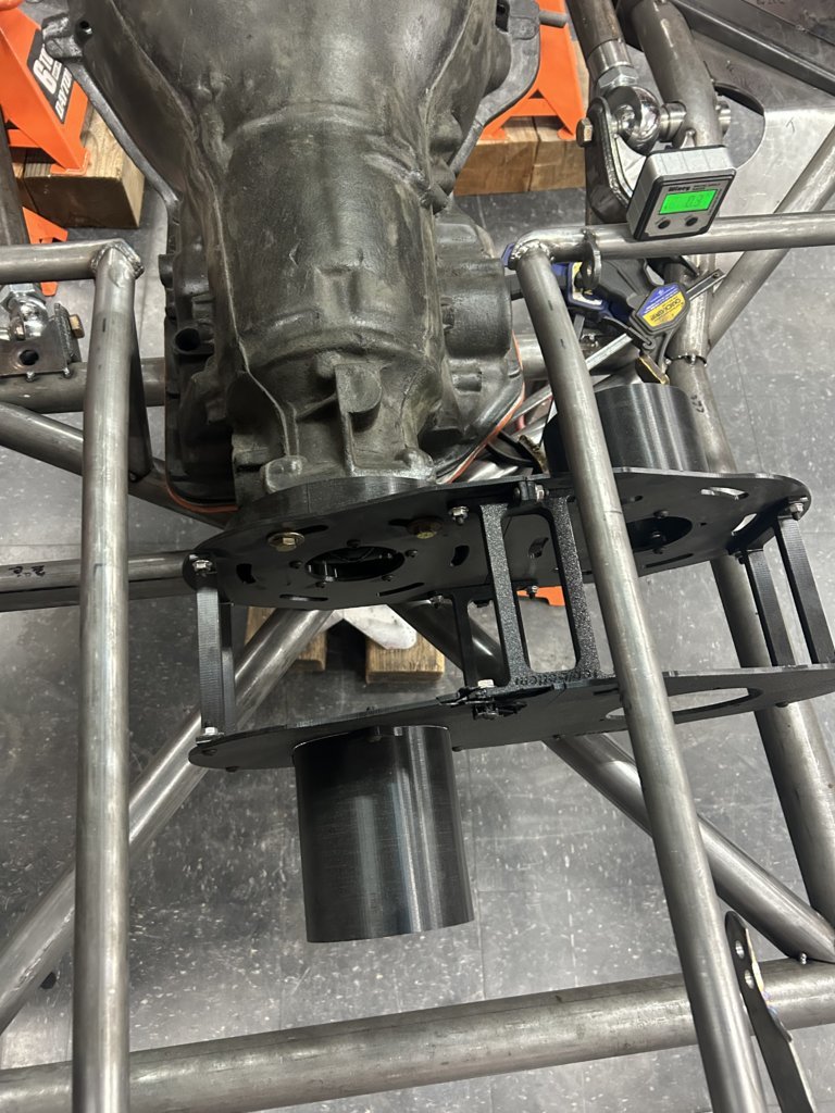

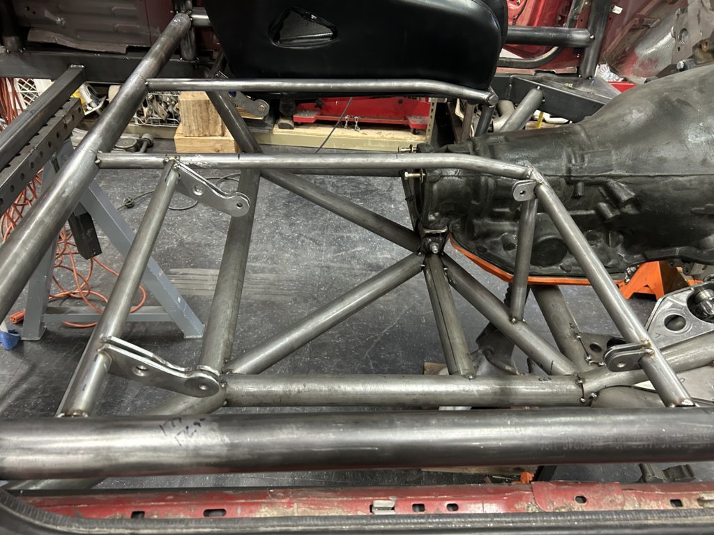

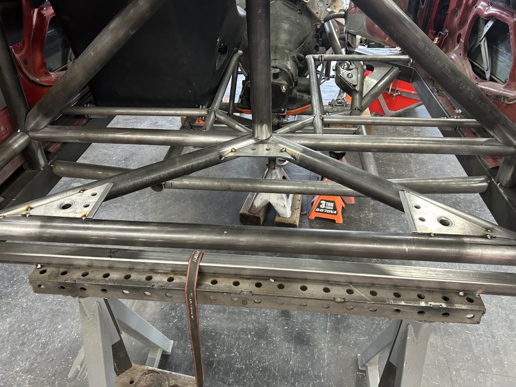

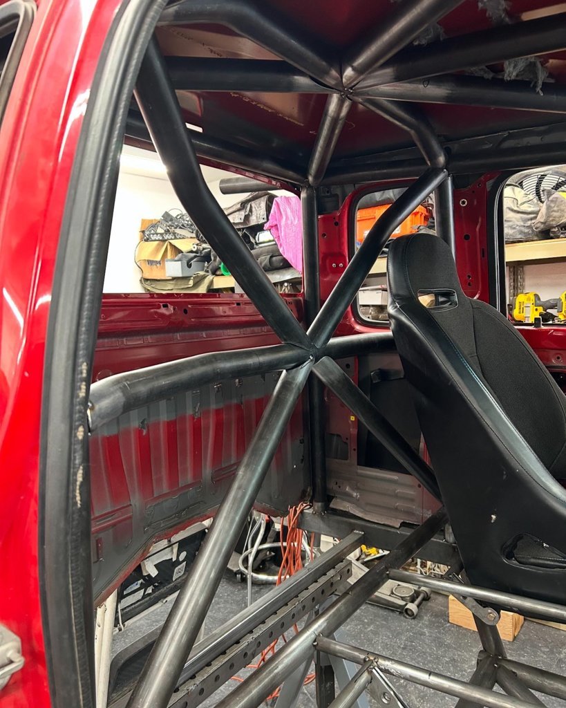

    Then messed with starting on the b pillar x. Was able to salvage the original cross bar I made by adding another 15 degree bend on each side. It probably only needed 10-12 degrees but the extra between the seat and bar will make getting to harnesses and any bags I put between easier. I got the top two bars of the x in as well. They look close but are no where near your head. Even if you got whiplash, your head won’t hit the bars because of the head rest. I may order the seats with +2 in height to just get the head rest a little higher. Pretty much copied this Cherokee build for the b pillarIMG_8999.jpg IMG_9001.jpg IMG_9004.jpg IMG_9005.jpg IMG_9007.jpg IMG_9002.png

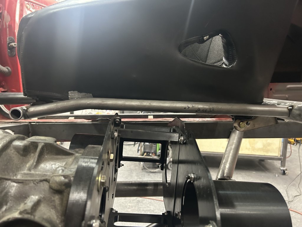

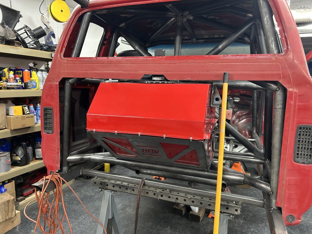

    Only made it outside for an hour or two and got the rest of the x knocked out. Pretty happy. Took measurements to make a file for the fuel cell to get That mounted next.2EAA5A4F-736B-4C64-98EC-6A6C86638C0F.jpg

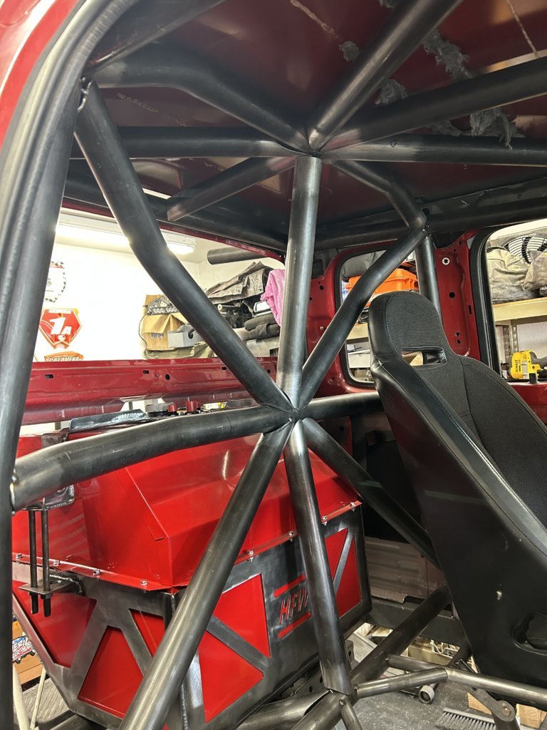

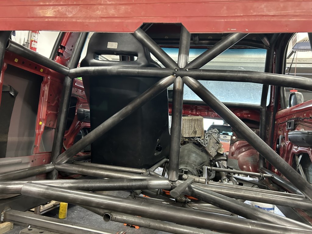

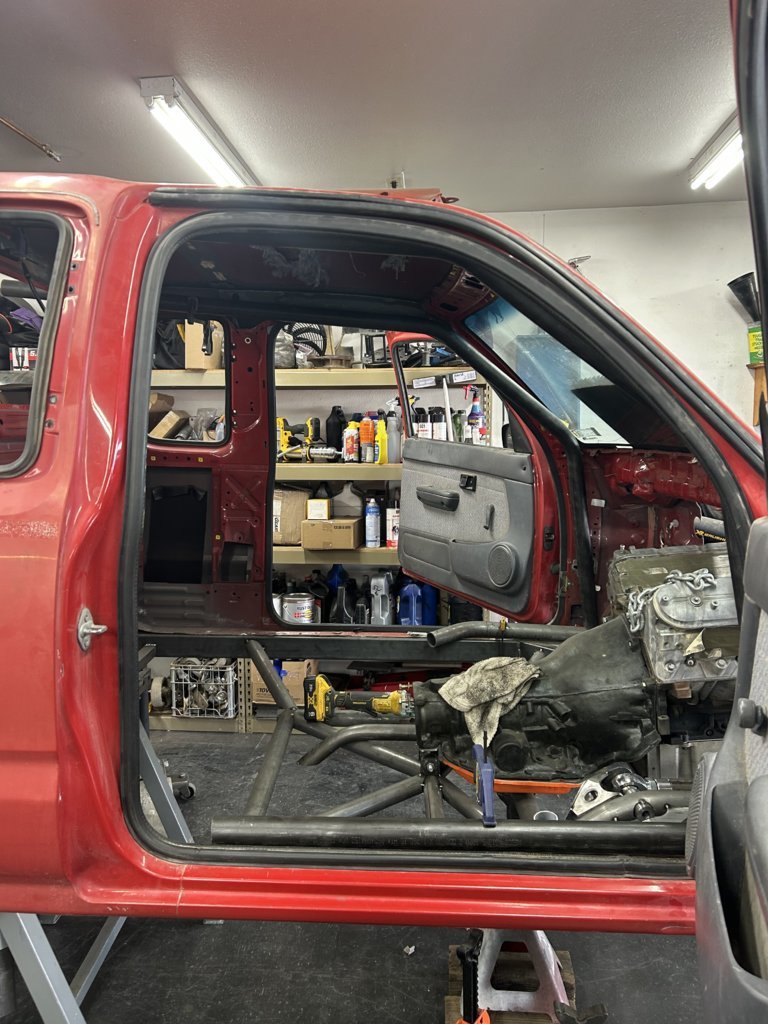

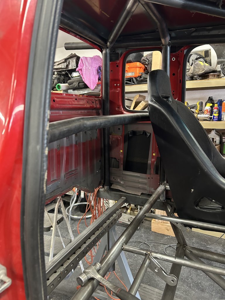

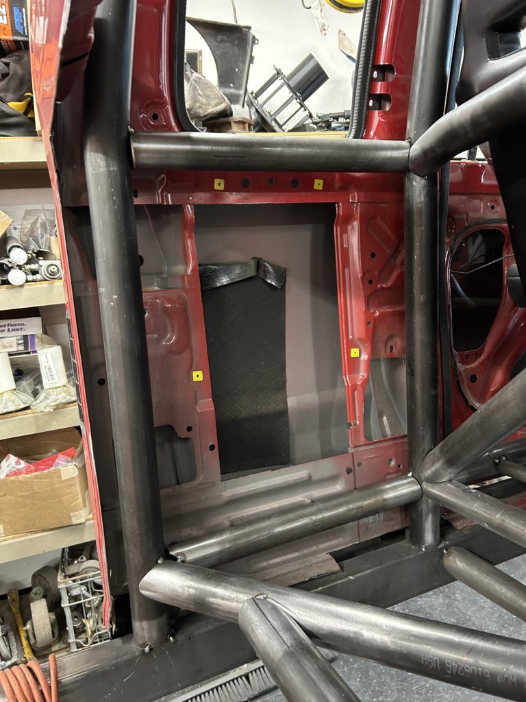

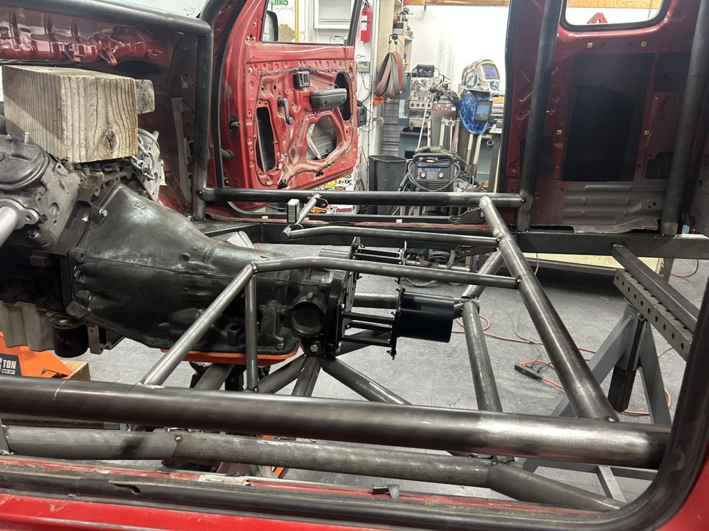

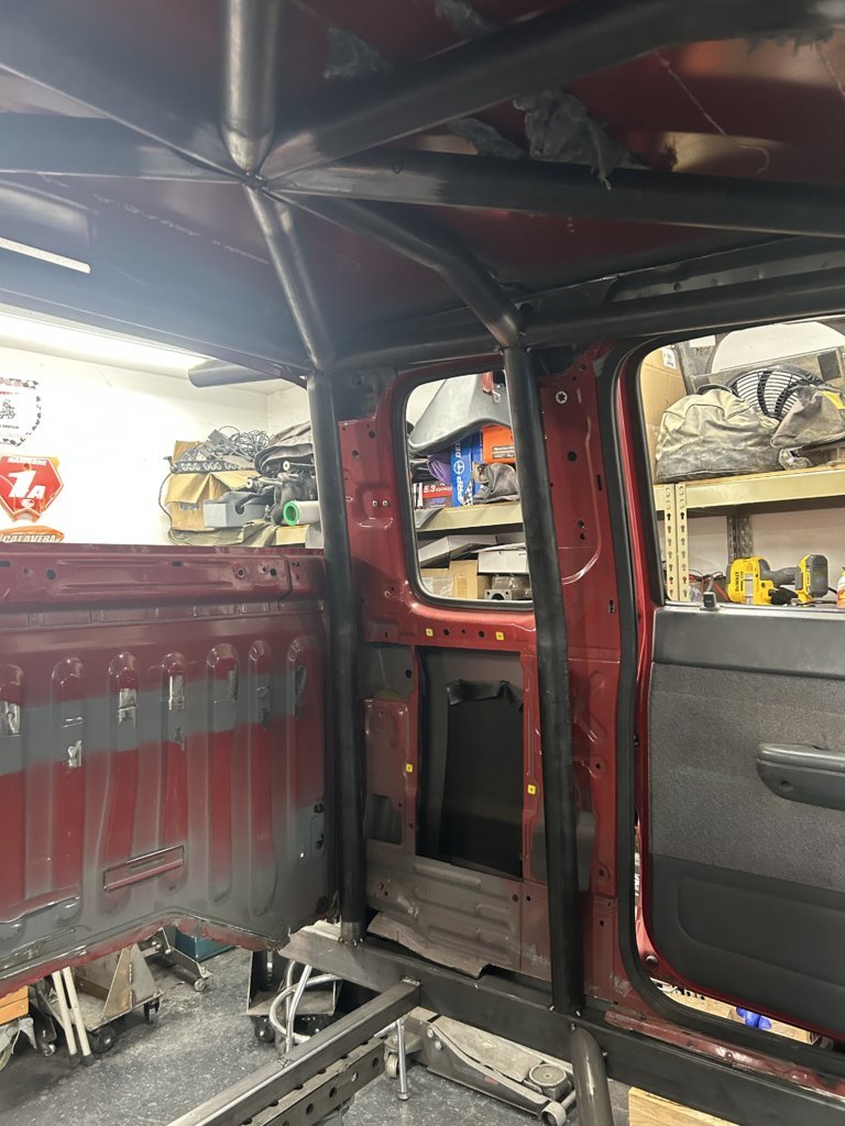

    Got most the passenger compartment cage done minus the intrusion bars and door bars. Pretty happy with it.
    I ran out of tubing so the bracing between b and c pillar still needs done as well. But that’s 3 more short ish tubesIMG_9100.jpg IMG_9107.jpg IMG_9109.jpg IMG_9105.jpg IMG_9104.jpg IMG_9106.jpg

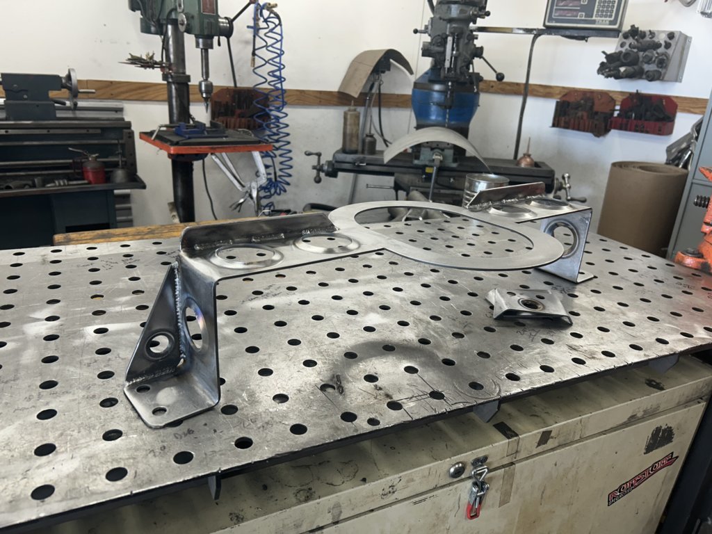

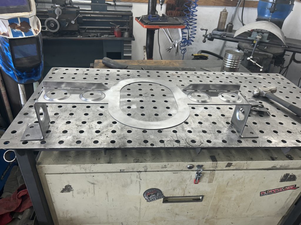

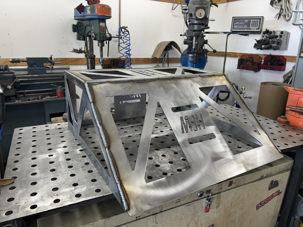

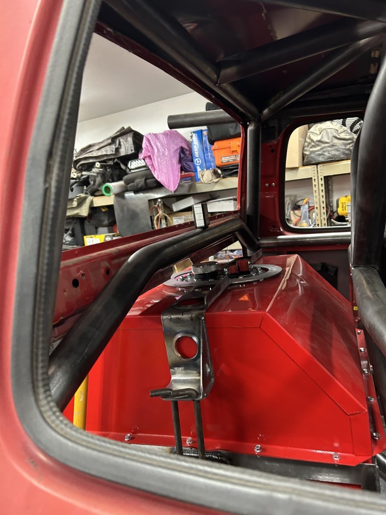

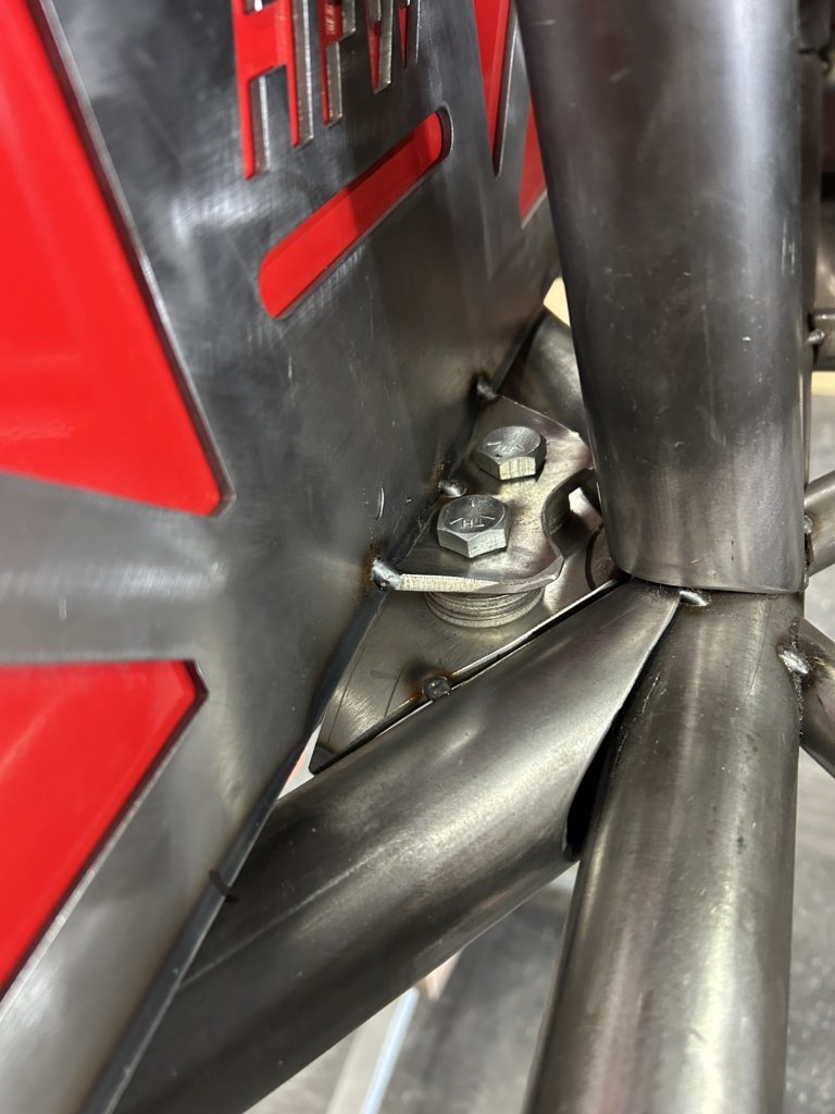

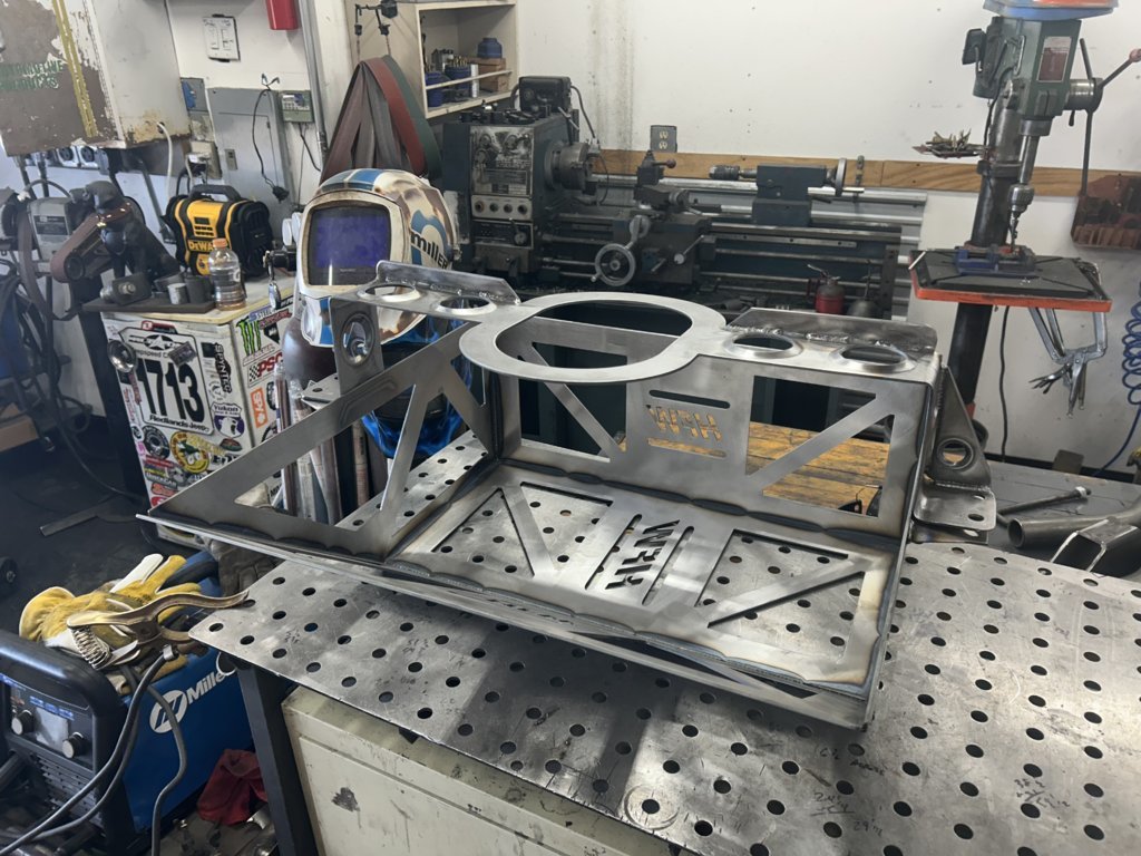

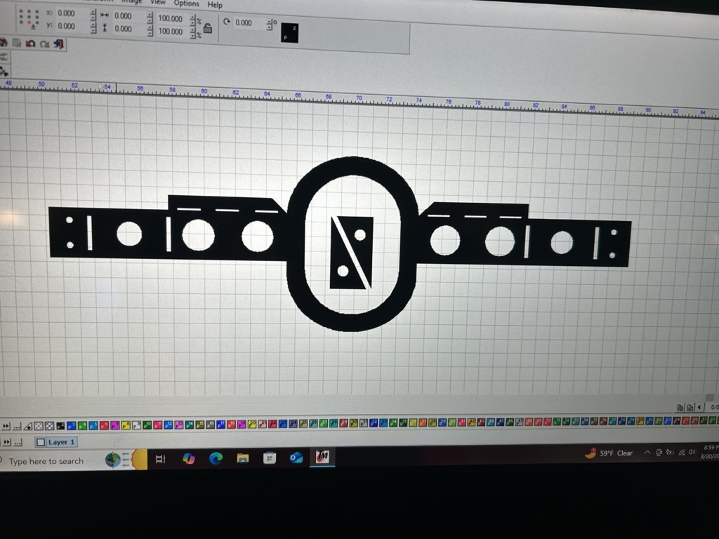

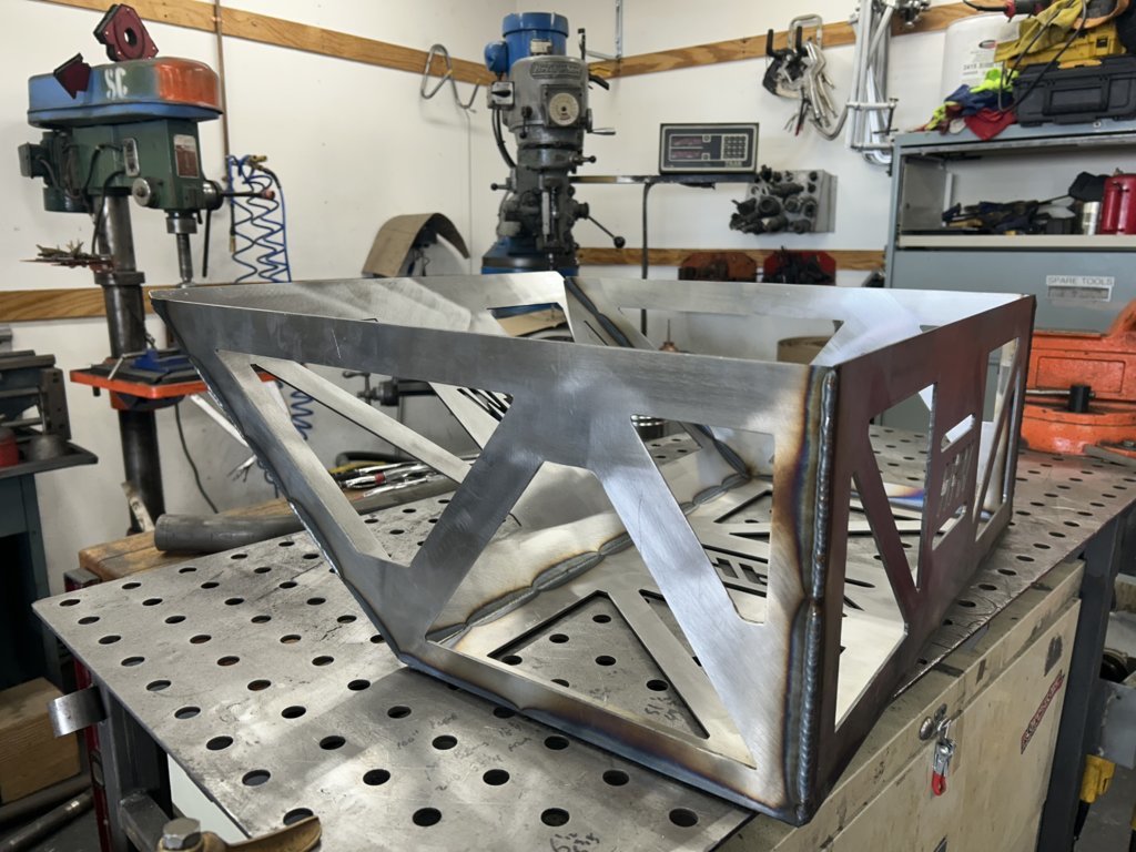

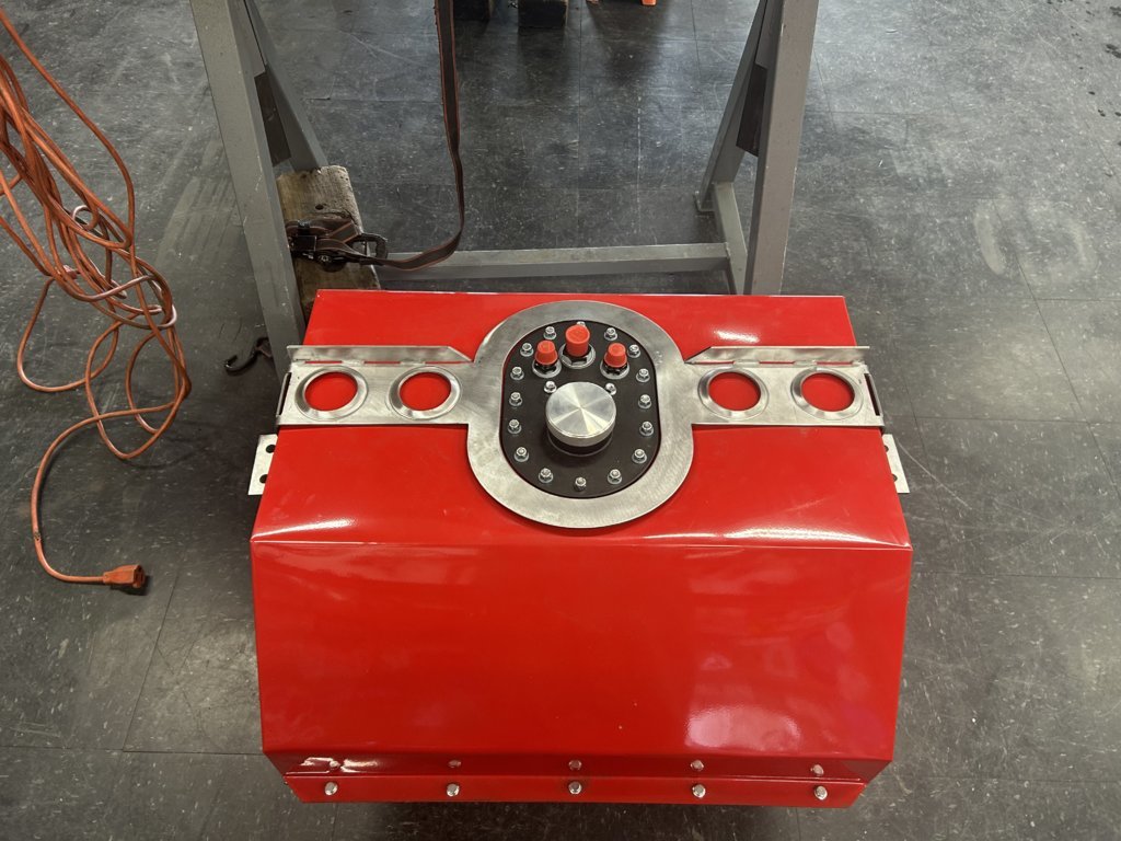

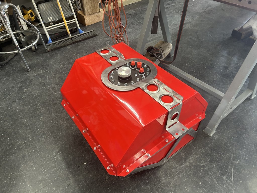

    I also worked on the fuel cell and am extremely stoked on how it came out. Drew it all in 2d cad and cut it all correctly the first time and with no screw ups from the cnc. Never would have thought I would be able to make something like this.IMG_9051.jpg IMG_9052.jpg IMG_9082.jpg IMG_9081.jpg IMG_9083.jpg IMG_9084.jpg IMG_9086.jpg IMG_9093.jpg IMG_9097.jpg IMG_9110.jpg

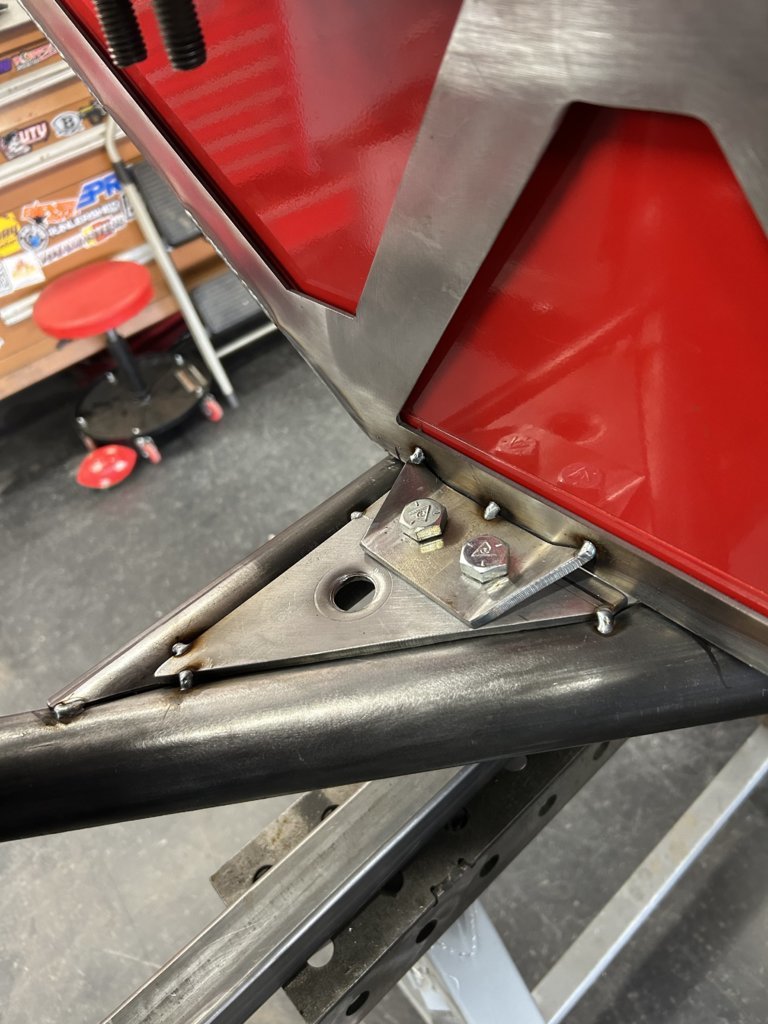

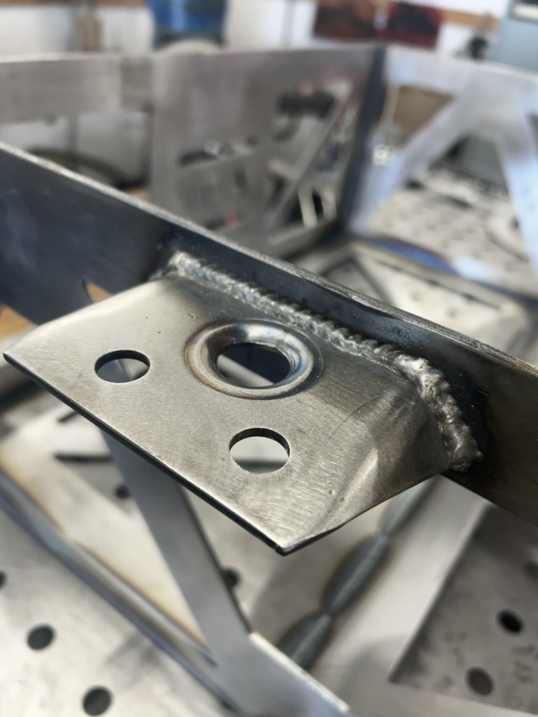

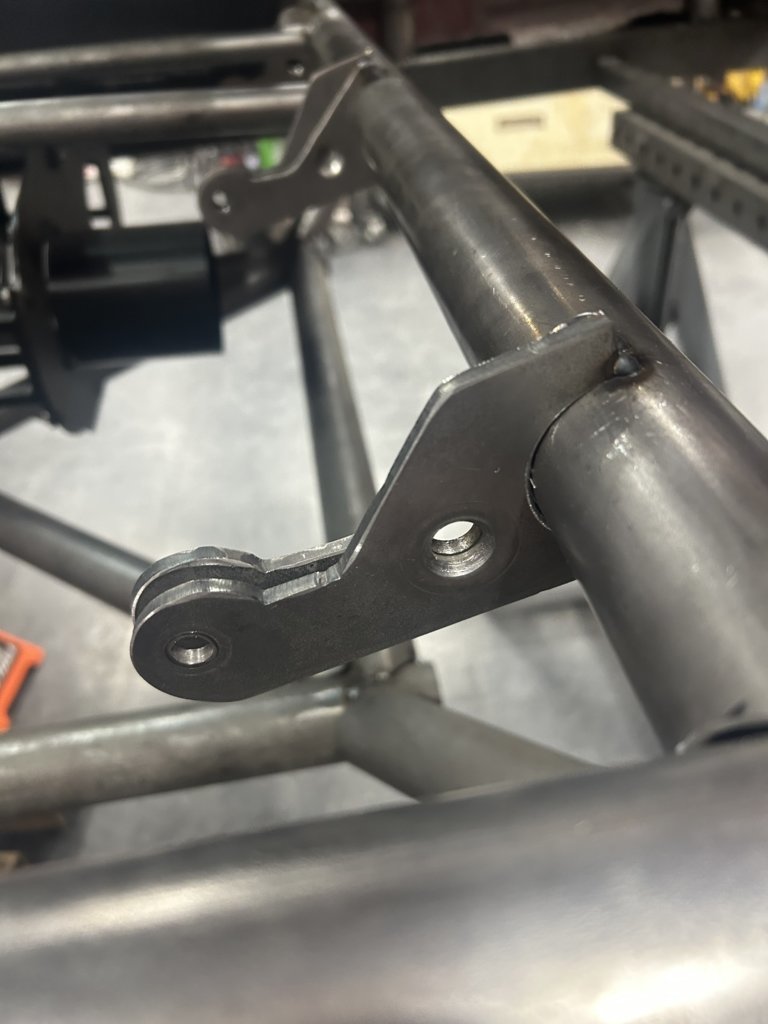

    Tons of parts on order and should start coming in next week or the week after. Just been focused up on finishing some stuff I left half done.

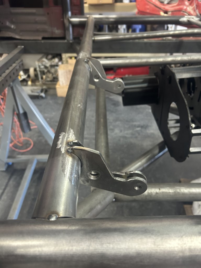

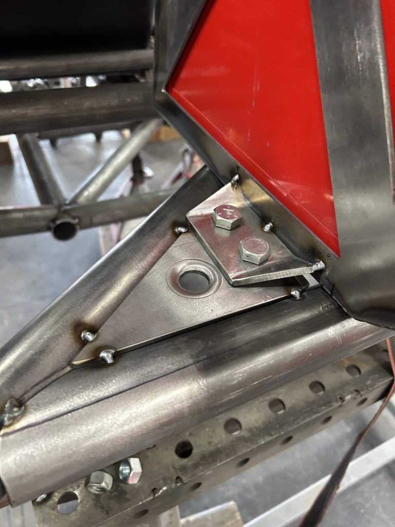

    Fuel cell tabs. May do something off the top but I’ll wait to see if they’re needed.IMG_9141.jpg IMG_9142.jpg IMG_9143.jpg IMG_9145.jpg
