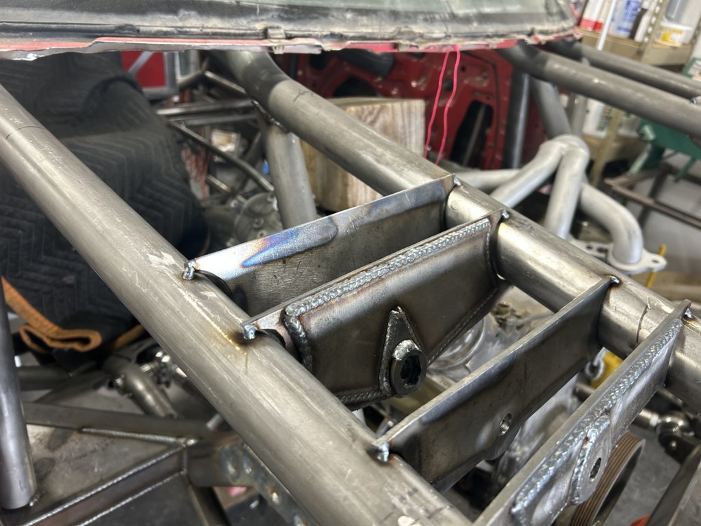

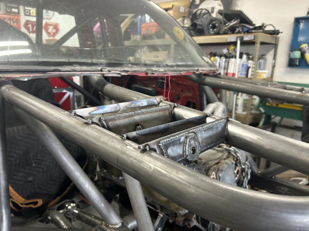

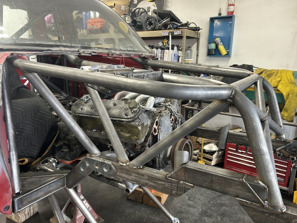

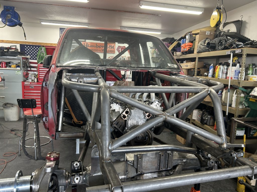

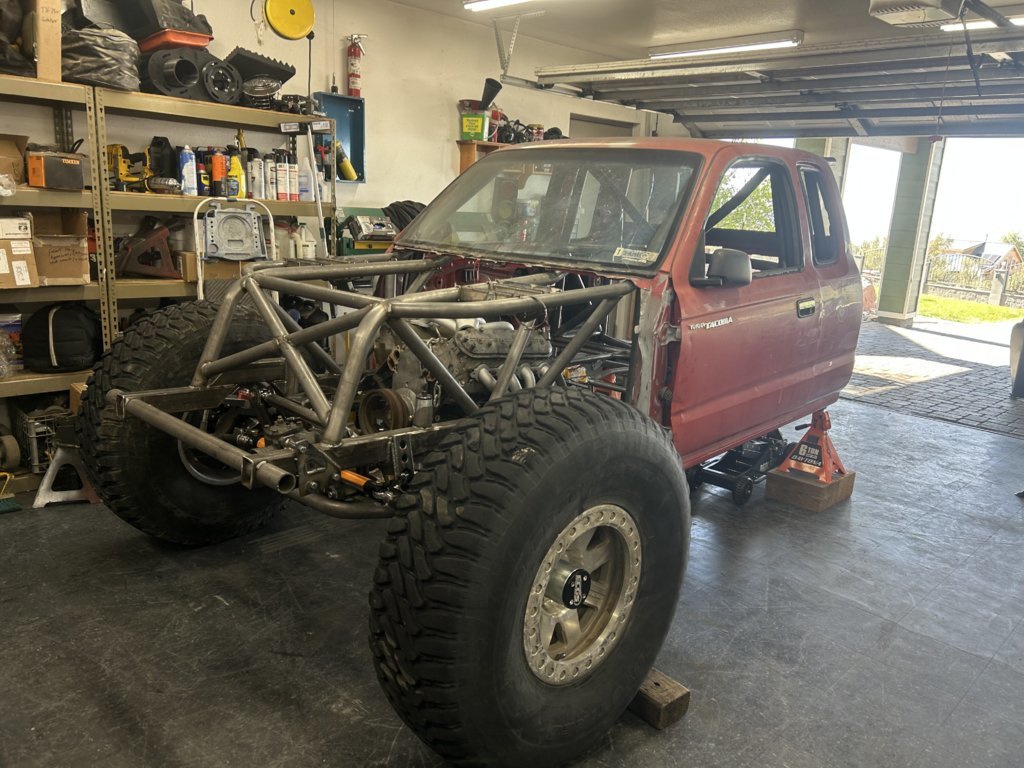

    Awesome looking subframe. Came together well.

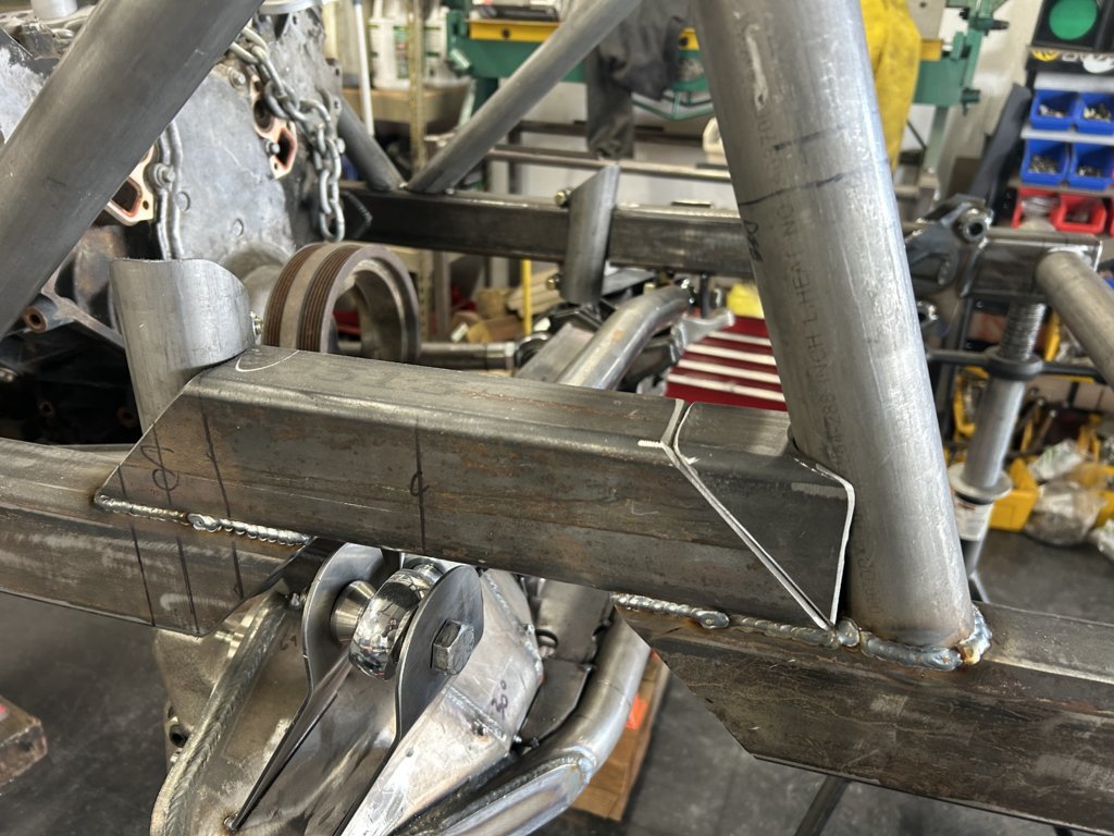

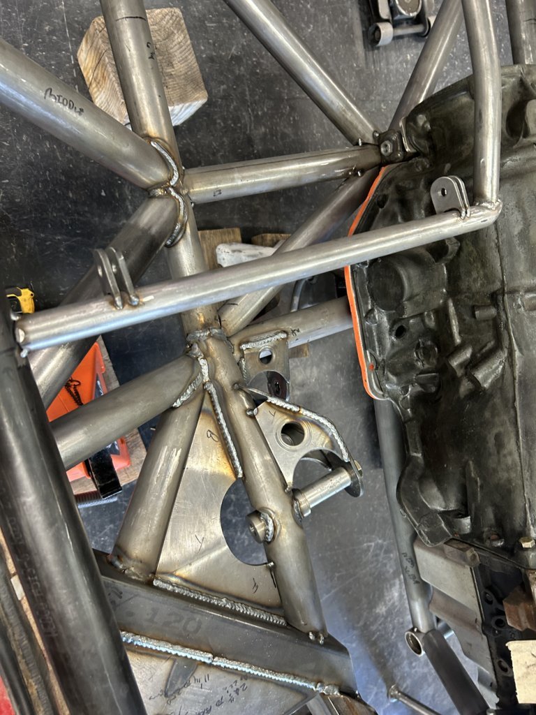

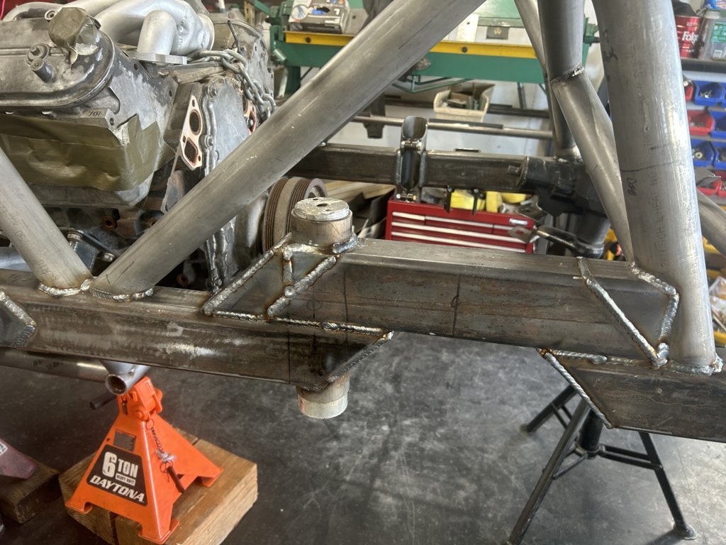

    Are you going to do any additional gusseting or bracing for the frame tie-in tubes that the motor is mounted to?

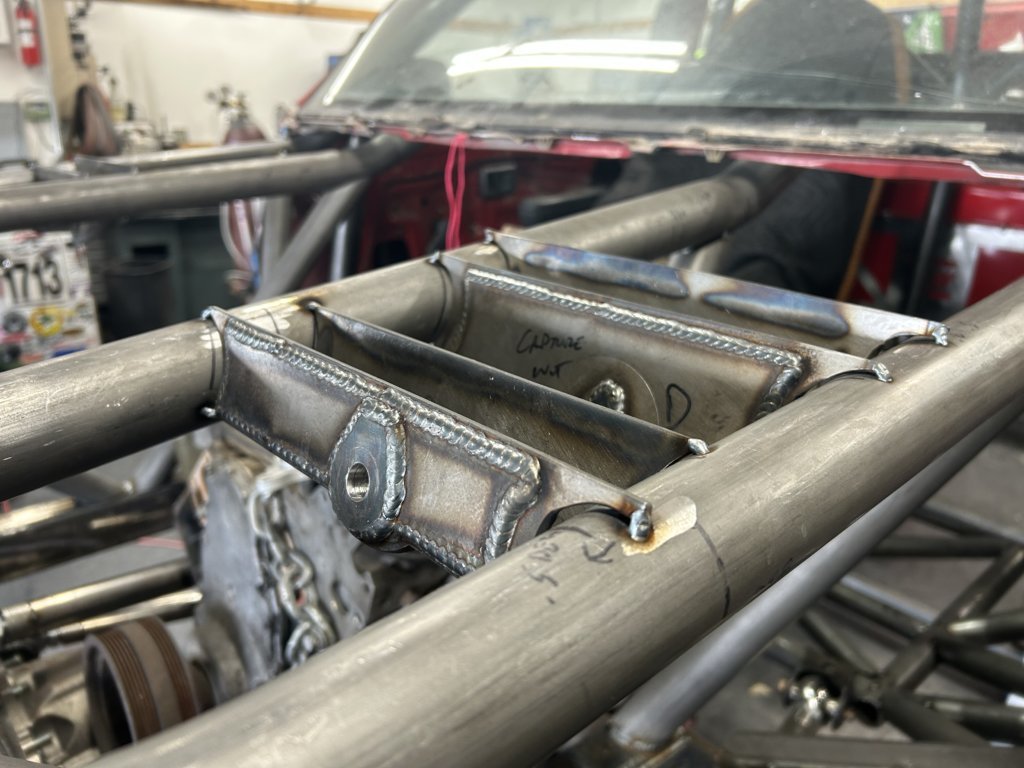

    Possibly. There’s not a ton of room around the motor mounts. One of the tubes off the engine cage lands onto the rectangle tube inline with the motor mount so maybe I’ll add a gusset between the two but need to get a set of headers that first. I’m all ears for ideas though

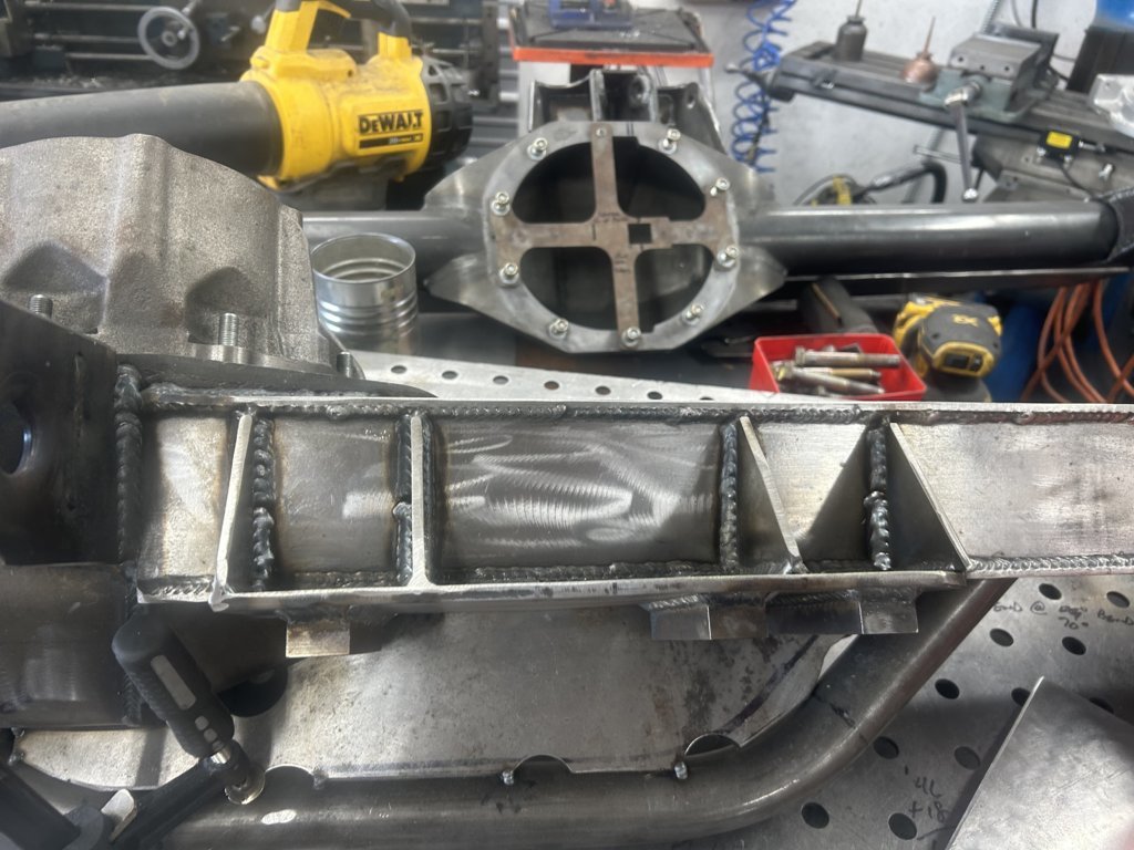

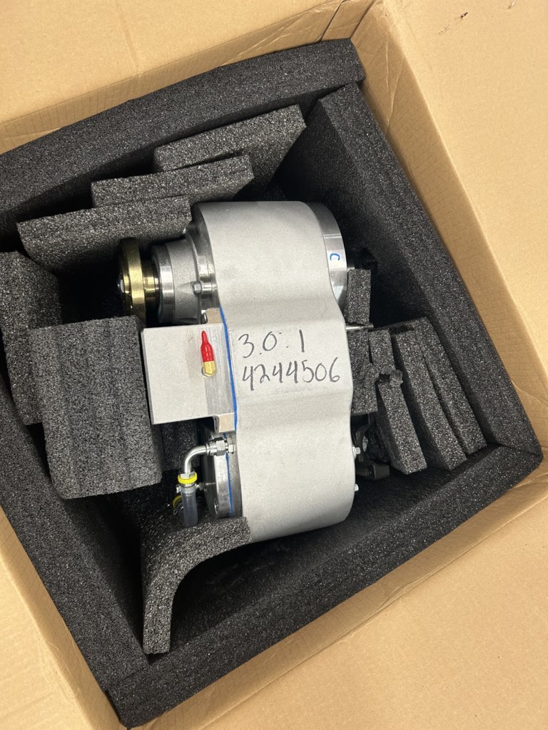

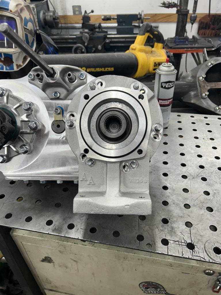

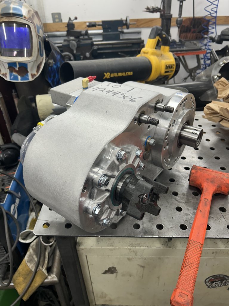

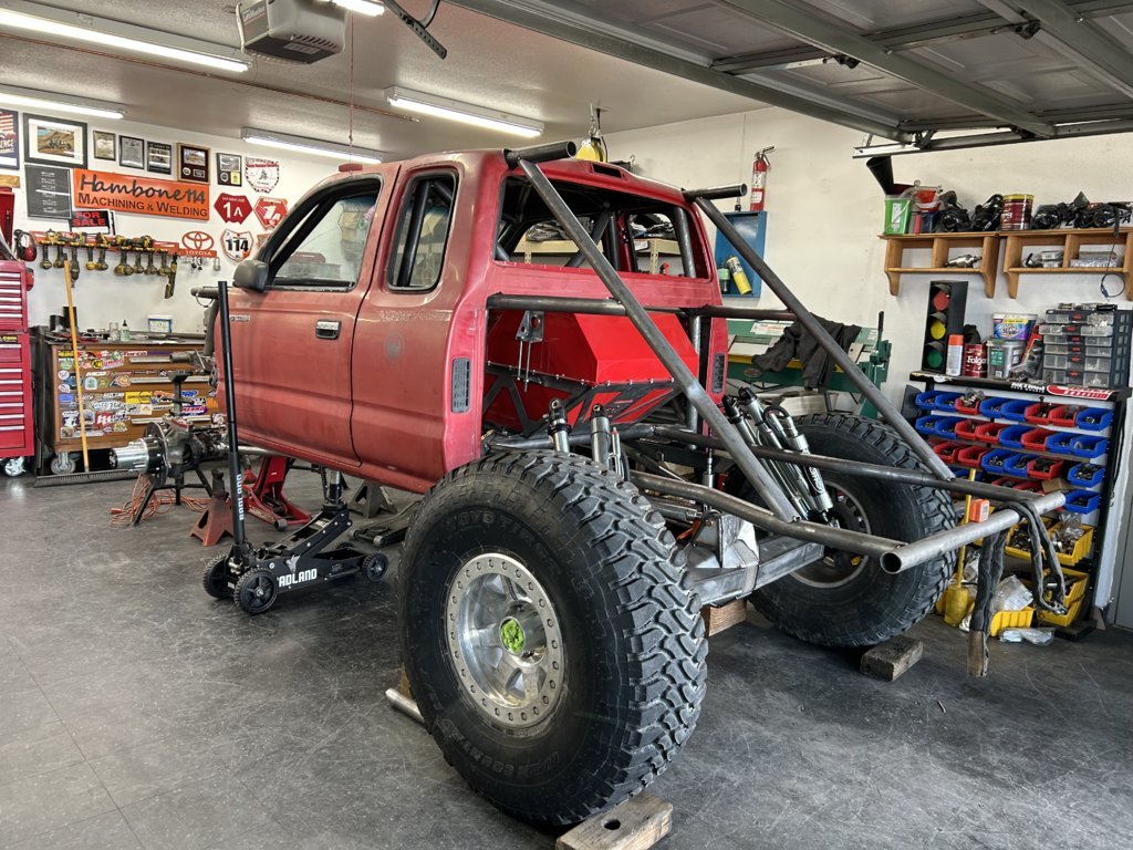

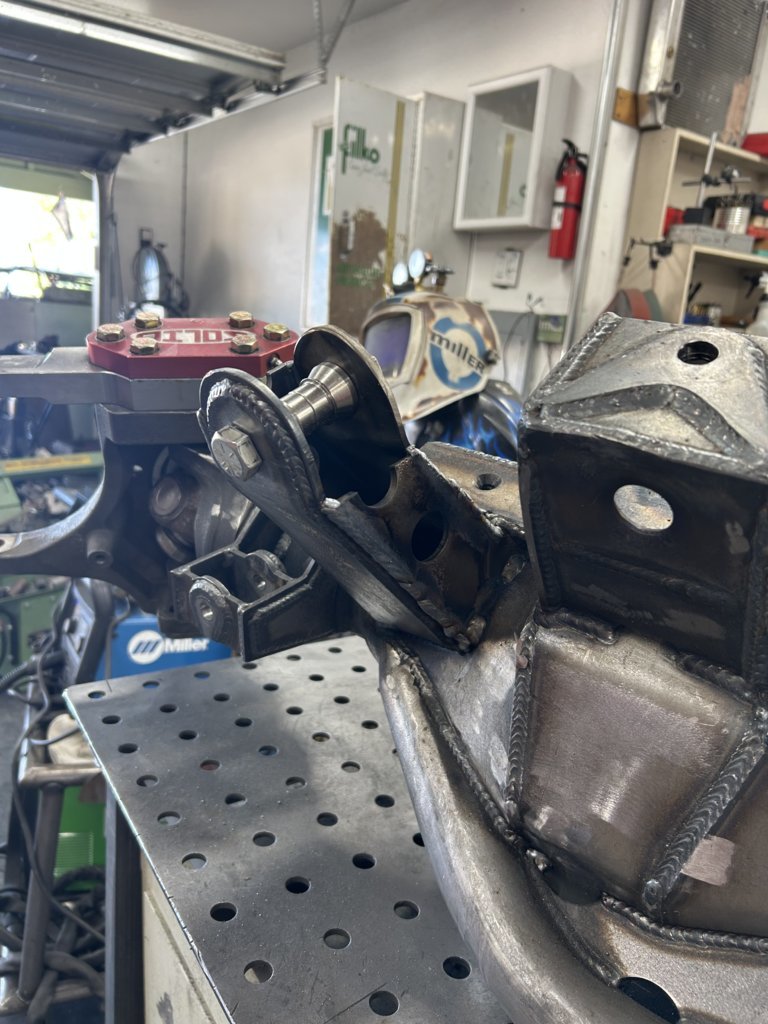

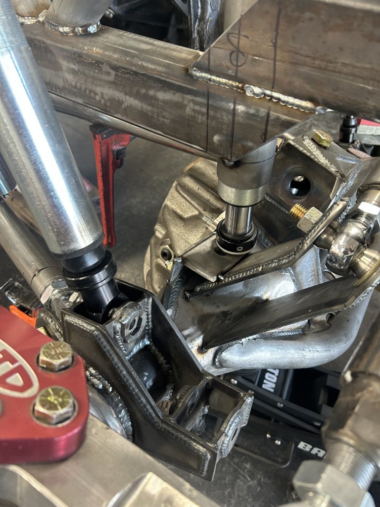

    Atlas showed up with the adapter. Adapter bottom needs trimmed to clear the subframe so I’ll throw it in the mill and take some off.IMG_9395.jpg IMG_9397.jpg IMG_9396.jpg

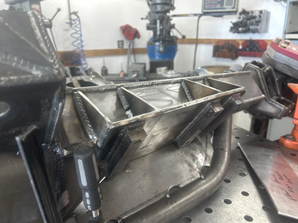

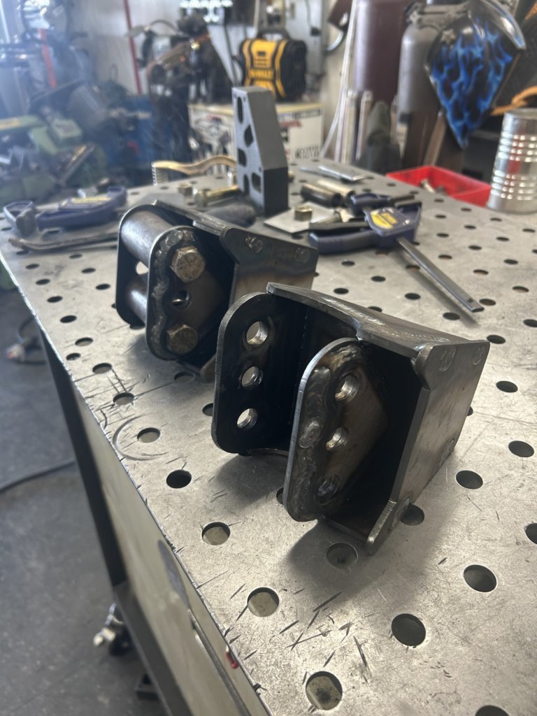

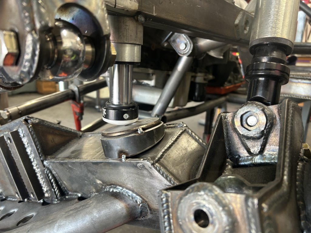

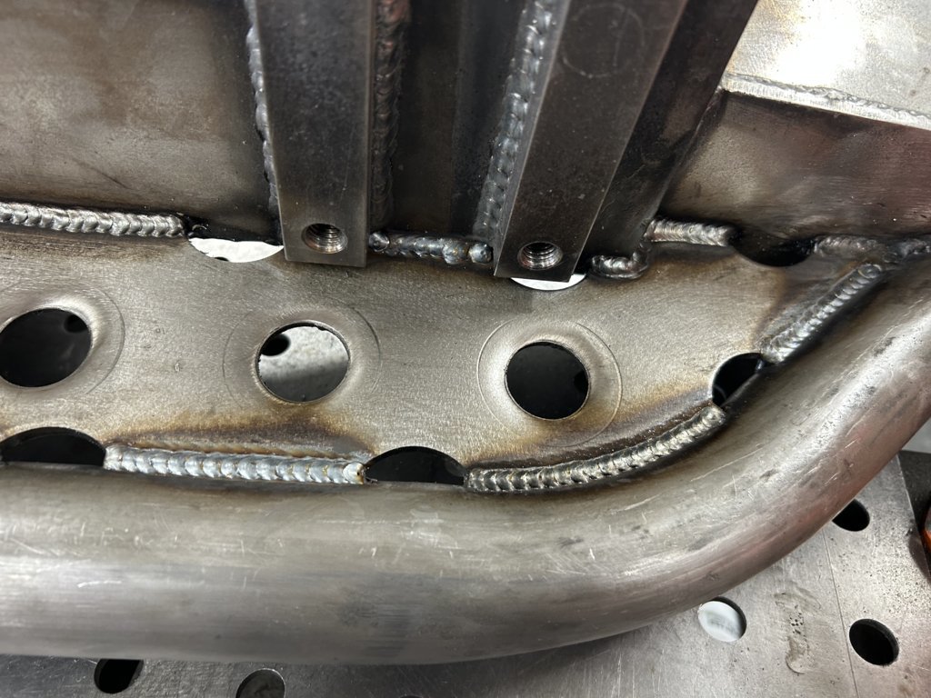

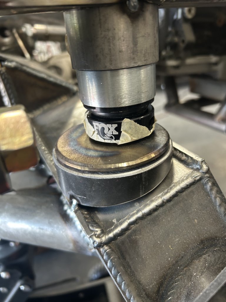

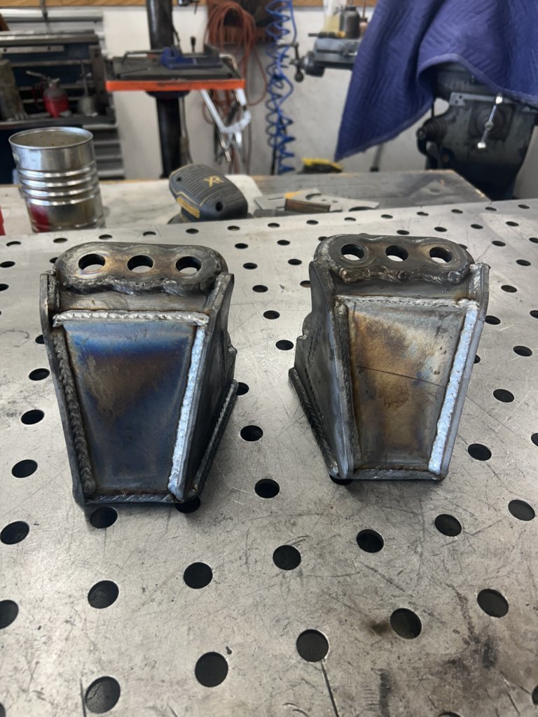

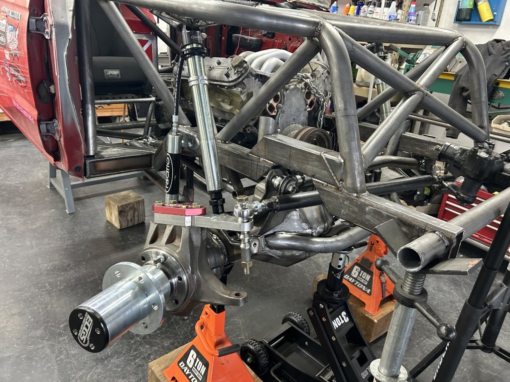

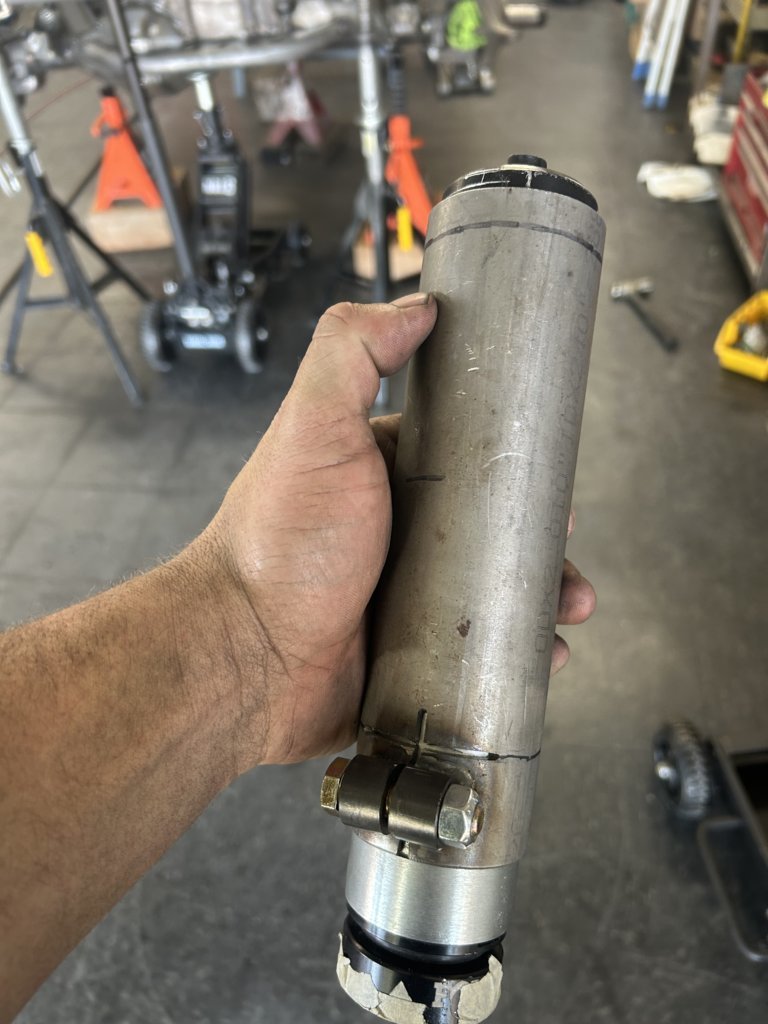

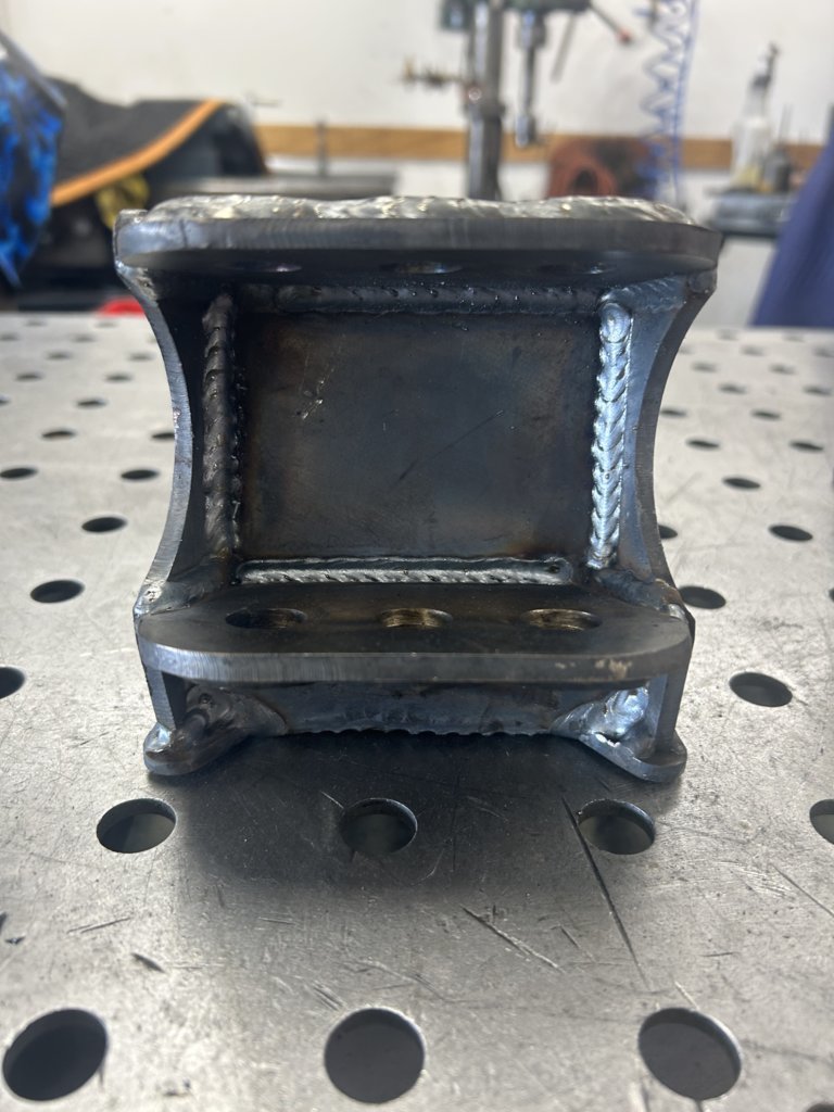

    Little bit of time today. Got the shock mounts done. Not really a fan of how I did them because of how complicated the mounts turned out to be but they’re done. I then started welding out the front and pulled the axle to fully weld it. Not the best welder when it comes to tube but maybe by the end I’ll be decent.IMG_9416.jpg IMG_9418.jpg IMG_9419.jpg IMG_9420.jpg IMG_9421.jpg IMG_9422.jpg IMG_9423.jpg IMG_9424.jpg IMG_9425.jpg IMG_9426.jpg

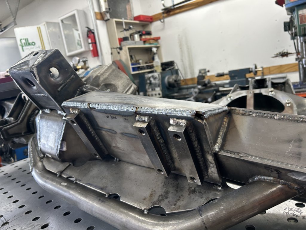

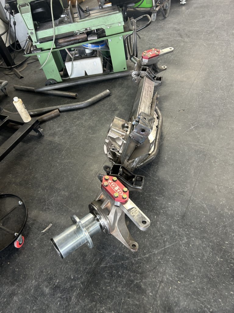

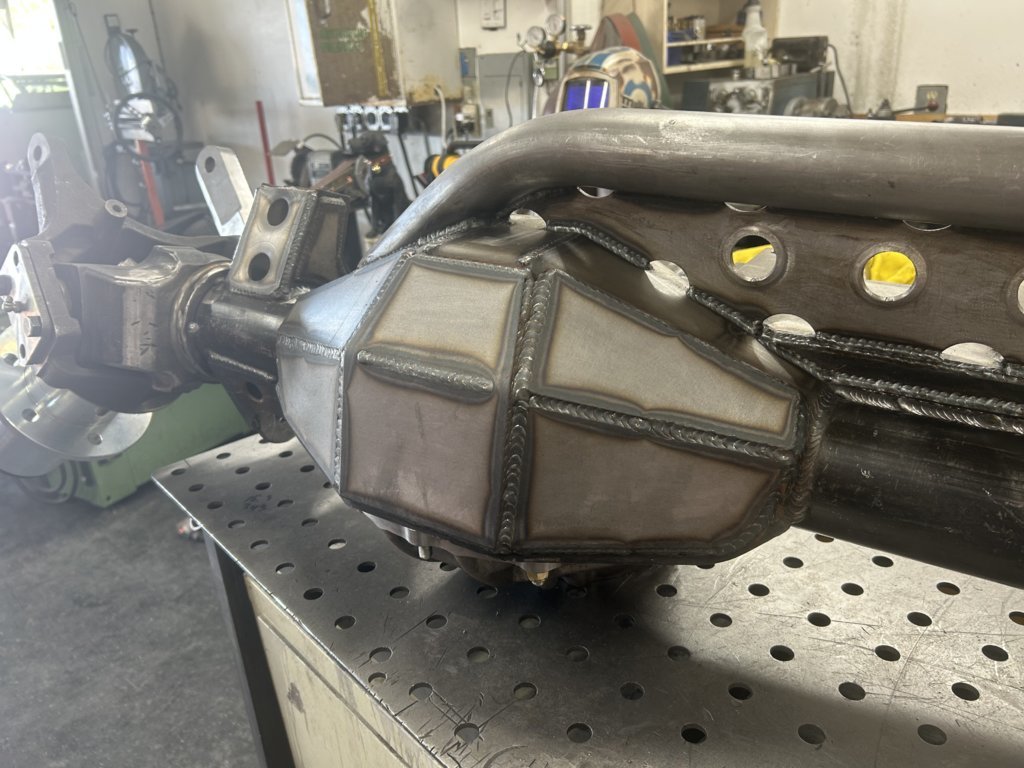

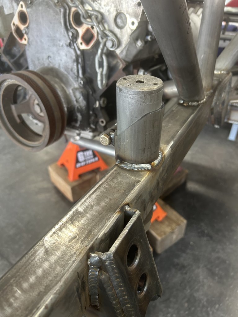

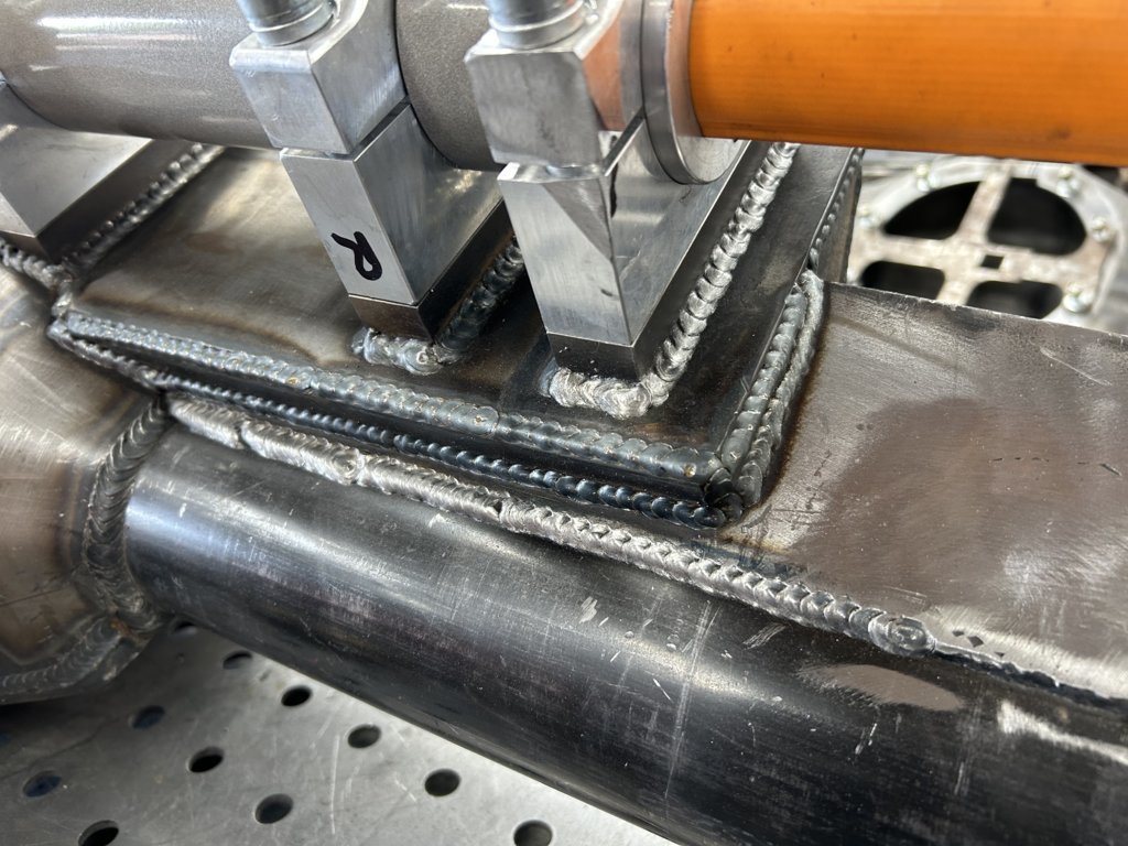

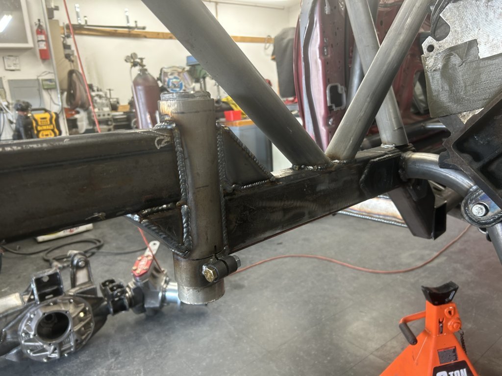

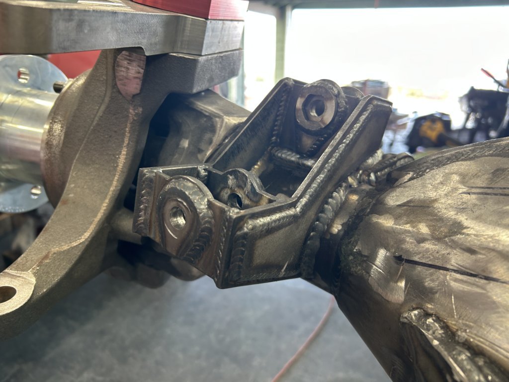

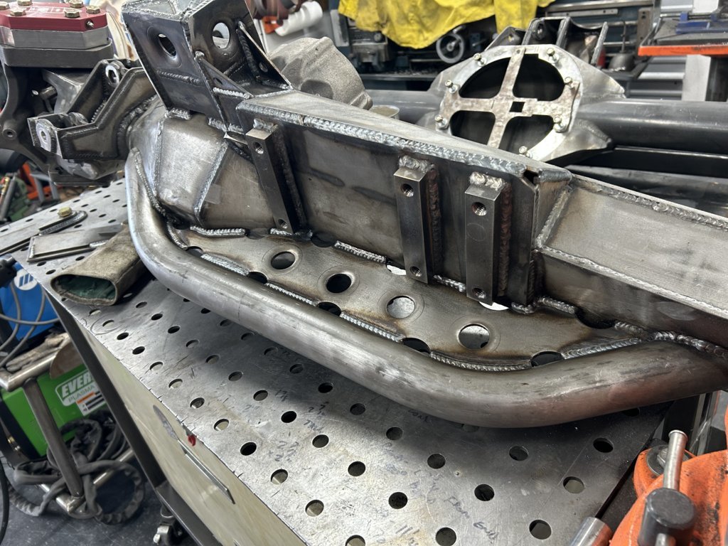

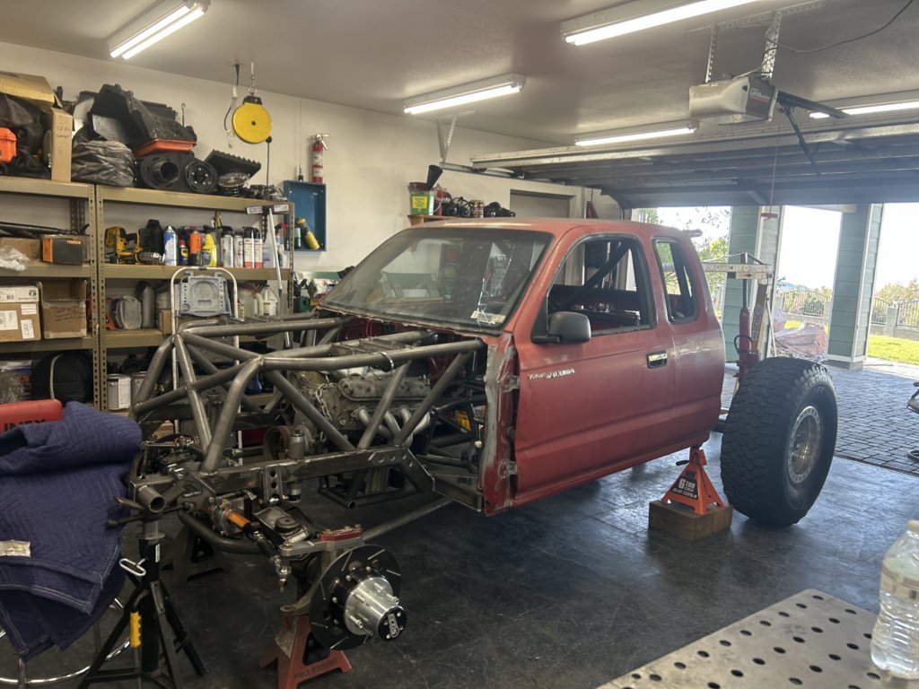

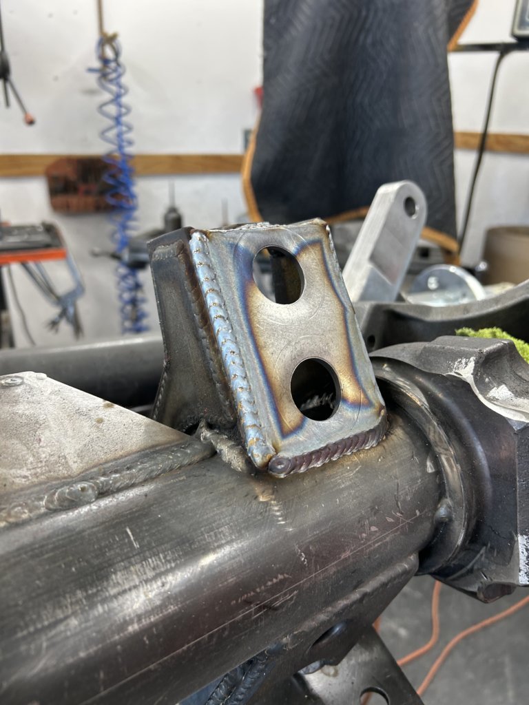

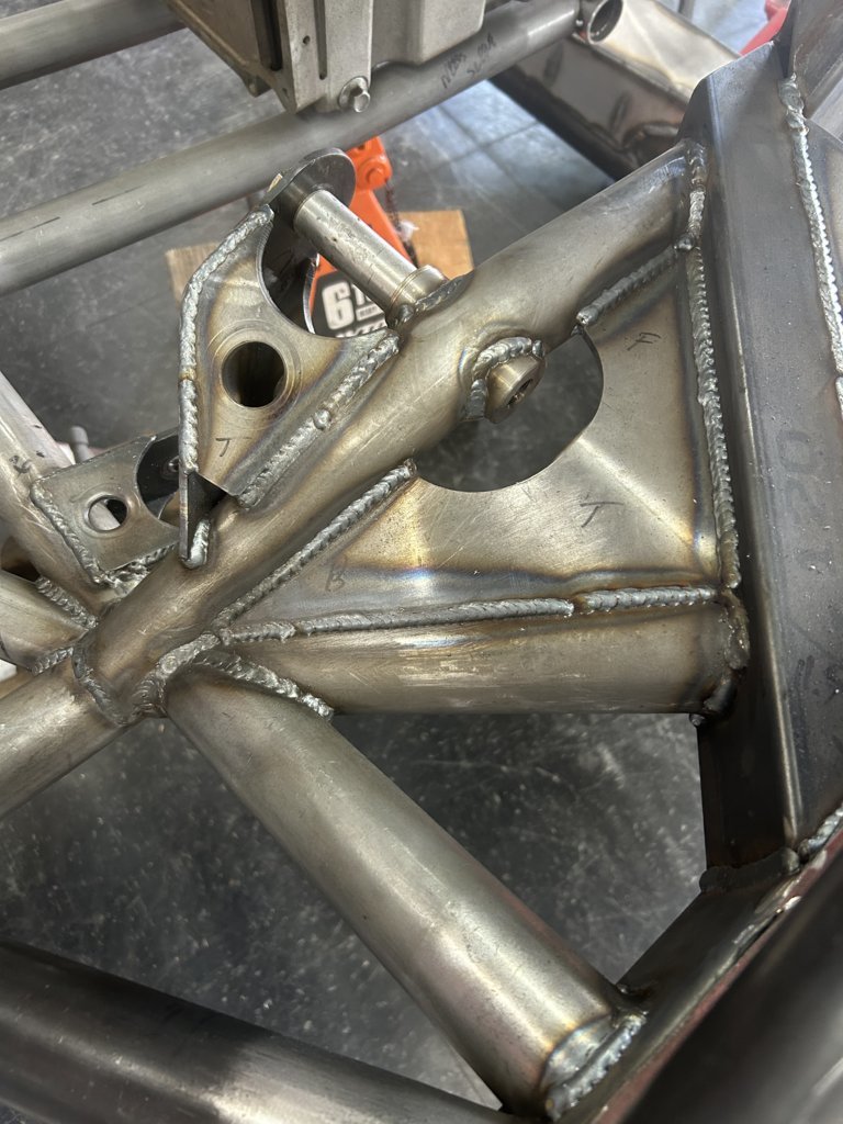

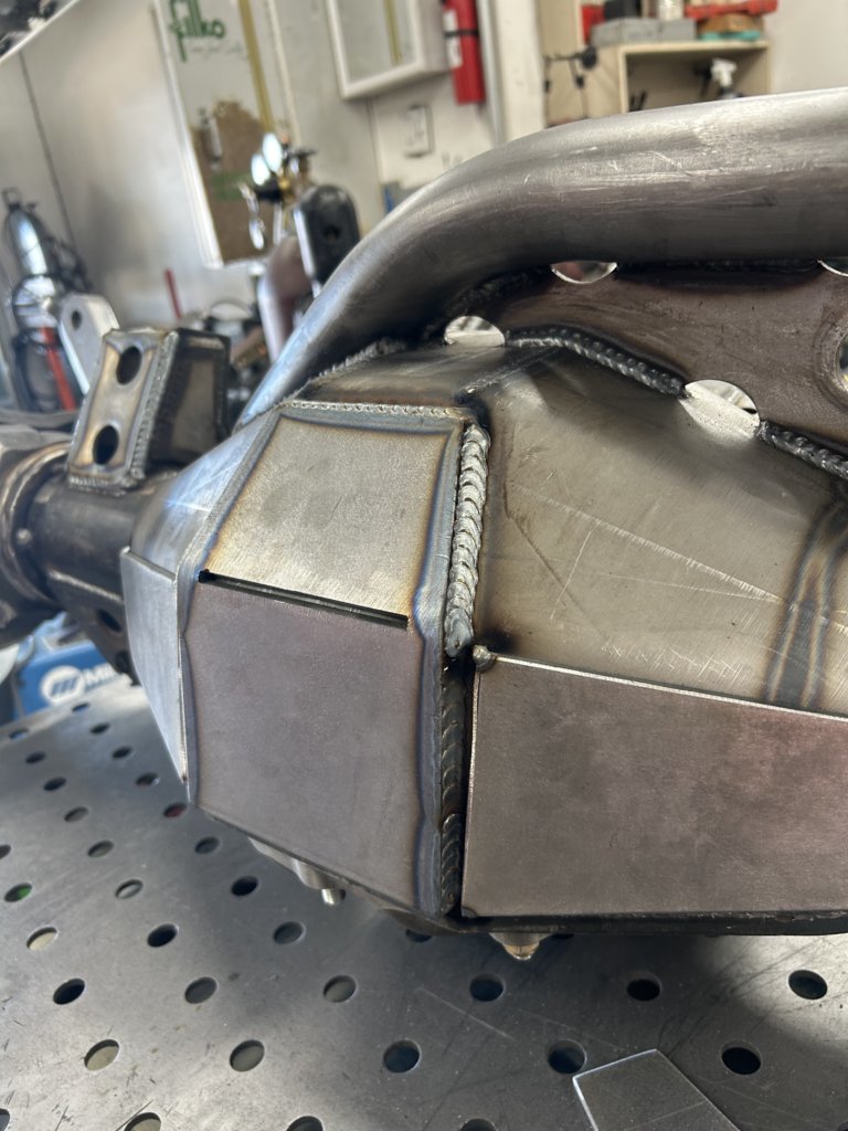

    Started welding out the axle. Taking my time. Got the ram mount welded and braced and capped. Most the shock mounts and the outside of the upper link are welded. I’ll bridge the gap to the upper link and ram mount and probably add a slope to the other end to finish it off.IMG_9427.jpg IMG_9428.jpg IMG_9431.jpg IMG_9432.jpg IMG_9433.jpg IMG_9435.jpg

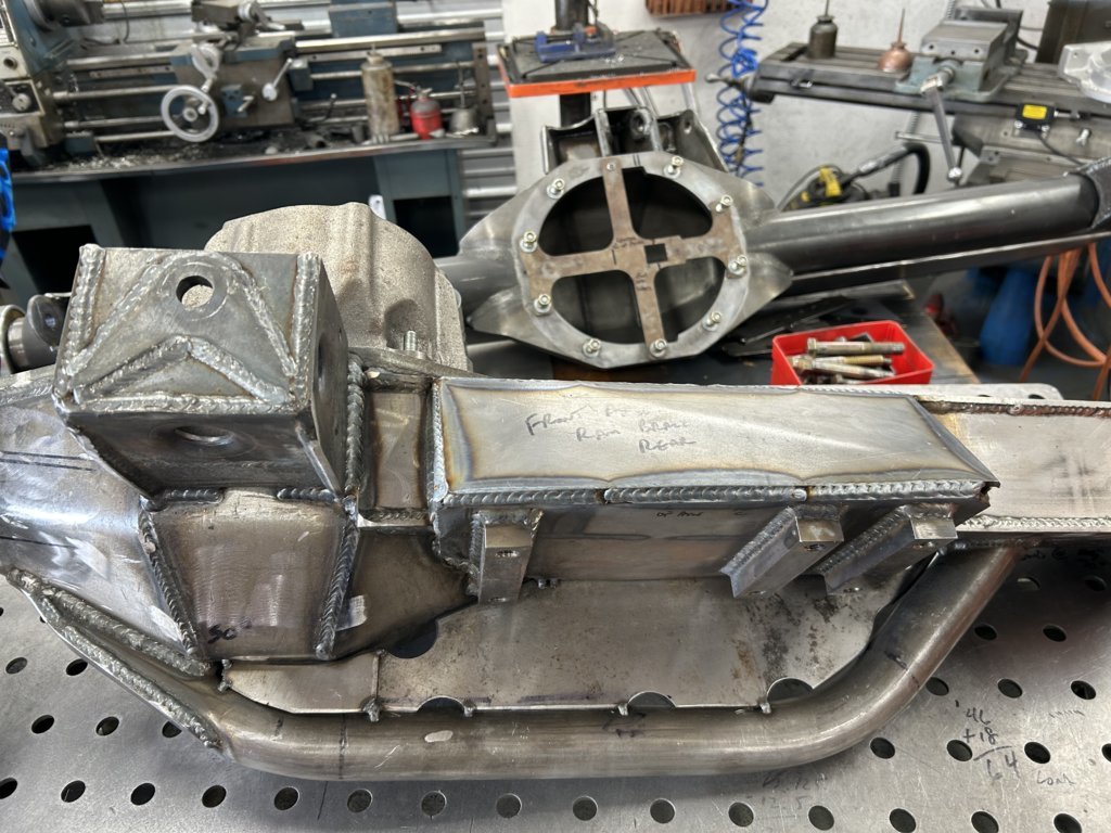

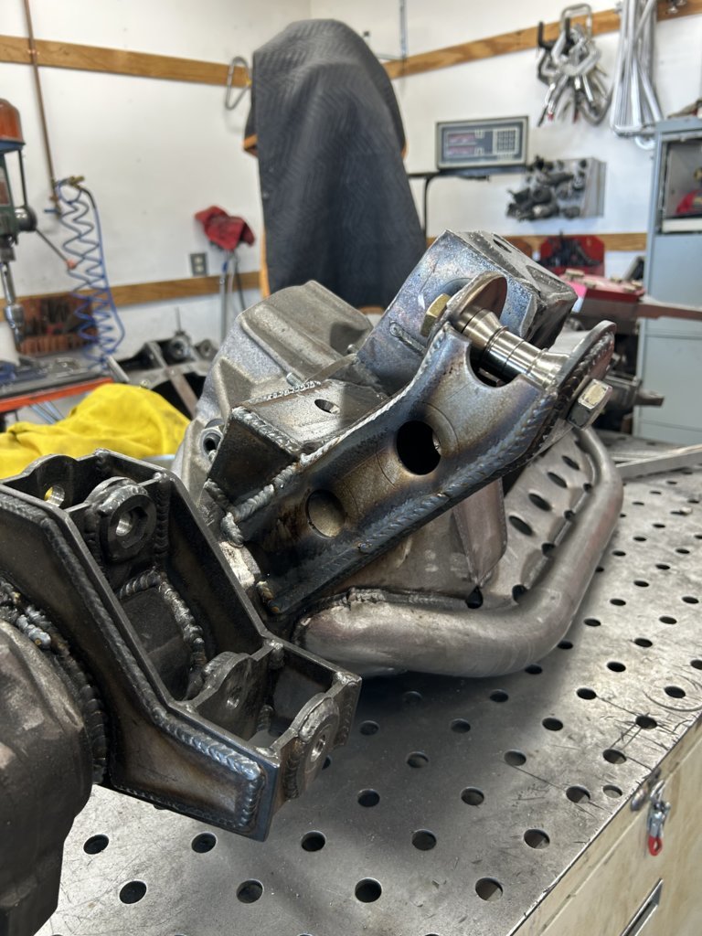

    More axle welding. It’s back under the car to get the panhard hard tacd since I erased my marks by accident.
    Redid the front tube as it was pretty close to the ram bolts and clamps and worried about it getting smashed. And made it flow into the housing which looks way better. Besides the panhard and bump pads, front axle is doneIMG_9488.jpg IMG_9491.jpg IMG_9493.jpg IMG_9503.jpg IMG_9505.jpg IMG_9508.jpg IMG_9509.jpg IMG_9511.jpg IMG_9512.jpg

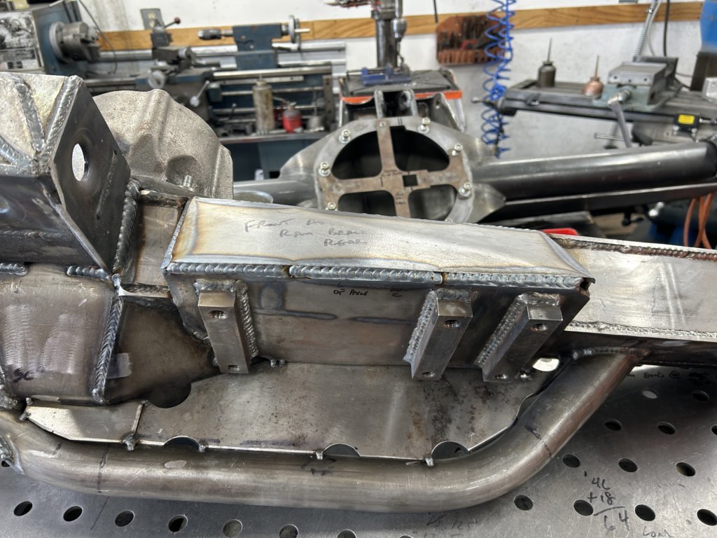

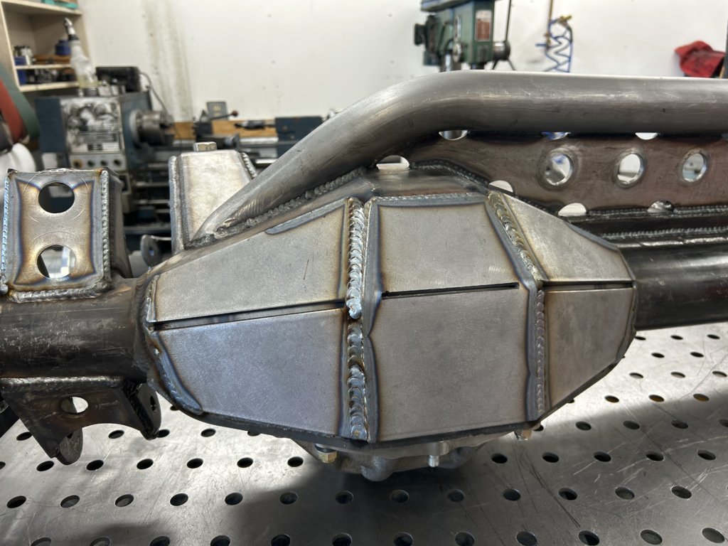

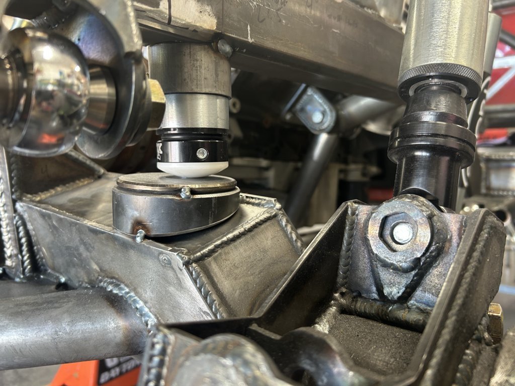

    Bump pads are in. Panhard is welded. Few more plates for support and front axle will be done. Getting close to turning it around and starting on the rear. Driver side is a piece of the axle housing so 3.5x.25 and then has a piece of 2x.25 in the middle welded to the cap.IMG_9522.jpg IMG_9525.jpg IMG_9531.jpg IMG_9529.jpg IMG_9536.jpg IMG_9538.jpg IMG_9540.jpg IMG_9545.jpg IMG_9546.jpg IMG_9547.jpg

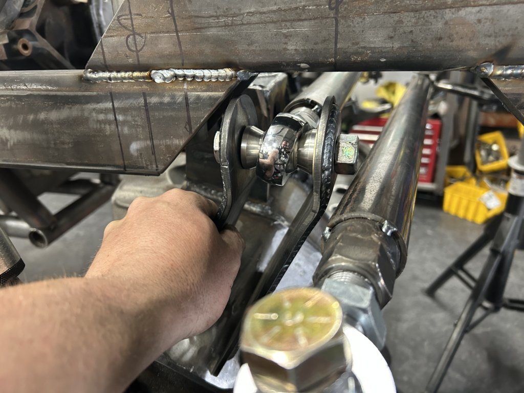

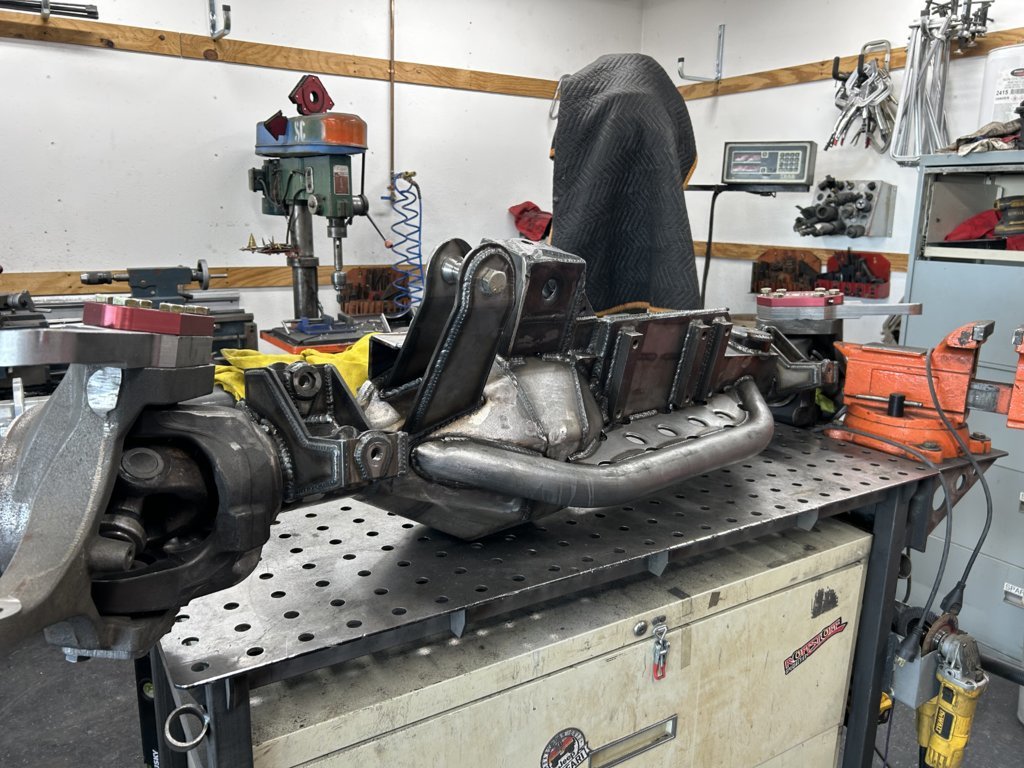

    Another day of working on this housing…

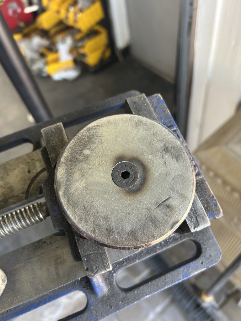

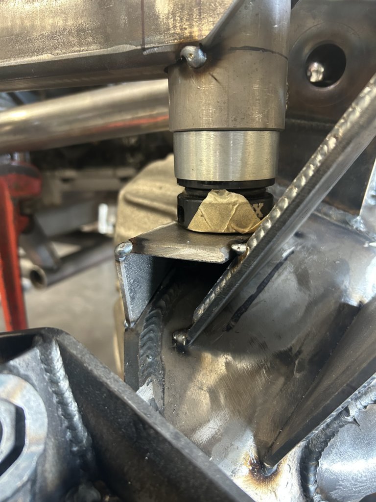

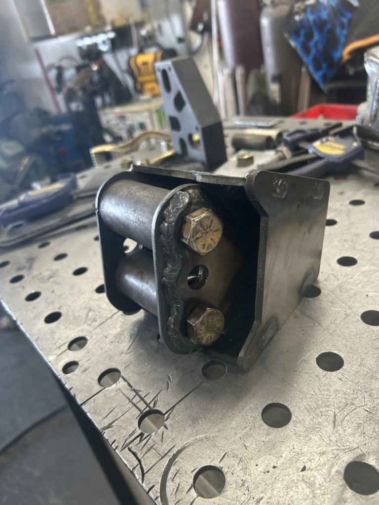

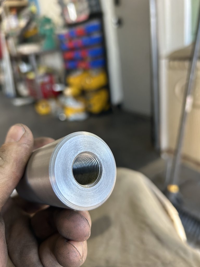

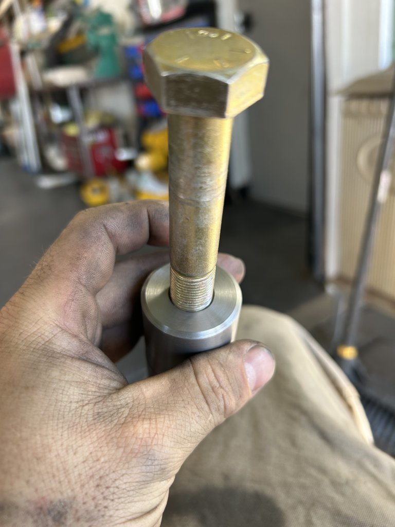

    Started welding out the subframe as well and made the slug for the upper link. Originally it was just a sleeve and then a nut on the end but the bolt was so long, the trans had to come out to pull the upper link. So I made another sleeve and tapped it for a 5/8-18 fine thread bolt. I’ll make a bolt on capture nut plate for the bolt head as well and some red loctite and it shouldn’t go anywhere.IMG_9549.jpg IMG_9550.jpg IMG_9552.jpg IMG_9554.jpg IMG_9558.jpg IMG_9556.jpg IMG_9557.jpg IMG_9559.jpg IMG_9560.jpg

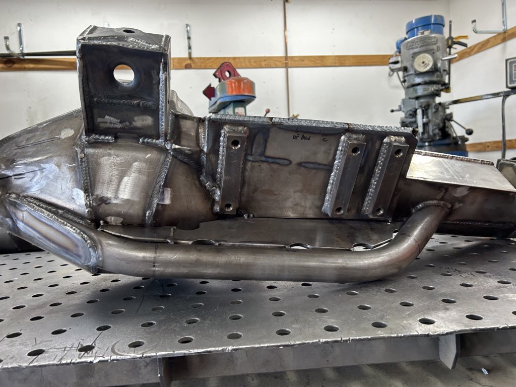

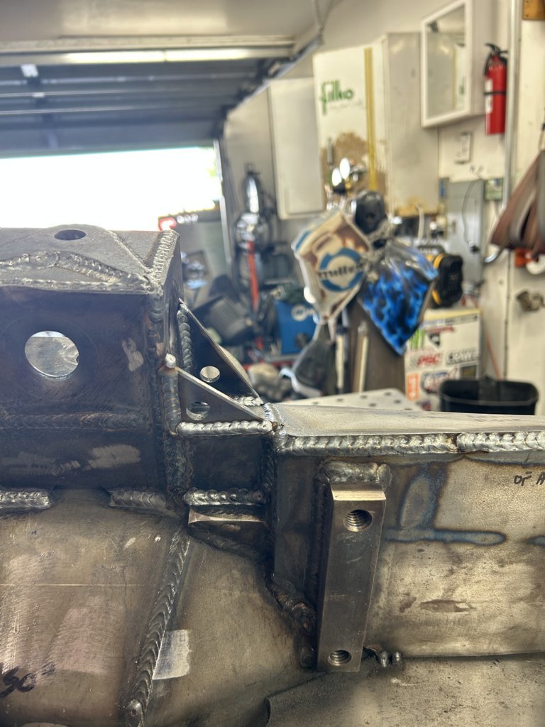

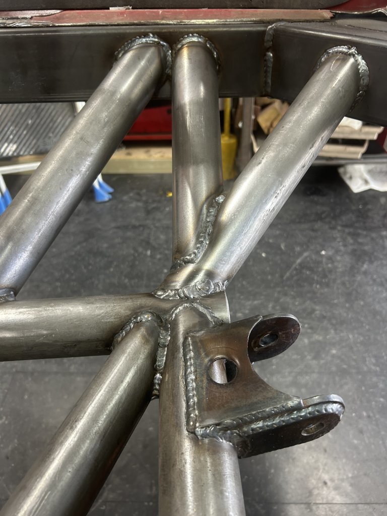

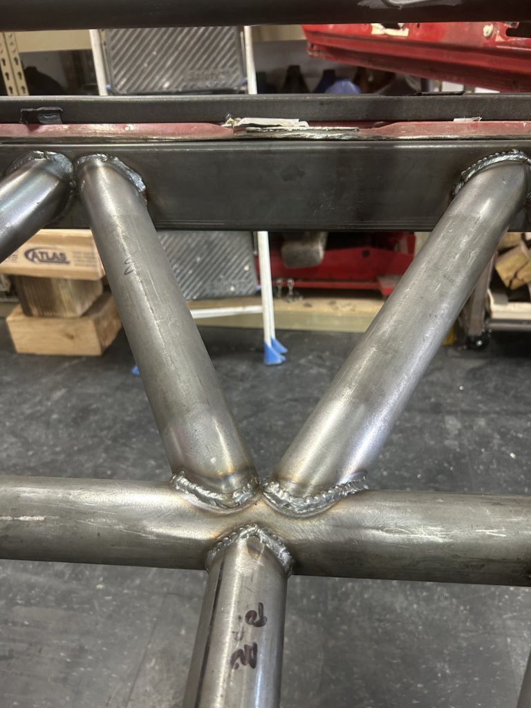

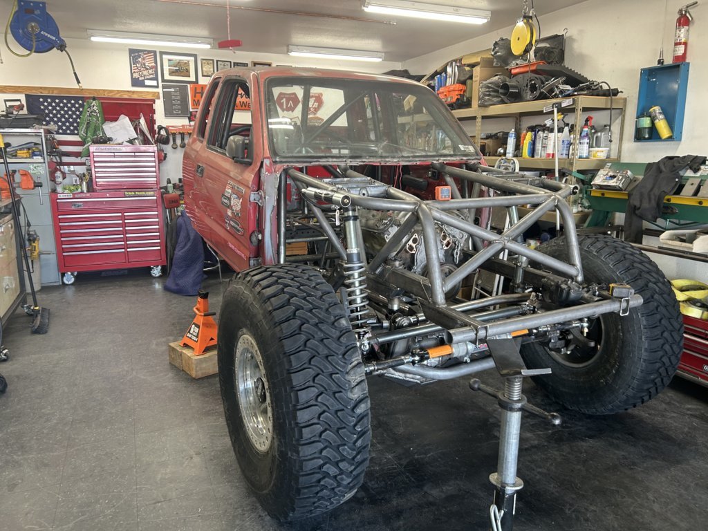

    This was a lot of welding. Same thing. Not the greatest welder when it comes to tube. But getting better already I feel. Front half of the subframe is welded out and to the frame and bump stop cans are in. I think I’m at the point to put the front axle back in and turn it around.IMG_9562.jpg IMG_9563.jpg IMG_9564.jpg IMG_9565.jpg IMG_9566.jpg IMG_9567.jpg IMG_9568.jpg IMG_9569.jpg IMG_9570.jpg IMG_9571.jpg

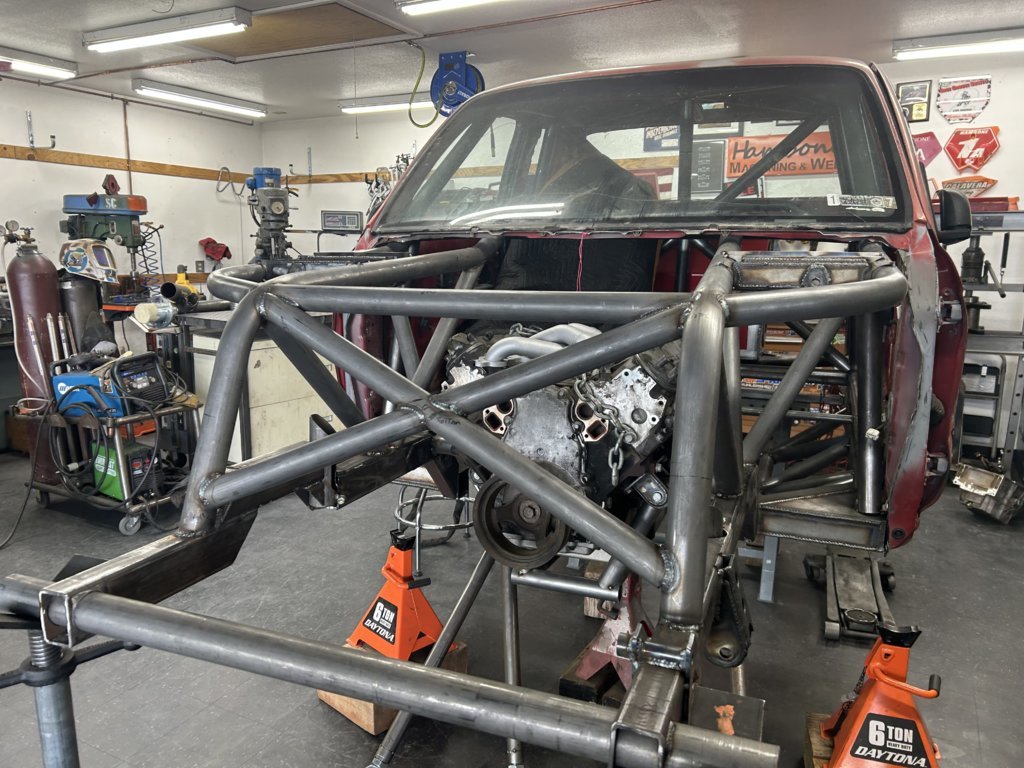

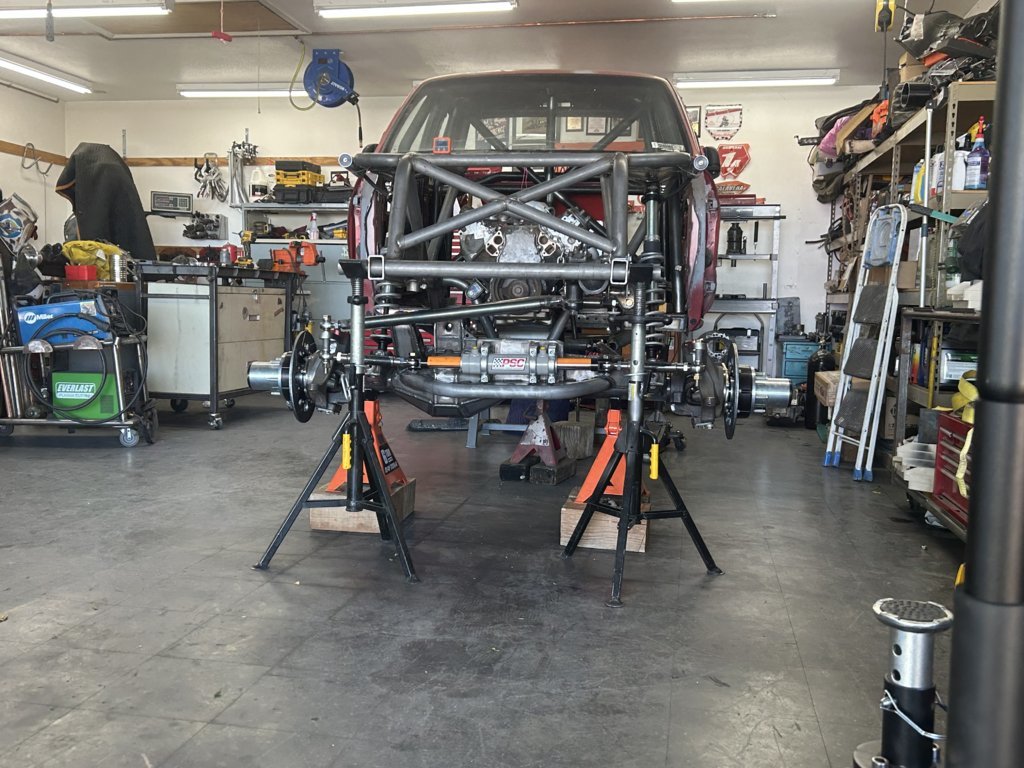

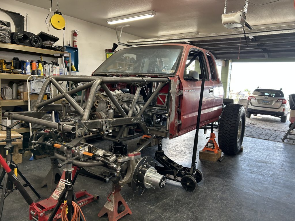

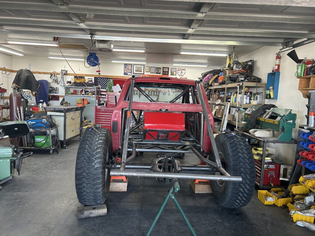

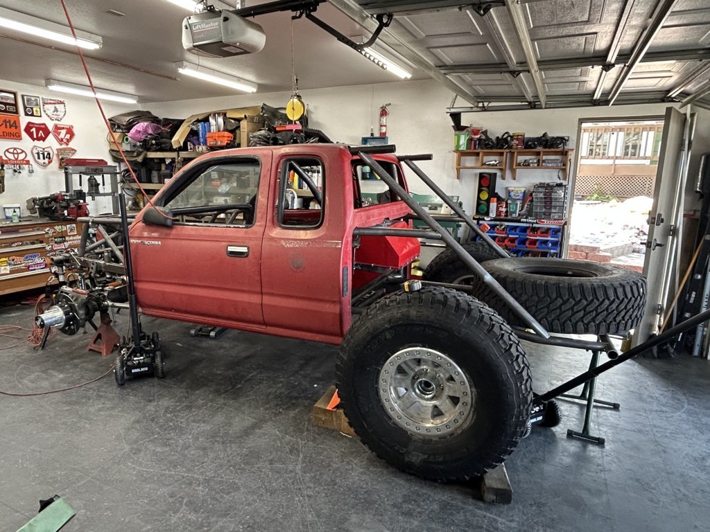

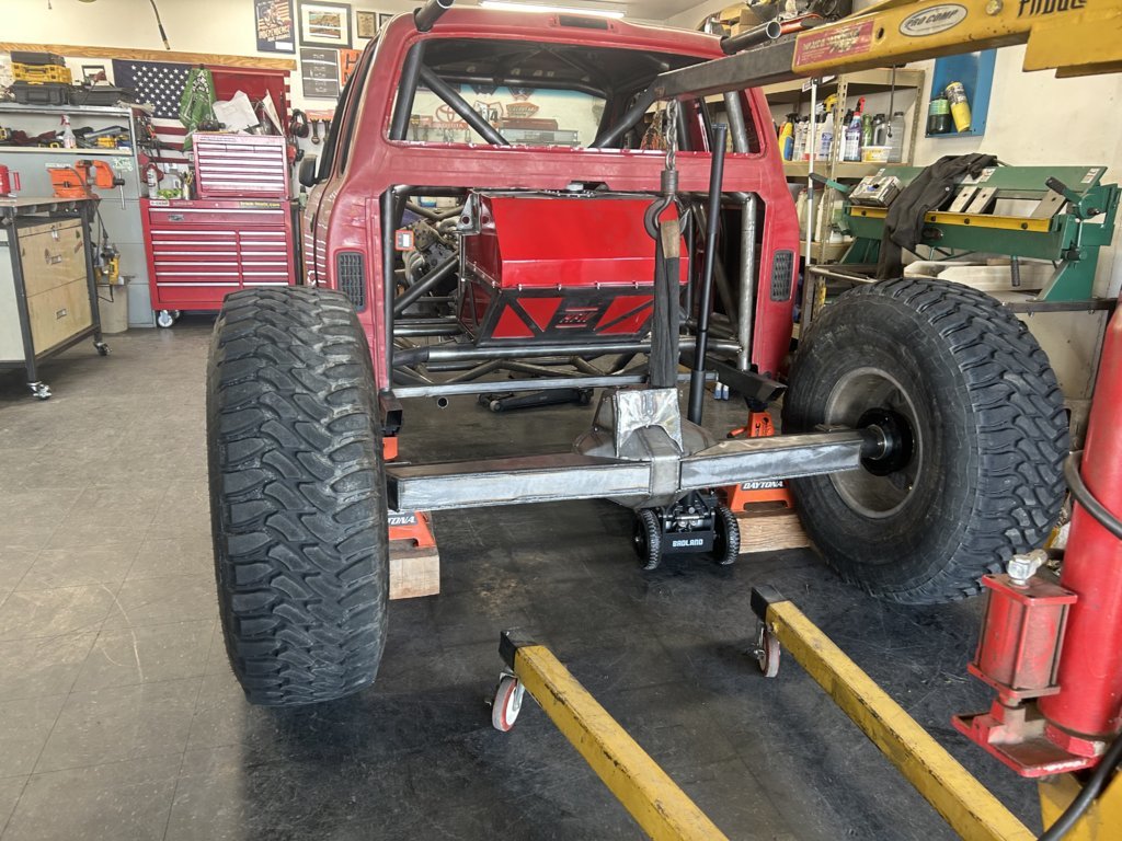

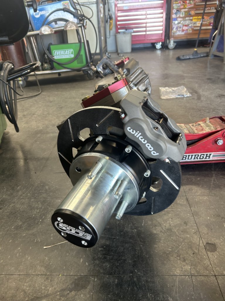

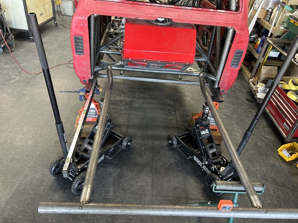

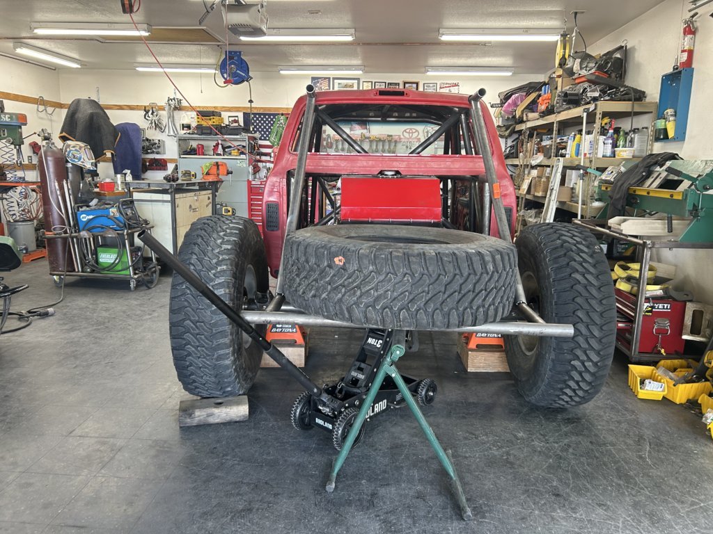

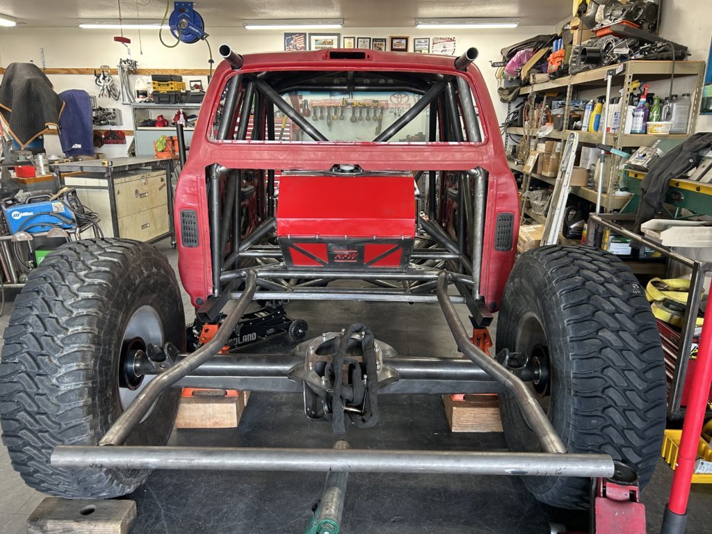

    Well got the front axle back in and wheel studs finally showed up. Having all sorts of issues with the brake kit and calipers not fitting so just carried on and went to turn it around it. Got the front tires on and went to put the back saw horse on some carts as they looked the perfect width. When jacking up the saw horse, it broke the tacs and clamps and car crashed to the ground. Only a more broken windshield cab bounced a little bending down sheet metal.

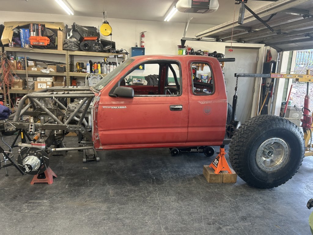

    So a few hours of undoing all the front axle again and getting the rear on the cart I got it turned around and put the front at full bump and leveled the frame to start figuring out the back. Got the wheelbase right around 117-118 which I think is where it’ll stay. I got a few tubes in after these pictures but forgot to snap one.IMG_9621.jpg IMG_9618.jpg IMG_9624.jpg IMG_9623.jpg IMG_9626.jpg IMG_9628.jpg IMG_9629.jpg IMG_9633.jpg IMG_9630.jpg IMG_9631.jpg

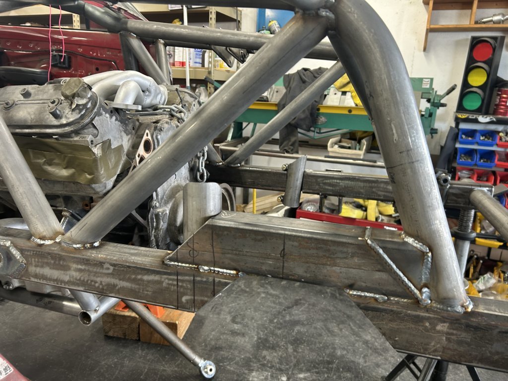

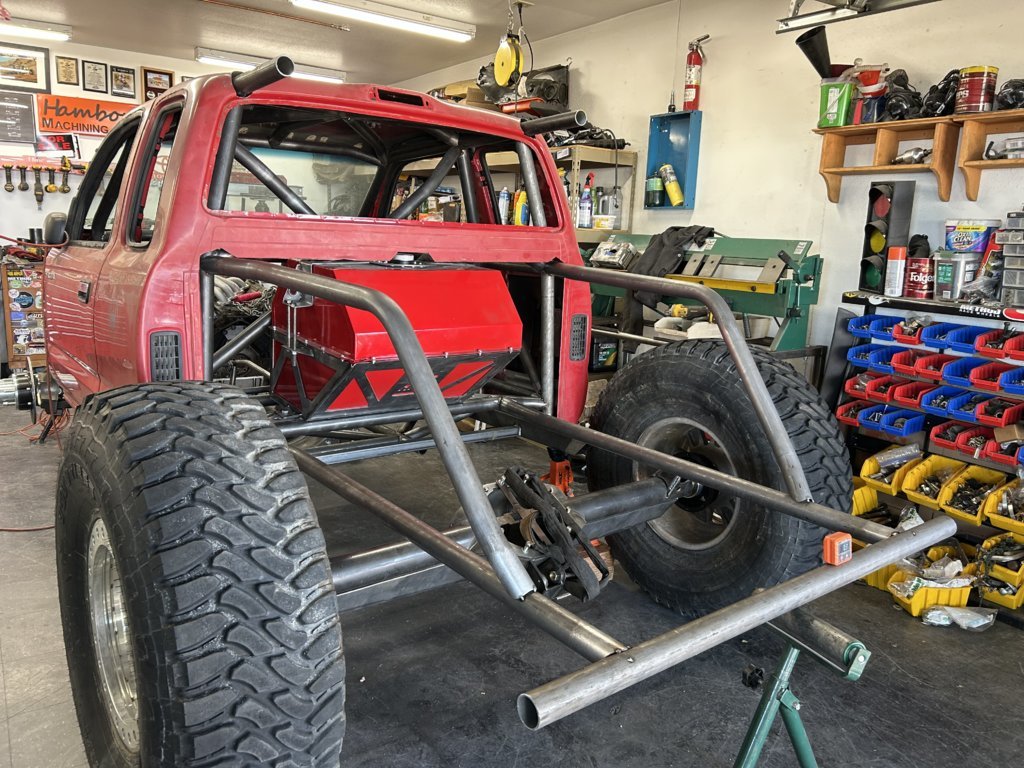

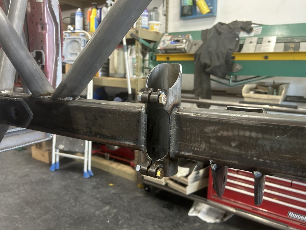

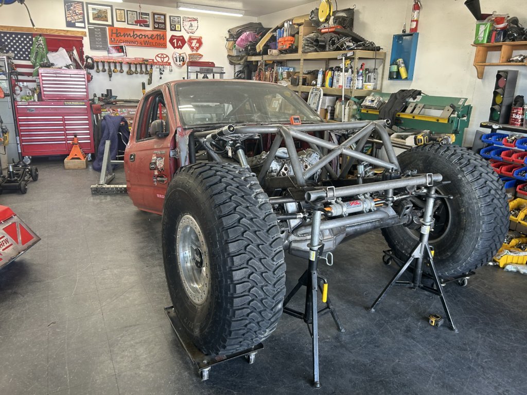

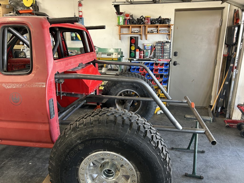

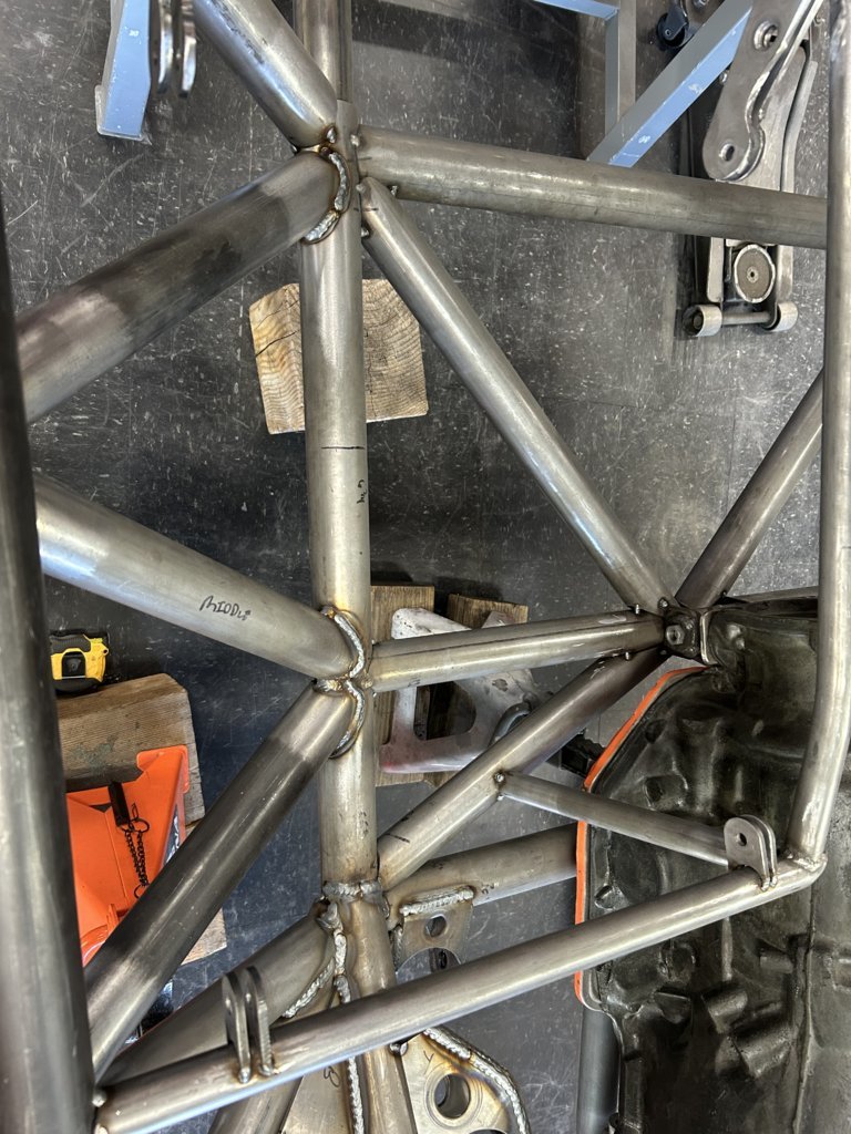

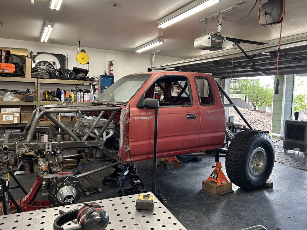

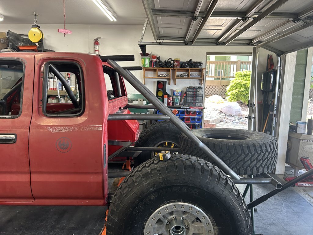

    Spent an entire day last week working on the rear and made something I didn’t like. Finally got something I do like though. Onto getting the link mounts in.
    old. Rear frame was to narrow for a 40” spare and the design was just dumb not coming off the top tube coming out of the cab. IMG_9693.jpg IMG_9704.jpg IMG_9705.jpg

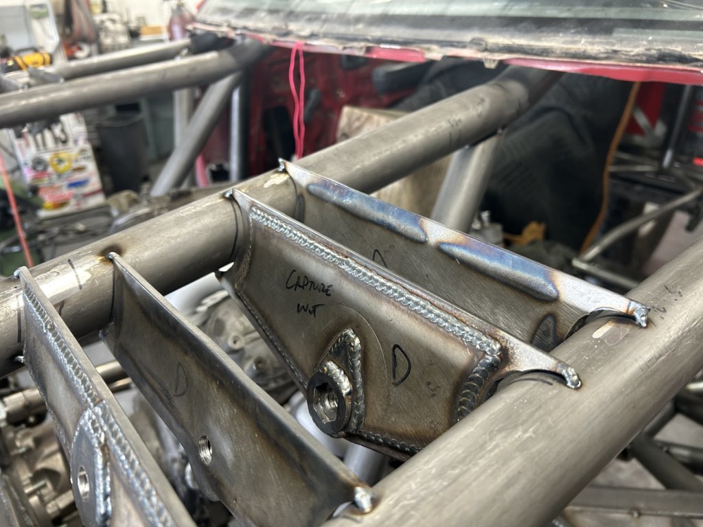

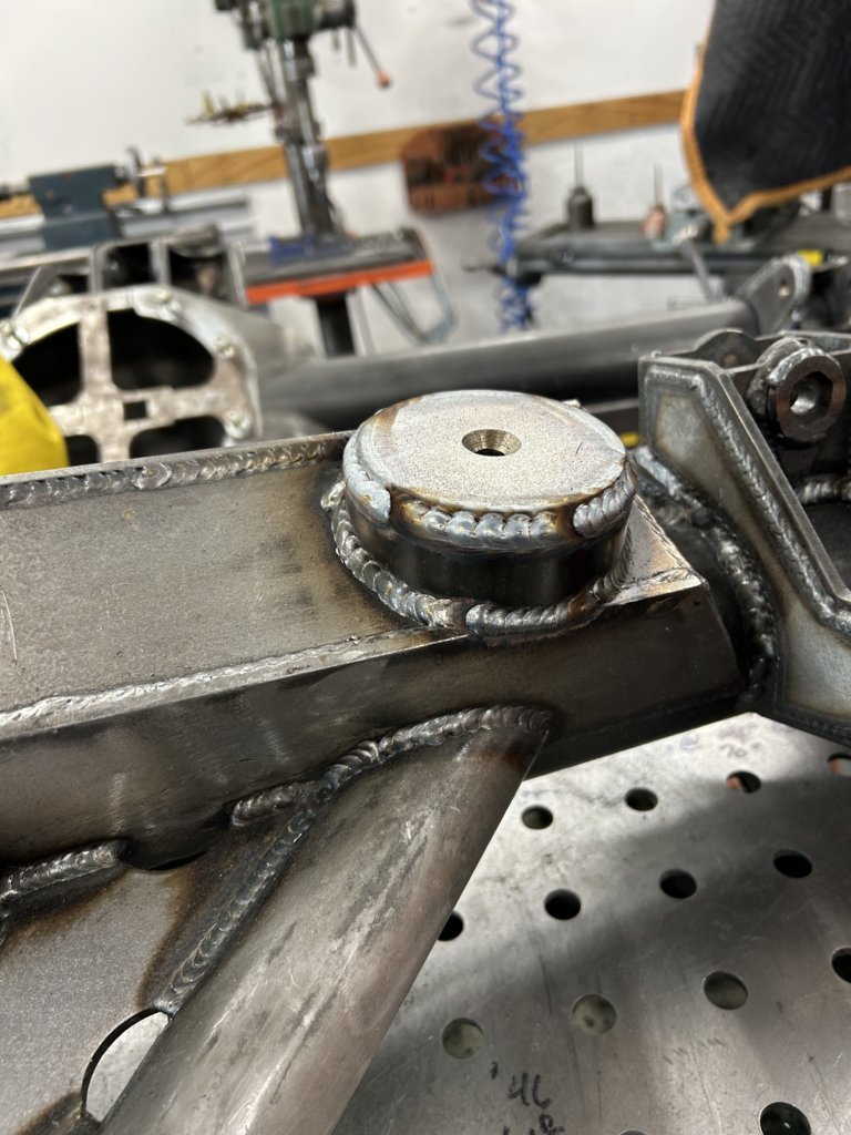

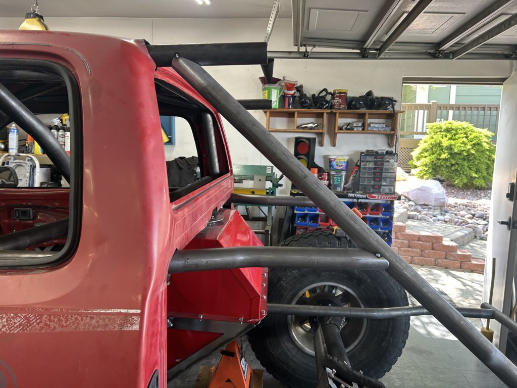

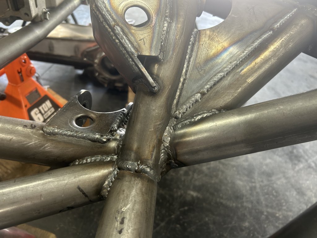

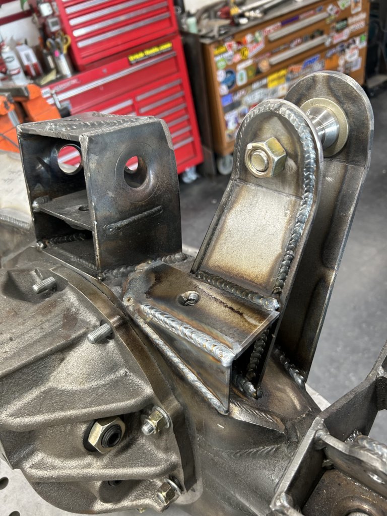

    Jacked the car up to ride height to plug the numbers into the calculator. Got the rear frame side upper link mounts done. Was a ton of welding. IMG_9754.jpg IMG_9749.jpg IMG_9756.jpg IMG_9757.jpg IMG_9759.jpg IMG_9761.jpg IMG_9763.jpg IMG_9764.jpg
