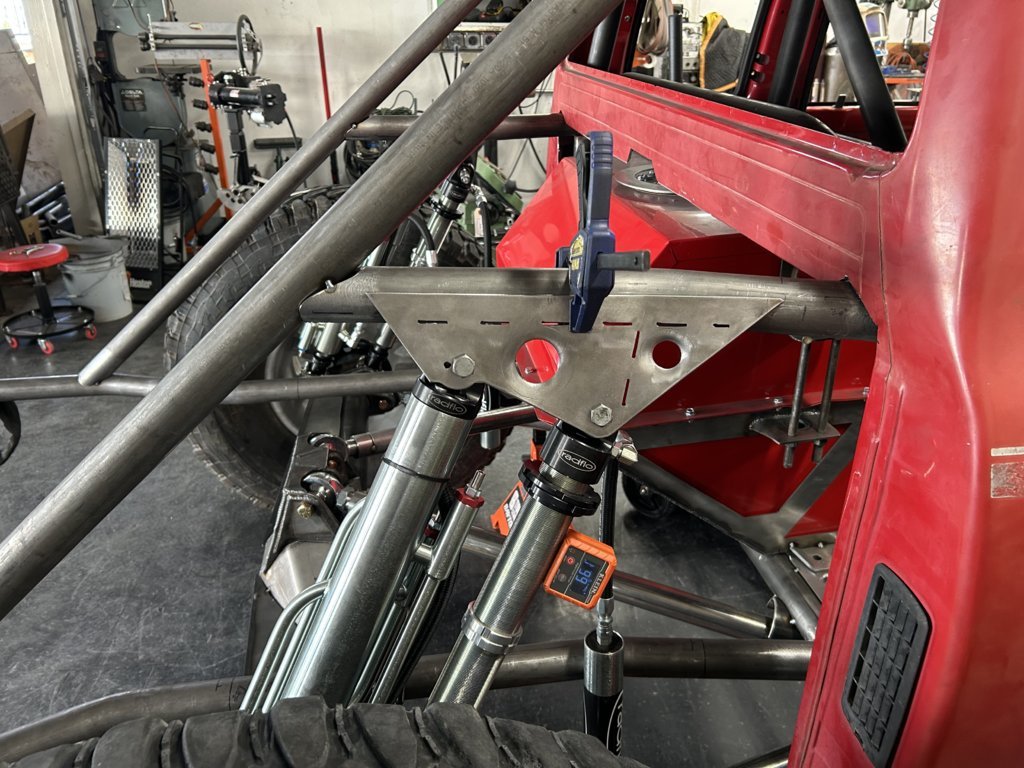

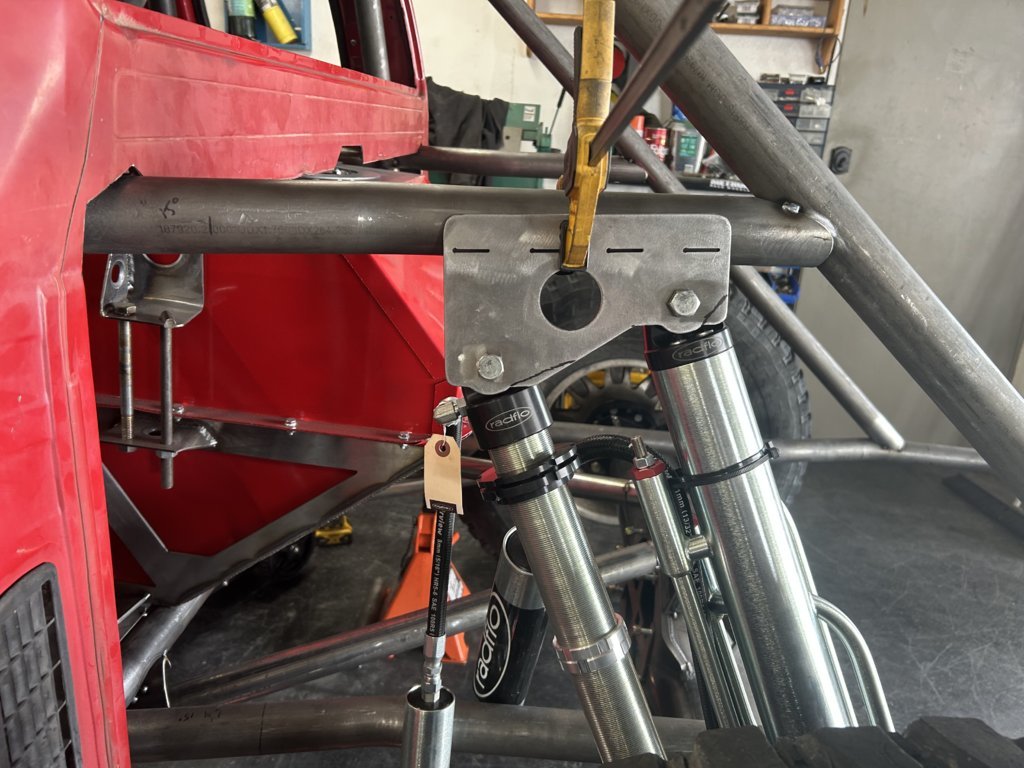

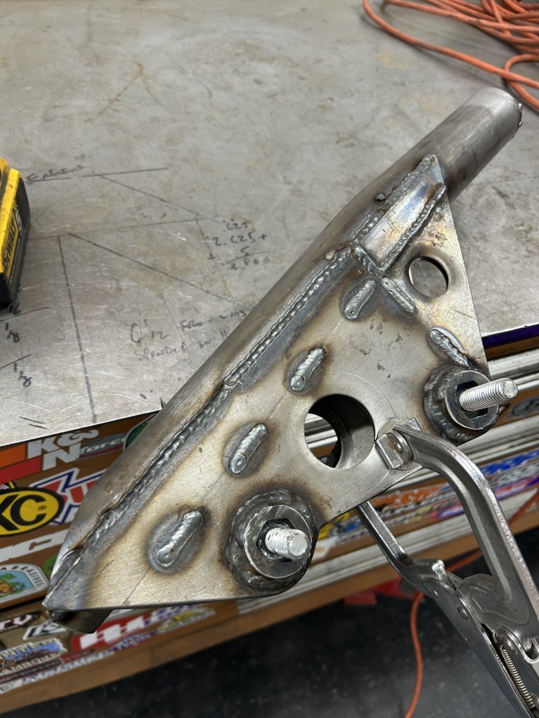

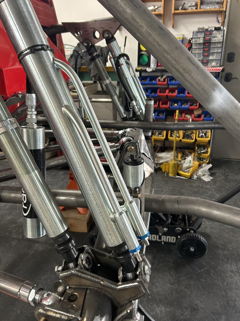

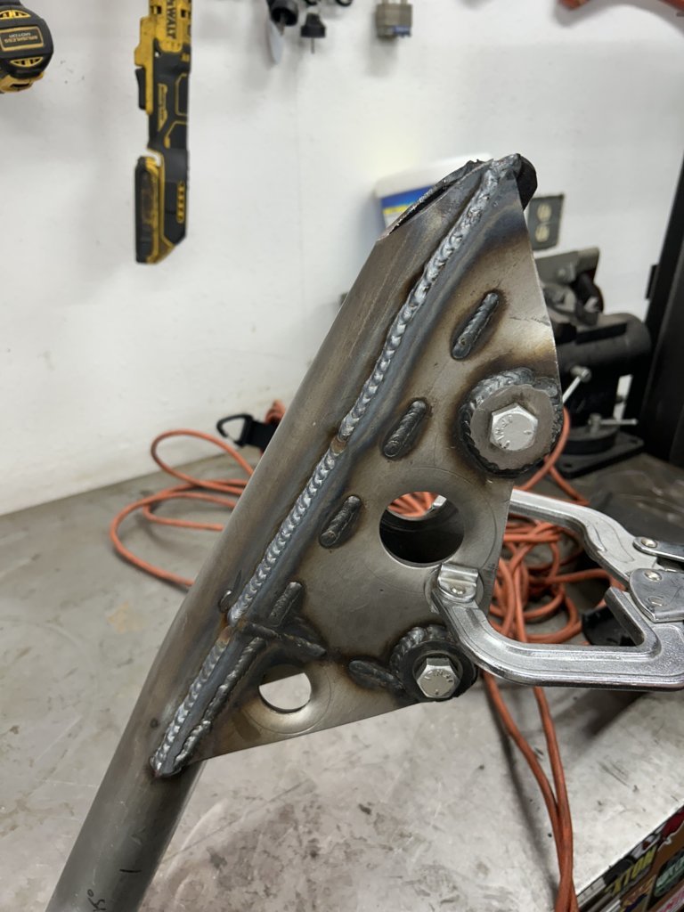

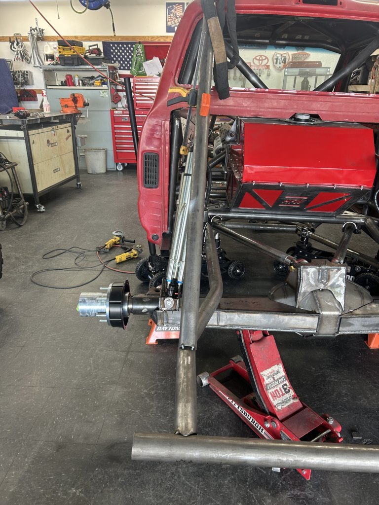

    Notched the crossmember for the fuel cell. This gave me another inch of uptravel in the rear which should be 8.5. Not my best notch but considering it was done on my back and I can weld the gaps and cut/grind it clean, I’ll be happy.

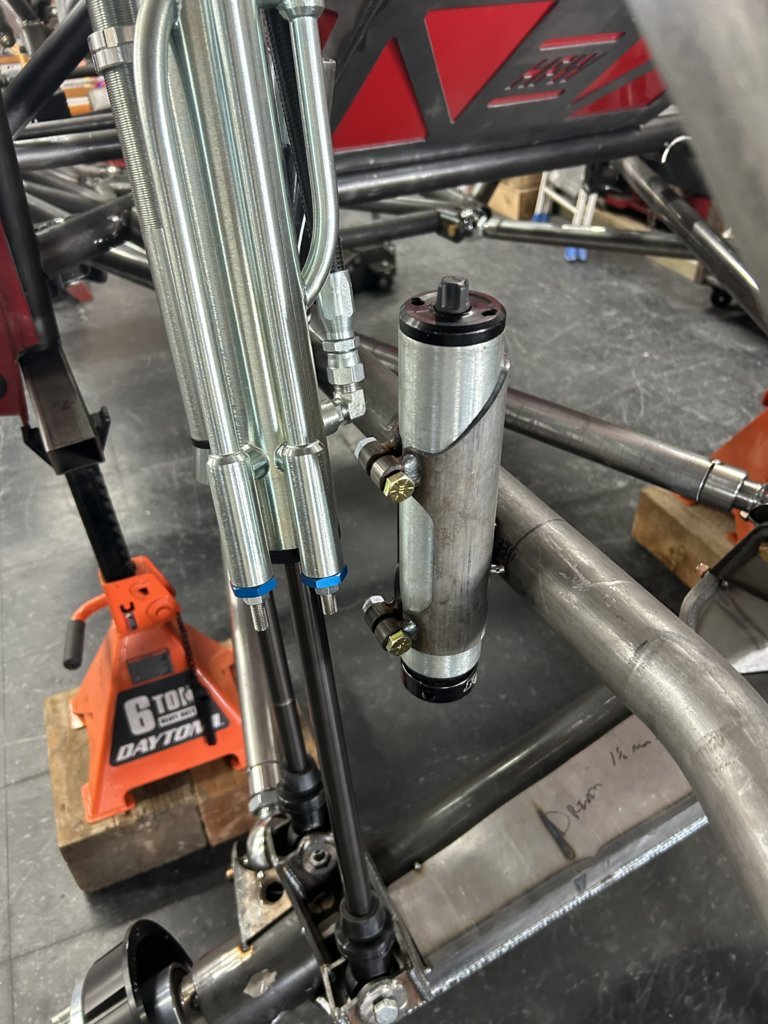

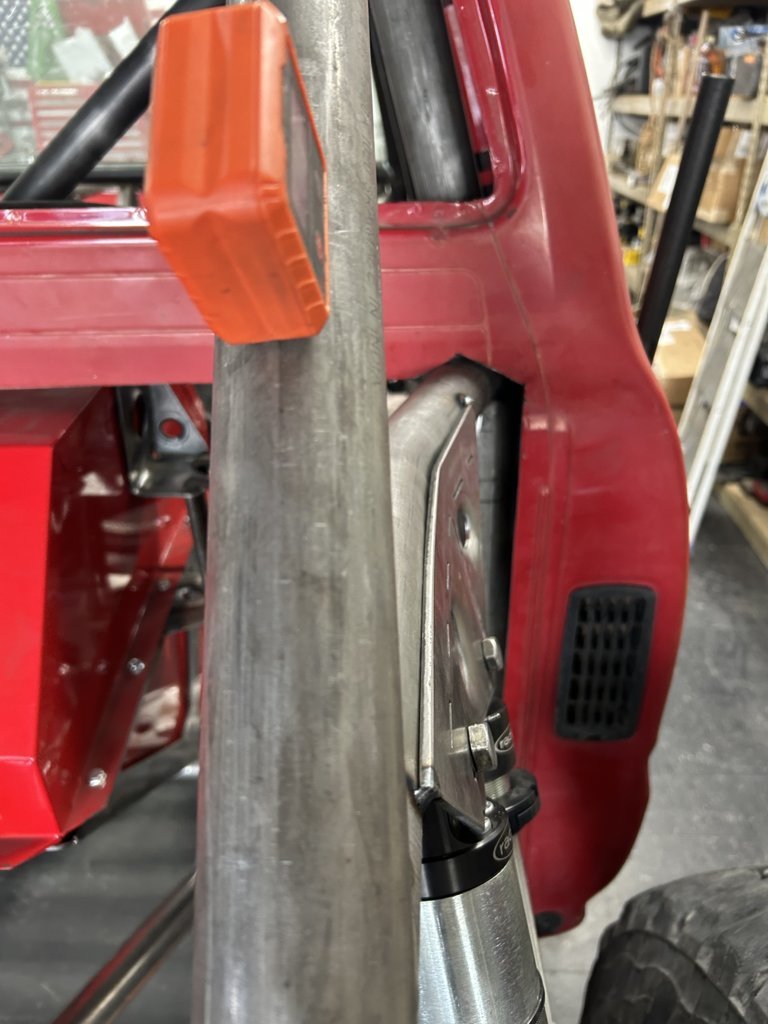

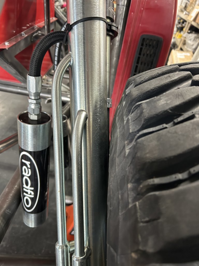

    Started on the shock mounts. Version 1 looked weak and small so made another that’s a little bigger. Tire almost kisses the shocks so I’ll bend the brackets in a 1/2 or so.IMG_9784.jpg IMG_9788.jpg IMG_9789.jpg IMG_9790.jpg IMG_9794.jpg IMG_9795.jpg IMG_9796.jpg IMG_9797.jpg IMG_9799.jpg IMG_9800.jpg

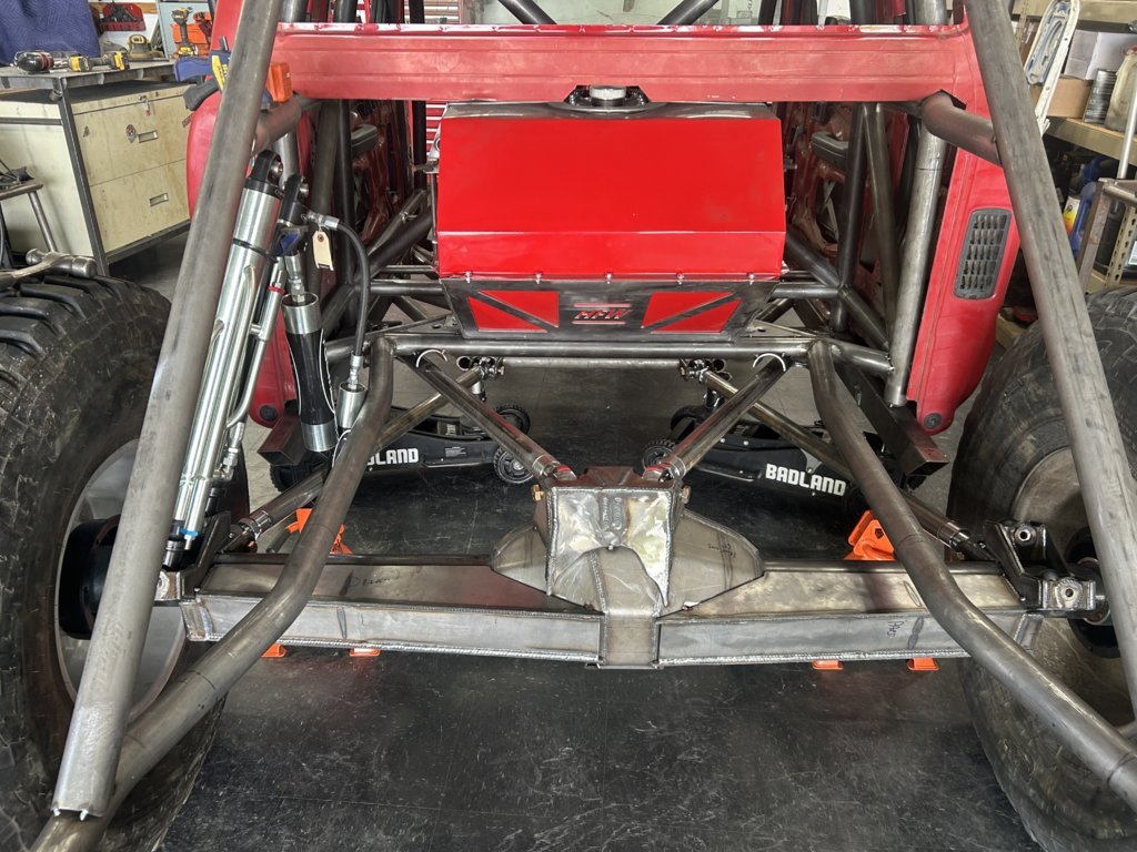

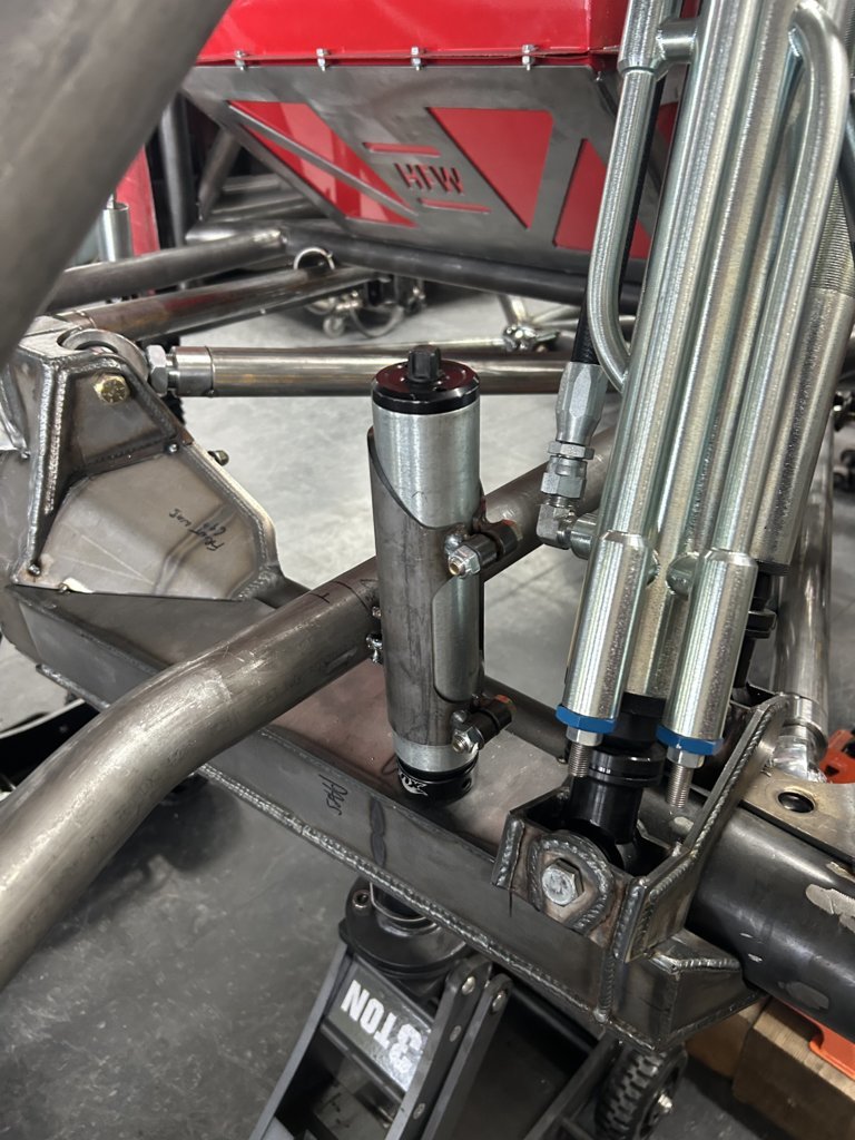

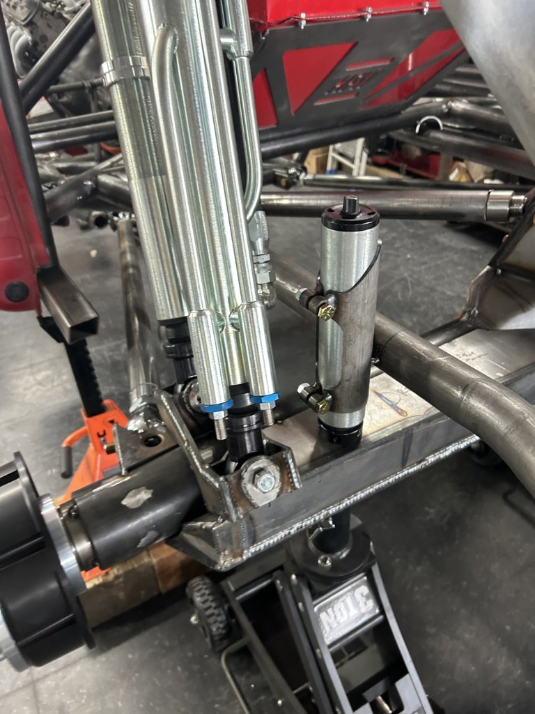

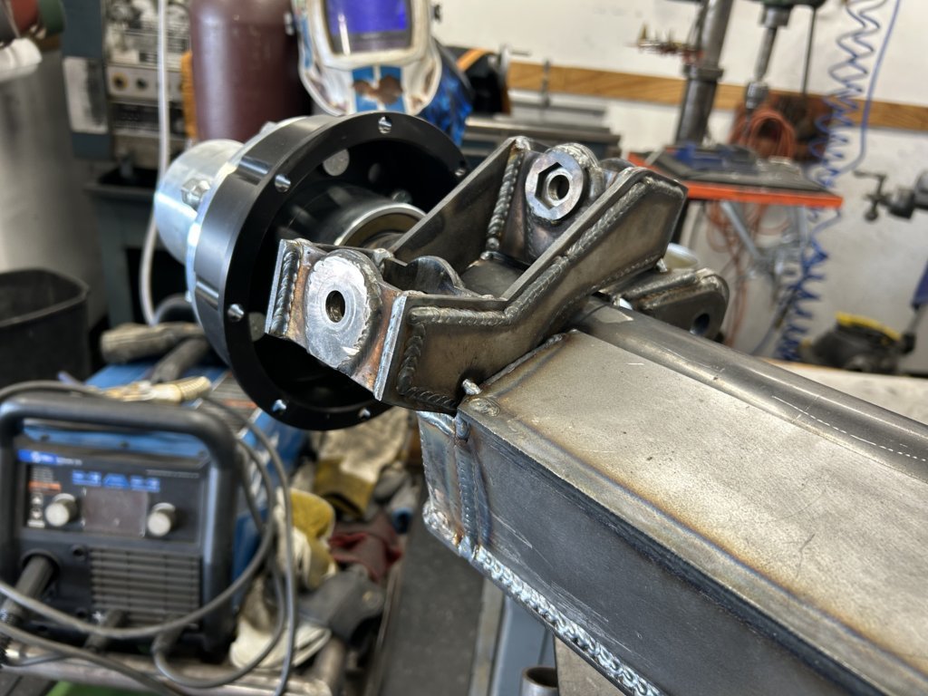

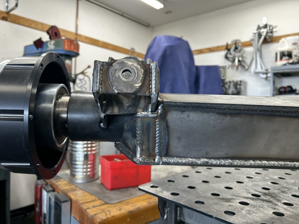

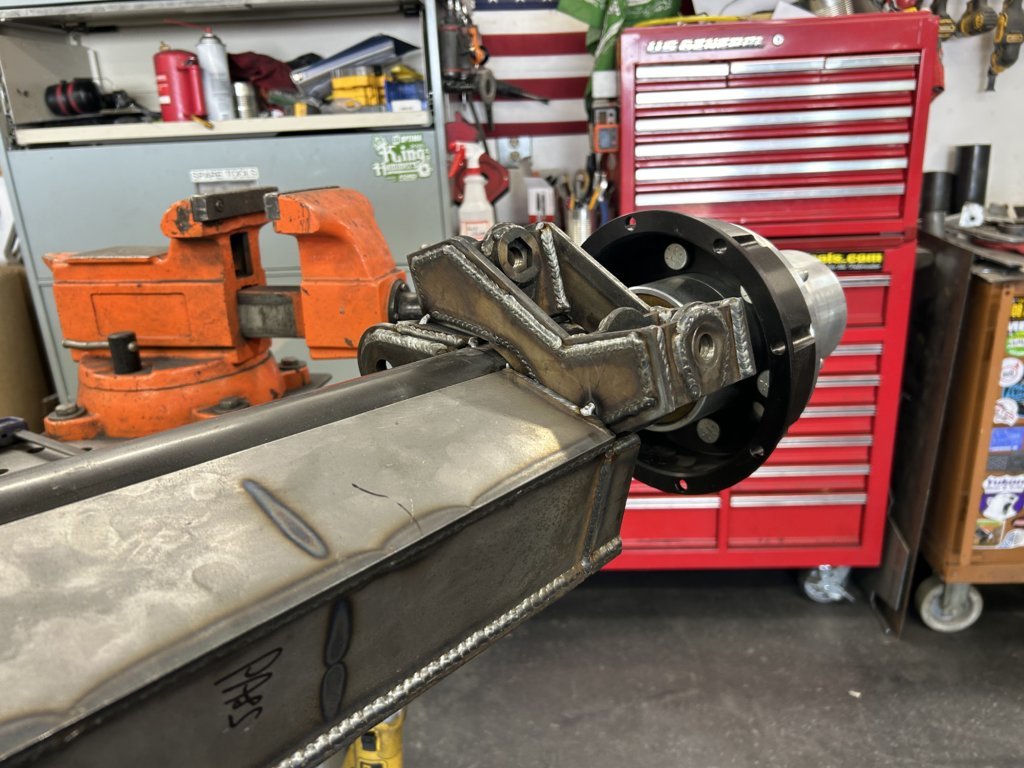

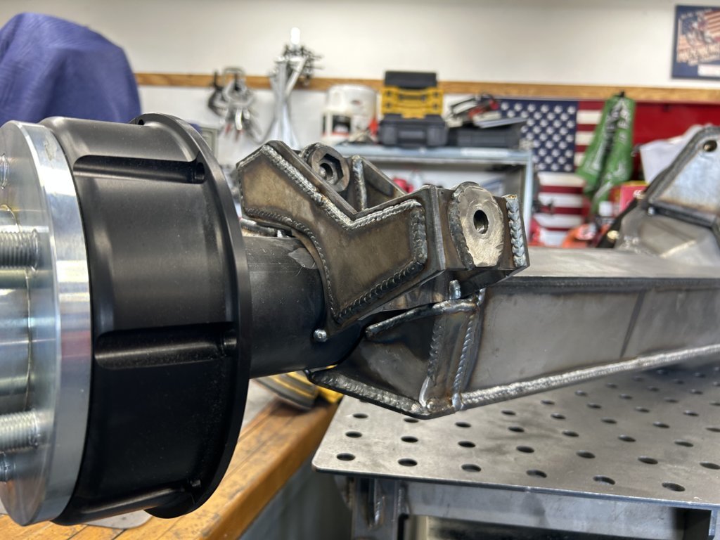

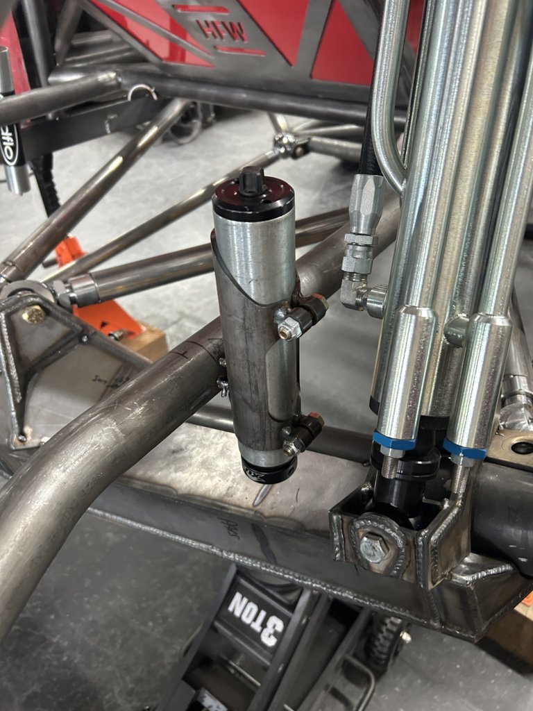

    Forgot I also pulled the rear axle and notched the truss to fit the lower shock mounts. It ties the link mount, shocks and truss all together. Real happy with that. IMG_9737.jpg IMG_9738.jpg IMG_9740.jpg IMG_9741.jpg IMG_9739.jpg

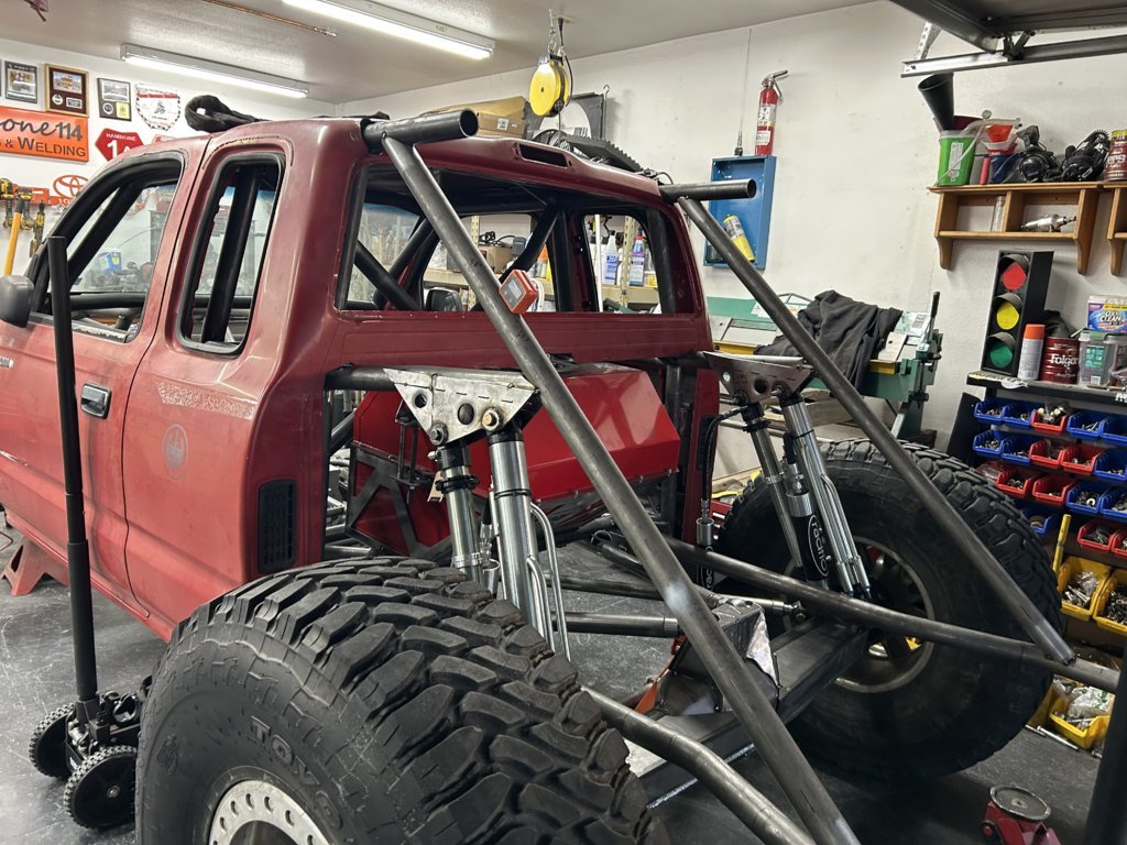

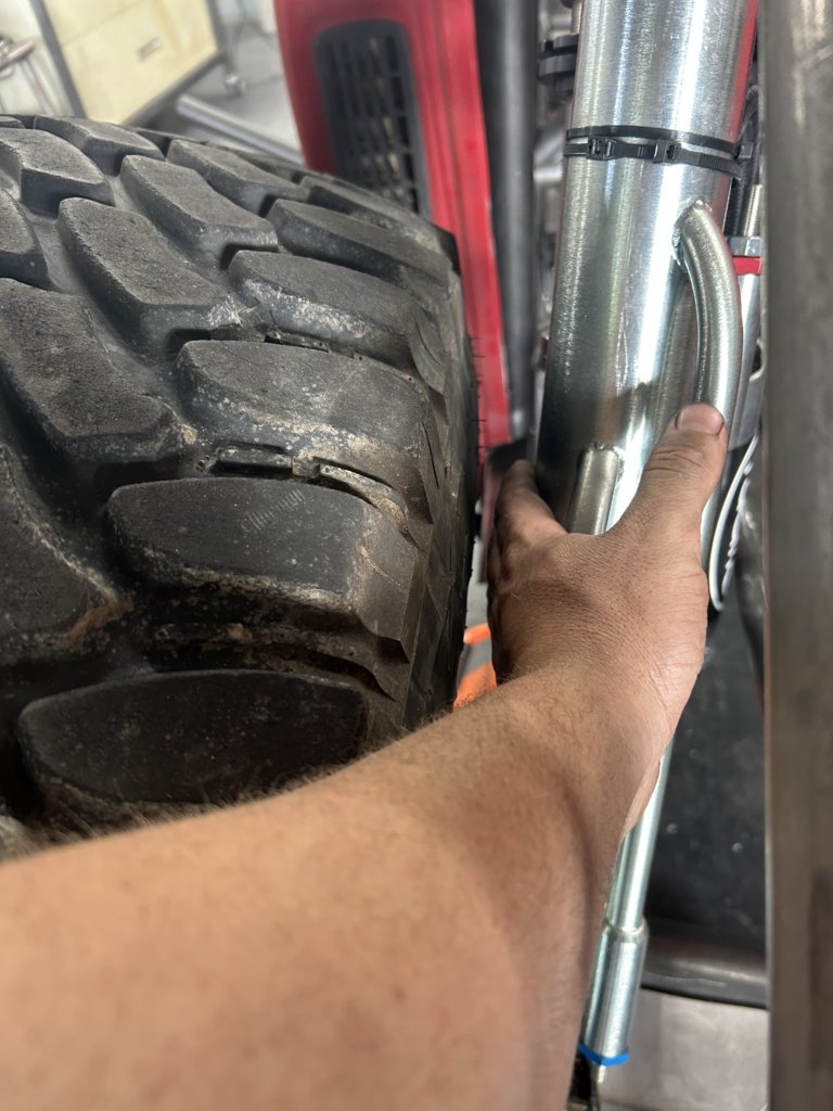

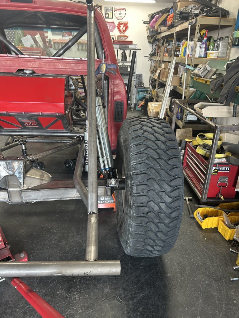

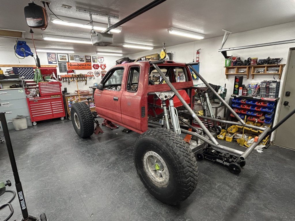

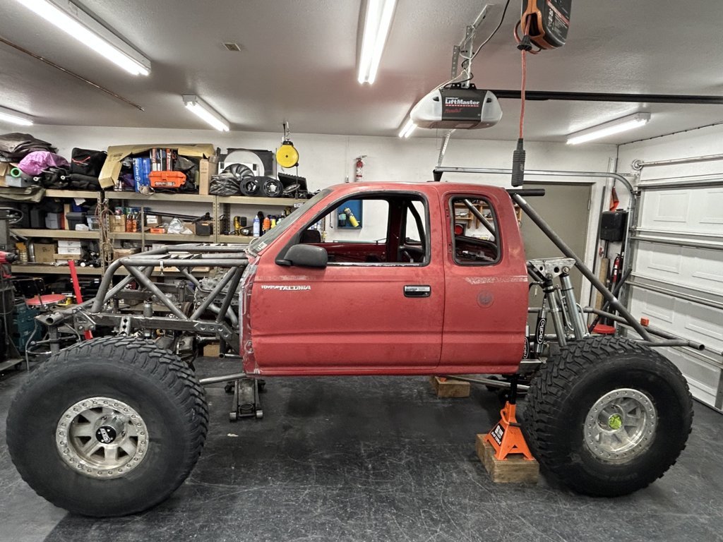

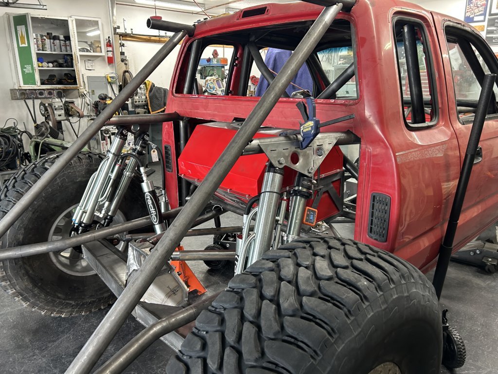

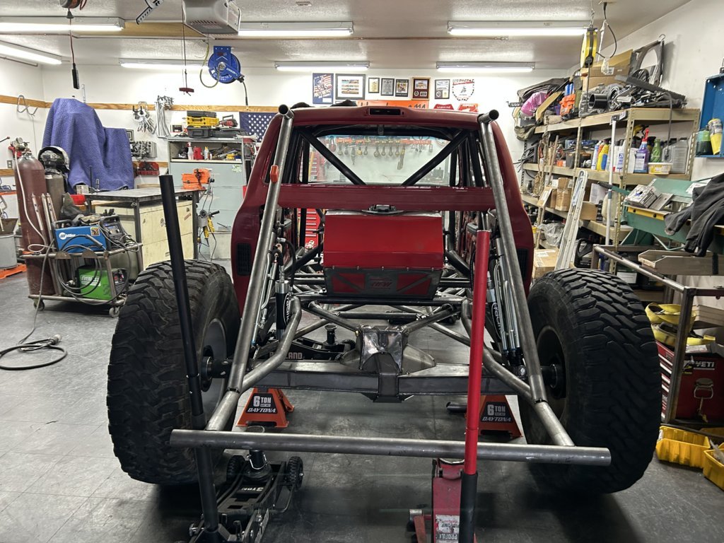

    Spent yesterday messing with the rear shocks. I didn’t like how much they were angled in so moved the lower mounts in 2.5” which made a big difference. Spent the rest of the day getting the upper mounts to fit.

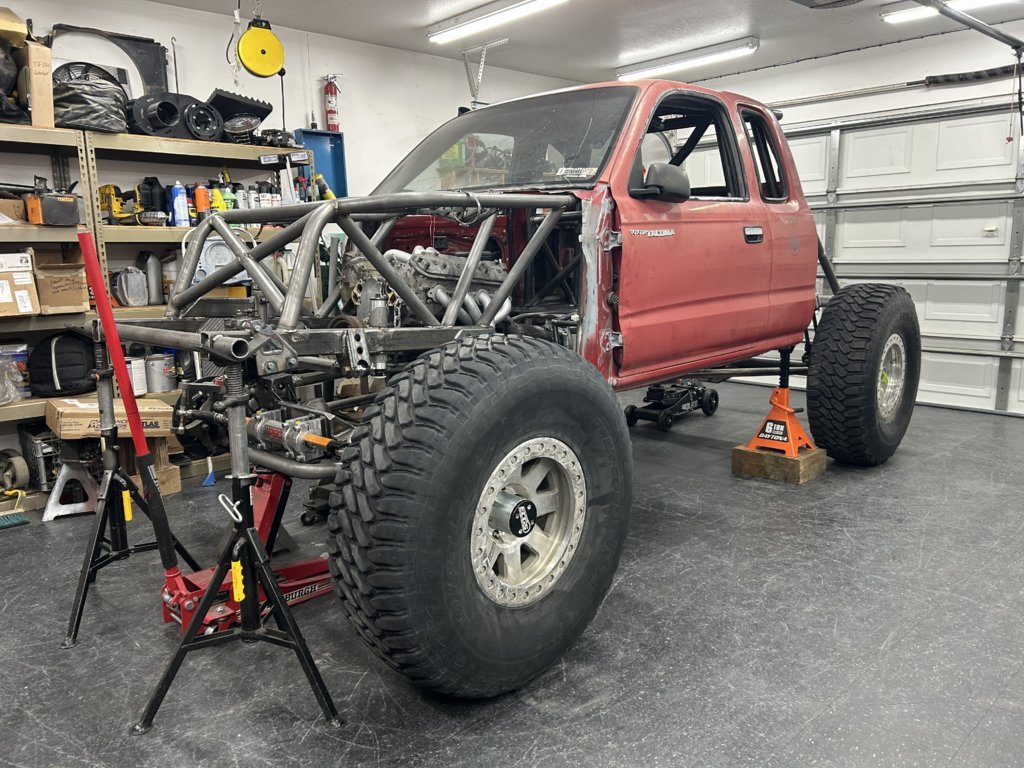

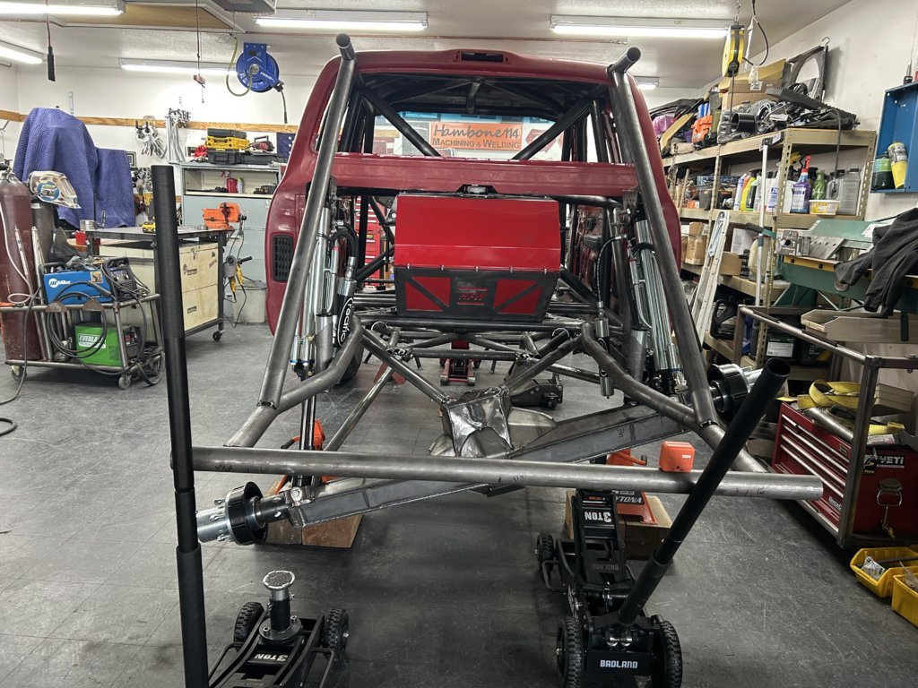

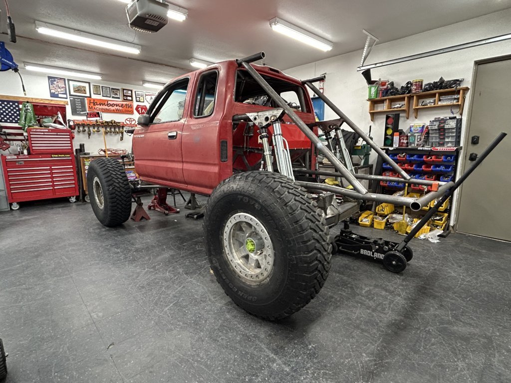

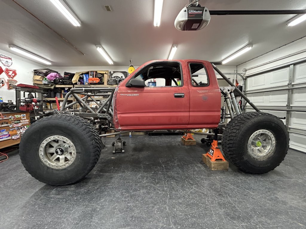

    Spent today putting the truck at ride height so I can cycle the rear. Threw a tire on the front and extremely happy with the overall look etc. 116.5 ish wheelbase. 22.5 to the bottom of the subframe. 27” to the bottom of the body seam under the doors. 7.5” of uptravel in the front and 8.5” in the rear. Overall I think it has a great look and stance.IMG_9825.jpg IMG_9826.jpg IMG_9827.jpg IMG_9830.jpg IMG_9828.jpg IMG_9829.jpg
  5. Jun 3, 2025 at 8:09 PM
    #145
    malburg114
    malburg114 [OP] Well-Known Member
    Dec 26, 2012
    #93766
    3,816
    Las Vegas, NV
    2001 Toyota Tacoma TRD

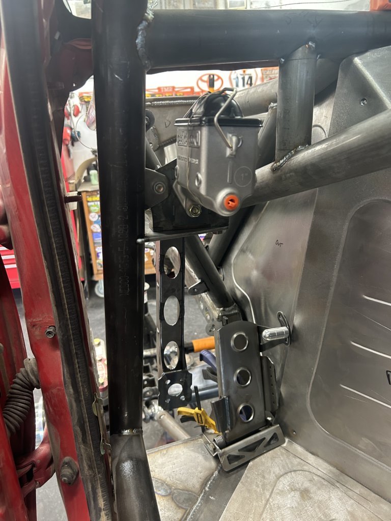

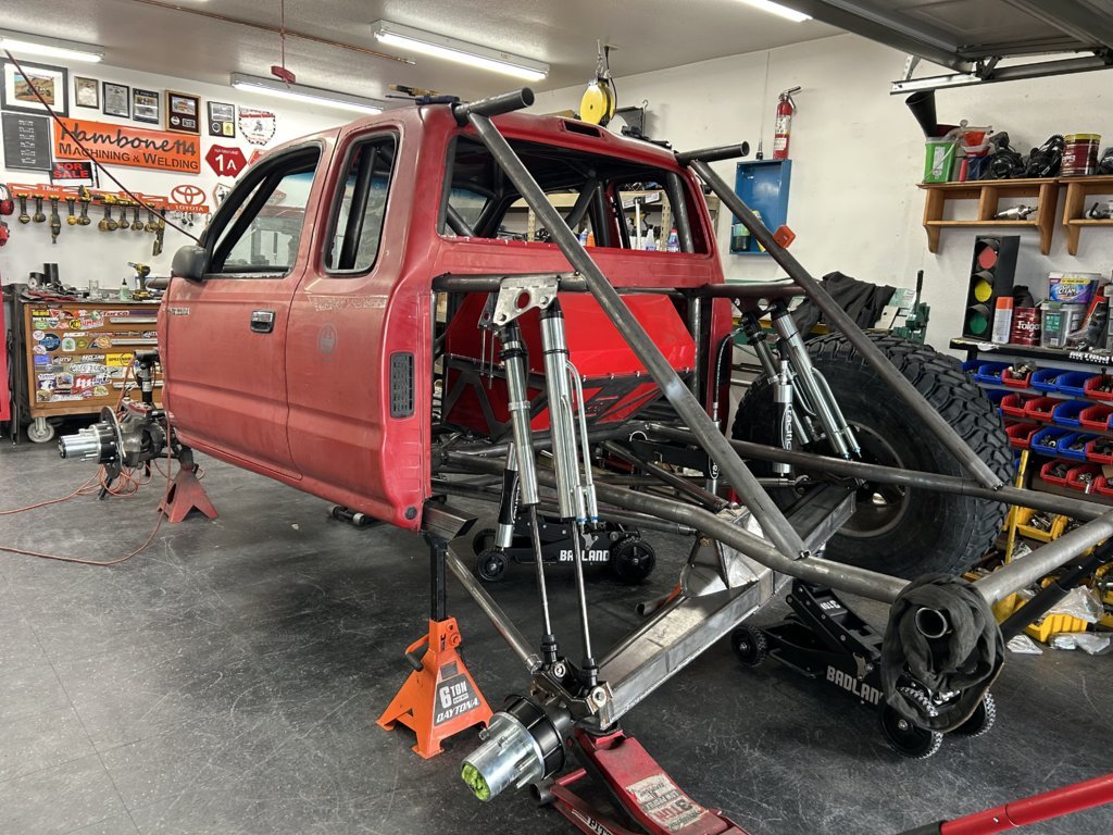

    Then cycled the rear and got the bumpstops mounted. Now for the long process of grinding and welding and adding more tubes/gussetsIMG_9840.jpg IMG_9841.jpg IMG_9842.jpg IMG_9839.jpg IMG_9838.jpg IMG_9837.jpg IMG_9843.jpg IMG_9844.jpg

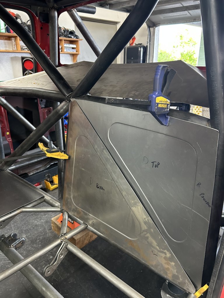

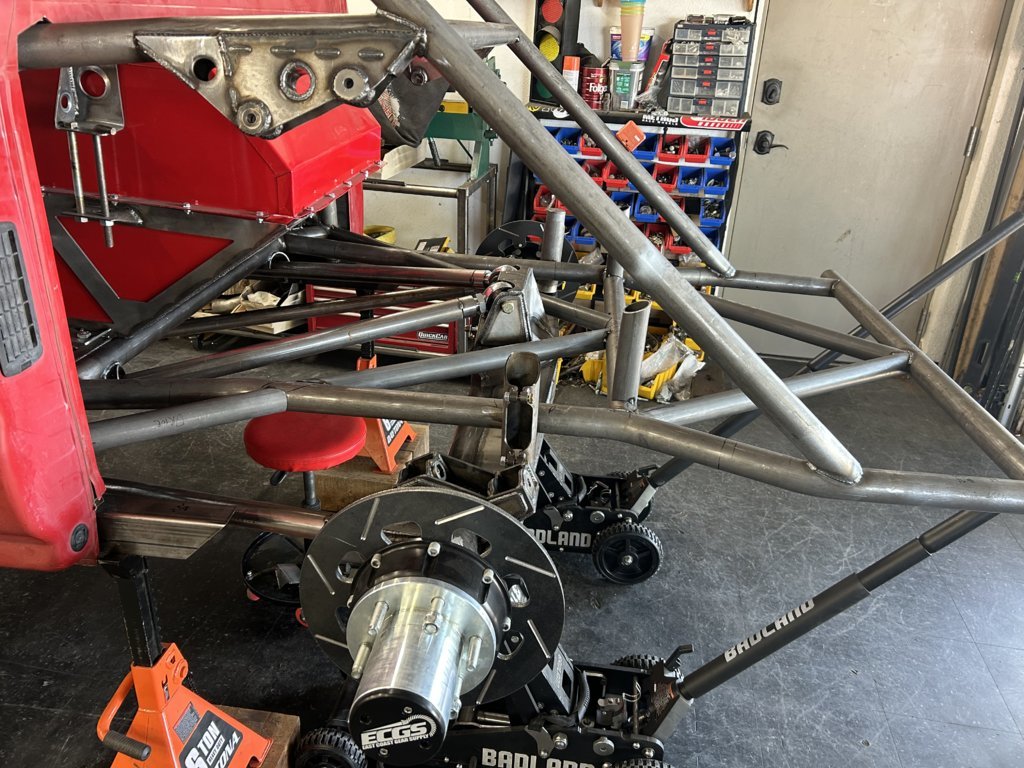

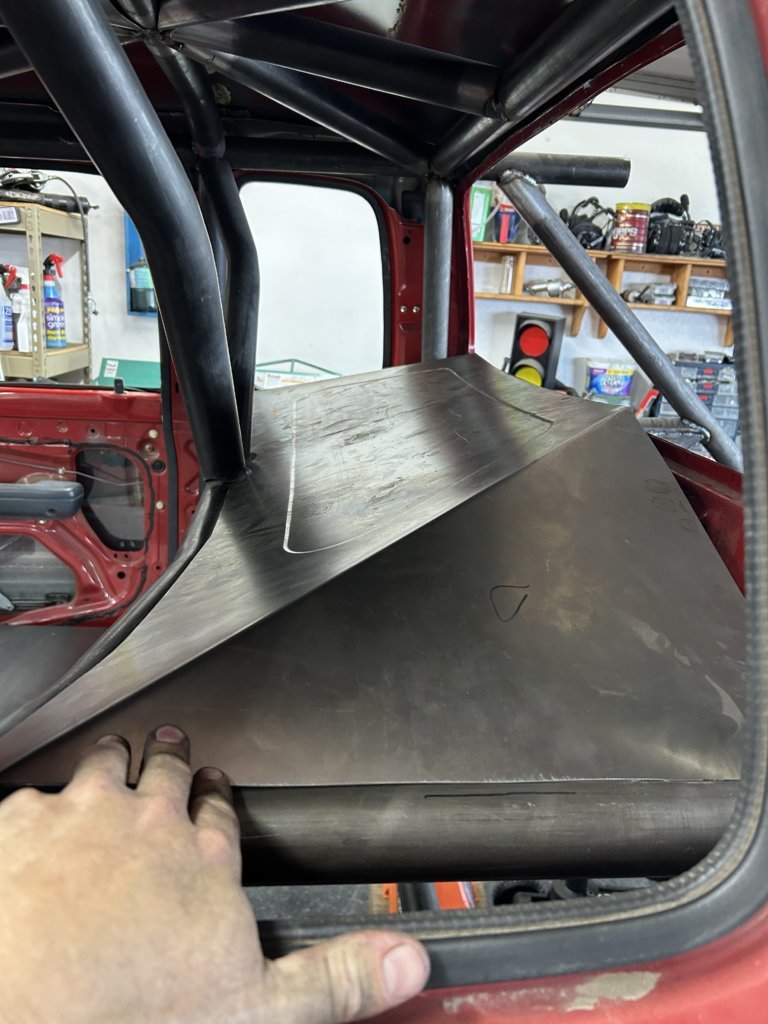

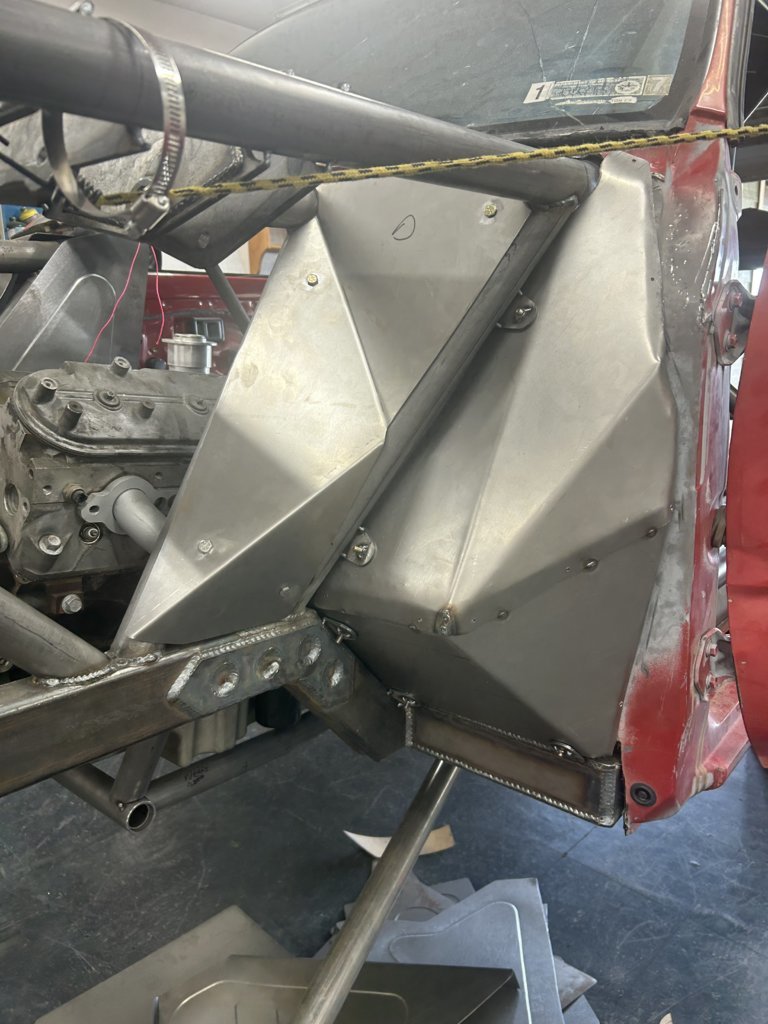

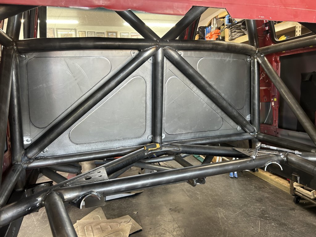

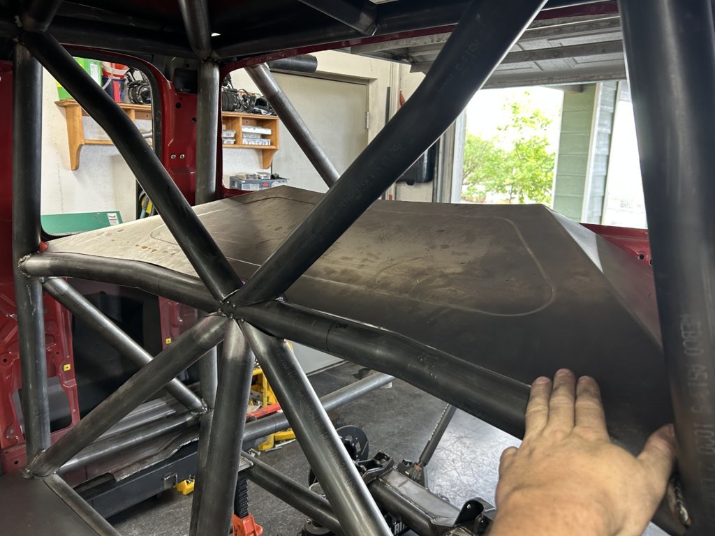

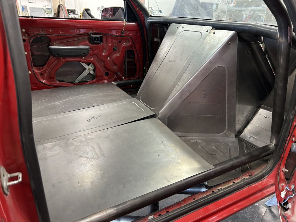

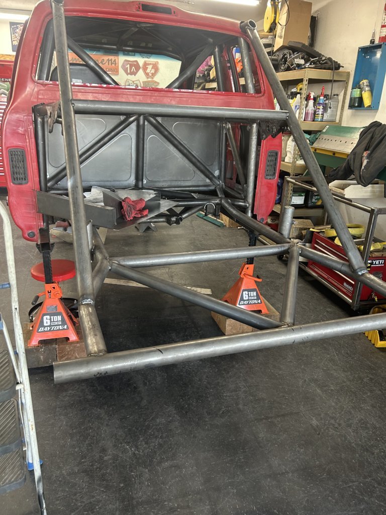

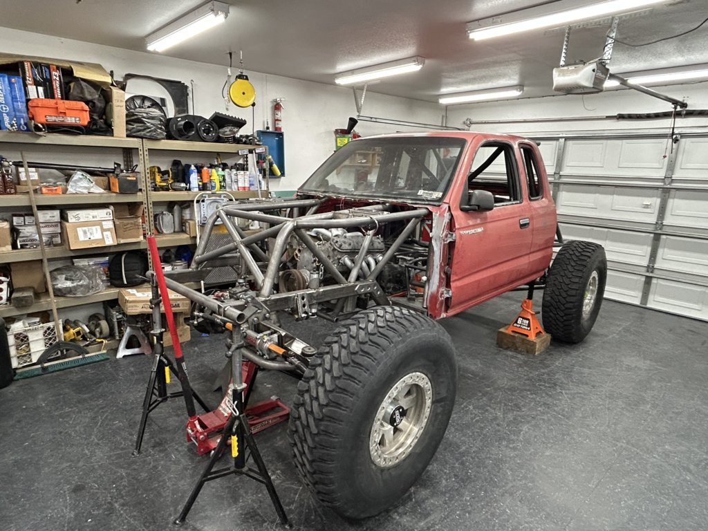

    wasn’t feeling great the last 2 weeks but finally got a few days in the garage. Got most the rear frame welded and a lot of the cage that I could easily get to. Then started on the sheet metal. Trying to get the cab enclosed so I can pull the cab and finish welding the cage

    Few more. A lot of the gaps will close up once I get tabs welded to the tubes and everything bolted up.

    More sheet metal. Pretty happy overall with it.

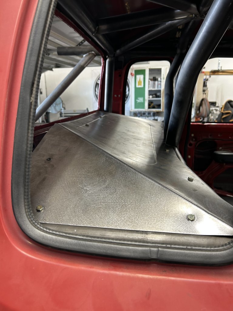

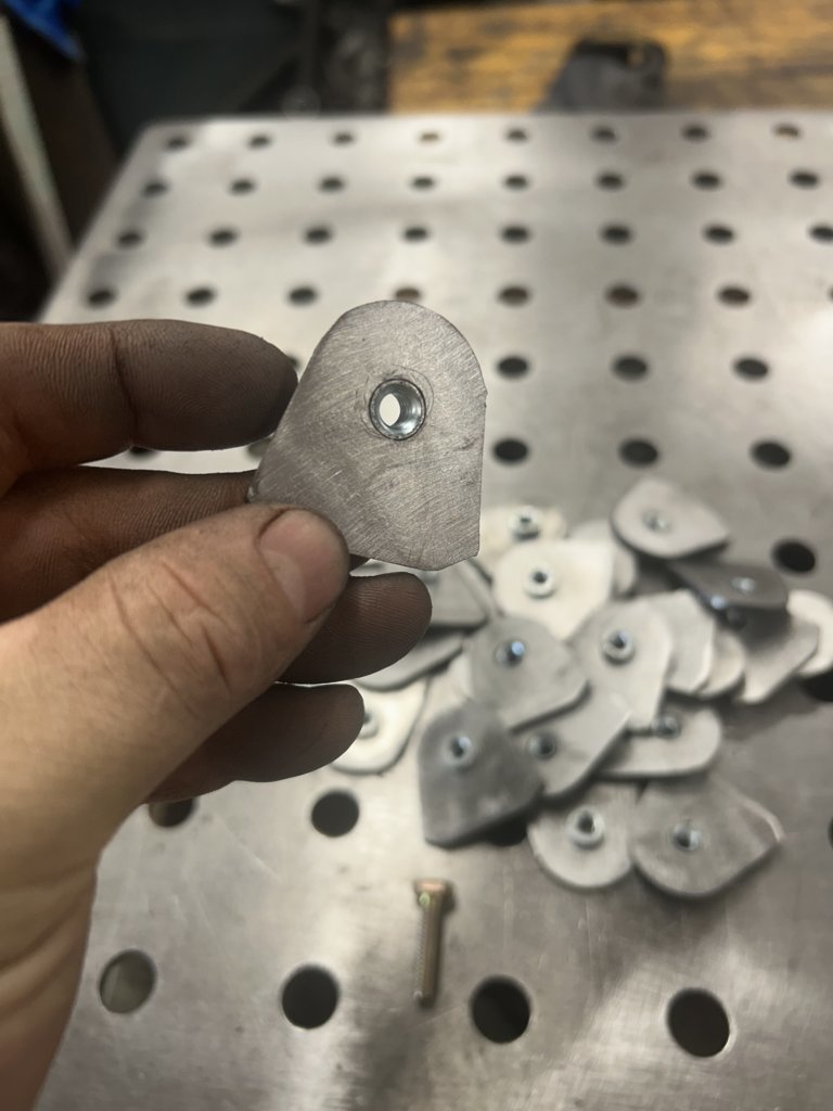

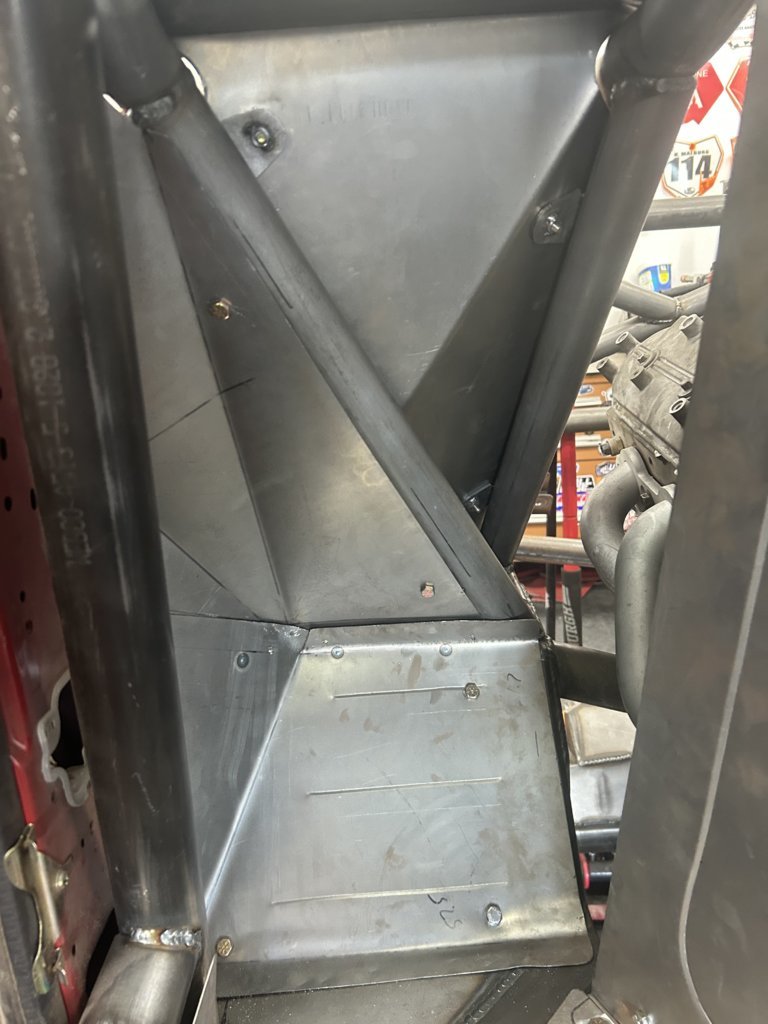

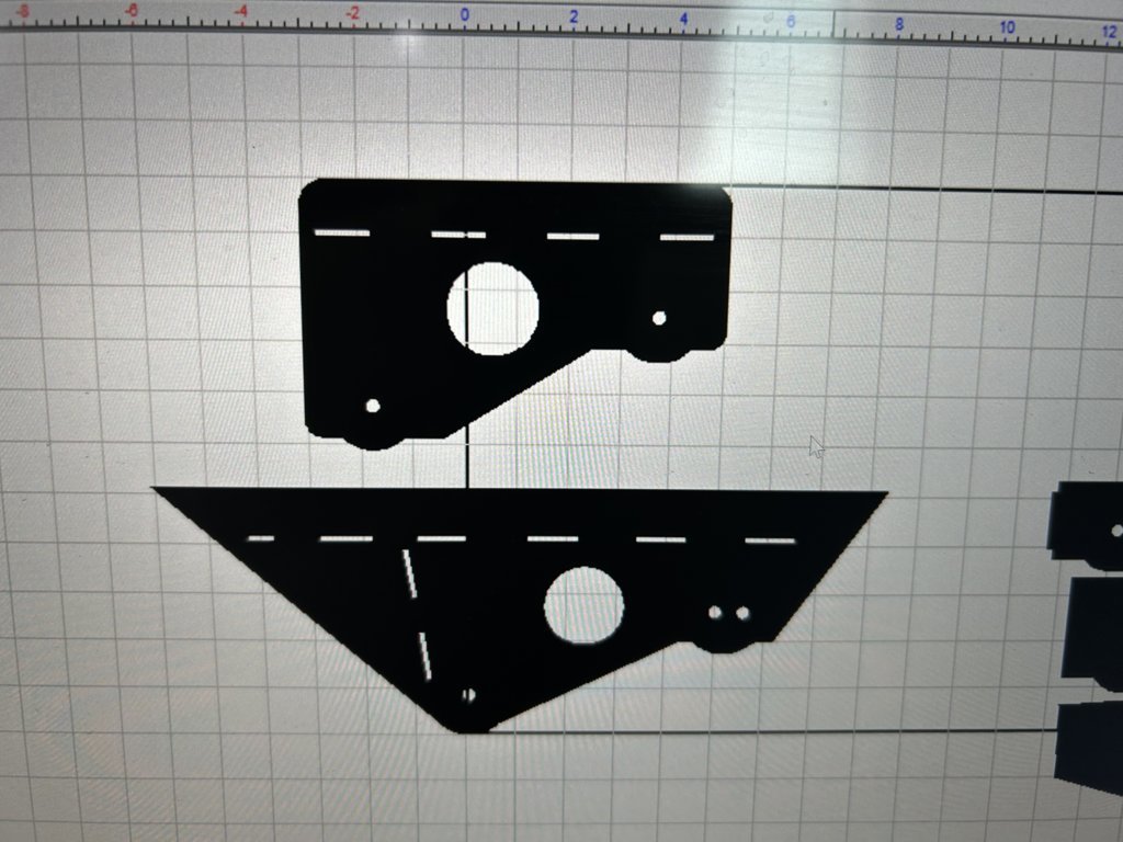

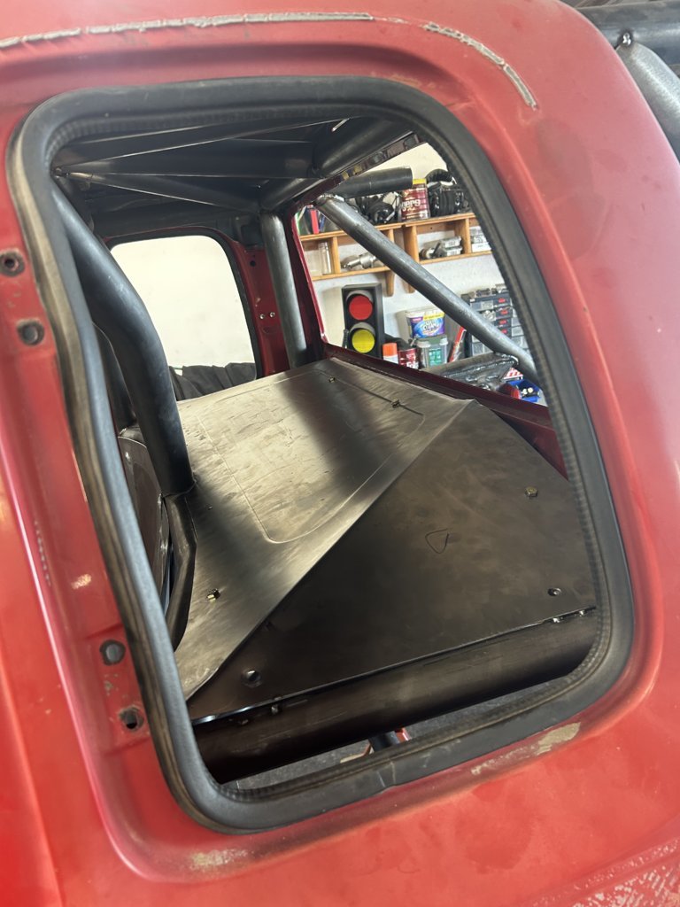

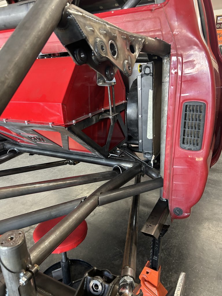

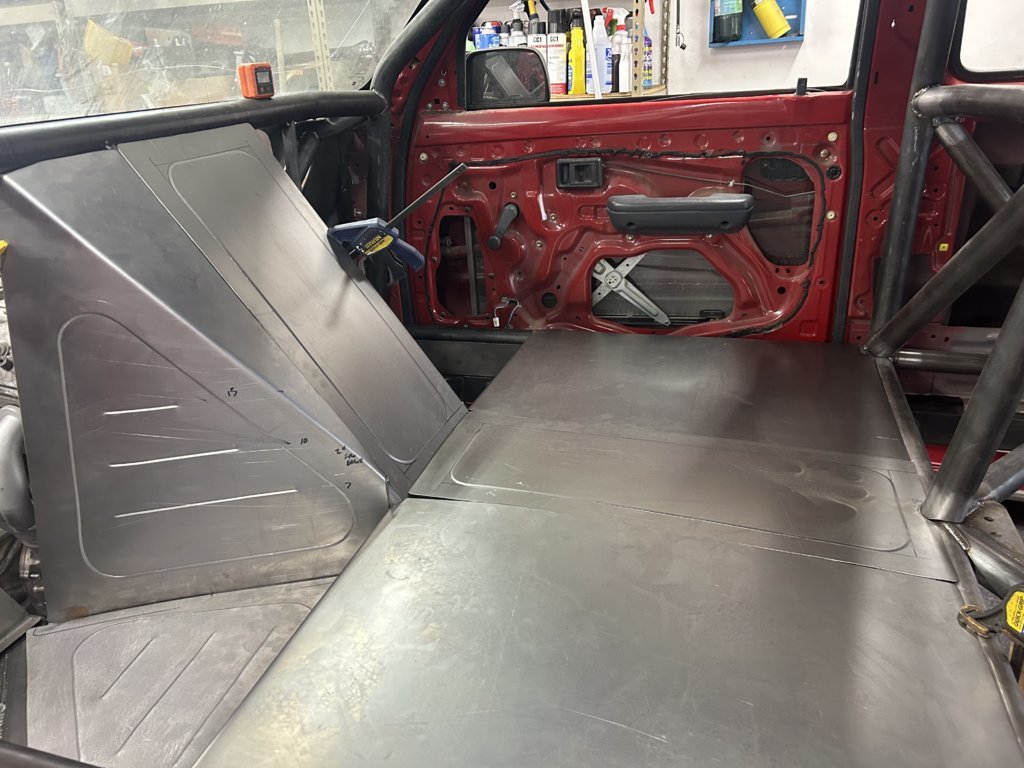

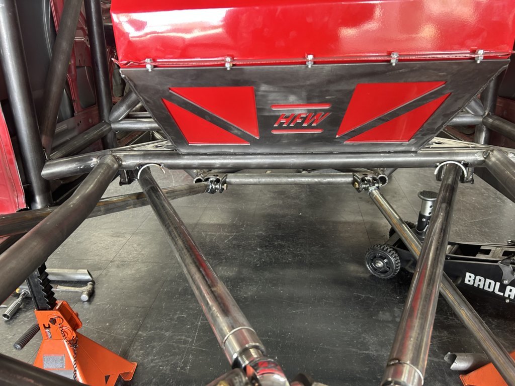

    Made some tabs out of 1/8 with 1/4-20 stainless press in nutserts. Called for a 3/8 hole which I did but some push out so I put a tac on them. Starting tabbing out the panels which is a lot of work but got most the driver side panels done. I made 24 tabs and only have 5 or 6 left. Pretty happy with the look

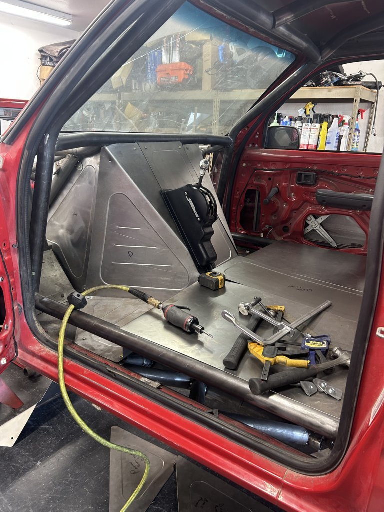

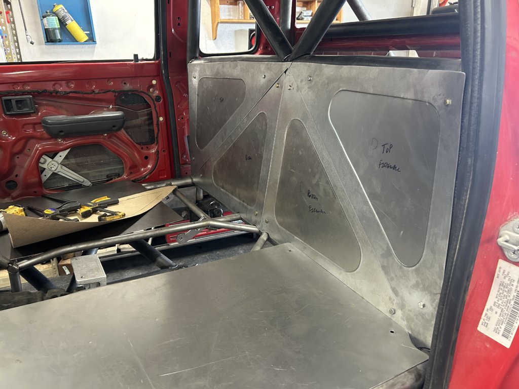

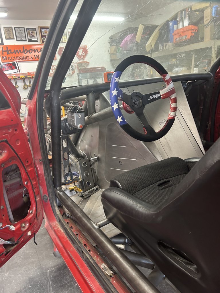

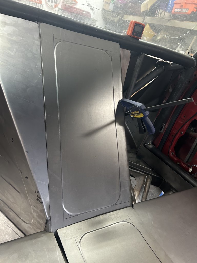

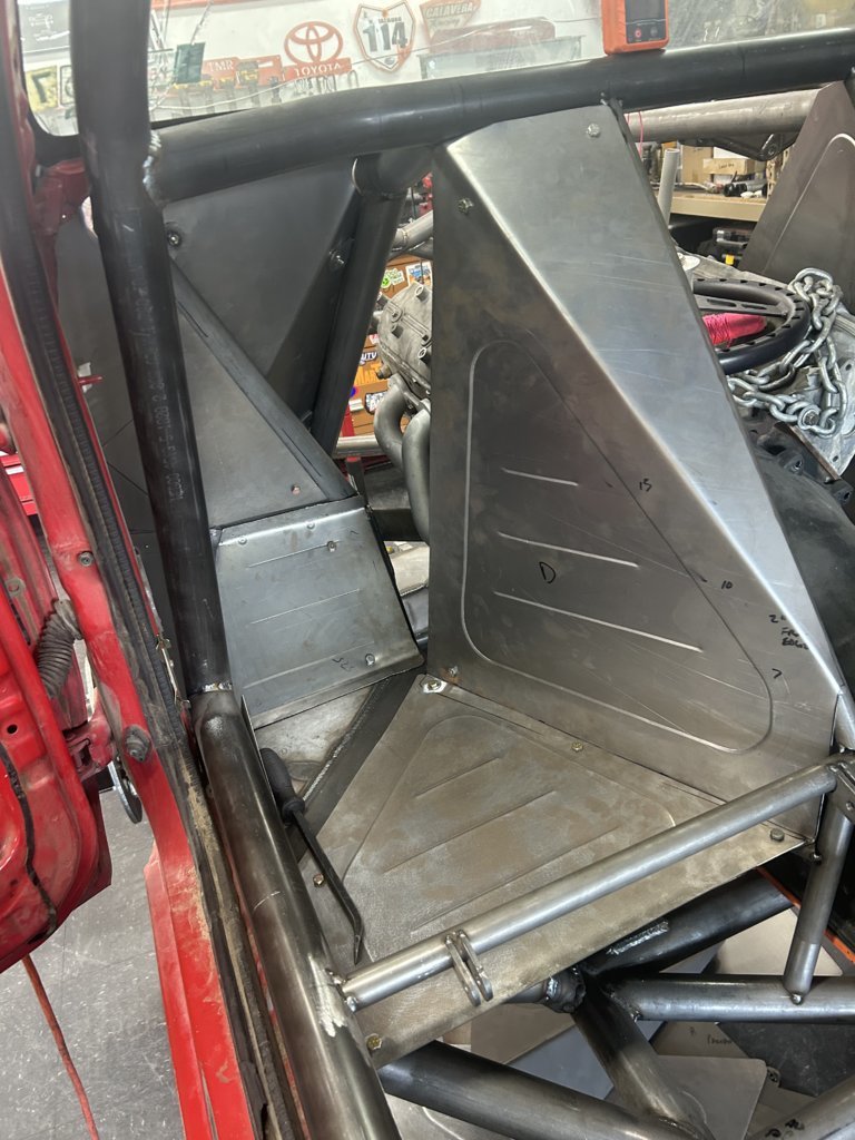

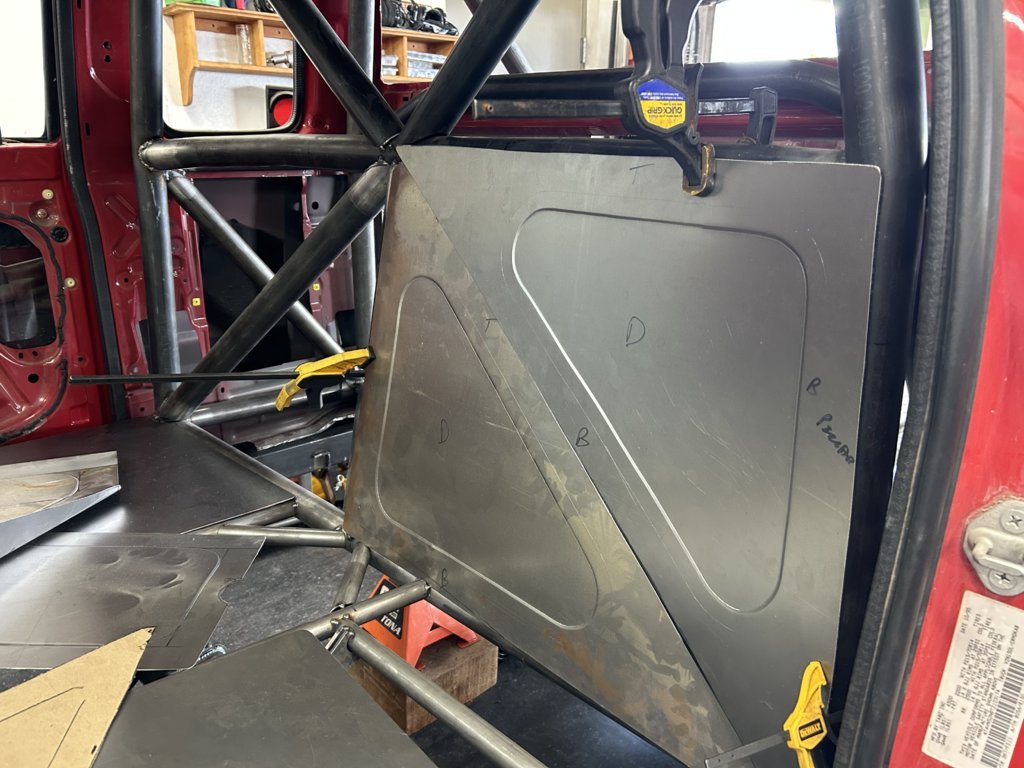

    And got the firewall done behind the seats. I think I have all the panels cut and bead rolled. Only other ones I know for sure I want to do is in the top of the b pillar but I want to bead rolled and cut the middle out to add mesh to keep rocks out of the radiator.IMG_0021.jpg IMG_0022.jpg IMG_0025.jpg IMG_0027.jpg IMG_0028.jpg IMG_0029.jpg

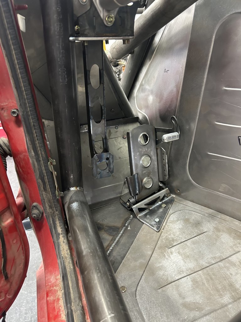

    Firewalls done. Few more panels and the panels will be mostly done.IMG_0047.jpg IMG_0046.jpg

    Mas panels… can’t wait to be done with them. Just one more section around the fuel cell to doIMG_0065.jpg IMG_0066.jpg IMG_0059.jpg IMG_0058.jpg

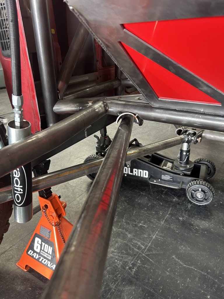

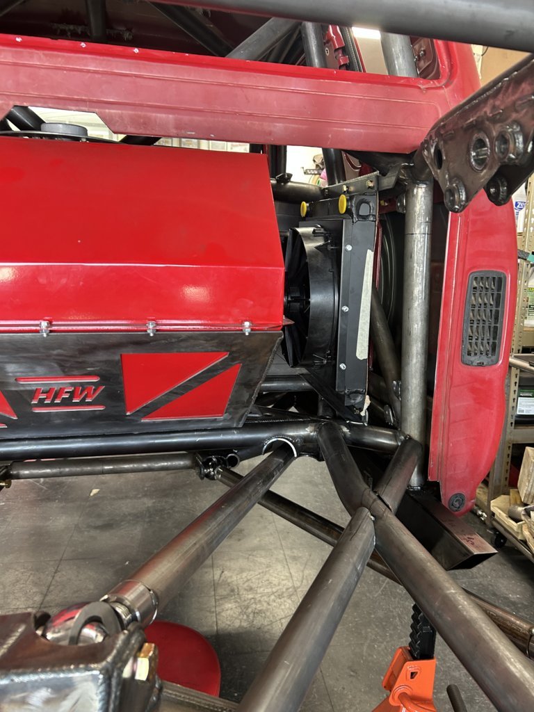

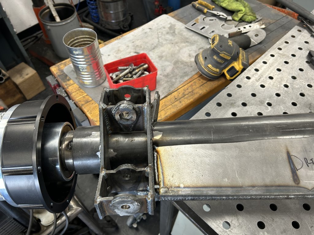

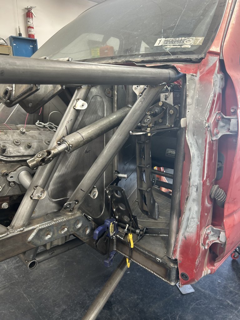

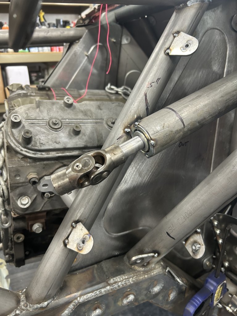

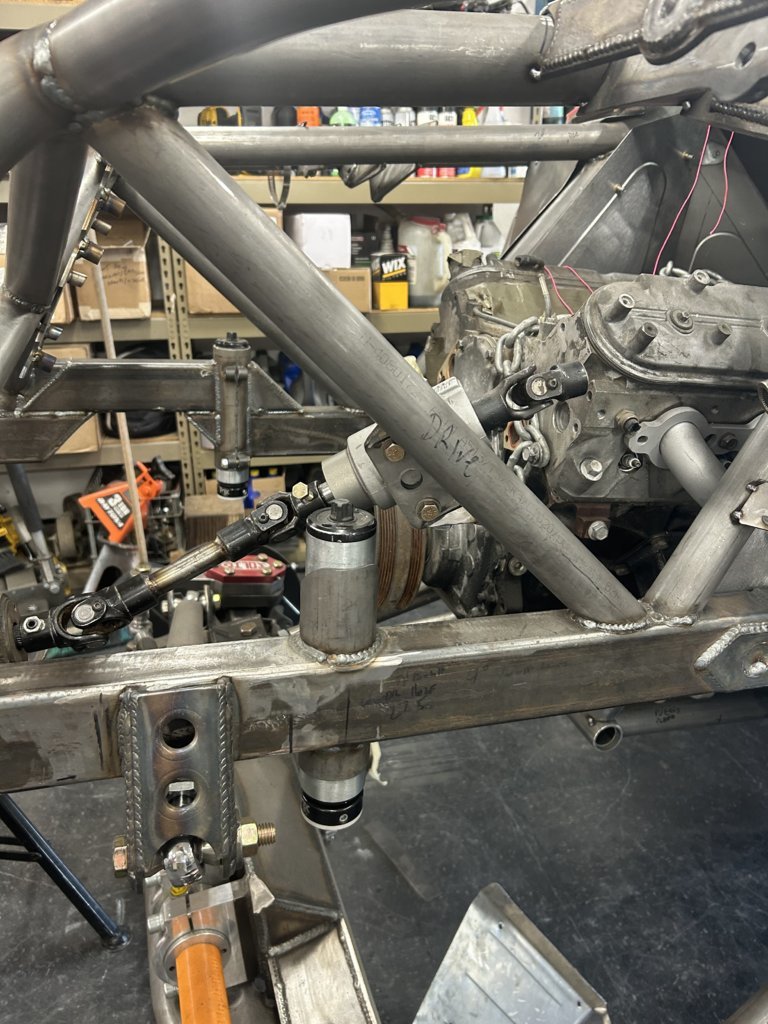

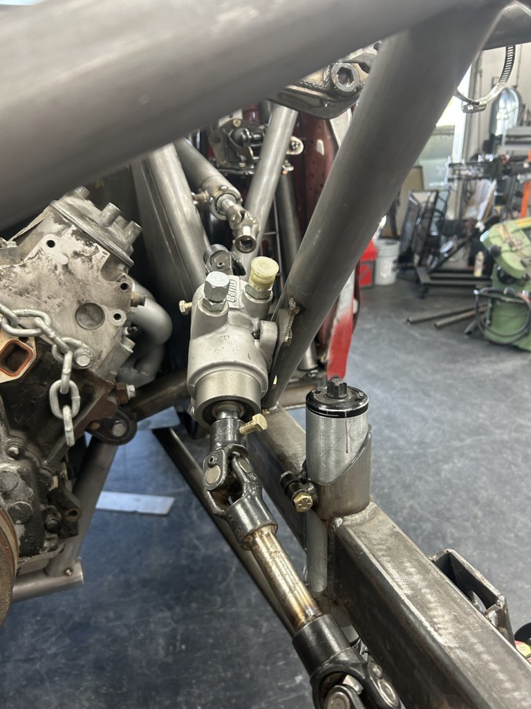

    My dad’s here for a few days and we are getting things done. Steering is in minus one link between 2 u joints. Also got the brake pedal mounted. Few more tubes in the rear. Didn’t like the summit radiator I got so holding off on mounting that while I wait for a griffin one to show up. Got the power steering cooler mounted in the front as well.IMG_0072.jpg IMG_0073.jpg IMG_0074.jpg IMG_0075.jpg IMG_0076.jpg IMG_0077.jpg IMG_0078.jpg IMG_0079.jpg

    got more stuff done before my dad left. We got the trans cooler in. He got a bunch of tube in the rear and I got the gas pedal in and fit a few tubes in the subframe to brace the upper rear links. Minus an upper tube for the radiator and a lower tube over the tire, and some gussets in the front engine cage, between the roof bar and a pillar, and between the rear upper shock mounts, I think the tube work is done. The tubes sticking up off the rear near where rhe axle bumps are to keep the tire from sliding forward. There’s one set of dead tubes where the rear axle bumps but didn’t have much of a choice. Axle bumps so high it screwed up my plans to run them to the center under the fuel cell.
    Overall happy with all the work. The air filter is way bigger than I expected so it’ll mount between the seats. Just need to find some 4” tube that’s reasonably priced. Ill end up making a dash that comes towards me as everything is to far to reach switch panel wise.
    A lot of work left but feeling like I’m getting a lot done. Going to focus on finishing the gussets and tubes so all I have left after that is bumpers. I’ll cap everything that needs capped and then probably move onto a dash.
