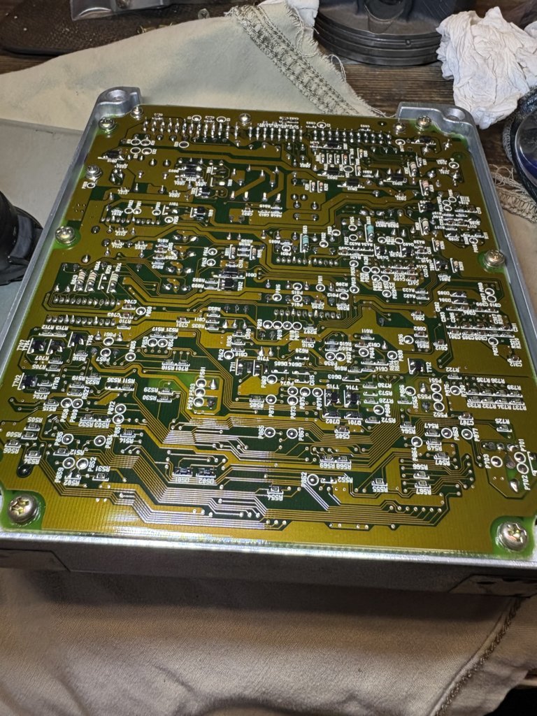

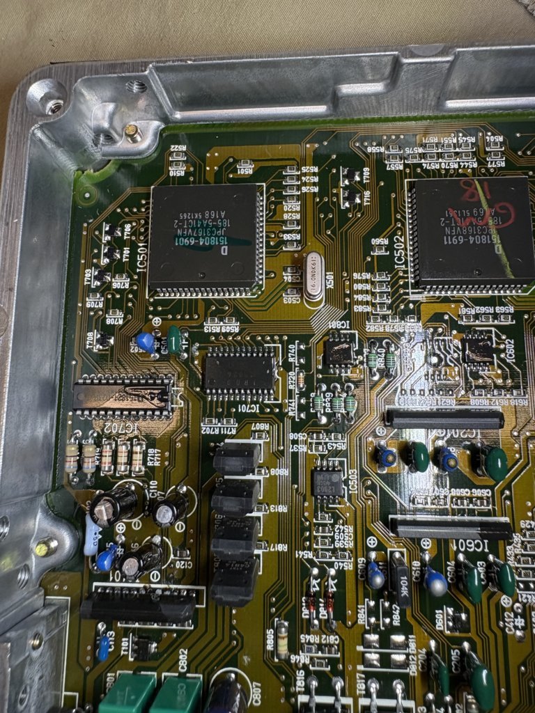

    10mins with magnifying glass and lite
    Nothing jumps out

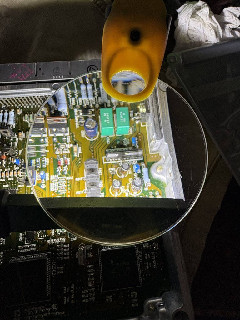

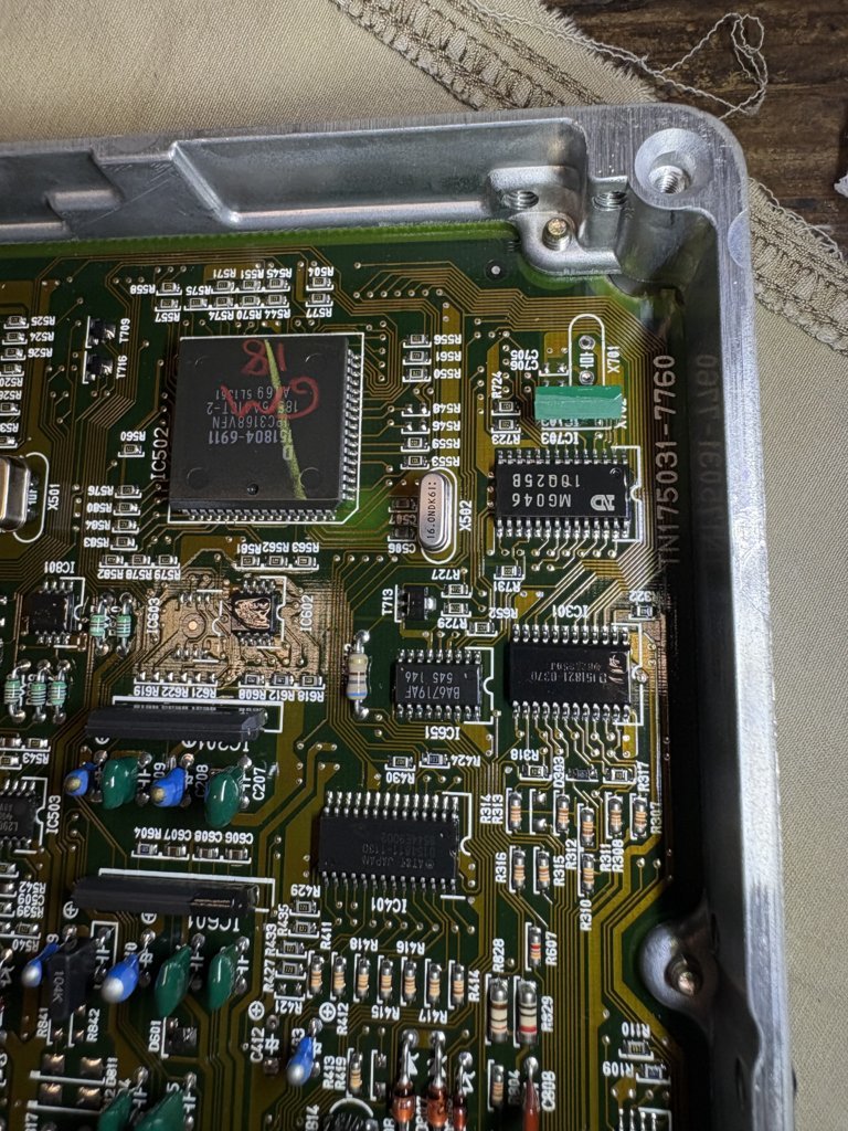

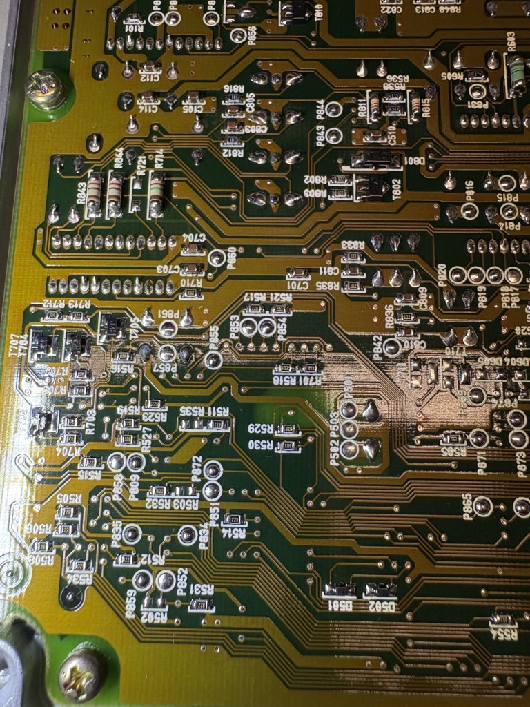

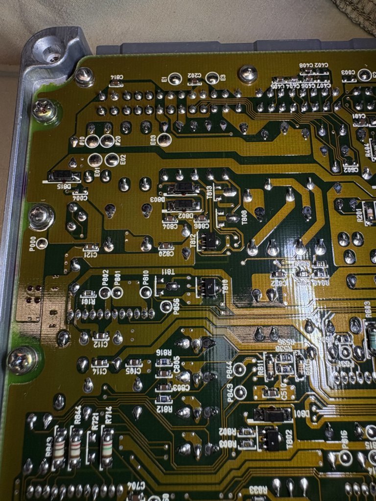

    back:

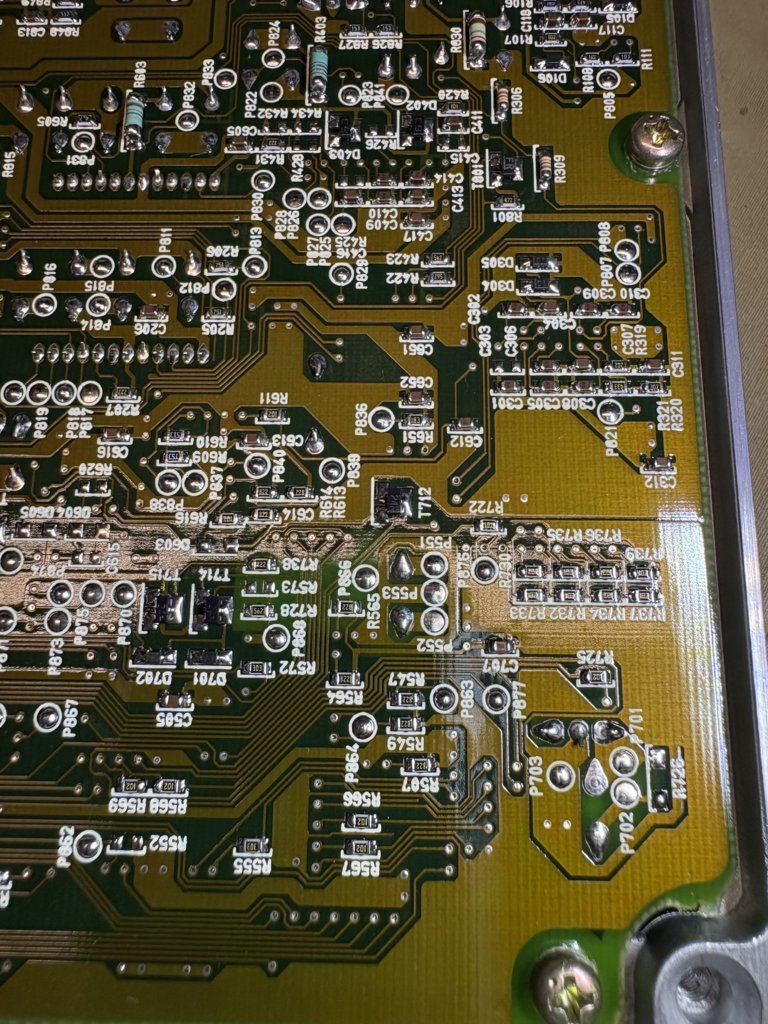

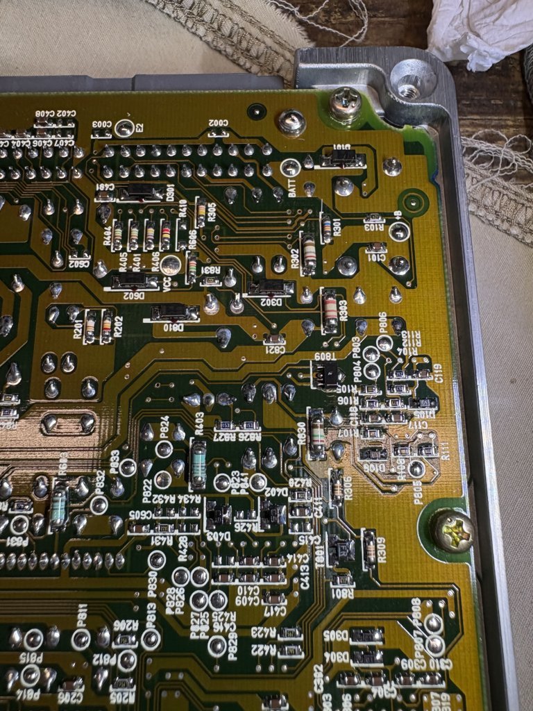

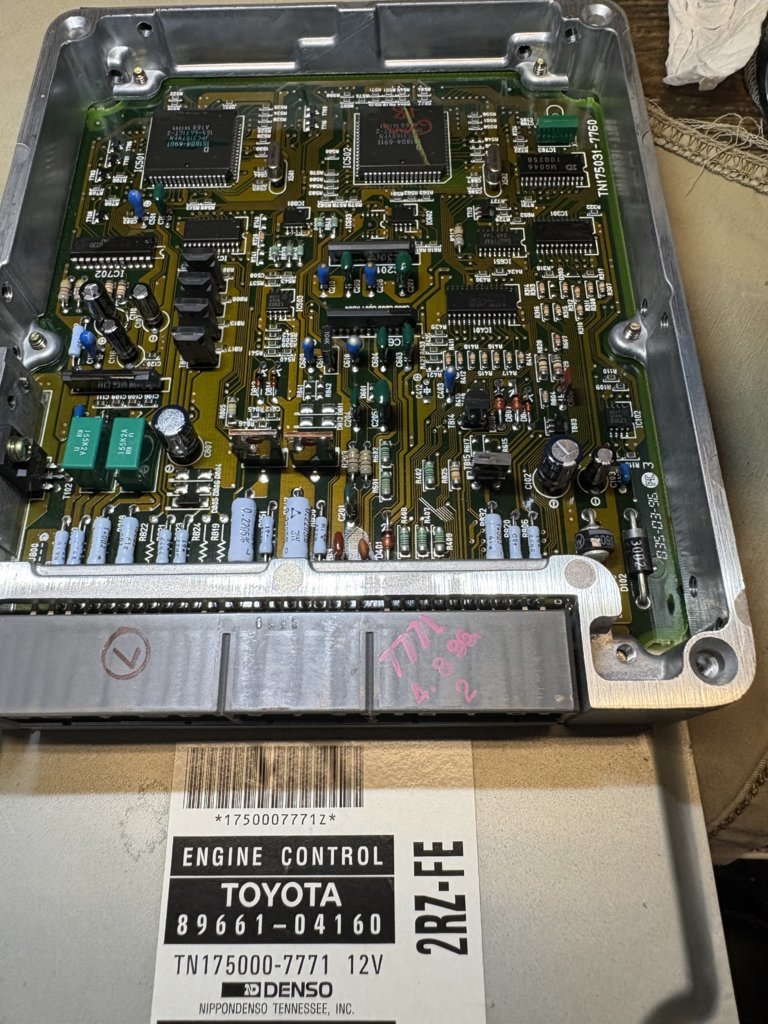

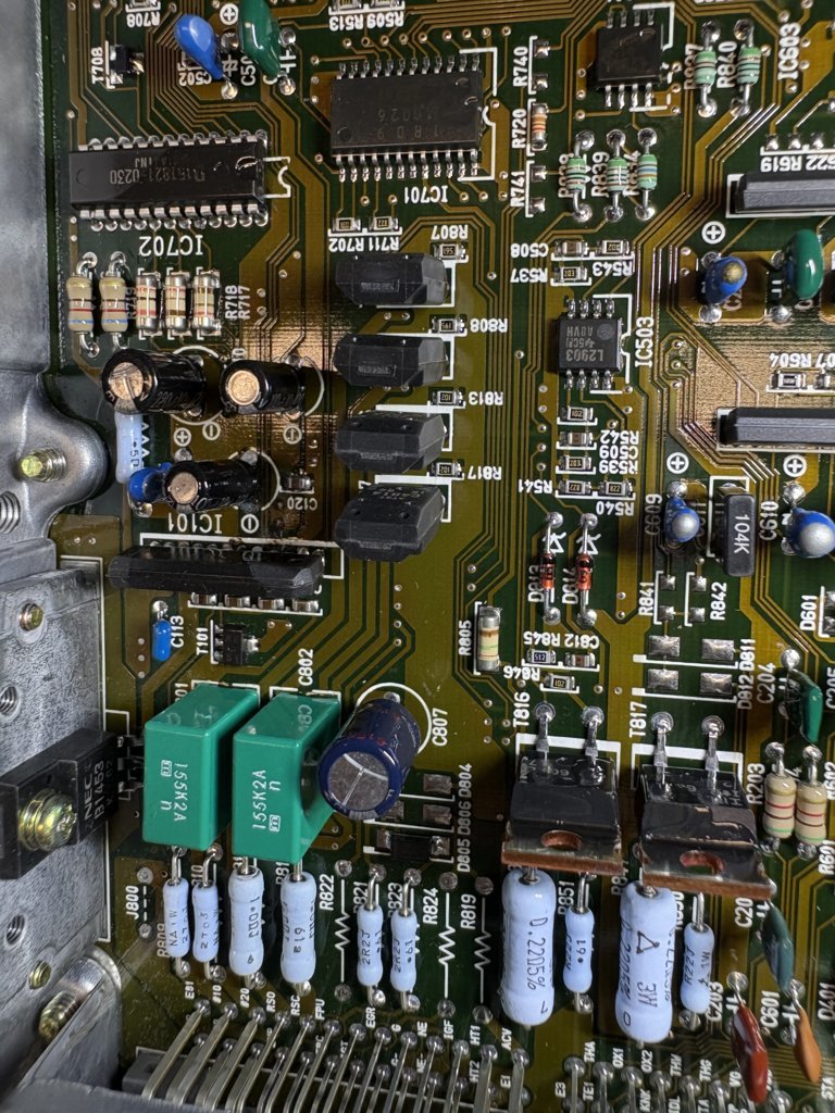

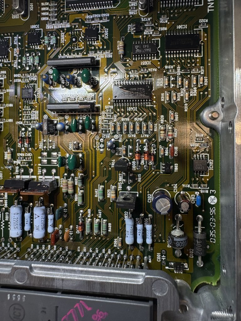

    Front:
    All those squares and rectangles have what appears to be wet substance on them
    But all have it and completely dry
    (Like a coating)

    IMO
    Not enough evidence to buy a $500 RM unit
    going to inspect the 3 pigtails now
    thanks for anyone’s advice

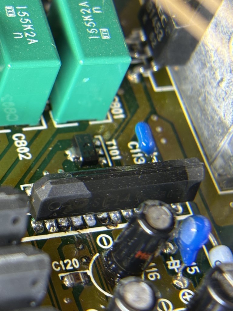

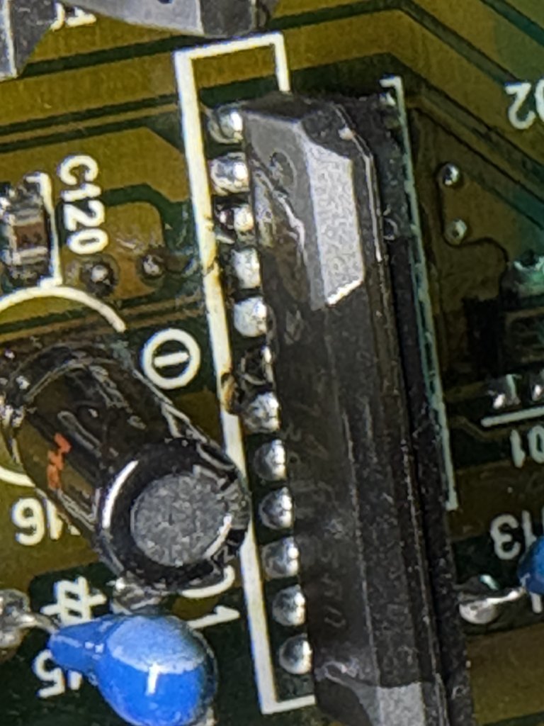

    Pigtails look fine
    took another stab with magnifying glass
    hmmmm
    opinions????

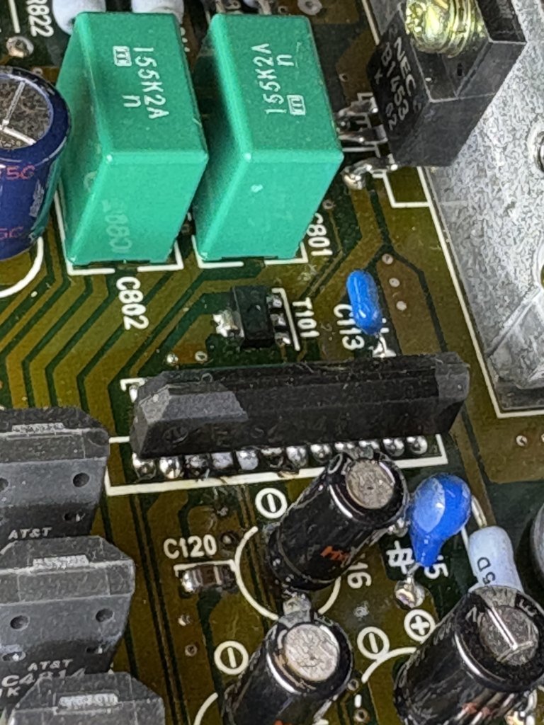

    Lil better pix
  11. Sep 2, 2025 at 4:51 PM
    Moonrman
    Moonrman Fix it and it will run
    Dec 9, 2019
    #312891
    565
    Hill Country, TX
    2001 Dbl_Cab Prerunner TRD
    You thinking that black cap with the red marks on it might be a culprit???
    ControlCar[OP] likes this.

    Capacitor nearest to vertical black box
  13. Sep 2, 2025 at 4:55 PM
    ControlCar
    ControlCar [OP] My Moto: Help & Learn…period.
    Jul 22, 2023
    #429578
    3,778
    Steven
    Sugar Land TX
    1996 Taco 2.4L 2wd Automatic
    Clock Volt meter/LSPV Delete/Hyundai 16’s/FP gauge/after 9months of wrenching ZERO oil leaks
    well thought few feet burnt on the box
    Then just saw what you saw
    (That is same component you mentioned)
  14. Sep 2, 2025 at 4:57 PM
    Moonrman
    Dec 9, 2019
    #312891
    565
    Hill Country, TX
    Yeah looks grundgy from that angle at bottom on pcb, hard to say it's causing it but not a good sign.

    i emailed some of those pix to
    -upfix
    -flagship
    -united radio
    want to see what a actual tech says

    Update
    4 out of 4 car friends say “can’t confirm but something doesn’t look right “
    on that note
    IM NOT LOOKING FOR CONFIRMATION
    Just opinions you guys
    2 vendors have not replied
    1 vendor, United Radio, responded that the technician mgr out today. I thought that response very nice/professional.
    keep yall posted

    THatt
    THatt Well-Known Member
    Aug 23, 2022
    #404202
    1,090
    Upstate SC
    1996 Tacoma 2.7L MT 4X4
    I didn’t see a picture of underside of card. Anything look out of order that side?
