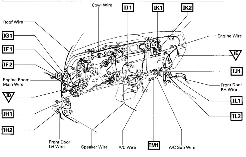

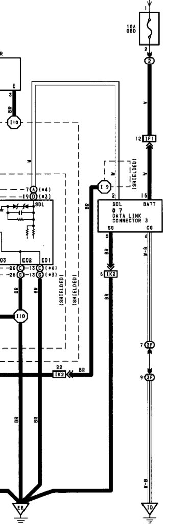

    Only thing I know to do would be check pins 4 & 5 on the DLC for ground.
    And pin 16 for Power.
    I'd suspect you have other issues if any of these were missing.
    Unless your scan tool just uses chassis ground. Then "maybe" you could have a a no com if the CG was bad?
    But not likely.

    The power and grounds at the DLC are not dependent on the ECM being in the truck.
    So no, the ECM doesn't have to be in the truck.
    But you kind of need the truck to be in limp mode to check it.
    If I were a betting man, I'd bet you wont find an issue when checking those pins.
    But it doesn't cost anything to check either.
    Only reason I mention it is because you had a previous Ground issue.
    Again, not likely to find the issue by checking.
    But I'd check the pins and and inspect ground point mounts while I was at it.

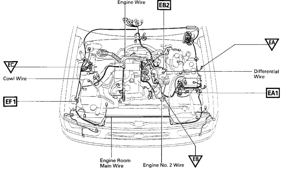

    TN
    EB is 100% good
    going check ID point next
