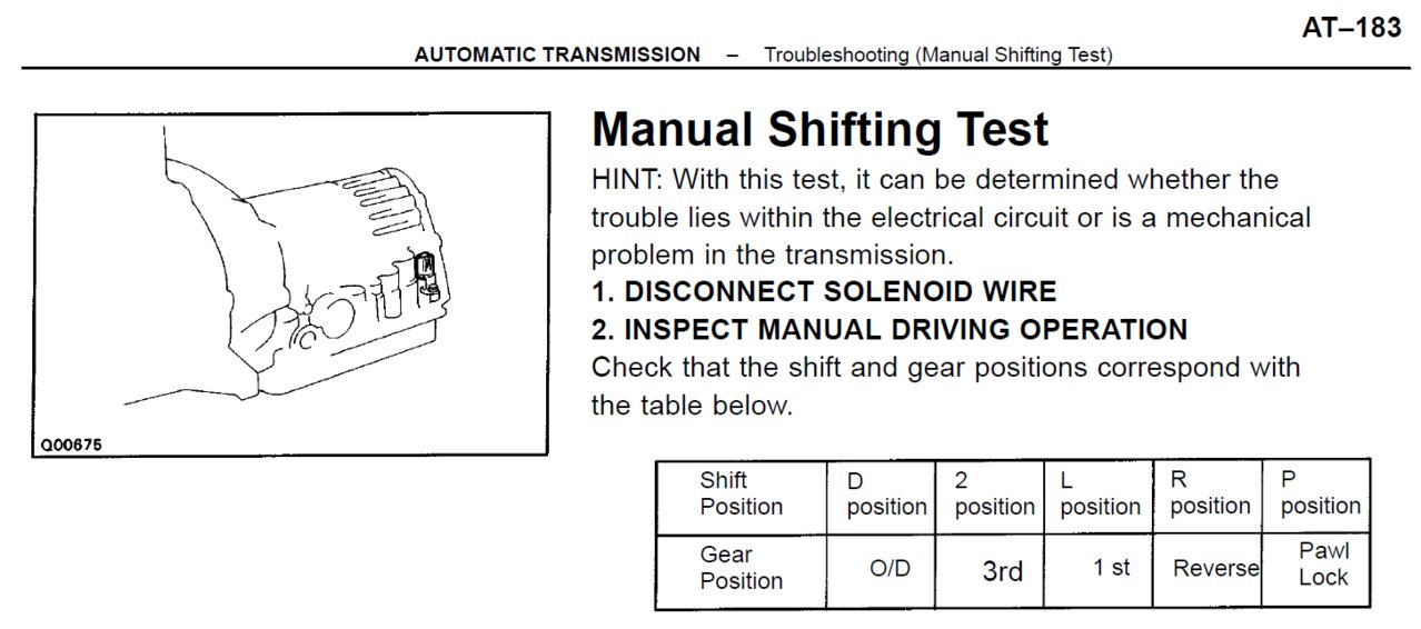

    Gearcruncher: here is the procedure I am following to manually select overdrive:

    I am still a little confused about the manual shifting test .
    You remove the wiring that powers the solenoid on the side of the transmission , then take the truck for a drive and manually upshift from 1st to 2nd to 3rd gear and then manually into drive range ( D ) and the transmission upshifts into overdrive ?
    This seems backwards to the way I test for overdrive and lock up . Generally I had to manually fool the transmission by powering up the solenoid with 12 volts for overdrive . I performed this test on the hoist after the transmission shifted into 3rd gear . The transmission wont upshift to overdrive unless the ecm knows the transmission has already upshifted to 3rd .

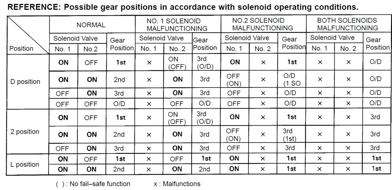

    After removing the solenoid wiring harness, shifting is manual. I start off in L, which is 1st, then move the lever to 2, which actually selects 3rd gear (2nd gear is skipped). Then I move the lever to D, which engages overdrive. I know it's overdrive based on RPM at 60 MPH (versus RPM in 3rd at 60 MPH).
    The A340F has 2 solenoids. Here's a chart:
    Thanks for the manual!

    Thanks for showing the solenoid application chart . I am so use to helping with the 2nd gen trucks with the 5 speed auto , I forget that the 4 speed trans works opposite
