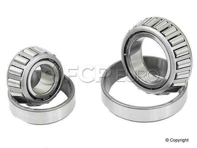

    I'm gonna put my money on Wheel Bearings. [​IMG]

    I hope you're right Steves104x4

    Can't hurt if they've never been done, depending on mileage, I guess.

    Won't you normally get a grinding noise if it is the wheel bearings?? Just from my experience when mine went I had a horrible grinding sound but that was when they were literally falling out of the bearing housing...

    Hey Steves104x4 are you gonna be in Vegas anytime soon? I'd be following your money! Yes its the hub bearing!
    I took it to tire shop today and they showed me the movement in front drivers side wheel..very noticeable. They want $468 to fix it!!
    My question is can i do this ? I have the read the bearing/CV thread on here and i am curious if i will need the shop press and any other tools that i dont have here. I dont wanna get in too far over me head, if you know what i mean.
    Any ideas on price of parts needed for this?

    Well i had the bearing replaced today and i still have the vibration, its not as bad andi have peace of mind that the wheel aint gonna just fall off but i want this problem gone. Next will be u-joint replacement,,man i HOPE that works.
