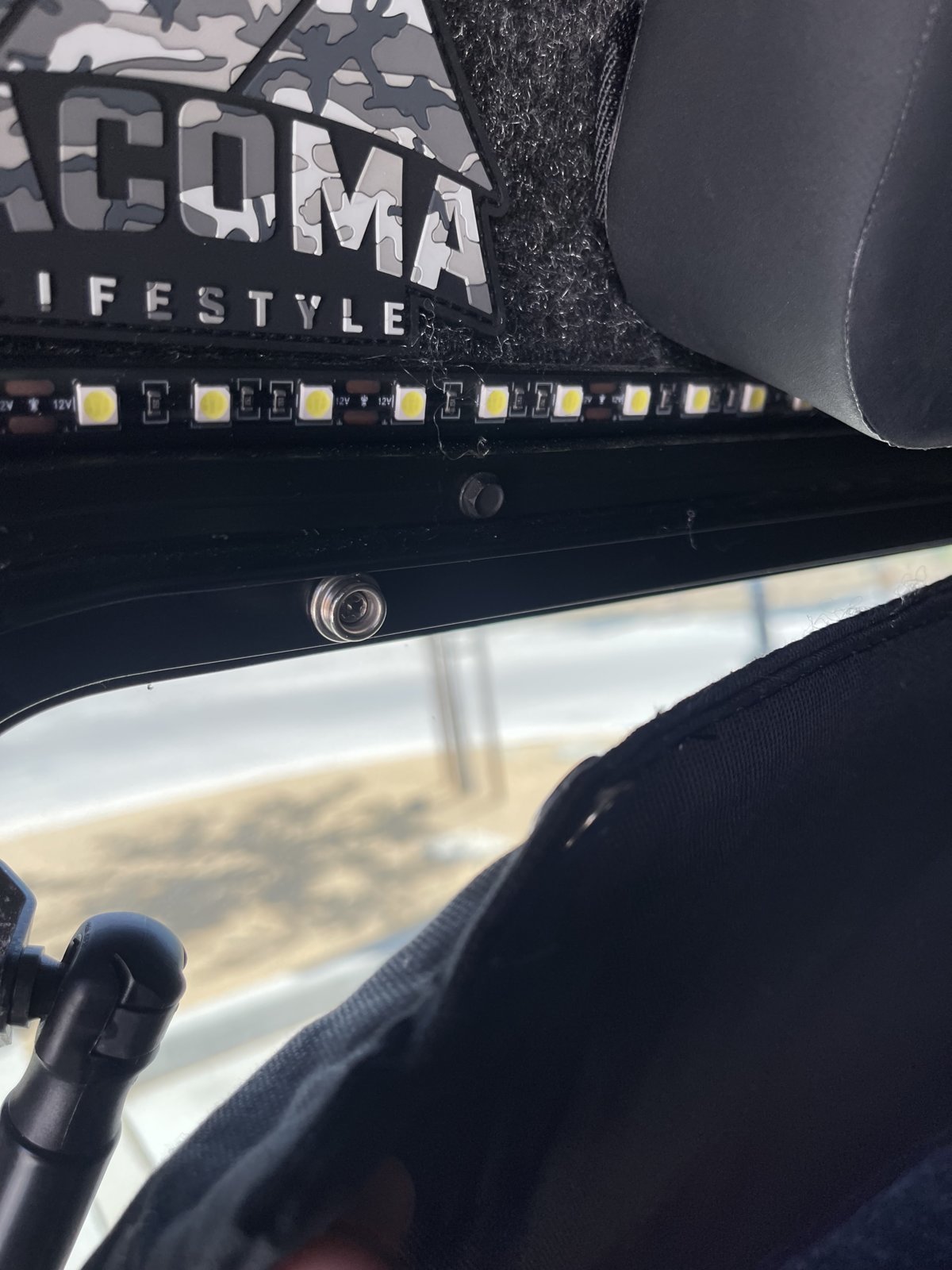

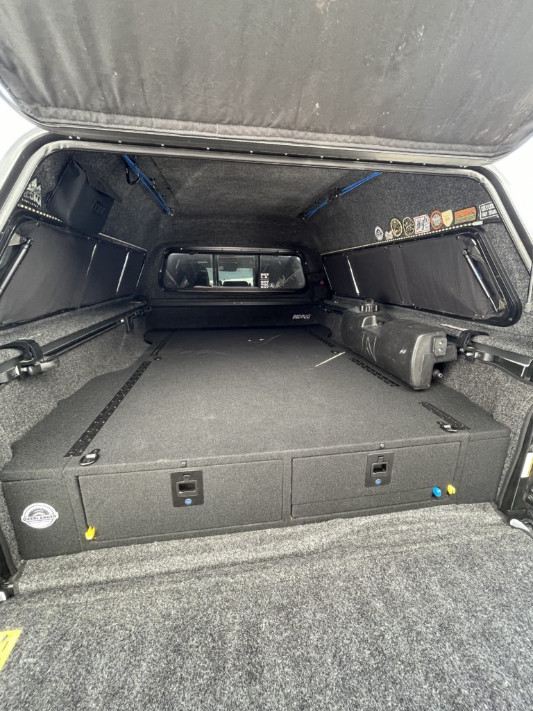

    Got the curtains 99% done

    Some better pics

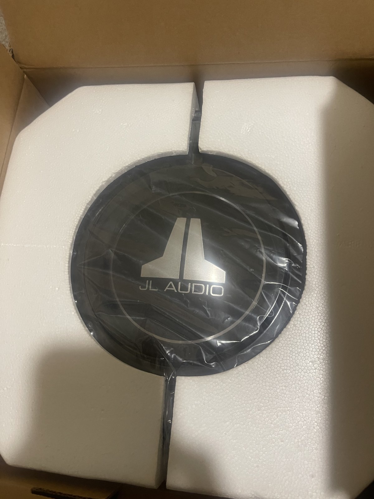

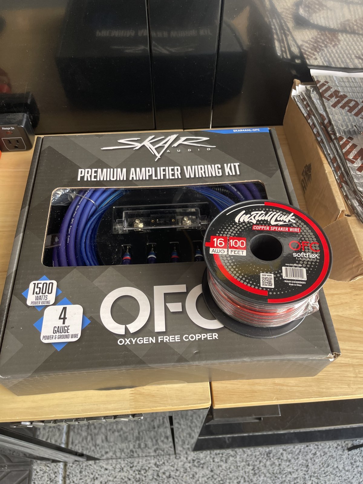

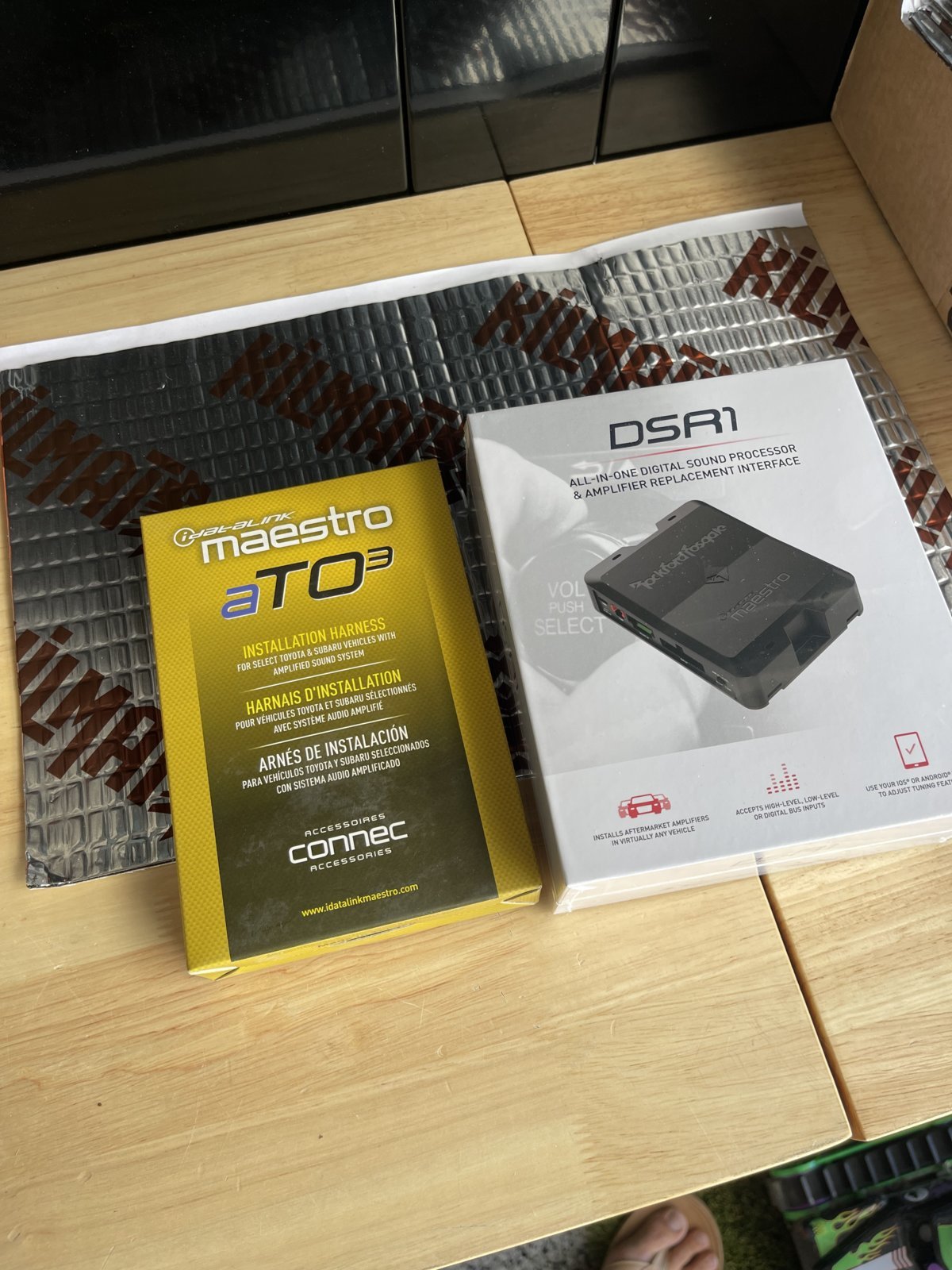

    Some new project stuff just arrived. Had to order it before we start putting offers in on another house. Already did like 90% of the cab in deadener. The rest of the components should come here soon.

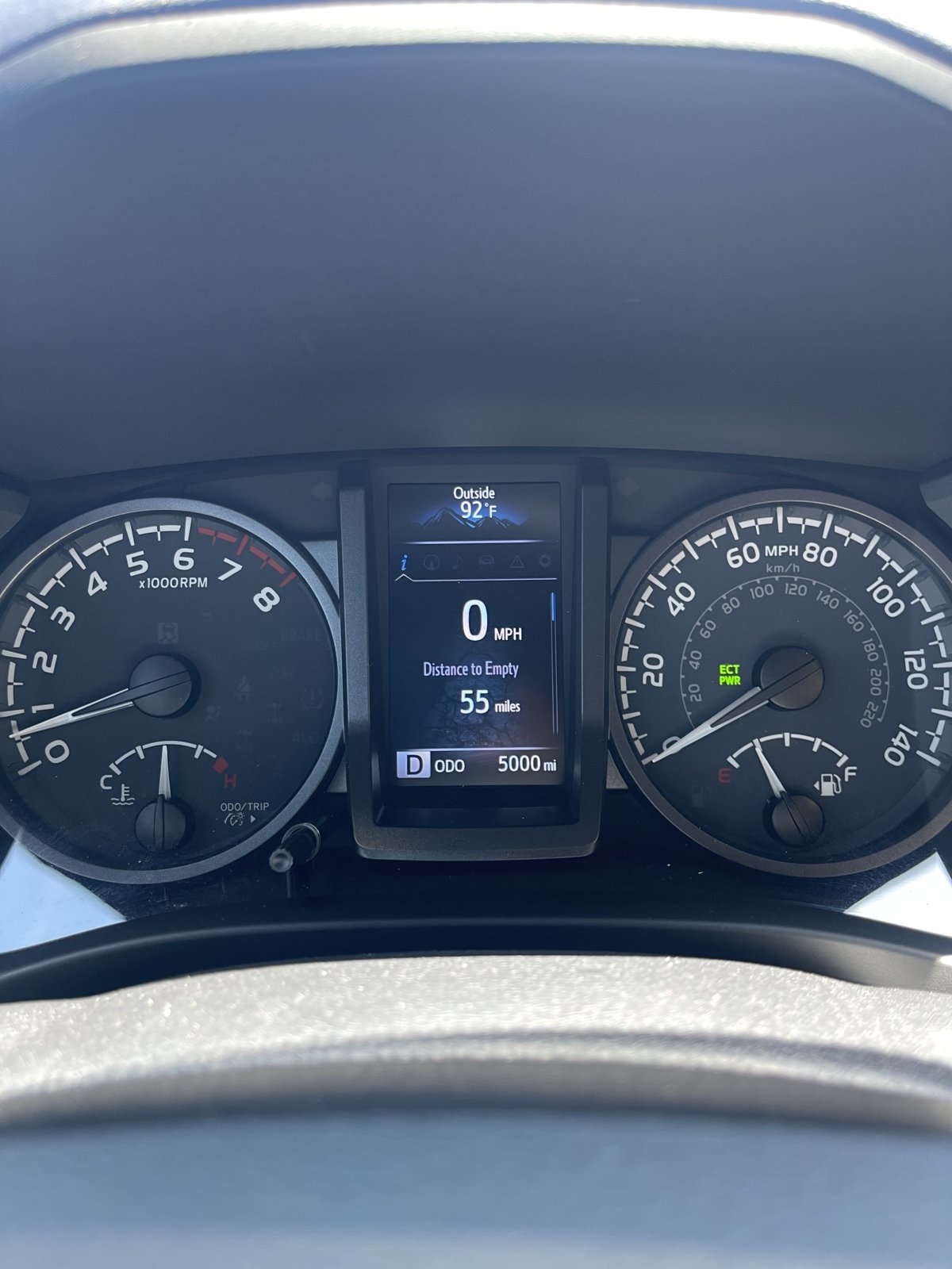

    Hit 5k on the way to work

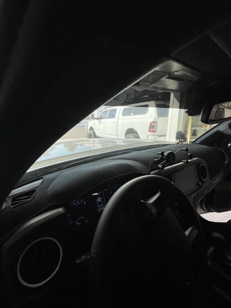

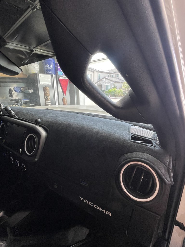

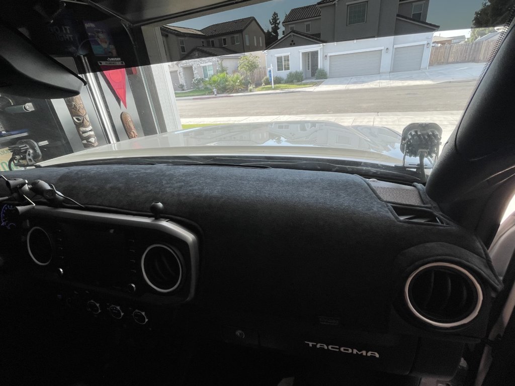

    Dash design dash cover had a buddy cut the speakers out because it muffled the sound so much.

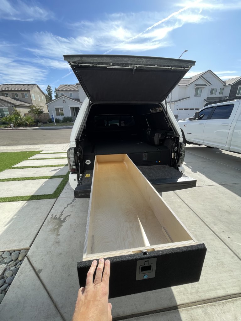

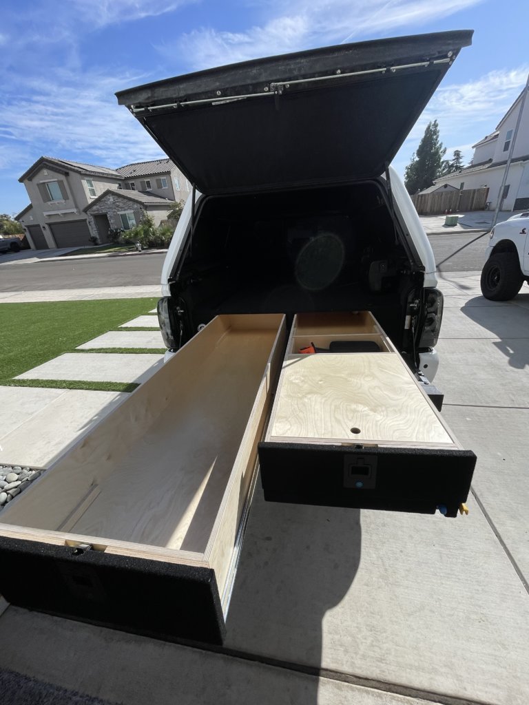

  16. Oct 25, 2024 at 2:49 PM
    #56
    azhiaziam
    azhiaziam [OP] Well-Known Member
    Feb 8, 2014
    #122554
    3,174
    The reef ca
    White 2023 trd off-road

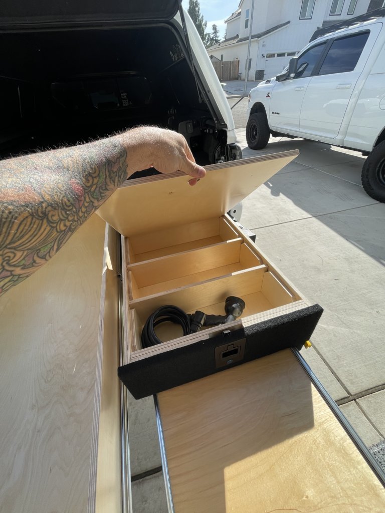

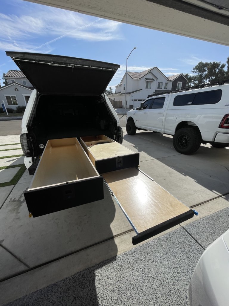

    Got my drawer build out done. Look up overlandwoodworks on ig in SoCal does a great job.

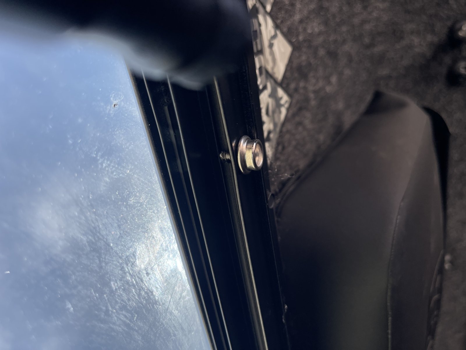

  17. Oct 29, 2024 at 9:14 AM
    #57
    longtimelurker1
    longtimelurker1 Member
    Aug 21, 2023
    #431791
    22
    CA
    '09 BARCELONA RED TRD OR AC

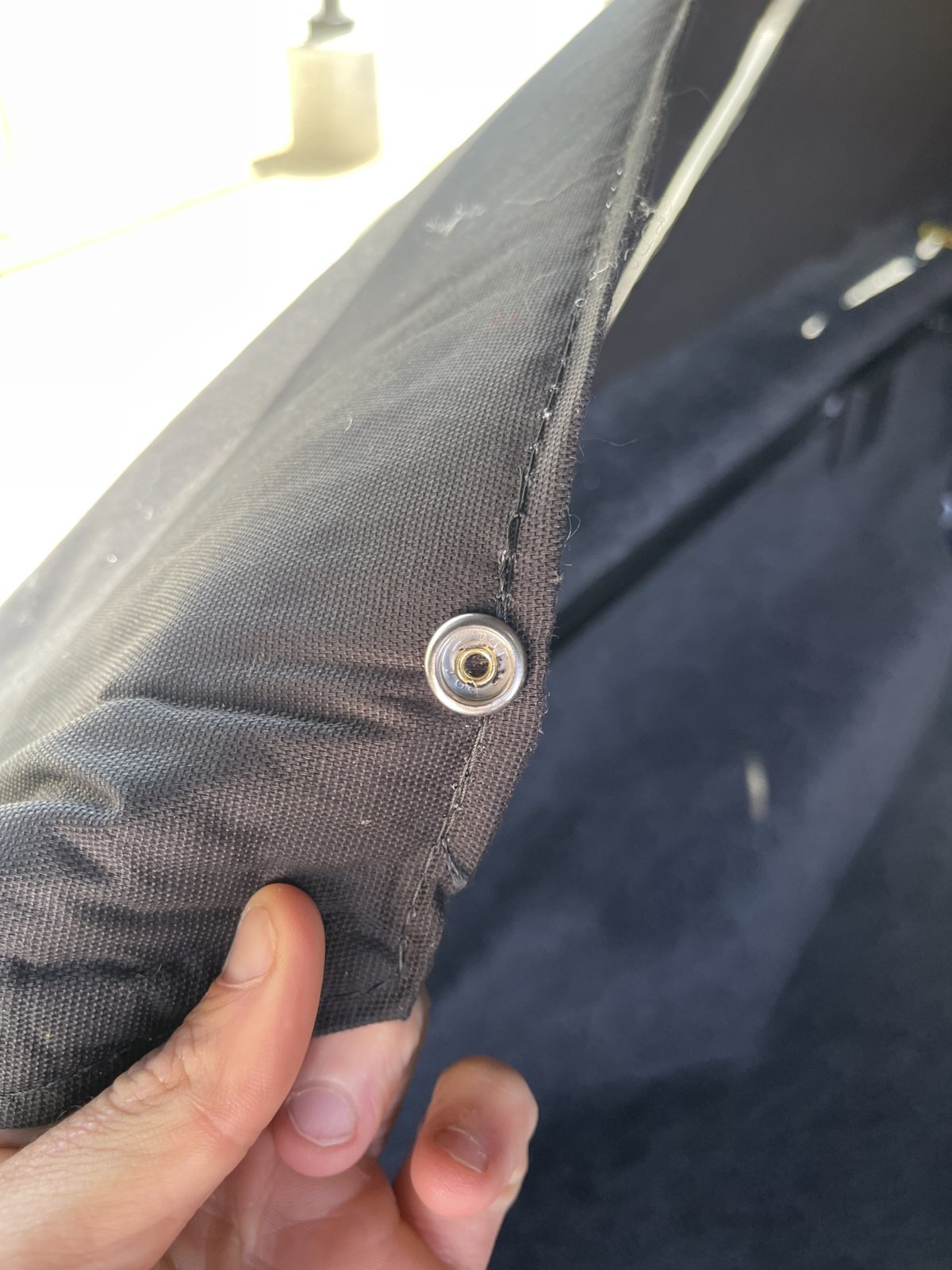

    Super clean. What did you make them out of? What was the process? I need to re-do my curtains a bit and yours seem to be a perfect fit
  18. Oct 29, 2024 at 12:03 PM
    #58
    azhiaziam
    Feb 8, 2014
    #122554
    3,174
    The reef ca
    So they are made out of just fabric and reflectix (sunshade) material and boat snaps.
    Process is fairly simple.
    Make your outline I did it with cardboard.
    Then cut the reflectix to those shapes. I did 3 per window because I have windoors and wanted to be able to open one at a time. After your reflectix is done cut some fabric spray glue it on. I had someone sew them on too and put the boat snaps on those. Then drilled the boat snaps into the metal frame on my indoors. That was the scariest part because I didn’t want to brake the frame or glass.
