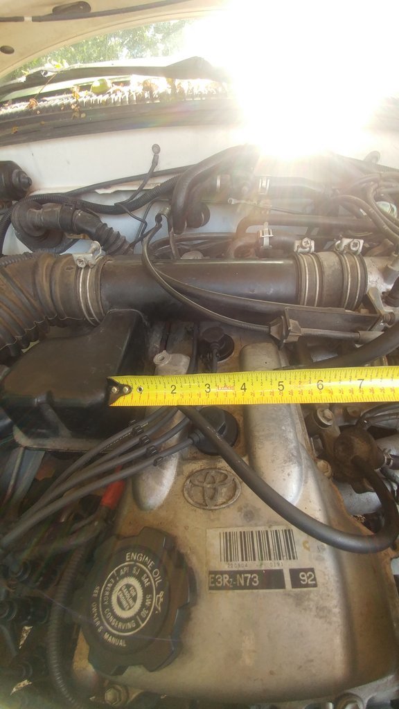

    My 99 2.7 Tacoma won't start. When I first got the truck less than a year ago, I had some re-starting issues. That is to say, cold starts were no problem-after operating temp was reached stopping and starting became difficult. I have been trying to figure out the codes the system is putting up 300-302 and 440. I have a list of things that these codes could involve. To date, I have replaced:
    Fuel filter
    Starter
    Fuel cap
    Vsv for vapor pressure sensor
    EGR valve
    Coolant temp sensor
    MAF/IAT sensor(2 in 1)
    Plugs and wires
    Cam pos sensor
    Idle control valve
    I have cleaned the injectors, cleaned throttle body, compression on first cylinder is 178 at 250 rpm. I'm stuck! Truck still won't start. It wants to, but has low choppy idle then dies. This is my daily driver and has been great! Please help!

    Could this simpl
    112000, sorry

    Seems a narrow head to be dual cam? I haven't broke into it yet, but I've rebuilt one before.

    Sorry I overdid the pics. I'm old school, need a grandchild to do this for me

    Four valves per cylinder and DOHC. "As to the timing chain, the main chain has a mechanical ratchet adjuster, the balance shafts have a hydraulic adjuster. The mechanical adjuster sometimes gets carbon gunk buildup on the teeth of the ratchet mechanism preventing it from staying clicked to the next tooth. A "motor flush" will solve this by cleaning all the gunk out of the oil system. It will also clean all the gunk out of the oil control rings in the pistons, and the little holes behind them. EVERY engine I have torn down without a motor flush all these little holes were plugged up."
    Pull the valve cover and see if the alignment marks are lined up after you've eliminated the easier fixes through diagnostics.

    That's a DOHC engine..... e3rz-73
