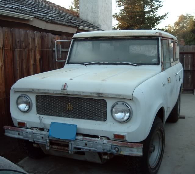

    4-low is good in any situation where you need to go VERY slow to avoid smashing over stuff etc. Even if not on a hill.
    My tacoma is 2WD, BTW, but I have an old Scout with flotation tires, 4.88's & lockers front & rear. I wouldn't dare run it in 4WD on dry pavement. I'd be breaking axles off. I've even seen this on 2WD vehicles with lockers, when the wrong gear oil was used. Just going around a tight corner at normal speeds, the axle would snap right at the end of the splines.
    In 4-low, on soft dirt, on a full lock turn, the front inside wheel is literally digging a donut-shaped ditch, as it skids sideways. It's spinning at the same rate as the outside wheel, but traveling only half the distance.
    Wish I had a better photo, but she's under non-op at the moment, and unavailable to pose in public.
