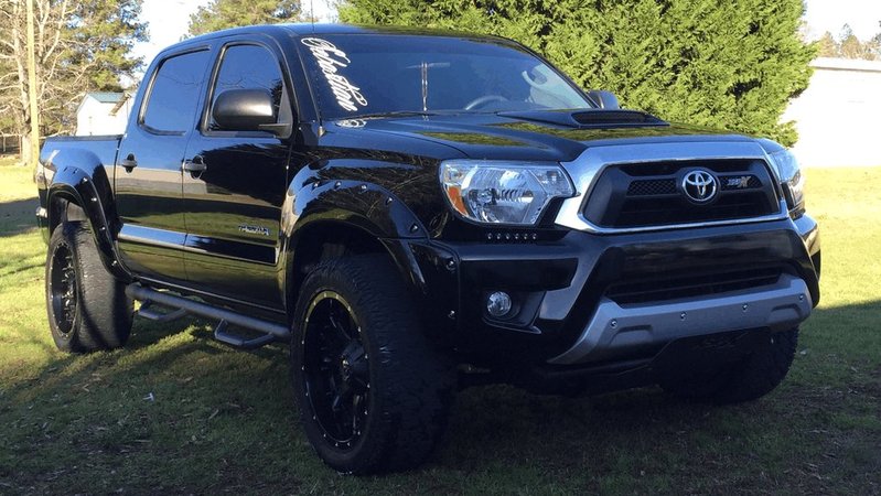

I want to upgrade suspension belstein 5100 raising it 2.5 inches will i need to lift the back?

    2015 xspx 4x4 tacoma
    20" fuel wheels Will lift it 3"

    I would recommend not using 5100s for 2.5 inches of lift. It's the cheap way out and the ride will suck. Get some 5100s and some coil springs. And yes you'll need to lift the rear. 1.5" if you want it level and 2.5 inches of you want to maintain the factory rake. If you even tow or load the bed up with weight then do the same lift front and back

    Also you need new tires
