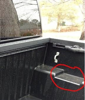

    What are the notches on the inside of the bed, on the bed sidewall for?
    They are approx. 3/4" deep x 7-1/2" wide.

    For boards to form a platform for drywall or other loads

    Sounds about the width of a 2" X 8"

    If I ever make a bed platform, I plan to use them to hold my cross beams

    Yeah, it's about the dimensions of a 1x8... but I thought that was an odd choice to go with for a make shift sheet material platform.

    Or people put wood in them just to “stiffen” the truck

    I just made some this weekend. Save a couple $$ and grab one 10ft'er. You'll have just a little scrap left over.
    Edit: Also, it is weird that the ones on the LBs are smaller than 7.5in. I had to notch 3/4in off of a 2x8. Not a big deal really.

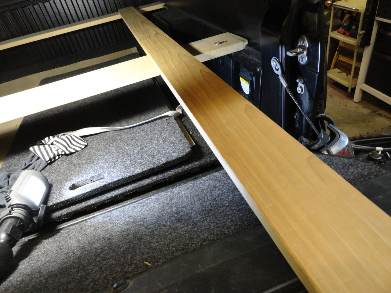

    DSC03557.jpg I added an extra set of bolts for the tailgate cable to hold the tailgate in line with those boards. Works great for carrying sheet goods in my 6 foot bed.

    Well that's pretty freaking neato! :bowdown:
    I bet a quality S hook or a hasp would work with my bed stiffeners there.
    Thanks for the idea. :hattip:

    I have bed stiffeners as well as the bolts. Plenty of room for both. Very quick and easy to change over at the lumber yard with no extra parts or adjustment required.
