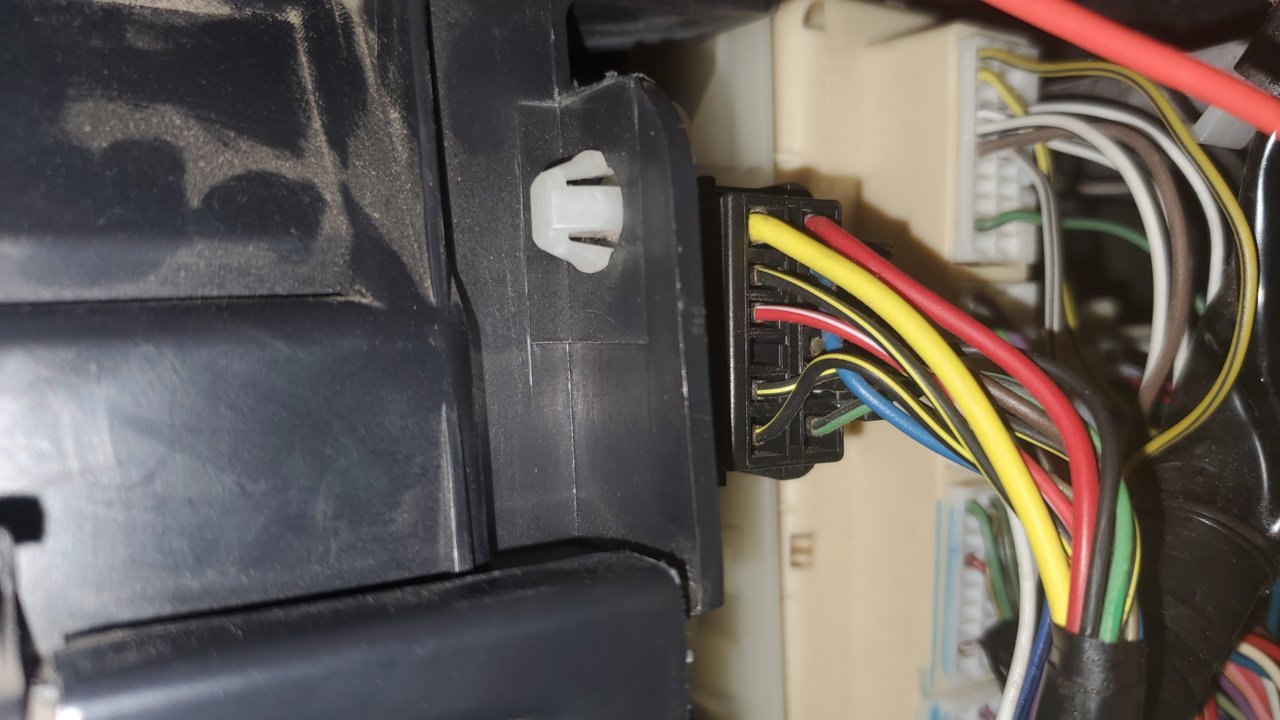

    You can check the Lock Sensor circuit at Pin 10 (Red/White) Connector IH1 behind the glovebox (3rd wire down on the left of the connector shown)

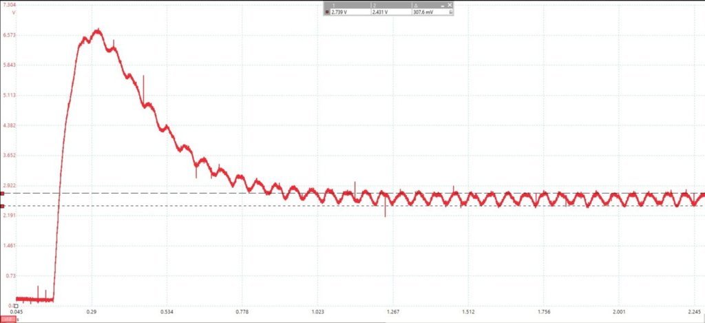

    Meter connected between a known good ground and the Red/White wire when the A/C is turned on you should see it briefly go to 12v and then drop to about 2.59v and stay there while the A/C is on. This can't be used to tell if the sensor is generating a signal or not but it will tell you whether or not the circuit is intact or shorted to ground.

    Lock sensor circuit is good, 2.31 v while running. Redid my connector on compressor. Still nothing. I’m wondering if it is worth returning my compressor pickup (not sure if that’s the same a compressor lock sensor) and get a new one from rock auto. Original bought on Amazon with good reviews but I’m nervous that I’m chasing this problem when it’s just a factory defect.

    You could try another one at this point, it's impossible to know if it's generating a signal without an oscilloscope and the signal is quite subtle (about 0.5v peak to peak) even on a good one.

    Without a scope to see what the signal is doing about all you can do is check wiring integrity between the lock sensor and the A/C Amplifier.
