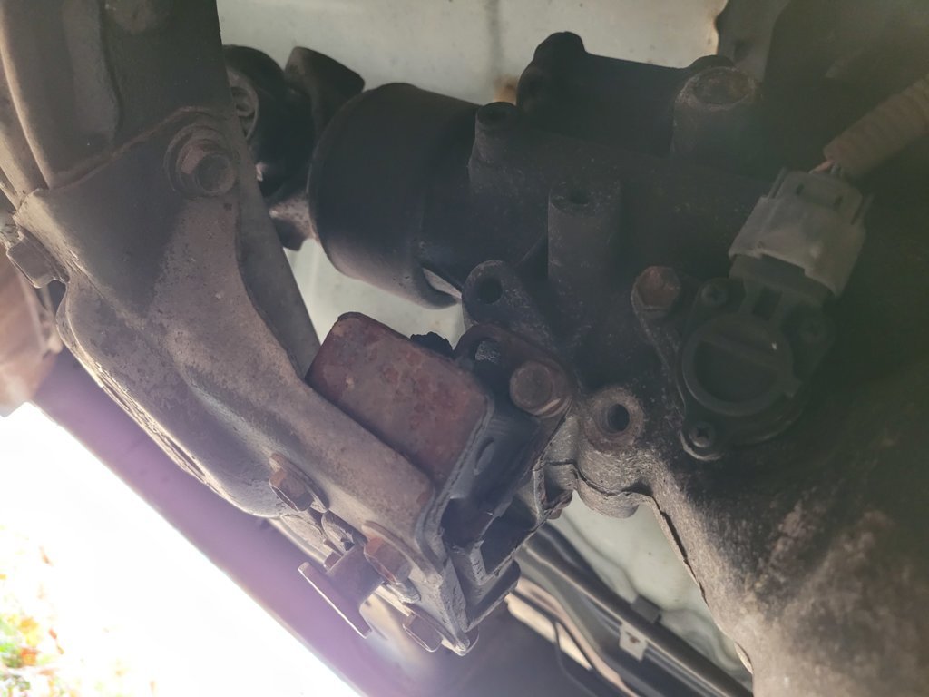

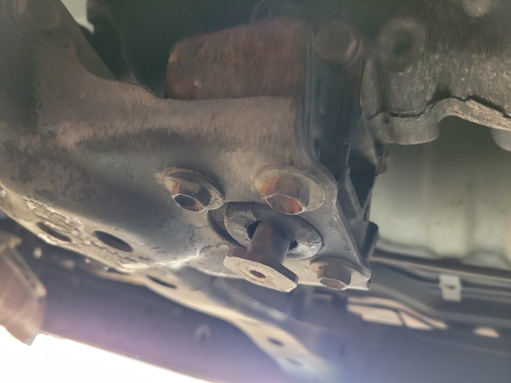

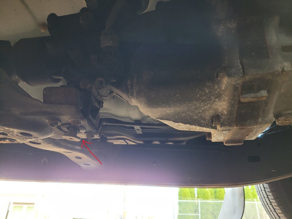

    Hi new here recently came into my dads truck (2001 2.4l 2wd MT), when he passed away. When I was changing the transmission fluid and the diff oil when i noticed this right where the transmission meets the driveshaft. Is this something that makes the truck unsafe to drive? How would I go about fixing it. I looked for an exploded parts view but i could not find one that pointed out this specific part. Any help would be appreciated. Thank you.

    Just a transmission mount. You can get another at the parts store for about $20 to $30. They hang down like that because they float on the rubber. Shouldn't exactly be bent back like that but it doesn't look like a major problem. Easy peasy.
  3. Nov 25, 2024 at 1:01 PM
    Mikerocosms
    Mikerocosms Well-Known Member
    Jan 18, 2016
    #175335
    102

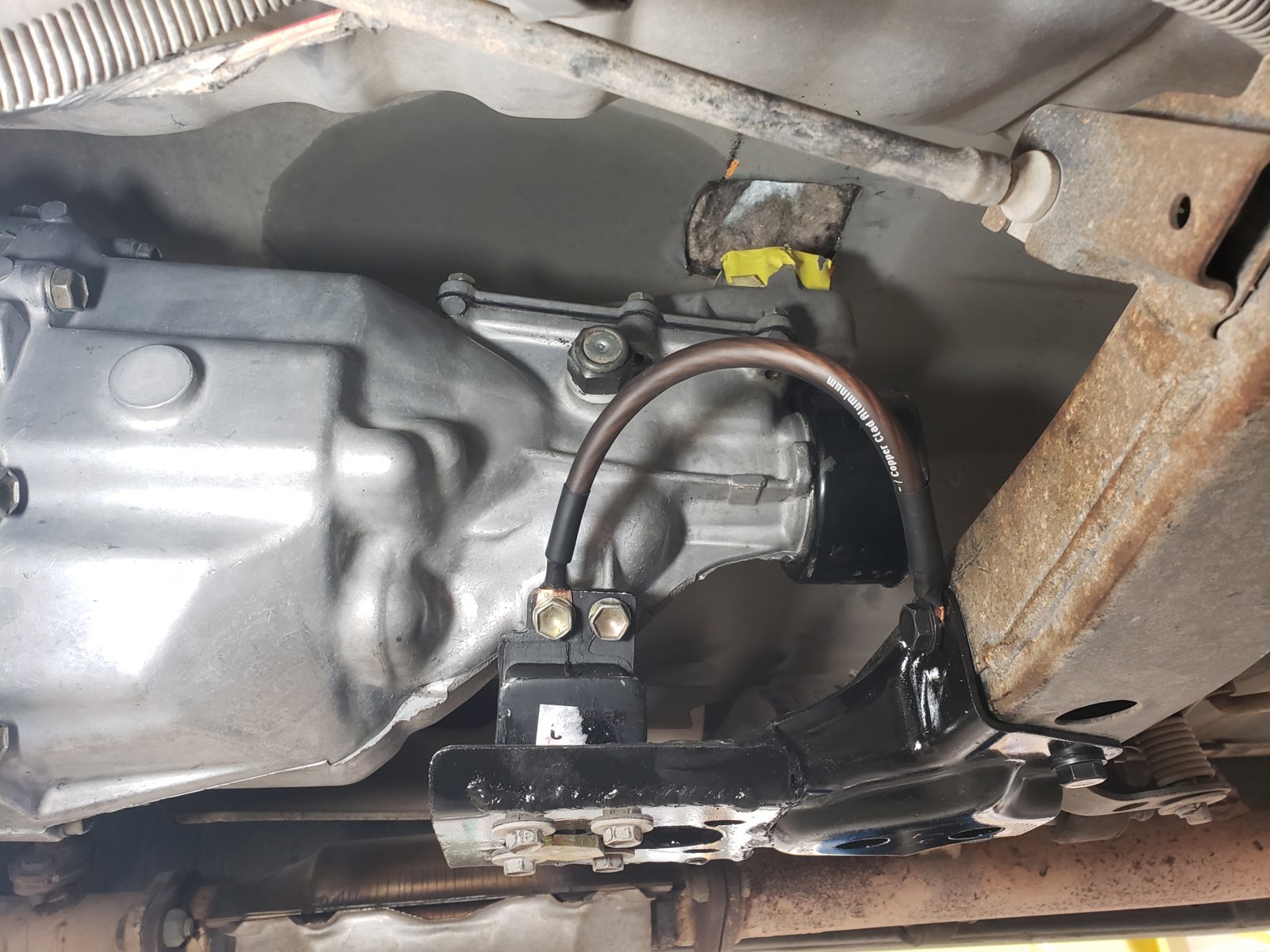

    At second glance it looks like you're only using 2 bolts on the tranny. Should have 4. Also the big bolt is hanging down pretty low. Rubber might be really old. Here is a pic of mine. I have a supra transmission so it looks different and my bracket is extended to fit but you should get the idea. Also my ground is overkill.

    Actually how do I go about getting the mount to line up to be able to use all four bolt holes? Do I just jack up the transmission more to try to get it to fit? It kinda doesn't look like there would be enough wiggle room to get the mount forward enough to get all four bolts in.

    Looks like that might be either a replaced tranny or wrong tranny mount. Might have to get creative on that.
    My truck (96) has a (96) supra tranny. I had to weld an extension.

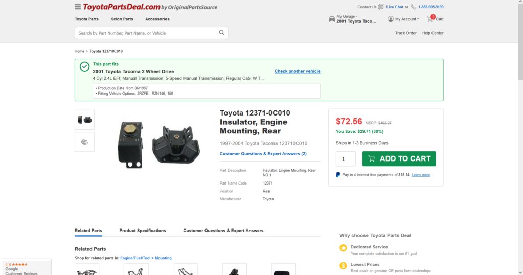

    For the future if you're looking for the OEM part for the mount itself it's this Capture.png

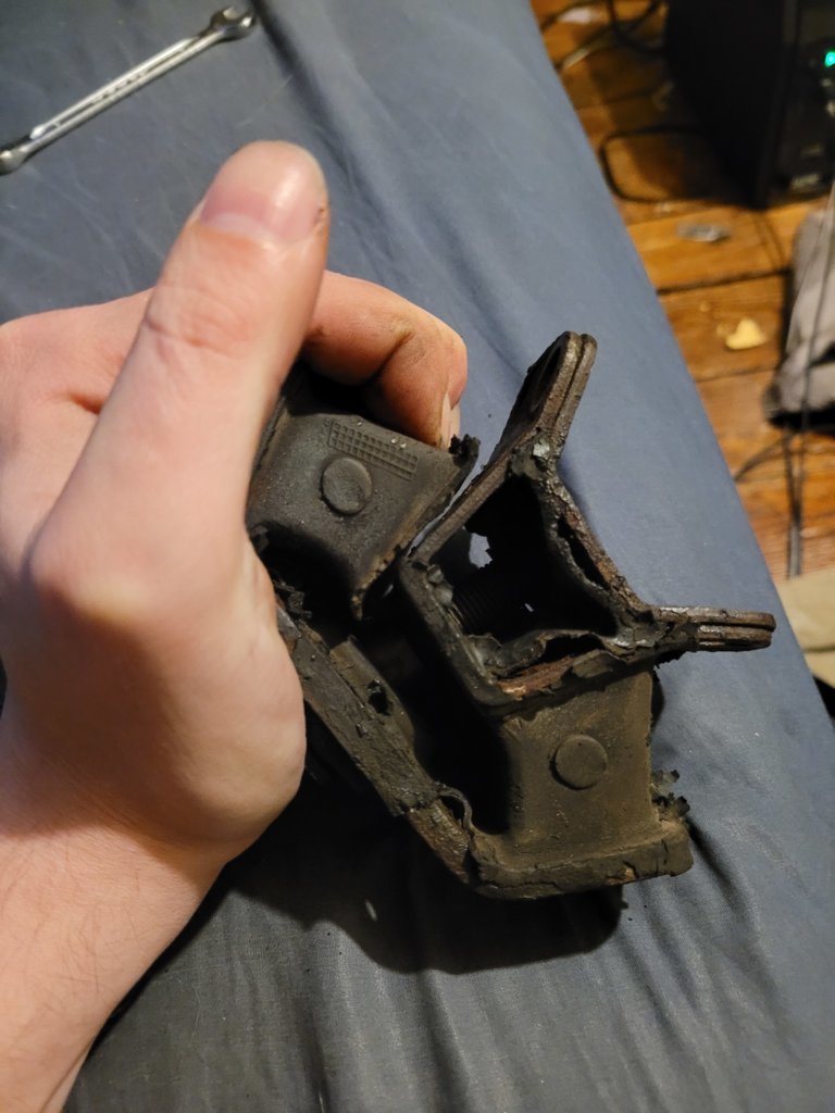

    Just an update replaced the mount it was pretty bad. Super easy job torque specs are 48 ft lbs for bolts to transmission and 14 ft lbs for mount to frame. Would have taken pics of it from underneath but it was cold and I forgot. Attached is pic of the old one.
