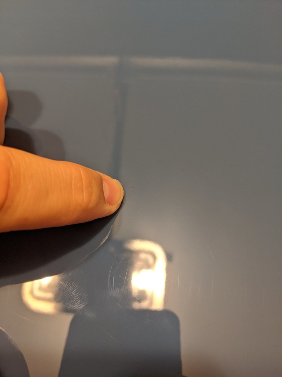

    So I noticed a tiny popped bubble on the hood of my new 19 Tacoma. It's not a road chip and it's not rust or anything like that. Is this normal? Should I try to get it fixed under warranty to avoid rust or repaint color match issues down the road? I am new to caring about paint and detailing in general so maybe I am just worrying about nothing? What say you all?

    Tried getting a picture but no dice in the dark. I cannot emphasize the word tiny enough.

    Yes.. somehow managed to get swirl marks in the clear coat. It's been too cold to put the ceramic coating on unfortunately. As a bonus question will I need to get those very light swirl marks out before putting ceramic coating on?

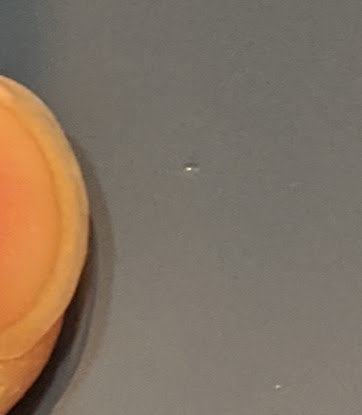

    i would definitly get that fixed as it could spread, however i bet they tell you to stuff it. dealers are awesome

    I don't know if leaving it be will be more durable than having it repainted. And if it does get worse in a few years then matching the fade on the paint will be annoying. Sigh. Choices choices... If only they painted it right to begin with...

    100% need to correct the paint and polish out swirls prior to ceramic coating.
    Also if you closely examine every square inch of your truck I bet you’ll find more of those pin bubbles.

    It’s possible it doesn’t expose the raw metal underneath. In that case, I’d be hesitant to “repair” it (and possibly end up with a problem that’s even more annoying than what you started with).
    I’d rub the area with some ScratchX (no “focused” finger tip pressure), polish the hood with a DA polisher, make sure the spot is smooth (no raised “edges”), and then use Dr. Colorchip to fill the spot in.
