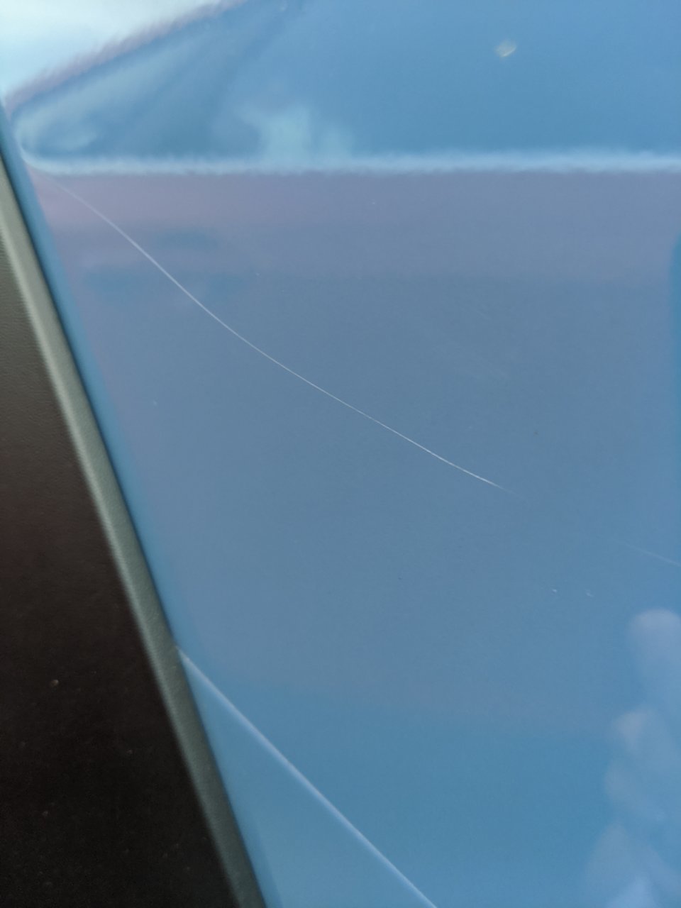

    Well. Not so worried about that tiny bubble after coming out to this today.

    That is my hope... But my finger nail just barely catches on it so we shall see... Still disappointing when the truck is less than 30 days off the lot.

    That stinks. Keyed?

    Possibly. Seems like a non go to spot to key a car... Just in front of the rear wheel well and down low. I live in an apartment complex who knows what someone was up to...

    Speaking as one who has done more than my share of detailing, that's an issue. My general rule is that if you can feel it with a fingernail, it's time for paint. Even if you can polish it out, you risk taking so much clear coat off that you have future issues. Bummer. Good luck though.

    I think it's right on the cusp between buff fix and repaint fix because my nail barely catches... Are those clear coat touch up pens/bottles junk? I am new to paint care so I genuinely don't know much about what works and what doesn't. It doesn't help that the internet is flooded with people trying to sell their magic products.

    Adding paint to the car without a lot of work and prep and rework is going to be noticeable or even look worse than if you hadn't. It's also a nice time to make a small blemish like you've got or a rock chip look worse. Systems like Dr Colorchip are nice but you will always be able to find where you've done the touchup. Will someone else at several feet away notice, probably not. But does that matter, or would it be better to get paint on there and prevent it from getting worse which will eventually lead to rust. Now having said that I've got a Dr Colorship kit for the rock chips I've caught and will catch in the future.
    As for buffing out your new scratches, that's just something you're going to have to experiment with. Can you remove the scratch nearly 100% that's a firm likely. However the real issue is you're going to have to level a lot of clear coat around it at the cost of making the scratch go away or just a lot less noticeable. So you've gotten rid of the scratch today, but you've left that area with a lot less clear coat for the future. As with anything buffing related, try a light approach first. Just hitting it with a polish may hide it enough.
