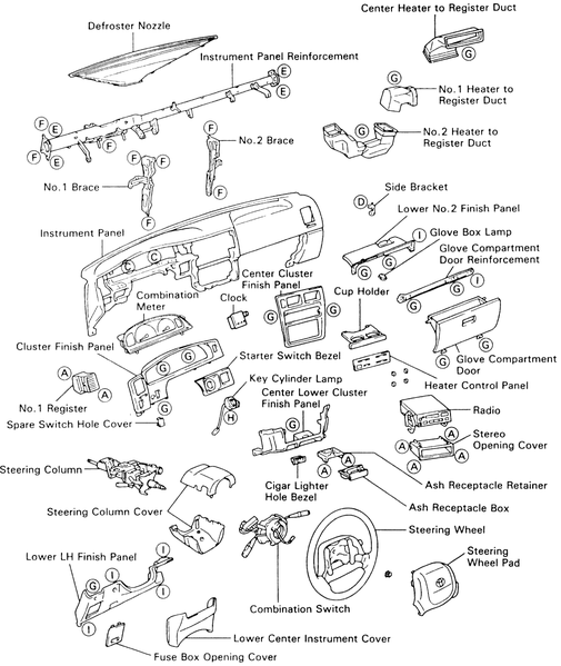

    I had my dashboard open during my 4wd wiring and found that the dash has warped a little.
    enough to break the clips that holds the plastic defroster nozzle that directs the air up on the windshield.
    it was off by more than an inch on the passenger side.
    so what i did was i had some square shaped foam, pushed the duct up to as close as it can to the dashboard and wedged in the square foam.
    so far no more squeaks.
    i attached a pic, i'm talking about the defroster nozzle which is located under the dashboard behind the instrument panel reinforcement.
    i wedged the square foam i had as much as i could between the right side of the nozzle to hold it up and the reinforcement...
    so far so good. its been almost a month now...
    to get to this part, you will need to remove the center cluster finish panel, center register heater duct and maybe the radio then look a bit to the right.
    you also might have other sources of rattles and squeaks and noises. best really to just disassemble. it only takes a few minutes to do it.
