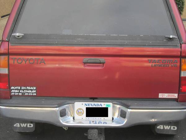

    Before:
    After:

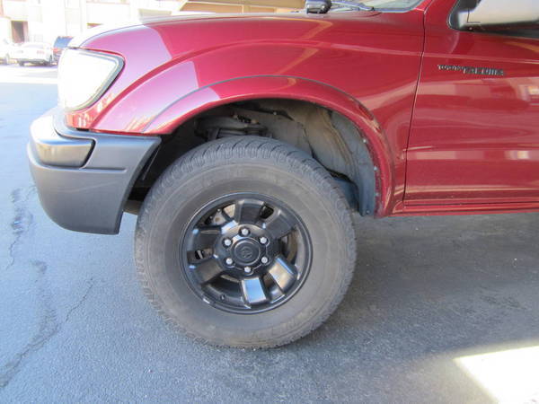

    Had some frame rub with the new Duratracs so I decided to get some 1.5" spacers from Spidertrax.
    Front Before:
    Front After:
    Rear Before:
    Rear After:
    Different Angles:

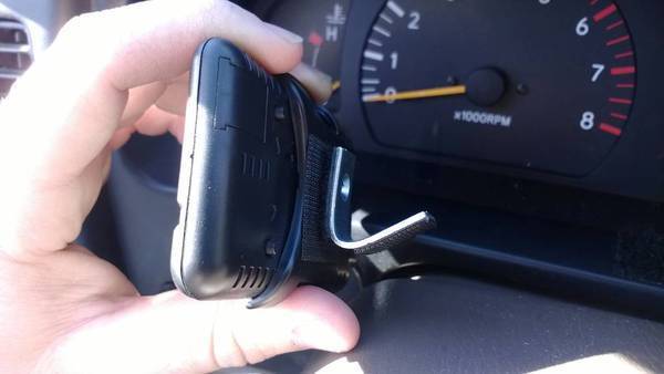

    Just got my gauge in last night and thinking about installing the same way. how'd you install it?

    I just bought a 1" corner brace from home depot and used industrial Velcro to hold it in place. Any "L" shaped piece of metal will work. I have also seen guys use a small block of wood with Velcro. I can put up a picture tonight when I get home if it would help.

    A picture would be great! I can't seem to find it now, but I saw somwhere on TW that a guy had used a bracket he found in his house to clip it under the black plastic trim by the gauges and attached the UG to that. Looked like it was almost the exact location as what you had done. I'll swing by home depot tonight too.

    Here are a few pics of what I used. I think I might even add a small piece of Velcro to the front bottom of the gauge/steering column to make it even more sturdy. Hope this helps.

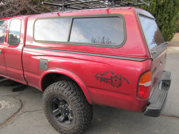

    New bedside decals, courtesy of RuggedT!
