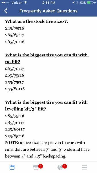

    With regards to the 255/80 tire size, I only mentioned it because of this picture I seen floating around on some Tacoma facebook pages.
    Do these sizes hold true for the most part? I can't confirm or deny haha

    Well, "fit" and "fit with no modifications" are two different things.
    I run 285 75 16's and I'm lifted 3 inches. They rub, and I need to run spacers/wheels with smaller back spacing.
    I've just never heard of a 255 80 16.

    I have 255/75/17 which is the same as the 255/80/16 and I love them. Perfect size for our trucks I think at exactly 32". 17s are easy to get because thats the stock jeep tire but 16s might be hard to find?

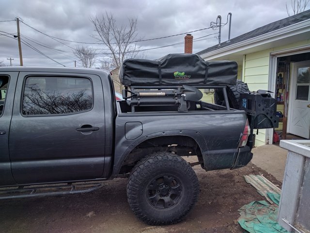

    Put my rack and rtt back on today, its finally camping season!
