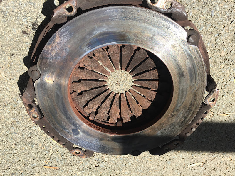

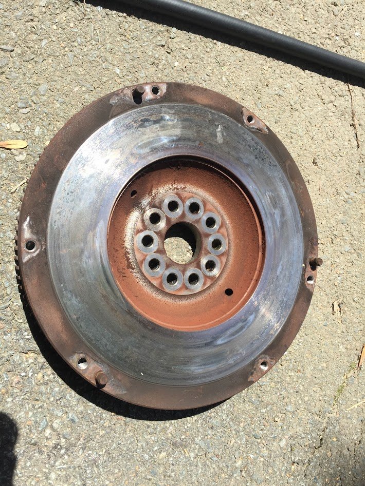

    @TacoMitch93 and I did a clutch job in my driveway early august, no real pics of the swap, but here is the old clutch with 390K on it.
    Flywheel - A few hot spots.
    CM8-S9zCRMhL1e9tWTdX1SfVli6R1DIjhFhBNZ8p_4722c91d581d698a4637db6cc6e9454dcbe17bc9.jpg
    Clutch - still had a bit a friction material left.
    UCfbFgwmdCmeJp5HIyp27iRHpsplwxsvBHJvGXuQ_2a1125cd3dffe46d07b758e407dca4955d309f12.jpg
    Other side
    IeFn0X-VYKpEBQCs4pmrXB83TcwsGlWr8aI3TvgB_35bd88f50e47674a1d49e9c2b3df395c607adb9e.jpg
    Pressure plate - a few hot spots ( and bent fingers )
    LIzDA6bFoBqZzbEeNsabyYiyqBncsuEDQCqHOTBm_7b785a6f5810817144c3521b10d9ab05e530f88a.jpg
    Clutch is a LC Engineering stage 1 clutch, double the factory clamping force. and I had Nova Automotive do the re-surfacing of the flywheel, cost about $105, and had it back in 4.5hrs same day.

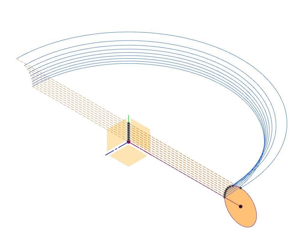

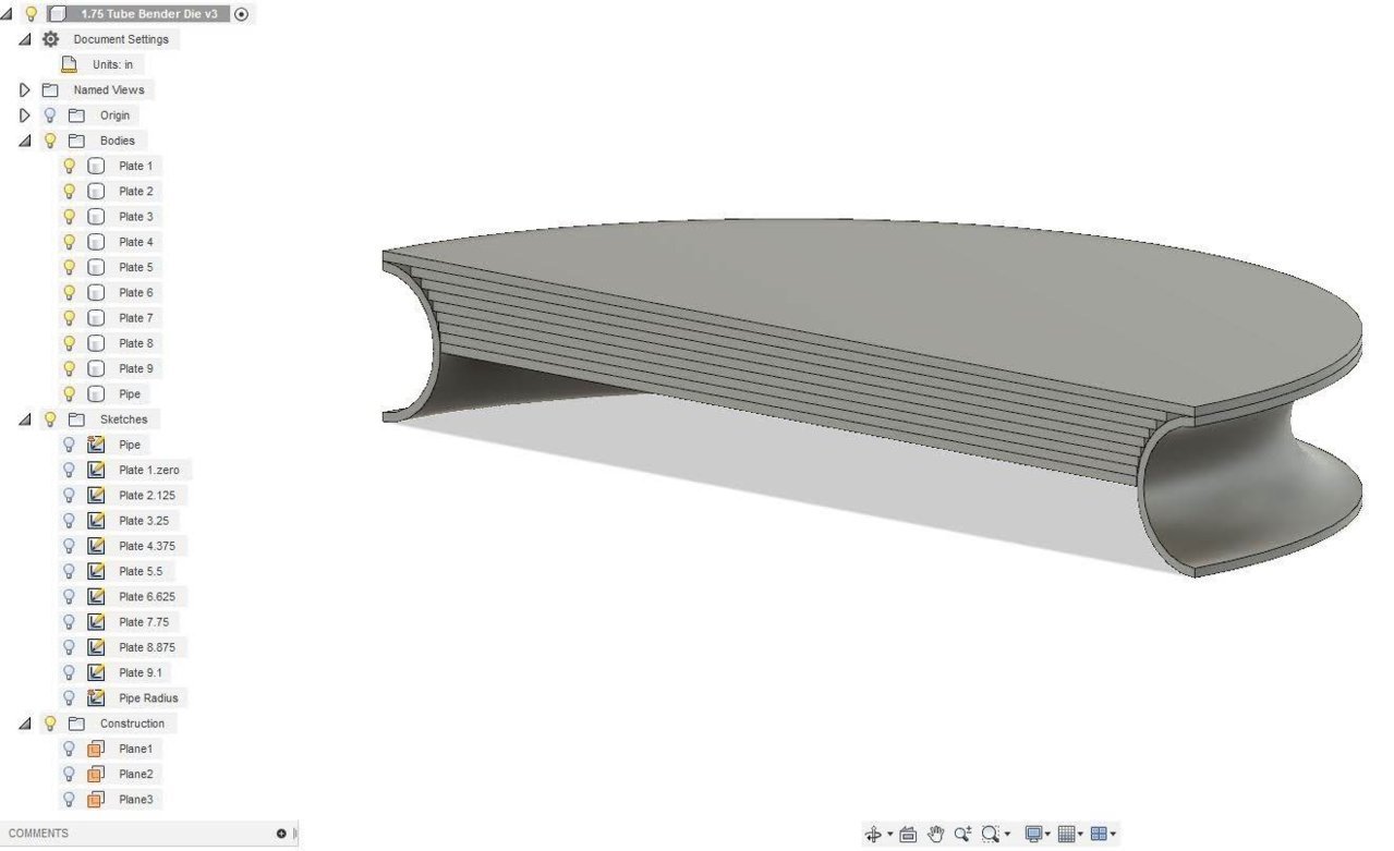

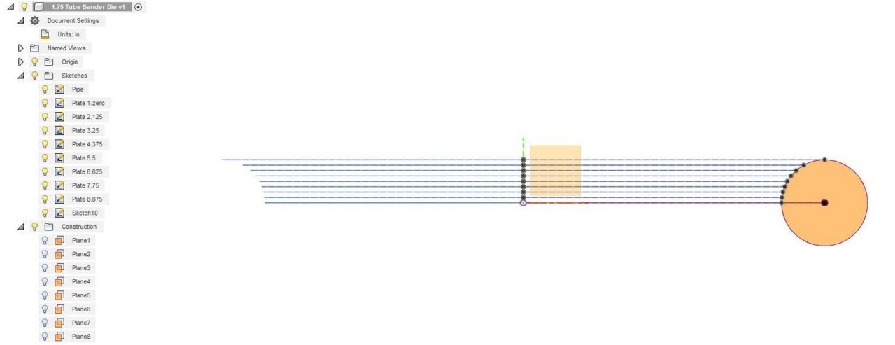

    I think I just did it.... I've been futzing around for over 2 weeks, it may not look like much, but to me, its a major victory!
    Quick summary behind my idea for a 1 3/4" tube bending die
    Take 2" .120 wall DOM and have it bent 180 degrees ( 2" .120 DOM has an ID of 1.75" ). Then take 1/8" plate and fill in the middle to give it support. but to do that, I need to have some one cut some semi-circles out at different radi ( radiuses? )
    Pic 1 - Getting there, Finally figured out how to draw on 2 planes at the same time. More on that in the 2nd pic. but you can see how each line is a different length depending on how far up the circle you go.
    yKU_vgp482gh7OTxSq-oxJdZmxejsTWMMNgumHS__5e2c8ffde8efa3a86f2e94486b48ad73a99136d4.jpg
    Pic 2 - you can see where i'm going here. the circle is on the vertical plane, and the arc's are on the horizontal plane. Now I just need to finish the arc's and make them semi-circles, add a little glitz.....
    C4e8FFLY7g7zsGiiyZ6S9BFBeK67ibsSd16bPgCZ_3deb09fc9c8e5e357911e6da0c645fedd8012331.jpg
    Pic 3 - BAM!
    I only bothered to draw up 1/2 of the plates since the other ones will be identical, I'll just get the plasma cutter person to cut the stuff out 2x. I do plan on adding some offset slots on the plates so I can weld them together, and also I need a pivot pin, but this is good enough for tonight. those two things should be easy peasy....... ( famous last words )
