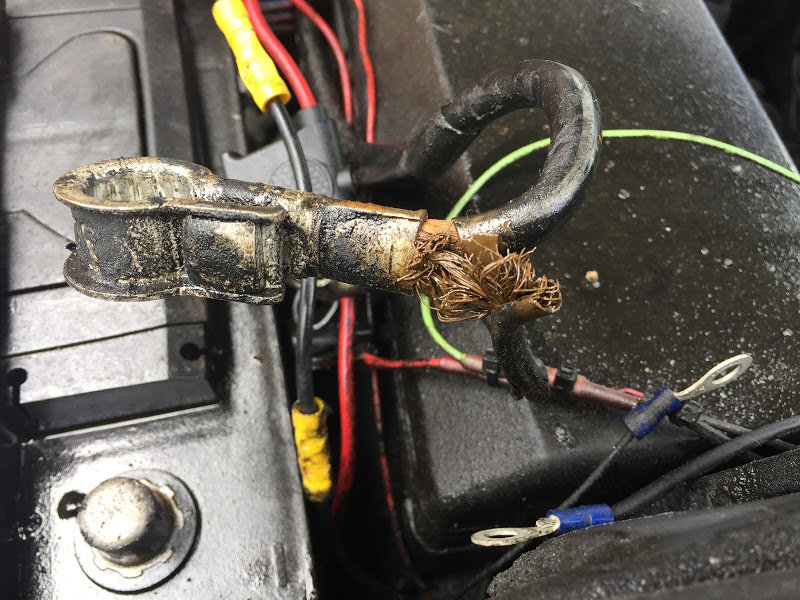

    Here is my ground cable, Pretty gross.
    it wasn't as bad as I thought, I would say there was more strands connected then not, still not ideal ( not tot mention all the insulation was cracking off. I cleaned it up real good with electrical contact cleaner, sanded the battery post as well as the connector, she's definitely a solid connection now

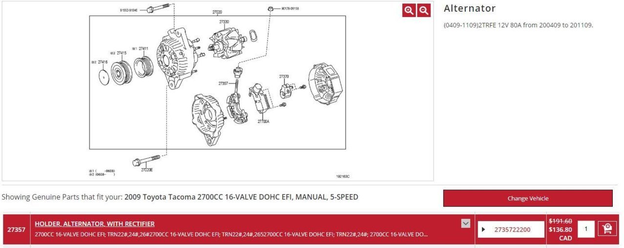

    Here is the Alt. for the plastic cap that protects this, you just have to "grip it and rip it" lol. Mine was brittle, and I broke off some clips.
    mpRgR8JNCMQJ6Z74c9pCGm1XCGNkIMJuFMYYgOEU_a970d0b4cc5790ff2b9101c0d6aff1484d2e7640.jpg

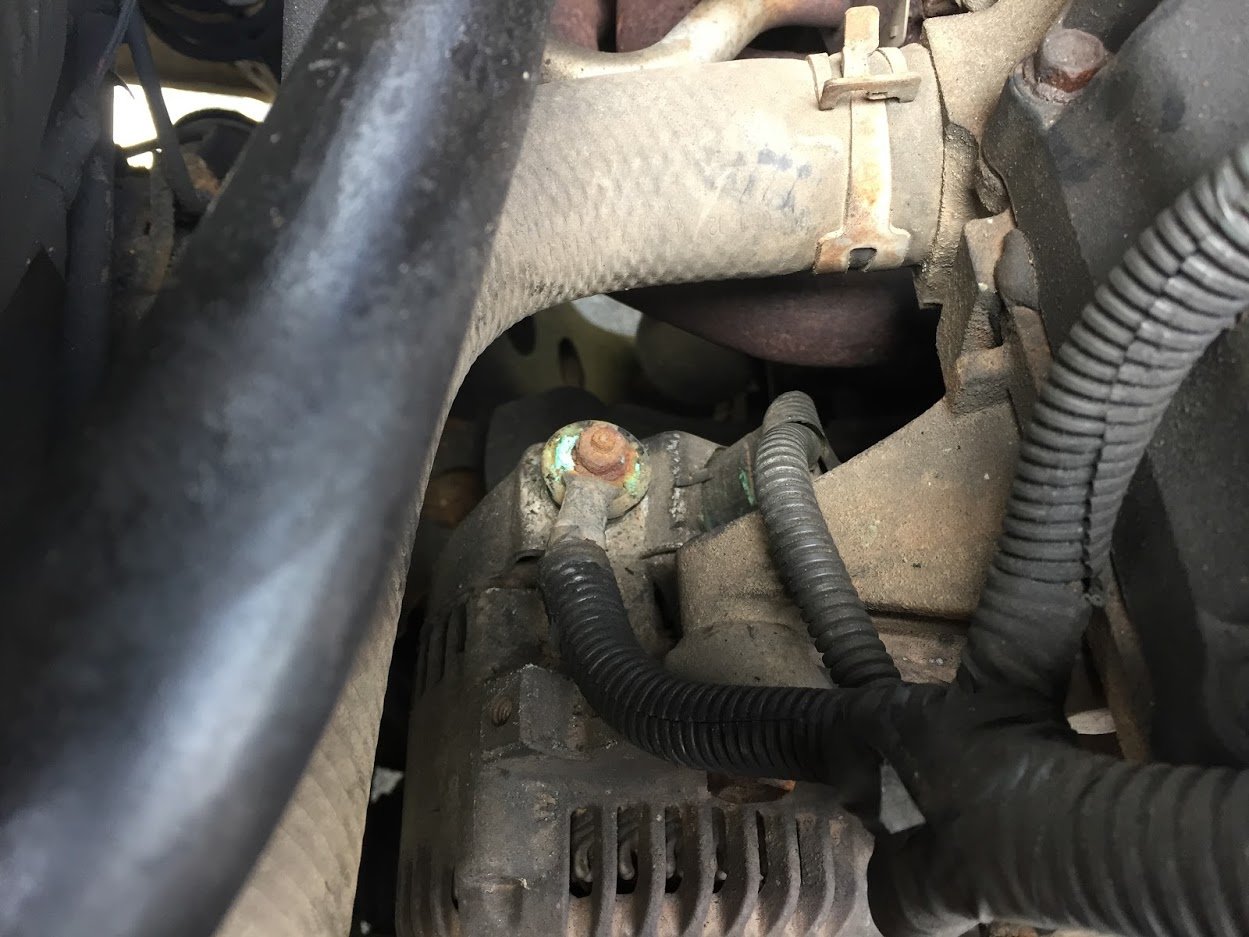

    After fixing the grounding cable I crossed my fingers and fired it up, but alas, it was not that simple. No Change, Nada The voltage from the rusty alternator post to the negative battey post was the same as before starting the truck. Pretty sure she's dead. I poked at the Green fuzz that was around the nut, and what ever was under it ( a big copper looking washer ) disintergrated upon touch ( another nail in the coffin for being dead ) I looked at the parts Diagram, and that rusty "post" is attached to all the Diodes ( I think ) so to replace that part, is about $136 from TPD ( Toyota Parts Direct ) not to mention what else may be past its prime and needs to be replaced.
    lJd5QOXzFAR48jM2DV2XzdP6xuVf-cjrxpgG_DHd_7a2663e546ba4f9dbf7377d6fe8f9e87a6d2dd03.jpg
    I sprayed some penetrating lube on the rusty bolt, and I was afraid of snapping the post off completely, that sucker is STUCK! and being just a itty bitty thing, I doubt it would last the impact.
    I decided to leave well enough alone until I had a replacement in hand.
    Many thanks to @Canoehead for the loan of the charger, I'll have to keep charging the battery every night until I get this fixed.
    Napa Wants $365
    TPD wants $514
    Friend of a friend $280
    I'm going with the Friend of a Friend approach I guess they still have their Mech License and get discounts on parts :notsure:

    Alternator is fixed, Core returned ect.....
    pretty un-eventful job, took two hours due to the fact that I had a tough time aligning up the bottom bolt holes and at one point was questioning if the Toyota bolt would actually thread into the aftermarket alternator. Turns out I was just waaaaay off
    now I'm all horny to get an aux fuse box setup so I can clean up the spaghetti of wires going to my battery :)
