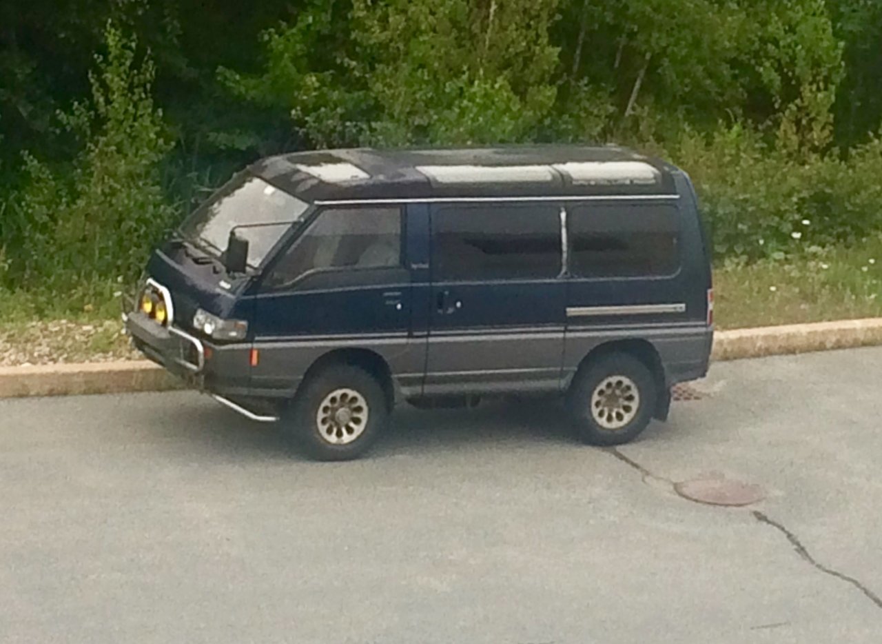

    Not taco related, but got this low res spy shot of a Delica in the parking lot at work. Looks like a cool rig, seemed like impressive clearance for a van.

    Those Delicas came out of an era when the Mitsubishi Pajero (sold in the US as Montero) ruled the Dakar rally so it's no surprise they have some serious underpinnings.

    Those are pretty neat, I was thinking of one of these before the Taco fell into my lap.

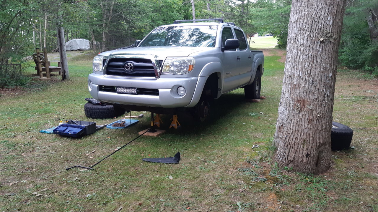

    Success! One down, one to go. Doing sway bar links too, had to stop to check hex size - 6mm seems too big, 7/32 is too small..
    Lol re ppe - I'm beating on the rotor earlier and it occurs to me, I have gloves and safety glasses on ... And bare feet. Takes a step back, keeps beating on rotor :D

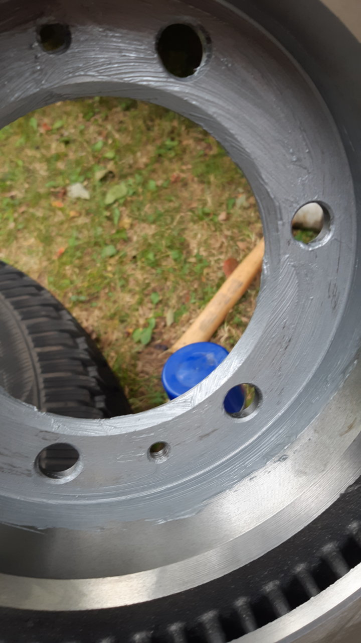

    New rotors have the threaded holes, painted the backs with anti seize just in case..20190826_151129.jpg

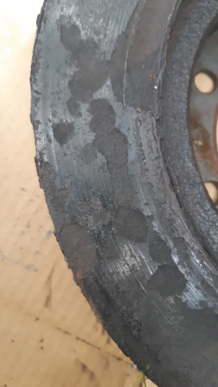

    Job done :)
    Drivers side rotor looked ok on the front but the back side was like the dark side of the moon, pad was down to bare metal..
    That's the back pad on the left, front pad on the right.

    Nice work :thumbsup:
    I bet the new pads & rotors feel night and day to the old ones.
