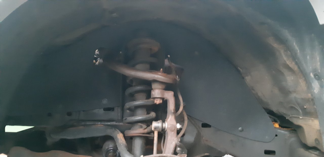

    With the number of people running the new splash guards, we're getting some serious mileage out of the template now :cookiemonster:
    Just gotta get em to post images at the thread to bump it for more exposure, wanna get Toyota to send me a free truck and have their manufacturing process entirely change to use our template

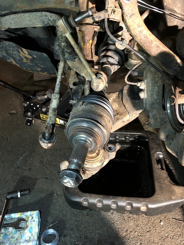

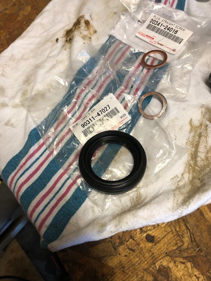

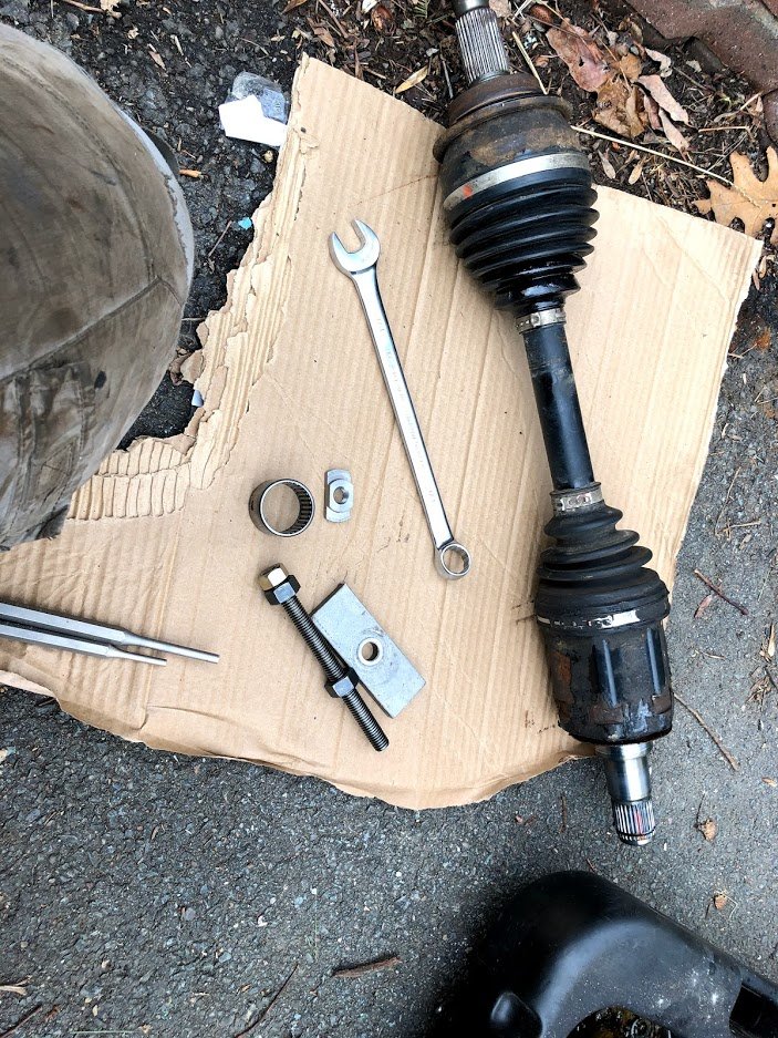

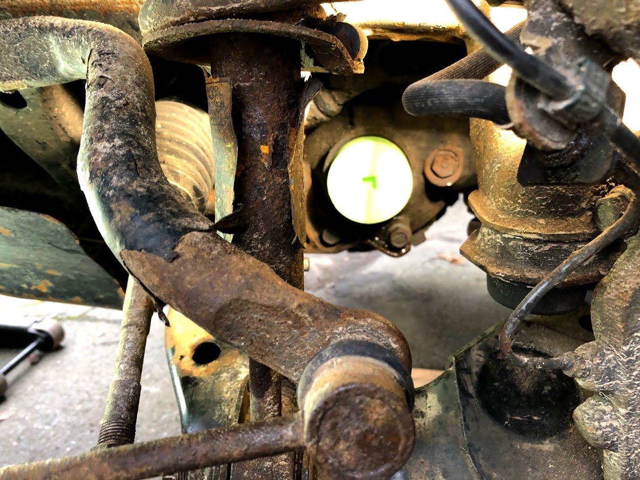

    Hey! I just did this on the weekend, Replaced the Front Diff CV shaft Seal, and installed the ECGS Bushing while I was at it.
    here is what worked for me.
    I pry bar and a hammer :)
    First I was trying to hit it on the little cut outs on the tulip, that was a waste of time IMO, when I moved to the actual end of the tulip between the dust sheild and the tulip, that's when things happened for me.
    Also that "C" clip that holds it in has lots of wiggle room on the end. so what I would do is rotate the CV, give it a few hits, rotate, hit, rotate, hit.... you get the idea.
    what you are trying to do, is get it so the "C" clip's opening is facing down, this minimizes how much is sticking out. Once I hit the magic formula, she came out with little fuss. @Canoehead said that he was able to use a small pry bar close to the top of the T-Case and pry it off with little force. Honestly, I think its all about getting the clip in the right position.
    Timmy the tool man has an excellent video on removal / install, during the install he mentions putting the C clip in the proper orientation.
    I wish I took a picture of my clip when the shaft was out, you could see where the splines of the shaft were digging into the clip. I probably should have replaced it, but it was getting late, and old D2 figured it was "future D2's problem"
    Install was easy. once the C clip was in the correct position and the splines lined up I did a reverse slide hammer motion on the shaft ( stop laughing! ) and she went in with very little force.

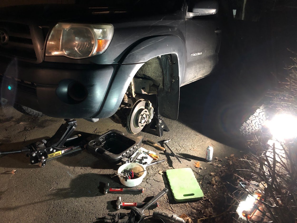

    here's the short version of what I did on the weekend.
    :worthless:
    XgmTRNdmEbSbh15mj_Xlwe81uIf6lTLPhqLn31nv_1dffad8766fc02c505d7be0e6d21ddb05f66b645.jpg

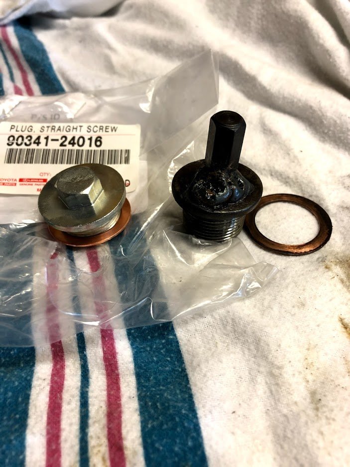

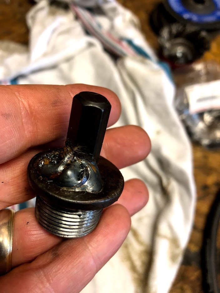

    had to weld an allen key into the Front Diff Drain to get it out.
    zlfZJCCwE4bLdqevsCunxtMRBQMUHYDMMUqXvdgL_c7c644607024eabe384fa7fe339caf222aca0f60.jpg
    Installed a Lexus GX470 ( I think ) diff drain that has a 14mm nut instead of the 10mm Allen hole
    qENruKD7t7E1HVfxoq2KIjvNatV9I8g_R4pcKKUT_c01b8ea2fbd4d2f63f7ce6b817c246c0ea30a5af.jpg

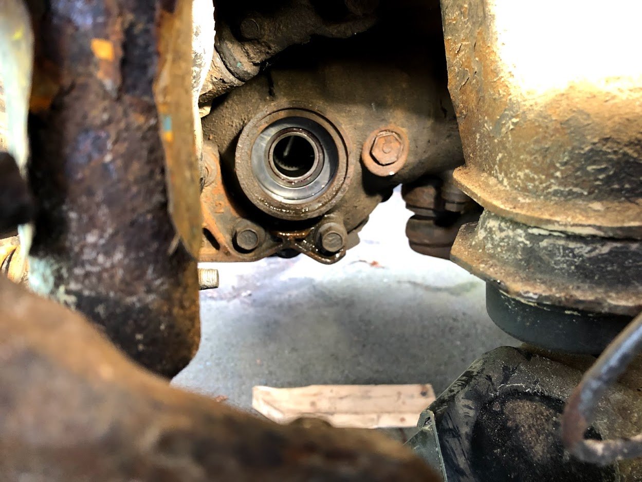

    new CV shaft seal that goes into the Front Diff on the drivers side, Mine decided to leak over Christmas

    Mr7sYt6XR2etZ-ktf6wpqaI3nNZ7AtyZCXvJIuwW_66b23084eb2b68f73deee3459ea131d2bf253226.jpg
    CV Shaft out, Bearing out thanks to the ECGS tool, Easy Peasy!

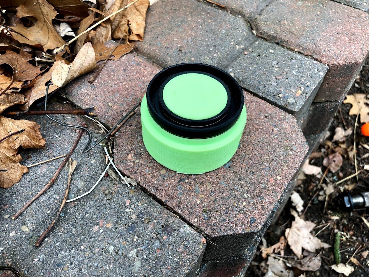

    LgyTPAwwRQMrLzY2fpJUwcCSjmWMn7krvp87Xh-2_2869689e1d6e9c644499aa4ad5789d5d1cc5bf5d.jpg
    My own custom designed and printed Front Drivers side Diff seal install tool. This installs the seal 5.5mm deep in the hole ( according to timmy the toolman's youtube channel )
    works really good with the dead blow, just pound it till she stops.

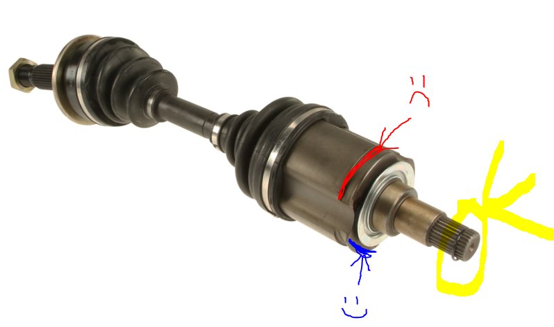

    Just to clarify a few things about what I was talking about regarding getting the CV axle out of the diff.
    first I was hitting it on the cut out's highlighted in red, I got no love from this ( and yes I know that's not a factory Toyota CV, but you get the idea )
    once I hit it between the dust shield and the tulip shown in blue, it came right out. I used a medium prybar and my 3lb dead blow.
    in yellow is the C clip, in this pic the opening of the clip is not facing down, see how much it sticks out now? Imagine that's inside your Diff, and you are trying to remove the axle, not gonna happen. That's why IMO you need to keep rotating it and trying to remove it until you get the clip just perfect so its not sticking out much. Also I would recommend you buy a new C clip so that you can replace it once its out. I'll bet you a coffee that it got a bit chewed up
    I beleive its part 43411c on the diagram below.
