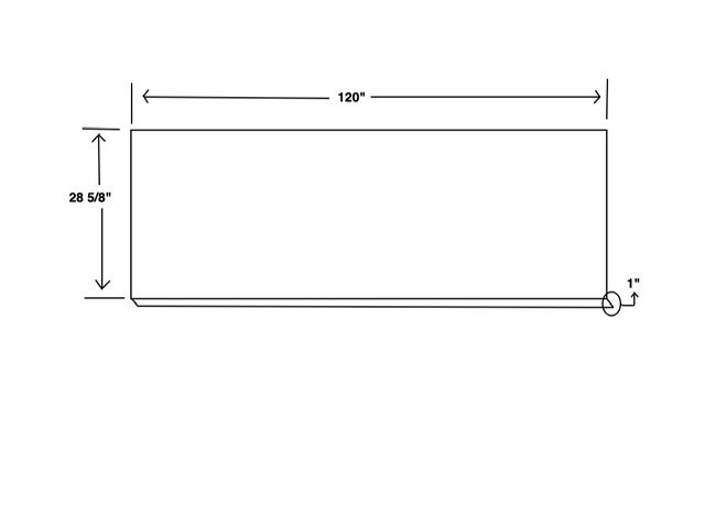

    I've been thinking of this.
    I don't know any place that would bend it for you. When I had the slider plates bent, my shop had to farm it out and never told me who that was.
    but if the metal is thin enough, could you not just "hammer" it over the corners?
    do I understand it correctly? you are going to have a wood table that you want to cover with thin sheet metal?

    You got it. It’s a bench with a top made with lumber. Just want a thin metal topper for it so the oils, dirt, shavings and whatever are easy to clean off.
    I don’t think at 10’ that I could ever hammer it anywhere close to straight. Just needs the bend so I don’t catch myself on the sharp leading edge.
    I’ll probably just google sheet metal in HRM and call around for quotes. Working in buildings I have seen much much larger pieces of sheet metal bent for giant hvac ducts so someone has the tools to do it. Just hope they don’t want a fortune.

    If the metal is light enough, I'd try to bend it on your finished wooden bench by pinching the metal against the wood with a piece of angle or square tube and some clamps. Might be too redneck?

    I thought about that but the metal alone won’t be cheap and I’d certainly screw it up haha

    Rona used to have a brake you could use if you bought flashing aluminum from them, maybe ask where ever you're getting the metal from?

    I was just talking to my Stepfather about this the other day.
    breaks used for aluminum flashing only come in one size. 10' He's never seen a bigger or smaller one and he's been building houses for 40 years.
    I asked him about doing steel in it, and he was pretty hesitant to even suggest a size since the breaks are usually made out of aluminum, and meant to bend aluminum.
    i'm sure there is a way.
    what if we just welded it and did a modified Pie cut on it?
    like get it the size you want with the overhang you need, then we take a thin cutoff disc and make slits in the steel to make it weaker and easier to bend, then once bent, we weld up the slits. I've done this with trying to bend thicker metal, and its worked well.
