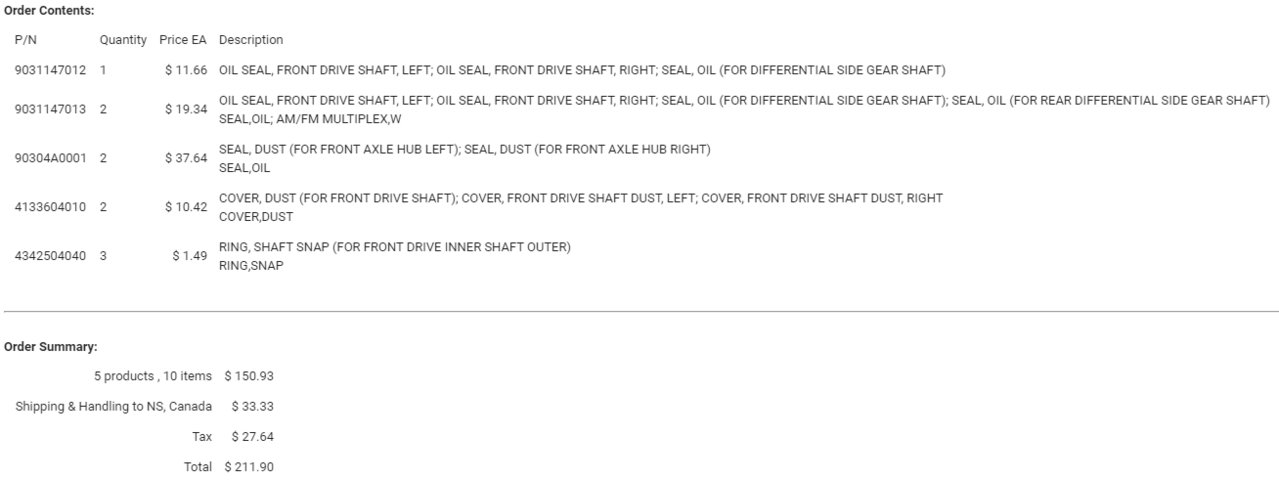

    I just ordered a bunch of seals from toyotapartsdirect.ca
    I saved $80 on OEM seals that way.
    I'm getting a bunch of seals for when I do my lift & fix that passenger side front diff leak
    Toyota Dartmouth wanted $280 + Tax
    TPD.ca wanted $211 total.

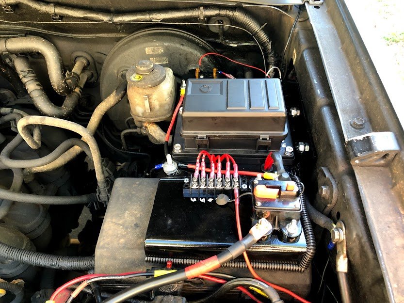

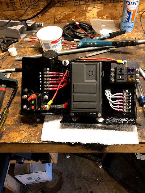

    I finished up a project that's been sitting on the bench for too long.
    this is actually version 3.
    its an aux fuse panel. 6 fused relay's for high powered stuff like lights etc. And 6 regular fused connections for lower amp stuff like CB radio, and Hood lights.
    I was tired of my relays getting water damaged, and that every time I wanted to add something, it was another messy wire stacked on the already busy battery post. This way anything else I add should be fast and painless. The Positive is fed from the main breaker to the relay box ( waterproof ) and also to the fuse block you can see in the upper right. Just to the left of the relay box and above all the red cables on the left is my Negative post for easy access. I have another negative post on the bottom that I ran a wire straight to the battery
    I still have two fused wires going to the battery since I don't trust the Princess Auto fuse block to handle the high current needs of my trailer wiring, but I'll figure that out soon enough. I know I only have 3 things on it right now, but I plan on adding more lights, possibly an air compressor. The idea was that it would be more than enough, and I'd never have to think about this again. I should probably start a build page.

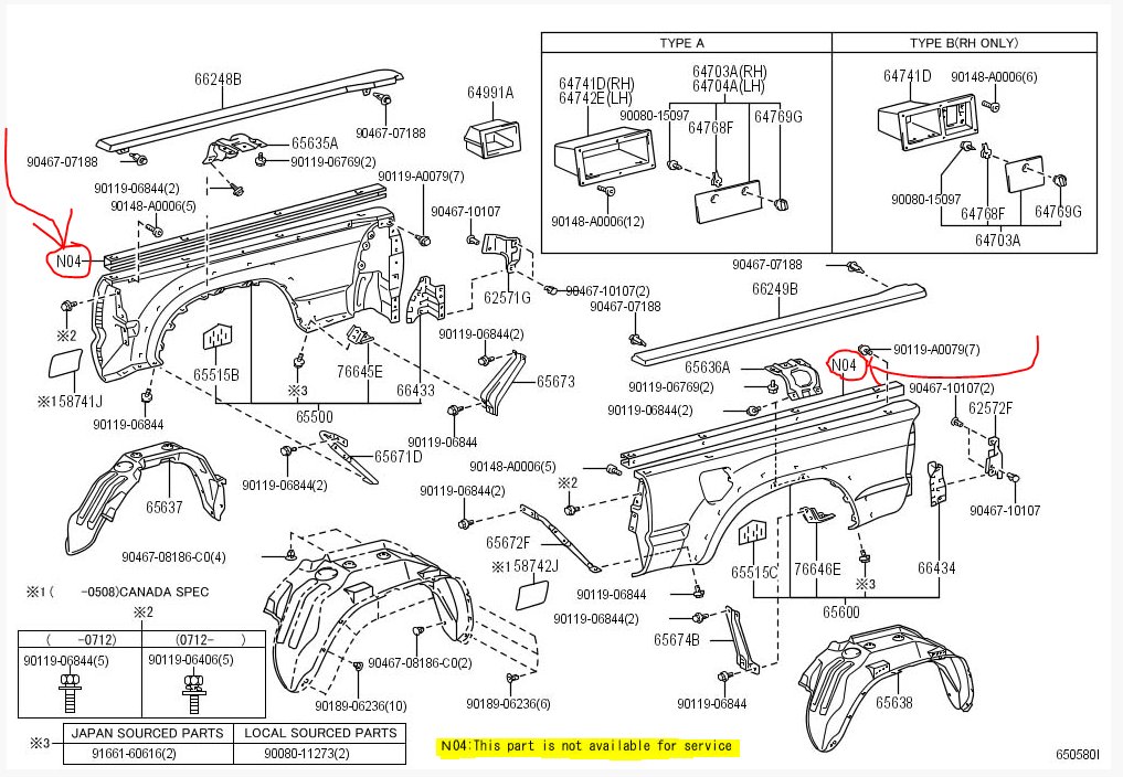

    You might be looking for this:
    PT278-35100-LB
    I got mine a couple weeks ago. Of course, my truck is a long bed. The diagram you posted looks like a short bed.

    That's pretty sweet. Did you build the fuse panel from scratch? I've thought about this, but I don't know anywhere near enough to screw with all that electrical. Plus, the only things I've added are fog lights (that stopped working) and a dash cam. So I don't really need it.

    I did,
    Wired up all the relays and the fuses myself, crimped the cables. I'm pretty comfortable with electrical stuff and have no problem helping others with their projects if you wanted to try this your self.

    How did you make the mounting bracket?
