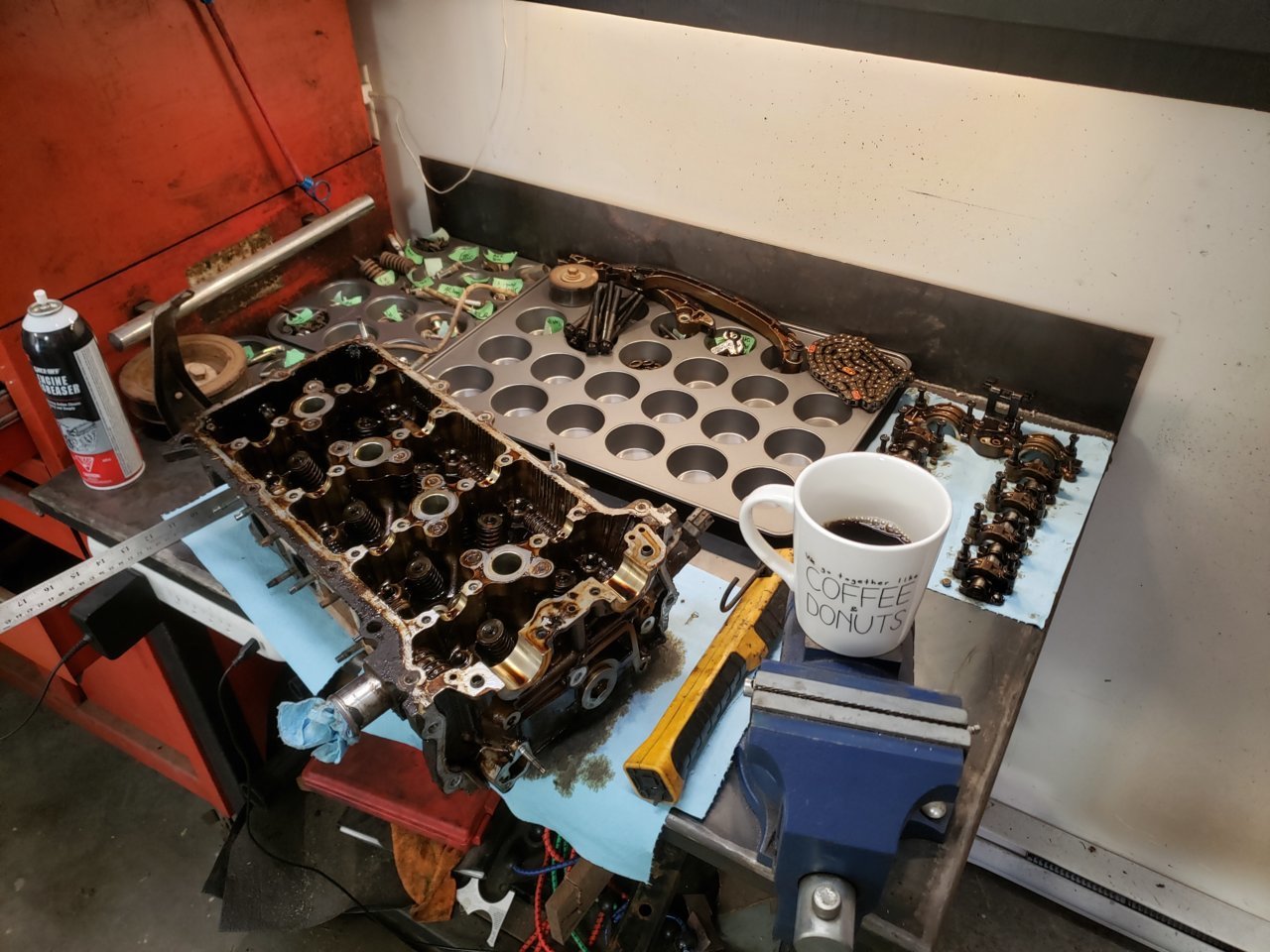

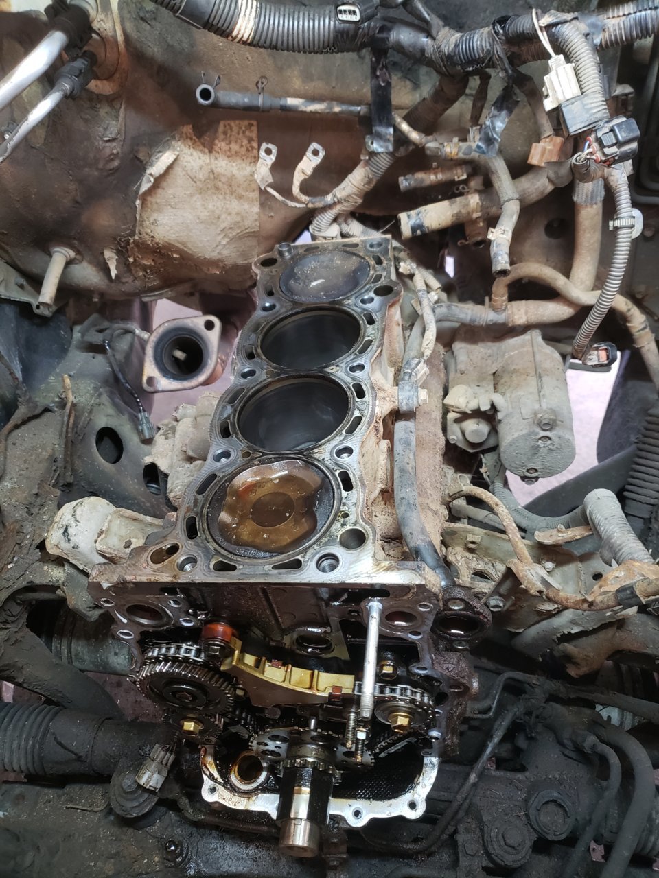

    It looks to be a BHG. Hairline cracks between each cylinder. Still need to check for flatness, but just slapping a headgasket in seems like the way to go at the moment!

    I had the same coolant issues and it a new HG solved all my issues

    There are hairline cracks between all the cylinders, so it's looking like it's a head gasket!

    Trying to decide what I'm going to do for gaskets. I think I'm going to go with an OEM head gasket, the Toyota gasket is MLS, so there's no real sense in upgrading that.
    Also.. would it be worth tossing a new chain on??? The Toyota chain and guides are relatively expensive, I don't know much about chains and guides, so I'm going to take them over to dads later today for an expert opinion on the wear, and I'll measure the chain and check for stretch (I don't own calipers) and see what he says about them.

    If you're planning on running the engine for a long while new guides at a bare minimum. I typically replace all timing gear at once if it has over 200k on it. No sense in risking it after putting all the effort into tearing it down and rebuilding it.

    I checked the wear on the guides, they're at 1.8mm, and spec for replacement is 2mm, so I'm going to order a timing set for it.
    I'm not going to bother doing all Toyota stuff, I've decided. The next time this engine dies, it's getting a +4 cylinder mod (or maybe before), I don't have the time or funds to make starting that project justifiable. Plus, I need two sheets of drywall to finish the basement walls and I'm gonna have to bug dad to take me to Home Depot, just like my pre driving days lol.
    Had the head into Nova today, buddy said there was a .005" twist, so they skimmed it for me.
    Also, the truck as 326k on it, and roughly 150 of those were turning 33's the poor little 4 banger did not have an easy life.

    I haven't touched the truck the last little bit, been waiting on parts! Head bolts should be here tomorrow, and then I'll start picking away at reassembly.

    did you figure out why the valves on Cyl 4 were a bit white?
    TacoMitch93[OP] likes this.

    No, I didn't! Everything else about that cylinder looked good though
