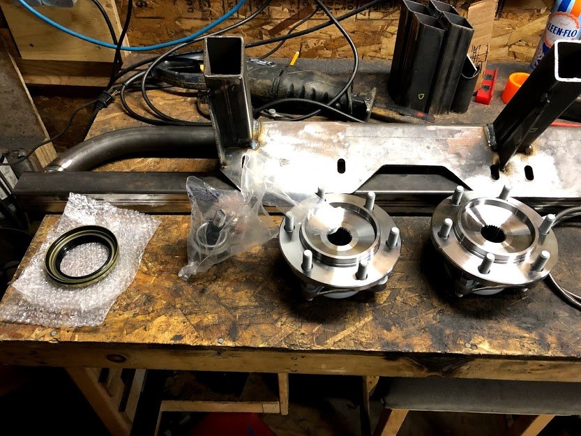

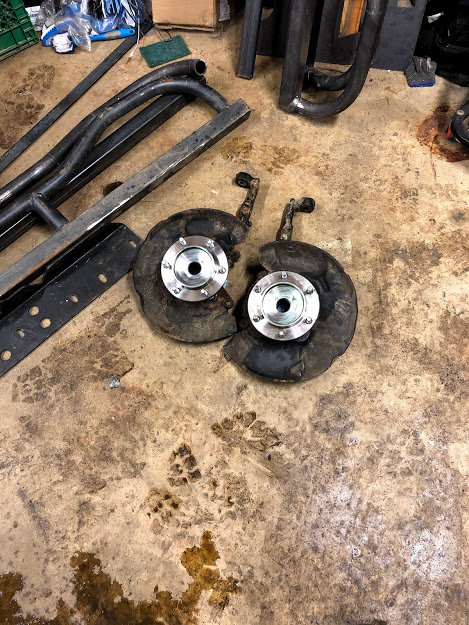

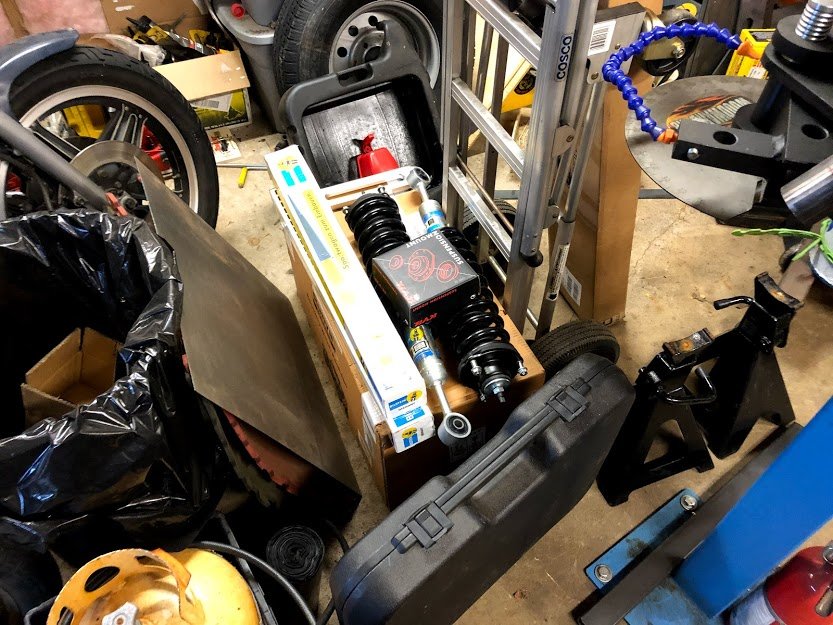

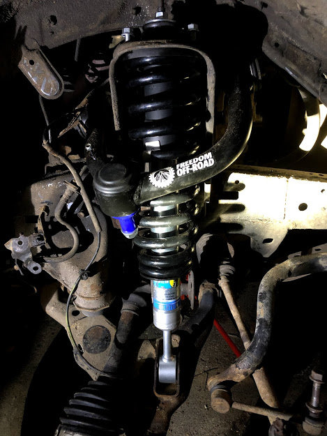

    the Hot Snot gun work on my end has slowed to a crawl..... Truck failed Safety the Friday before Christmas, and I've been working on it ever since.
    the Shop wanted $1,300 before tax to replace the two front wheel bearings, and the drivers side BJ. I knew I could do all that work myself, and it just so happened that I was starting a two week vacation so I decided to order the parts from RockAuto and tackle the job myself. It also was a great opportunity to install my new lift.
    so far I've done.....
    2 new wheel bearings
    two new lower ball joints
    two new UCA's
    two new 5100's with OME 886's
    with the family and stuff, its tough to get time to work on it. a few hours here and there is all I'm able to do.
    what's left to do:
    put it all back together :)
    install new dust sheild on the drivers CV ( don't know how I banged it up so bad :( )
    install 2 new ABS Sensors ( because I'm an idiot )
    put on rear AAL's
    re-inspect.

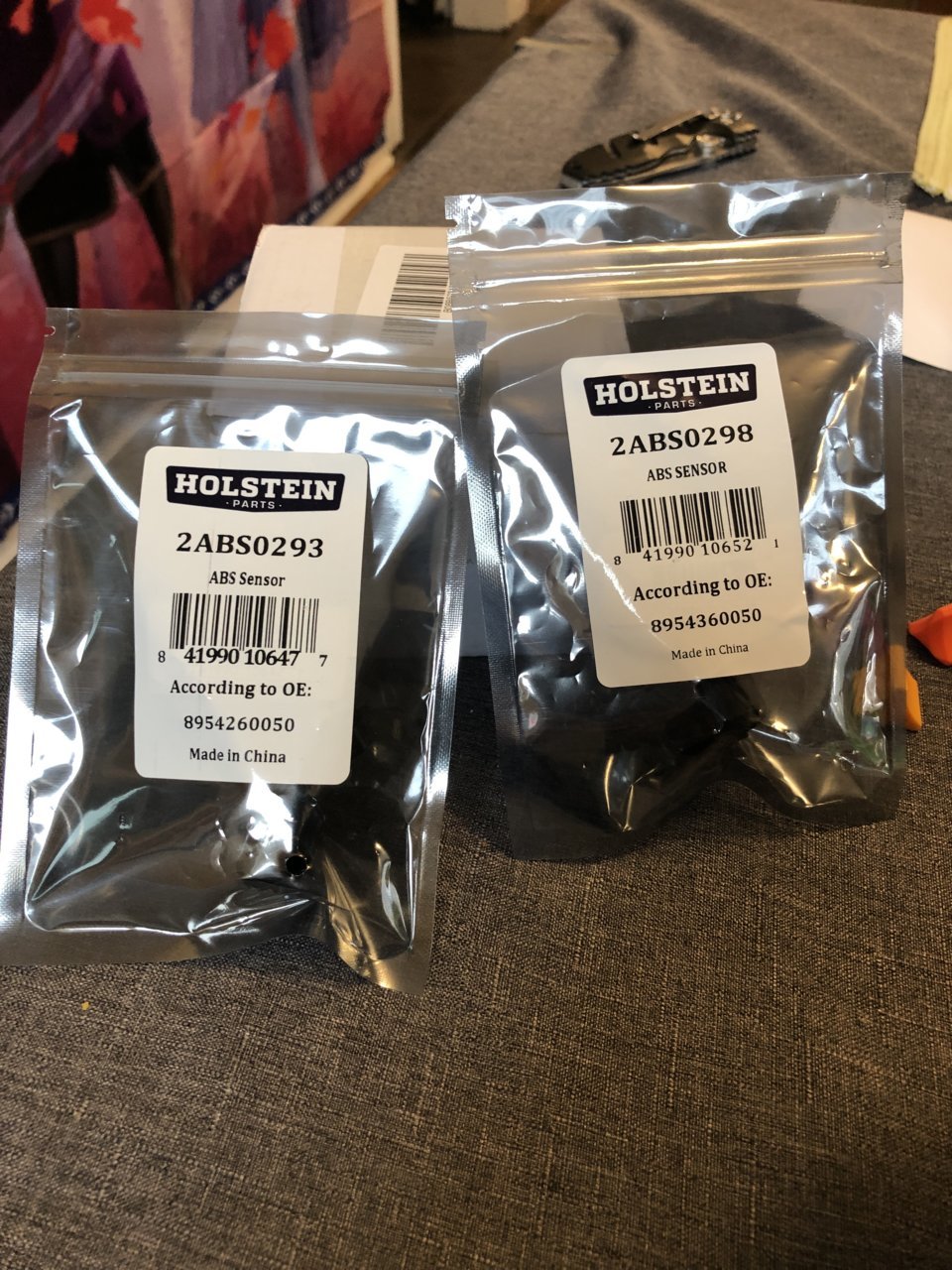

    Word of caution. Those factory ABS Sensors are EXPENSIVE! ( $170 EACH! ) so don't do what I did and break them off unless you have to. I was trying to do a "real good job" of cleaning off the bearing and seal mating surfaces on the steering knuckle, so I wanted to remove them so I could remove all the rust / old grease. Even though they are plastic with a rubber o-ring, they were corroded in place real good. So good that they pretty much broke clean off. I ended up using a punch to drive out the rest of the sensor. Had I known just how much $$ they were, I would have left them alone and cleaned around them. Gotta pay to play I guess.
    RockAuto does have replacements for $40, but who knows how good they actually are. Mine should be here Tuesday.
    Parts From RA on the bench

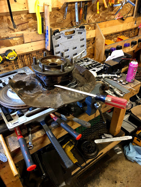

    Old & Busted.
    ACtC-3es9zT3WDGOkDV4sRY4i84DGqEXXeaSzKXs_d210db3d2d828f71503b8ac35af6678fa099d55f.jpg
    New Hotness
    ACtC-3eh76Ihd_gCCpNp63yf6sqBkvQmMfMOtFCB_b83a4c267dee5337c839b1c449dfedefb248a325.jpg
    Old & Rusted
    ACtC-3fqBaU5OeVONGakWkpbIiroXqk0Dmj3lNj3_6fcec7d3064385939fa256446ca2734de9936dde.jpg
    New Hotness
    ACtC-3dhNLaMeulzCGVEdbIq0oqDJLEkYMN6xj2s_644f1d399c22f6396207a2946087f6d241573ace.jpg

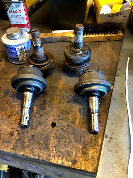

    Upper Right is the factory ball joint that failed ( 420K! ) The Moog on the upper left was still "good" but I snapped off the grease nipple over a year ago, so replaced it anyway since I'm sure it would have failed soon anyway.

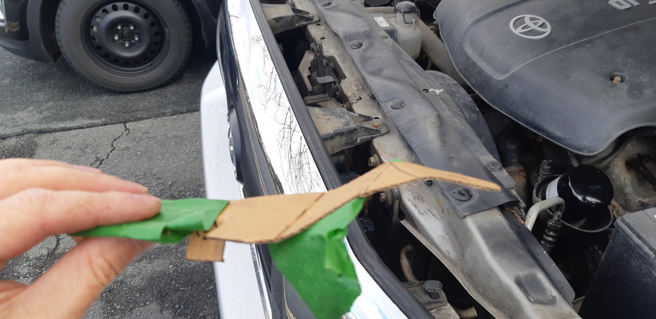

    I'm doing a little CAD work myself

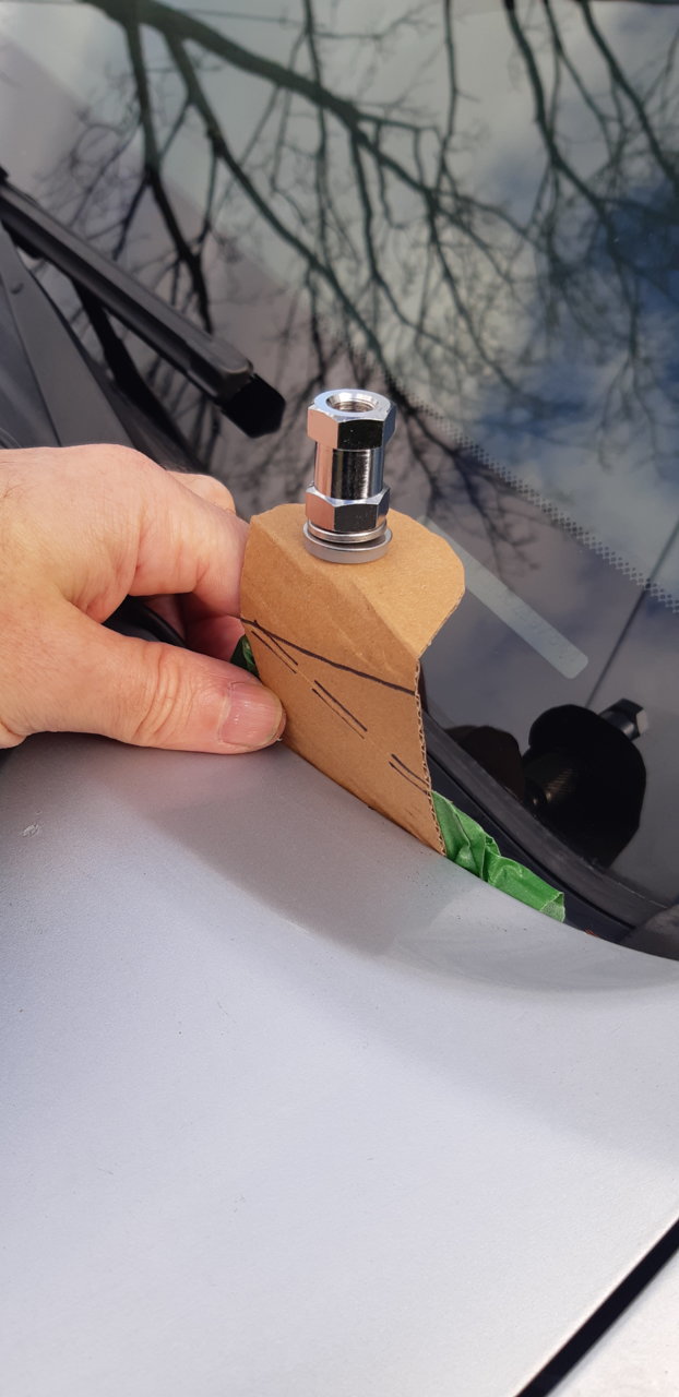

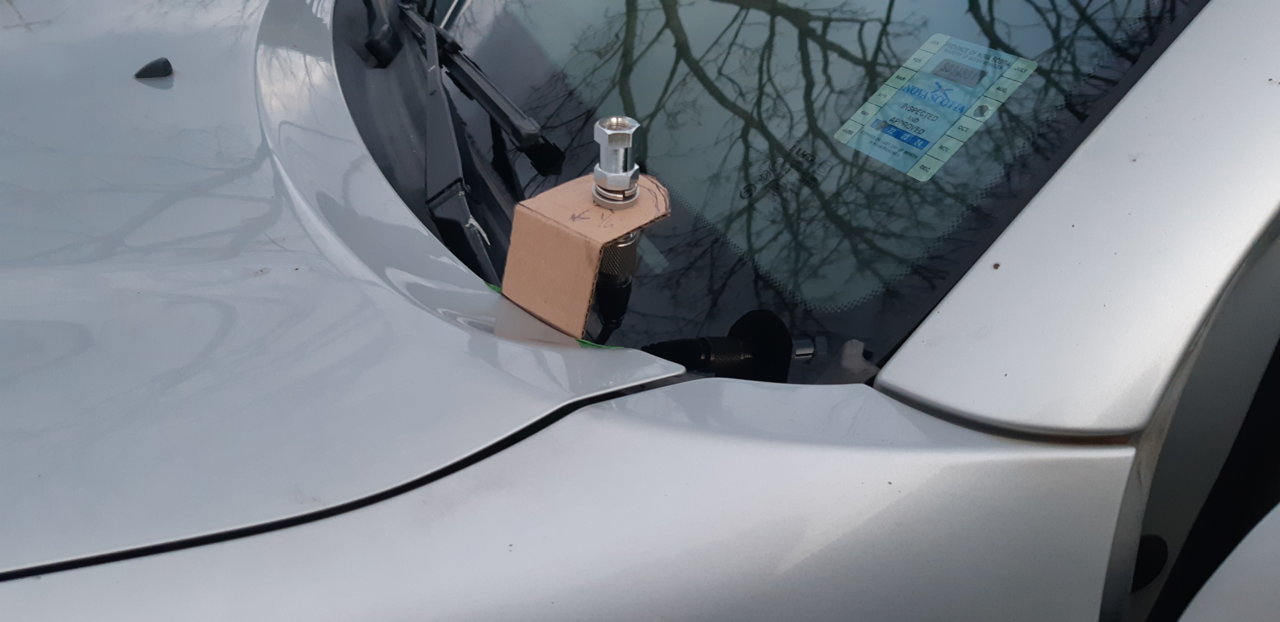

    Well shoot, despite my oh so careful CAD work I not only managed to bend the first attempt the wrong way but the wiper had a little conflict of interest with take two so I had to drill a second hole in it. Good thing it's only temporary right @Canoehead ?

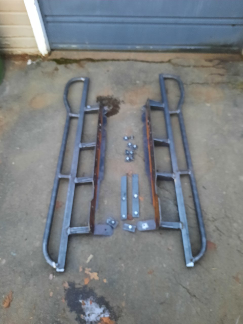

    Ready to mount. I'll paint them in the spring when the weather is warm enough for paint to cure.20210101_165100.jpg
