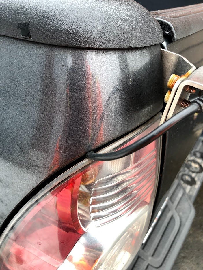

    Antenna mount
    ACtC-3cVAS7-JUAH0IB-Q6vHJd2YCjrwd_1ThsWI_186e3f1fd8f52fd01554c00ee86c9150ef61ab11.jpg
    how its screwed in ( yes I drilled 3 holes in the body )
    ACtC-3fIa7-TiaRCY7GTBxLXKu-7vmGPJF6gyXxp_f4525eb4bb325fc3f1fc096236428bb508306ccc.jpg
    I sneaked the wire in between the body and the tail light.
    ACtC-3deW06LGjf9t52pg1CxfvvpY2y8zd4uZCEQ_c97392e75b1e6654cc12850016b03c7ea4d143f6.jpg
    tried to get a pick of the little "box" that the WX75 connects to under my seat, but its too dark / small and works perfectly. I zip tied it to the seat springs. Easy to get to, easy to remove if I had to.
    the antenna wire is routed along the frame, and up through one of the body plugs under the drivers door. I used the 18' firewire cable that has a really flat connector on the antenna part, and has this nifty screw on / off adapter on the radio side that allows you to remove the "fat" end of the cable for easier routing through firewalls / plugs etc...

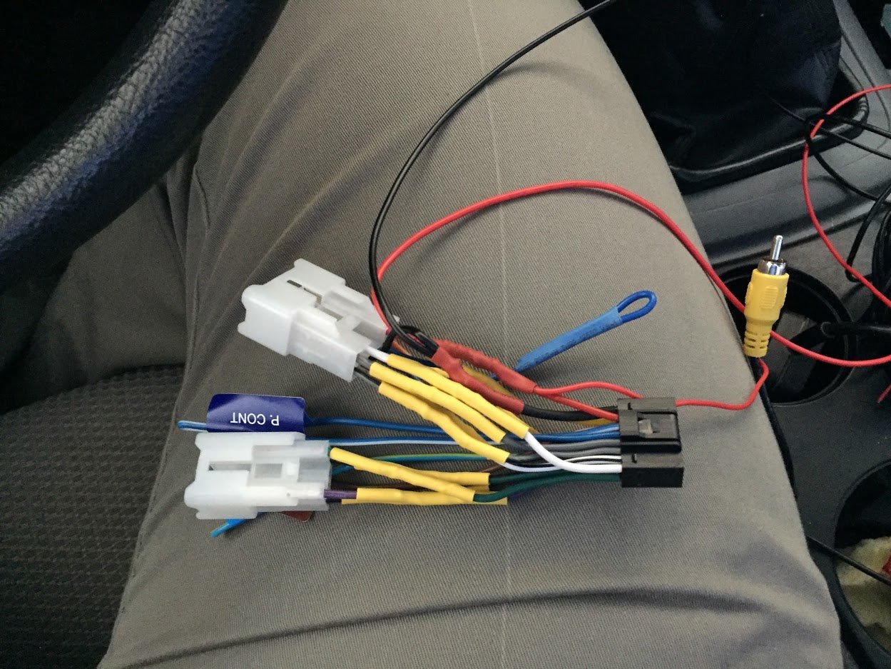

    i'm slightly against cutting factory wiring, I'm an adapter kind of guy.
    Soldered up this little guy to make it easier to go back to stock if I ever had to.

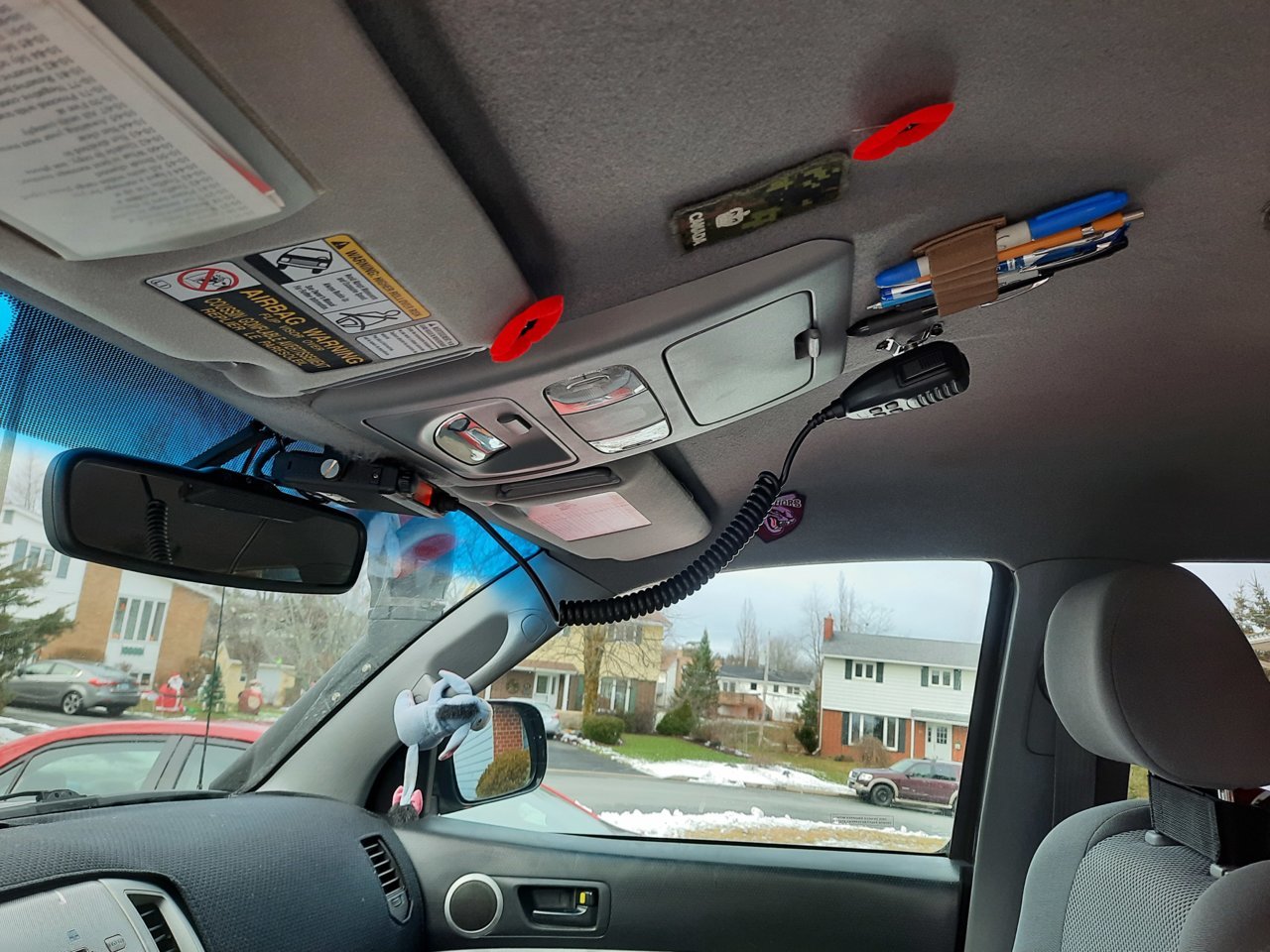

    I used to have the compact Cobra, but it finally died on me. I replaced it with this nice little Uniden.

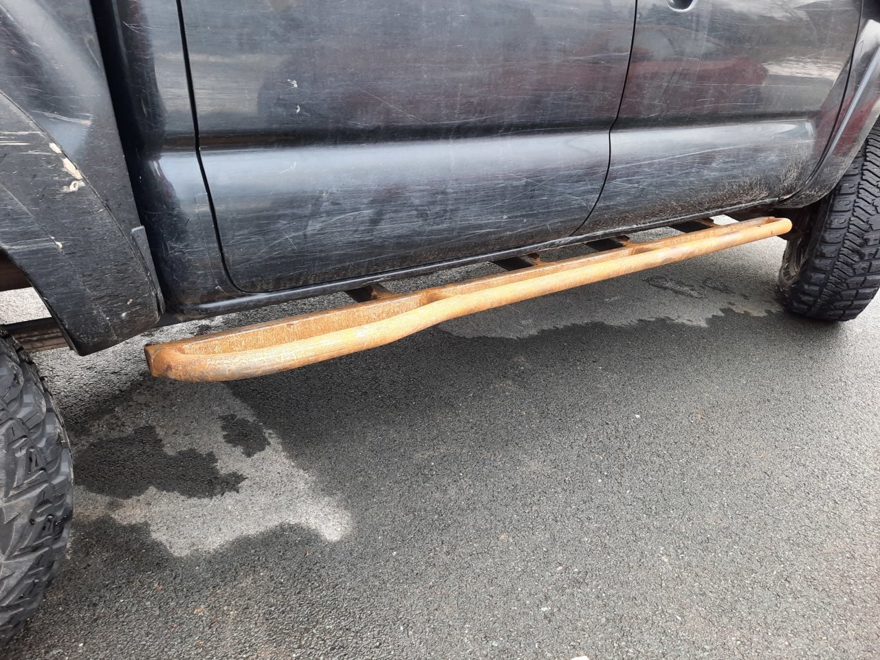

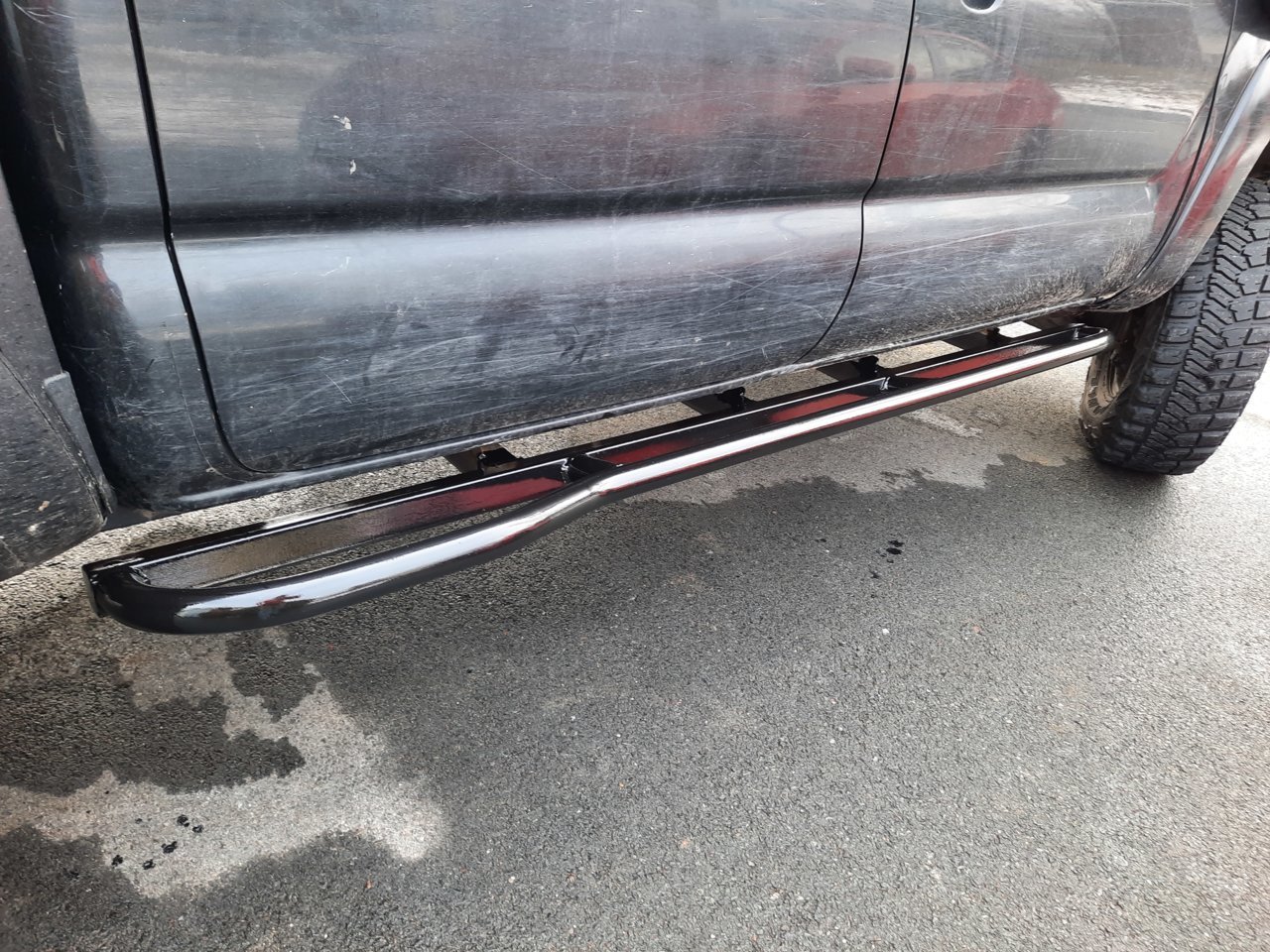

    Was looking at the new sliders. They got ugly fast.
    So, I gave the prep work some thought. Then I just brushed on some POR15. Should hold me over until spring. If it can dry at all in the cold!

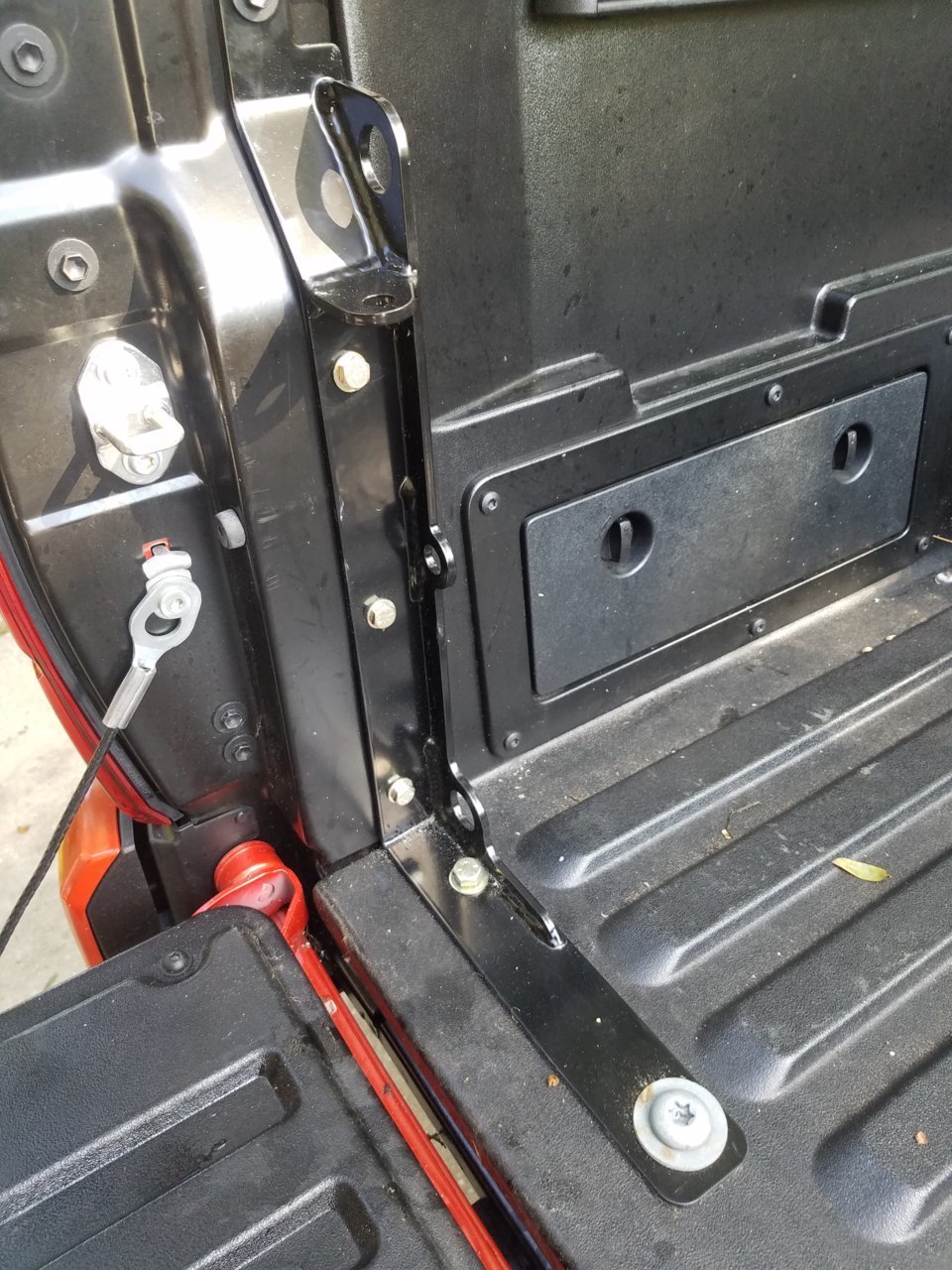

    Something like that? Doesnt have to be as fancy, would be nice to have a tie down on it though
