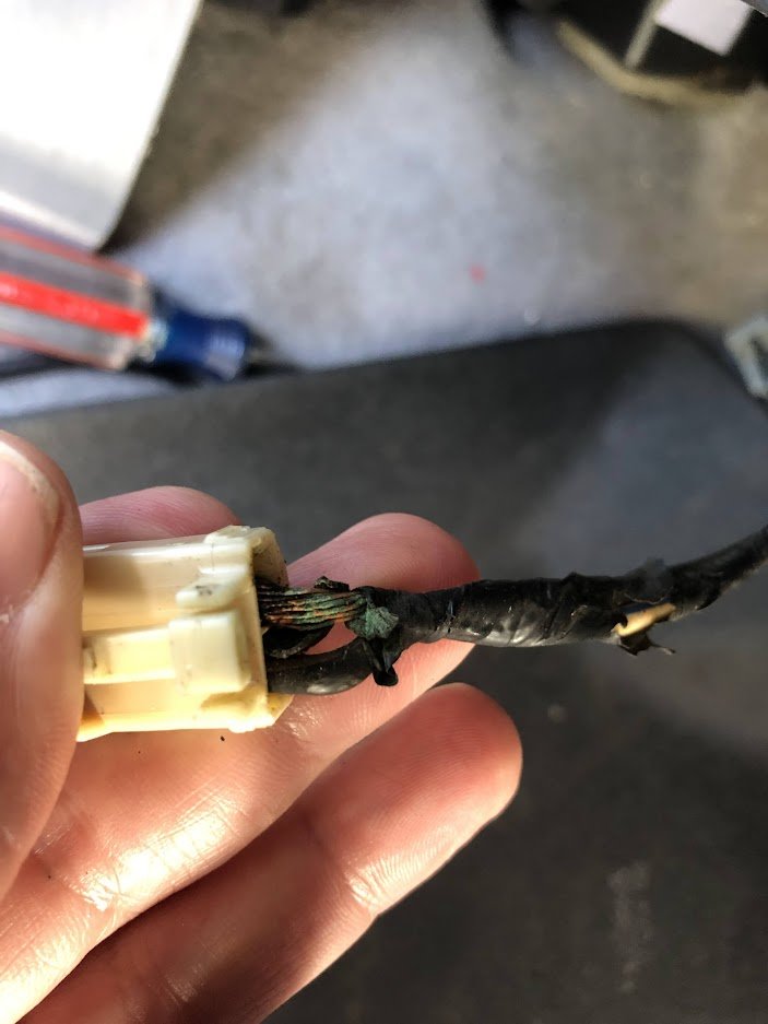

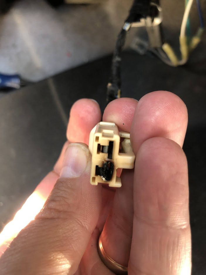

    Alright, I figured out my blower motor issue.
    I had this real nice write up with pictures etc.... but then something happened and I lost it, so here's the coles notes version.
    @k.strong you are welcome to my extra resistor pack ( solid state ) for the price of some coffee... Give me your mailing address via PM and I'll ship it to ya. I'll collect my "fee" next time we see each other
    so....
    Blower only worked on high, common issue, original resistor packs are known for wearing out due to excessive heat in the wires and connections getting burned.
    I replaced the old resistor pack with the Doorman solid state resistor pack and it worked for 3+ years, then I started having the same issue. only worked on high, then it stopped working all together. I jumped the gun and bought another doorman solid state resistor pack thinking it was just a "cheap part" and how it must have failed. Swapped in the new part after checking the connections ( they were all good and not corroded, pinched or burned/charred ) but no dice, only worked on "Hi" intermittently.
    Super Quick explination of the resistor pack and blower motor setup:
    the reason the blowers only work on "HI" when the resistor pack wears out is due to "hi" bypassing the resistor pack and giving the fan the full beans ( full 12v from the battery) all the other settings, low, med, med_hi are just different resistors limiting the voltage to the motor making it spin at different speeds
    the diagnosis:
    turned out that while my 1st replacement resistor pack ( solid state doorman part from Amazon ) was still good but the electriacal wires going to the fan motor were not. they burned. while un-clear WHY they were burned ( some TW.com peeps say the wires are too small and can't handle the current ) I suspected that my motor was perhaps in need of a good cleaning and the "dirt" was causing excessive drag making the motor work harder and draw more current making the wires hot and eventually corrode / burn.
    here is a picture of the blower motor connector, and a better pic of the wire.
    AM-JKLUu3iVFoIRIWHkPzphZpDG8bFL_SxFcO-s4_92c5ebb168b79044a4e9e89f6e043e4e535b264d.jpg AM-JKLX4s_z-iyqatVNO32oQEsBP6SCqd6h-maY__20d50931bba59588a5edd087bf49fded69037e94.jpg

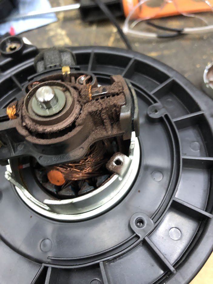

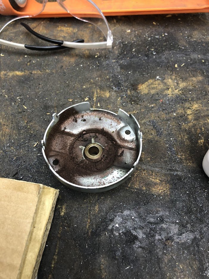

    I removed the motor, found a youtube on how to clean it and went to town. Only took 30 min to clean it. My only recommendation would be to take pictures during disassembly to help you put it back together. I mixed up the brush installation at first and wasted some time scratching my head figuring out how to put it back together.
    I used a combo of brake cleaner and electrical contact cleaner to remove all the "smoo" that was in there. I then gave the bushing a little shot of some lube ( pink rust check spray ) and re-assembled.
    AM-JKLUTajdjnpKyTkpYAvF5eutHnQUVdYCee1_t_8caa89a6f45ce75834e5dad37792c7178b0b0112.jpg AM-JKLUKoGQnmZA9JShiEK7LmPs1UkxWXuZwMDuG_7eb96bb25bc1f487ac717492a0a2308fcaf6d39c.jpg

    so this was toast, and the contacts on the blower motor looked a little "dull" so I got a small flat screwdriver wrapped some sand paper on it and made them shiny again. I then cut off all the burned wire which for me ended up being about a good 3+ inches of wire. I then stripped the original wires back and soldered on some new ones leaving me plenty of extra to connect back to the blower motor. ( Pretty sure I used 12ga wire )
    since the connector itself was toast I searched for another solution. Turns out female spade connectors slide over the blower motor connections very well. I used a multimeter to figure out which wire was + & - and then matched that up with the original connector then used a sharpie to mark on the motor which terminal was which. I mentioned that the female spade connectors worked, there is one small catch. They are too close together when put on the motor contacts, there is a risk of them touching, I got around this by using 1 normal "naked" spade connector, and 1 covered one. it was snug, but worked great.
    now I have all of my fan speeds and a long enough wire that If this were to happen again I should not have to re-solder anything, just cut, re-crimp and go.
