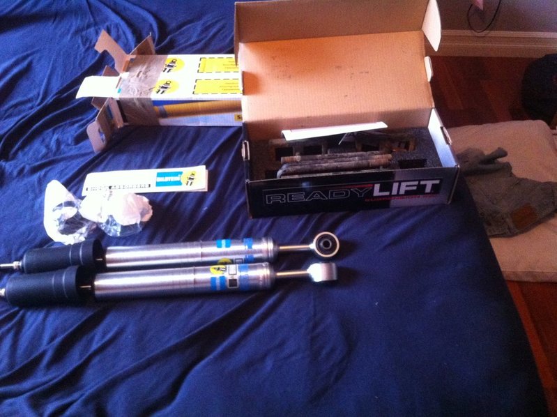

    Parts finally showed up. With a 1 inch lift block in the rear what should my billies be set in the front to level it 1.75 ?

    I am by no means an expert, but I reckon you will need them on the highest setting if you are using a block in the rear. I think the 1.75 setting would level if you left the rear stock.
    You could measure front and back to determine your current rake. measure from hub centre to the fender if you want to compare vs other size wheels (your own truck with new wheels, other people's trucks, etc.) or just from the ground.

    On a side note, blocks are hard on leaf springs and Tacoma leaf springs are notoriously weak....

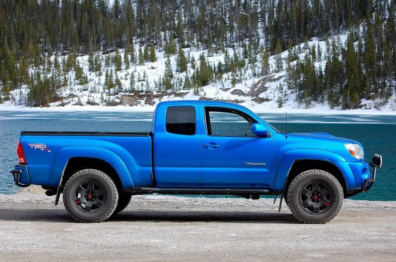

    This was my 2007 with 5100's at 1.75 up front and stock leafs in the back (if it helps at all):

    Blocks create a mechanical advantage for the torque of the axle wanting to spin, against the leafs.
    It increases the moment arm. That's why everyone with a tacoma should get new leafs....
