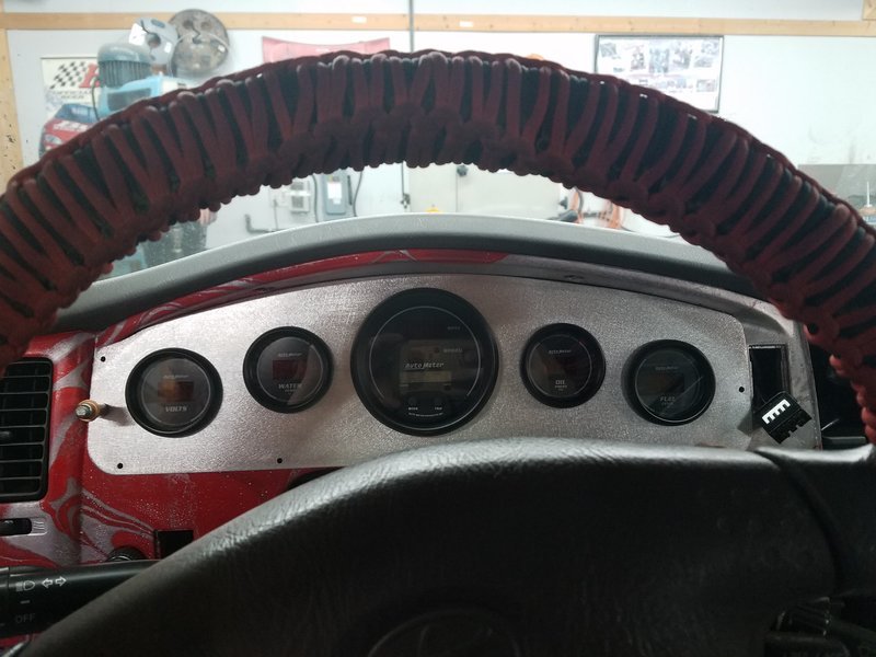

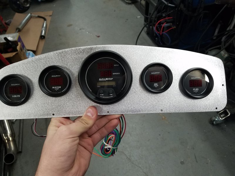

    yea i can't wait to get the new gauges done, going to have to modify or totally ditch the stock center console for the shifter and atlas sticks. probably just going to get rid of it.

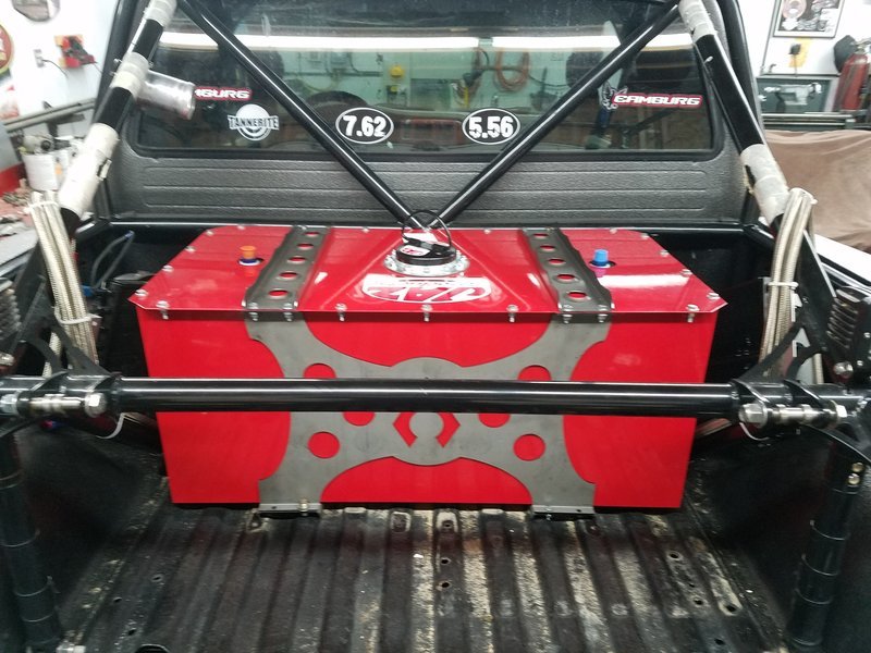

    Got this fuel cell mount done just have to mount it to the bed

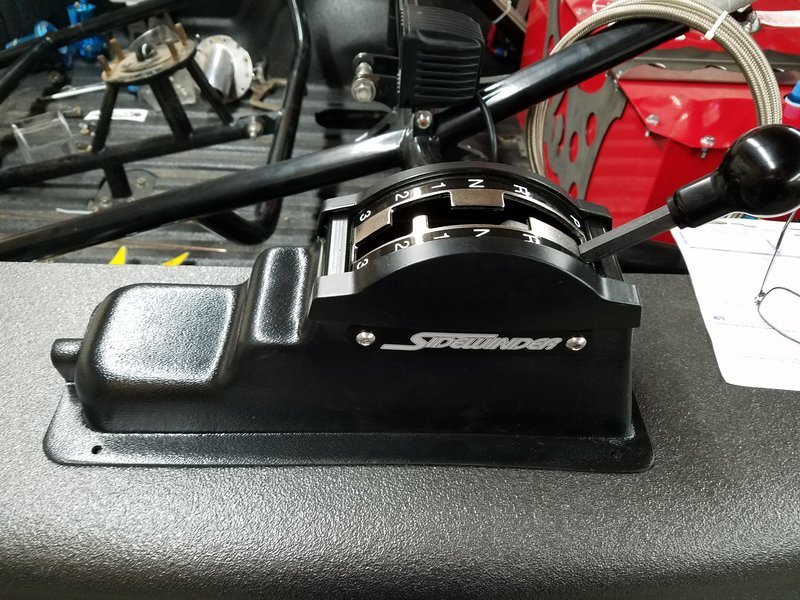

    Heres some pictures of the gauges and shifter

    Is that transmission PRN123? I know a normal Tacoma is PRN321
  10. Feb 27, 2017 at 8:49 PM
    #190
    Long_Travel_2002
    Long_Travel_2002 [OP] Well-Known Member
    Feb 22, 2016
    #179105
    572
    ivan
    memphis
    2002 tacoma LSA swap prerunner
    built supercharged LS, T56, Linked, caged.
    prn123.

    Weird

    Reverse valve body in transmission

    You can hammer it from first to reverse quicker with a reverse valve body in case the nose starts to come up on a climb.

    Ah I see, I'm 2wd I wouldn't know :D

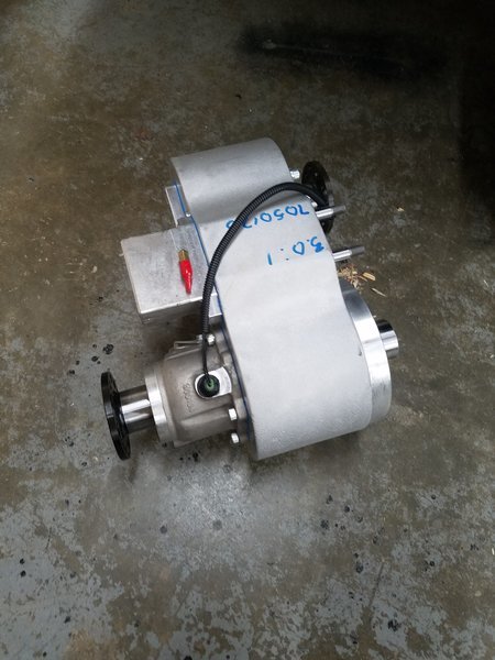

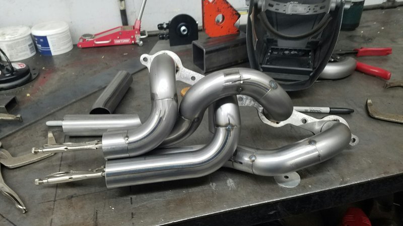

    #199
    doyouquaxu
    doyouquaxu Well-Known Member
    Dec 6, 2014
    #143779
    864
    What oil pan is this? Have you figured out how you're gonna do driver side exhaust and route the steering shaft?
  20. Mar 15, 2017 at 1:28 PM
    #200
    Long_Travel_2002
    Feb 22, 2016
    #179105
    572
    ivan
    memphis

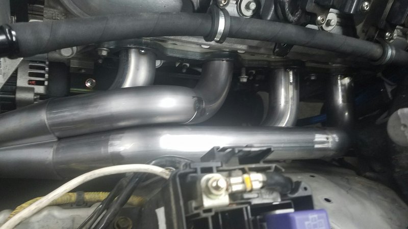

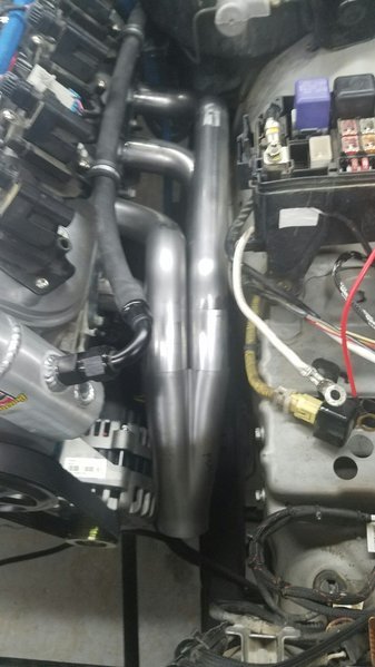

    Headers are mostly done and the Atlas came in
