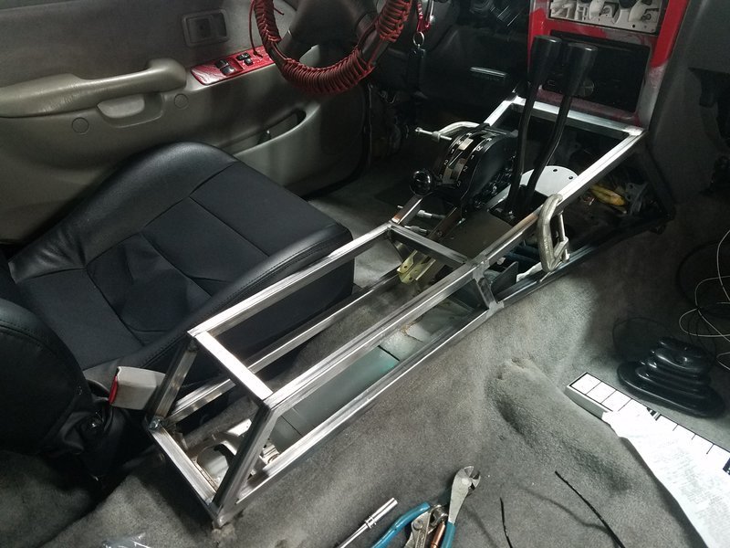

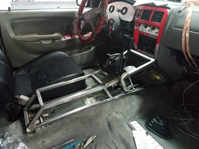

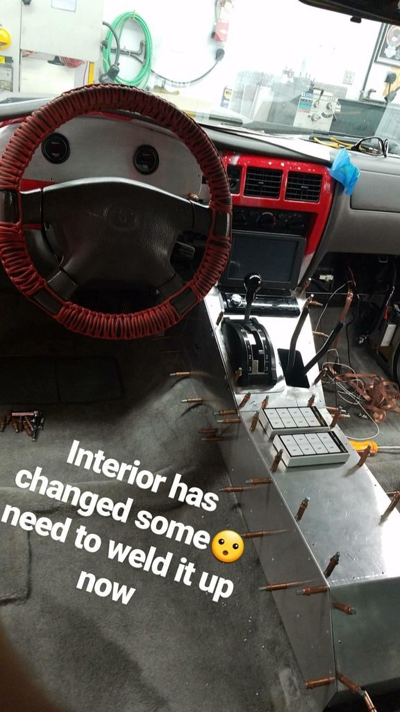

    So made some good progress on the interior. Got most of the frame built for the center console. Now we just have to skin it and mount all the shifters. Also got most of the interior pieces back together and fixed the bird nest wiring job done on my alarm by the guys that installed it.
    The holley efi dash came in and it is too big to mount where the stock cluster goes and if we did somehow fit it in there the wheel is stuck all the way down and the dash is at to hard of an angle. We did discover that it is the perfect size to mount where the radio goes. So now i am going to get a single din radio (wanted one anyway) mount it in the center console above the shifters and put the holley dash in its place. If we were to put the holley dash on the center console it would still be at a bad angle and would have a bad glare. I also put the trans temp and fuel level where the old cluster used to be.

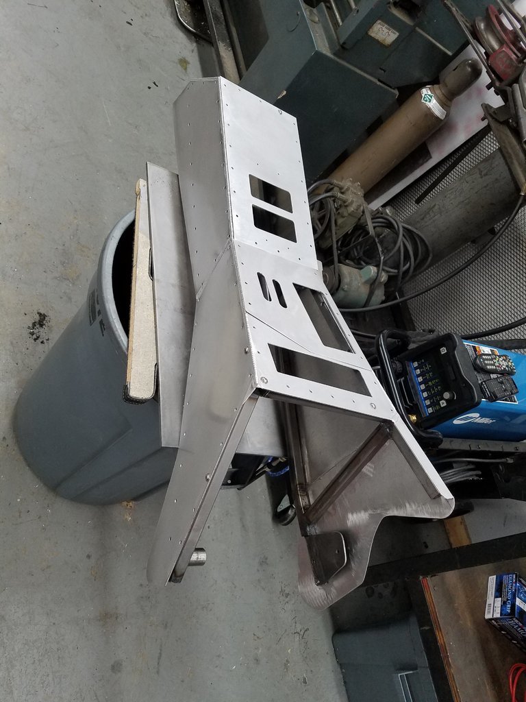

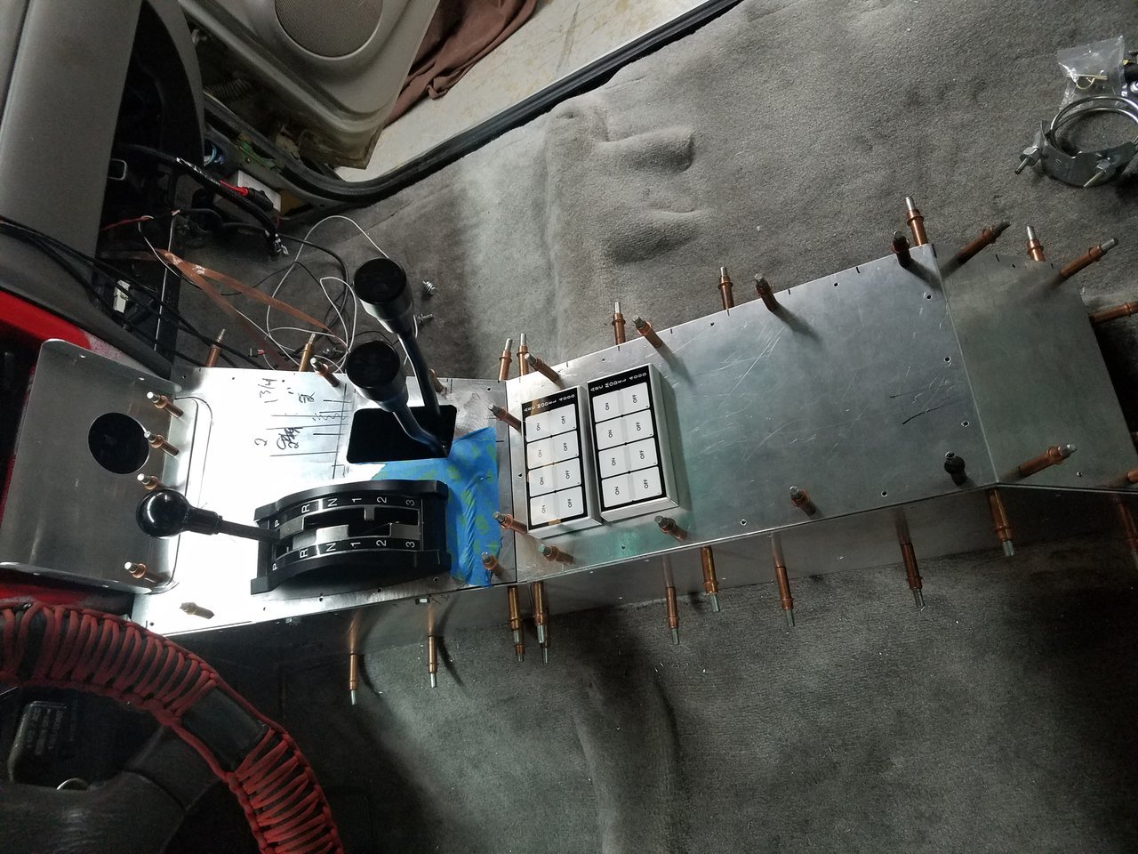

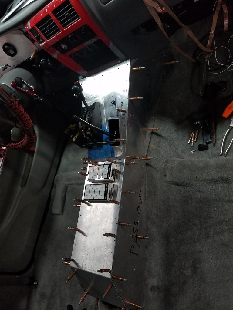

    Center console is basically done. We are taking it to a friend who is a aluminium welding god. Just need to make a small trim piece around the tcase shifters and mount my switch panels. Once its welded together it will bolt to the frame of the console and will be removable. 20170708_171725.jpg 20170708_154614.jpg

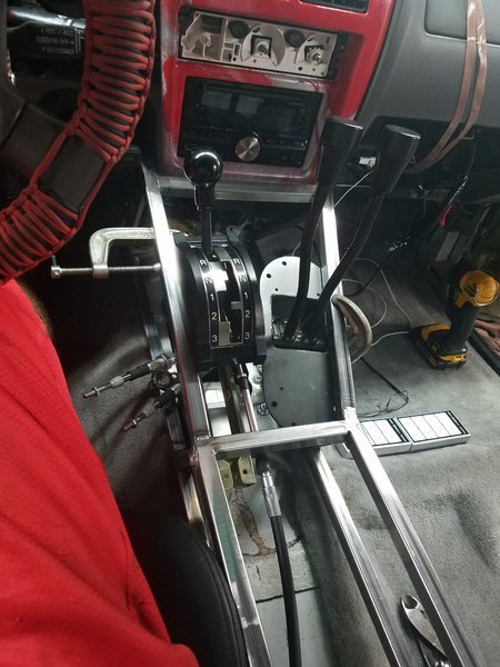

    Interior is a little different now. Need to weld it up, mount my switch panels, and most importantly a cup holder lol.

    Center console is about done. I ran out of bolts lol. Truck should be road worthy this weekend 20170801_190920.jpg
