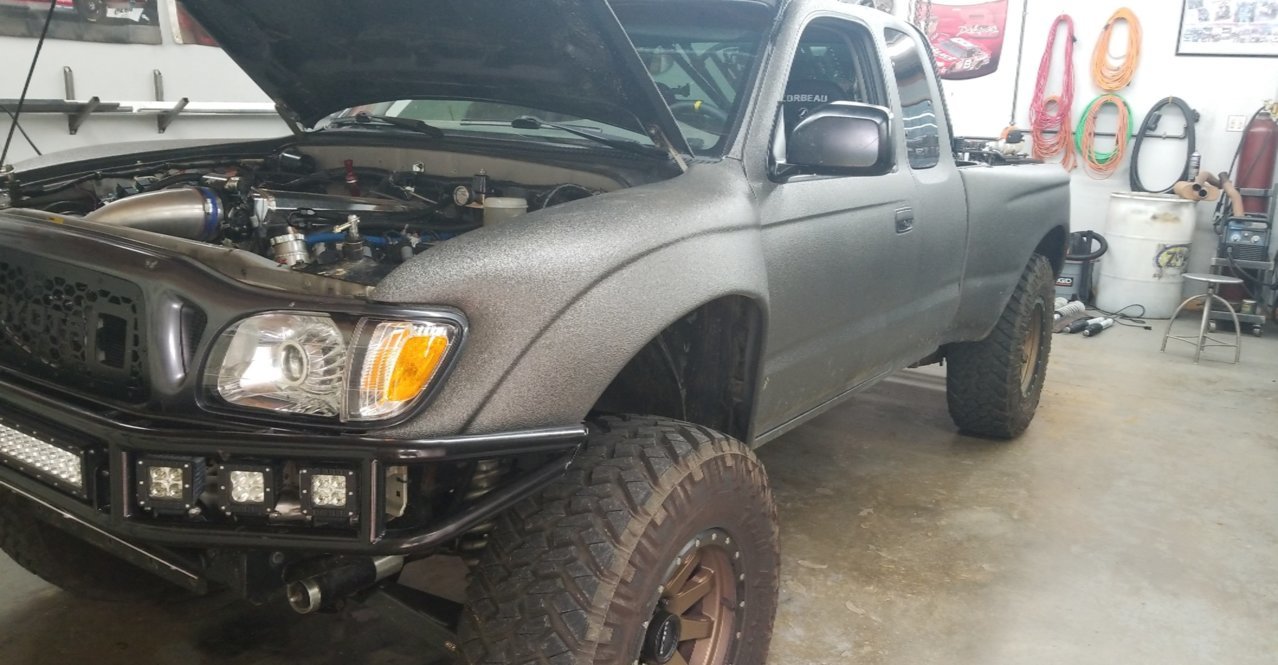

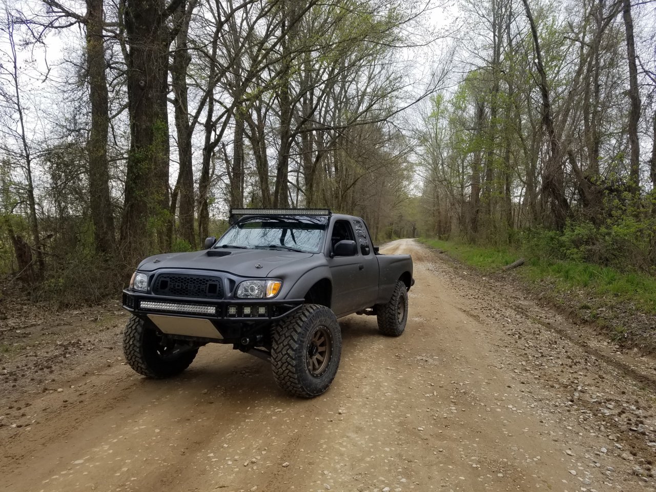

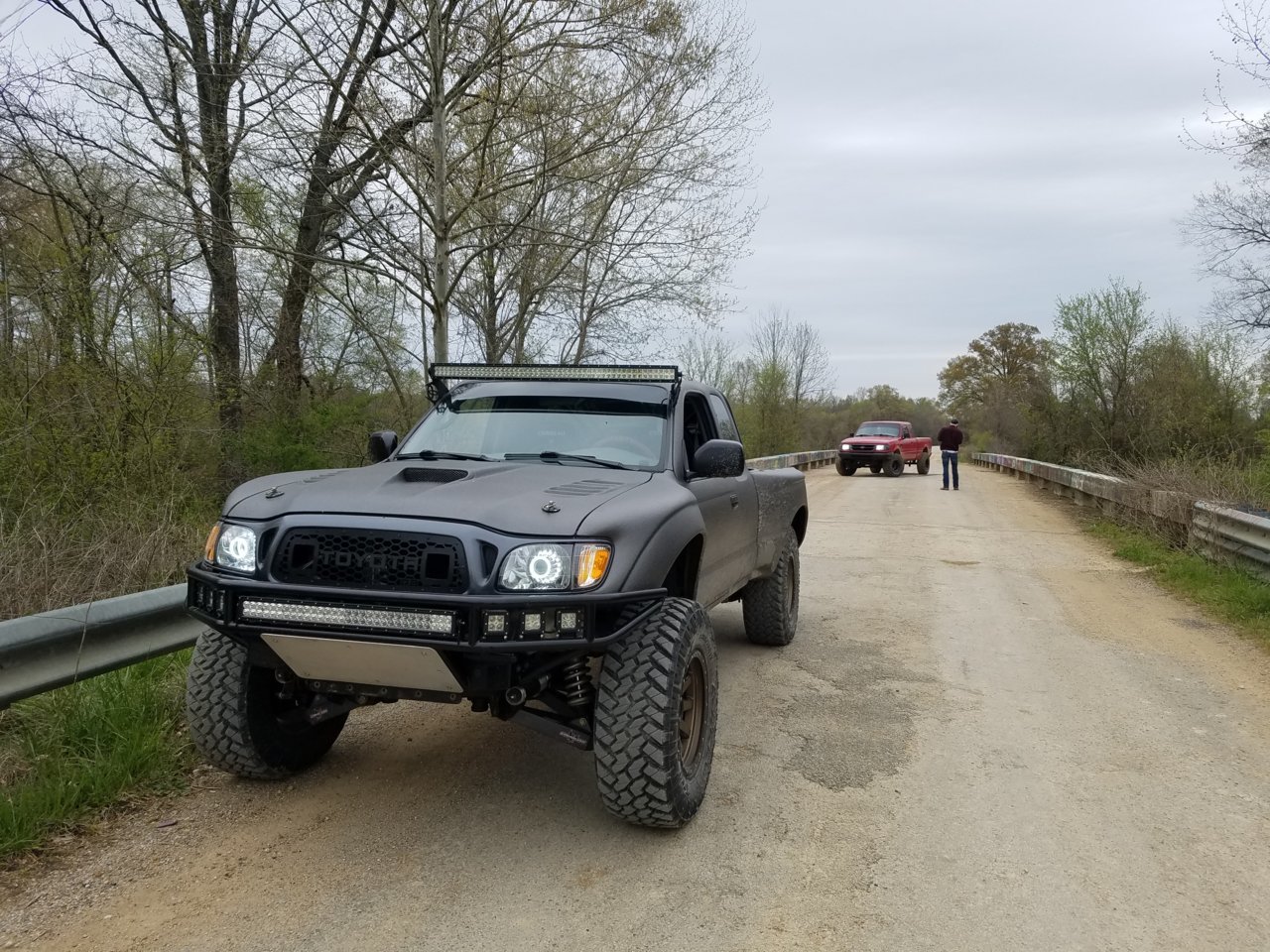

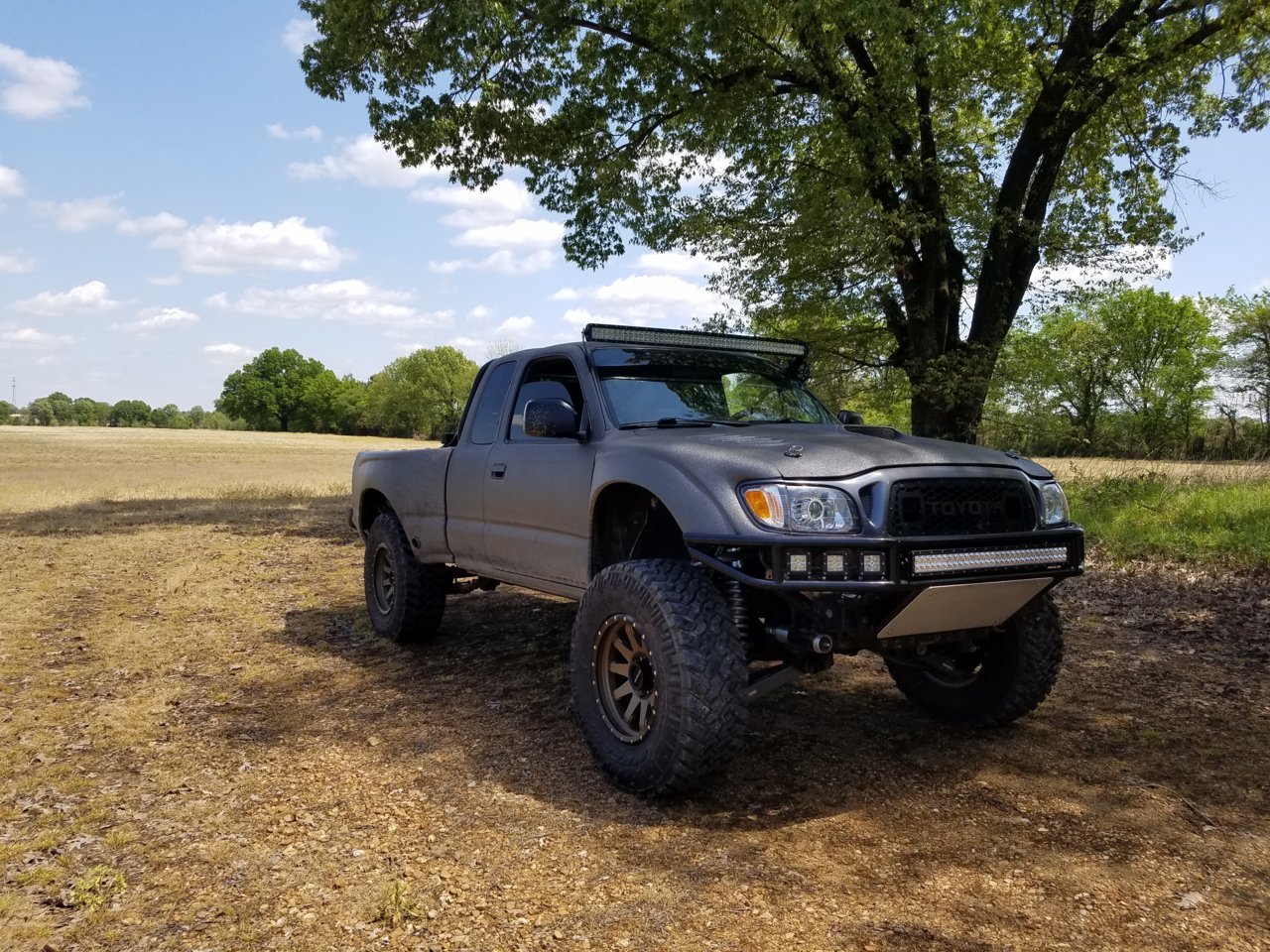

    haven't posted on here in a while but the tacoma got a new setup. race line clutches with a slightly smaller nitto trail grappler than before. went from a 315/70 to 295/70/17
    https://www.youtube.com/watch?v=WbXFSBJSbVc

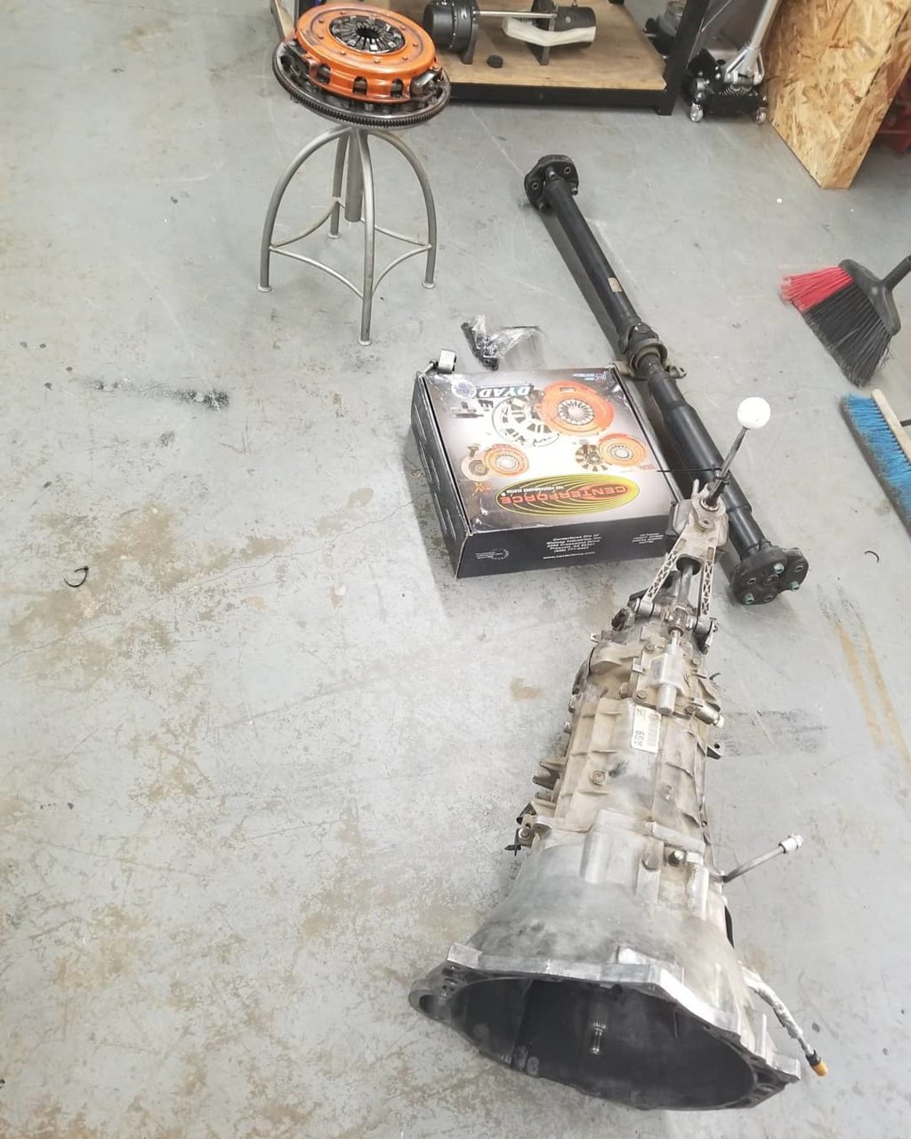

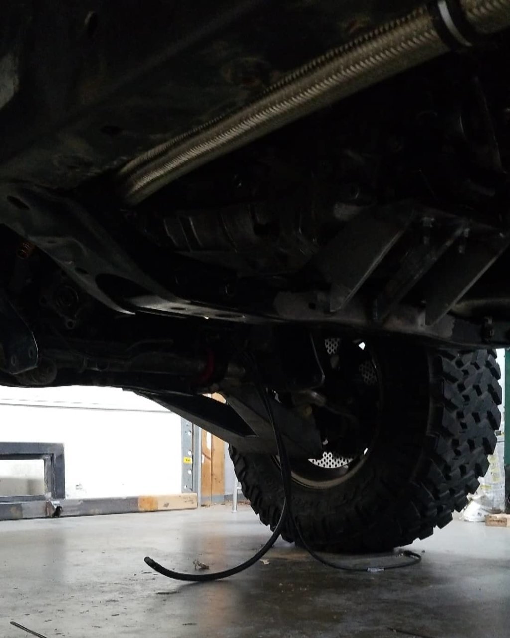

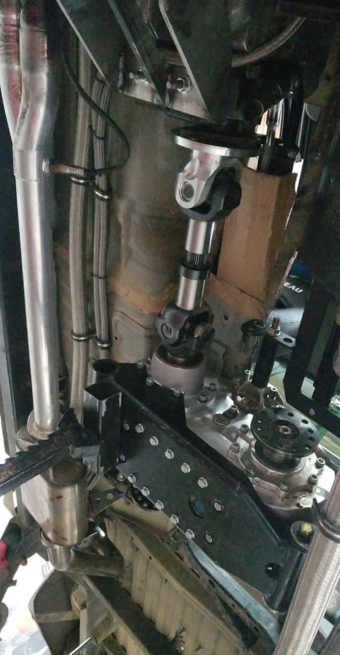

    Bad pic but out with the auto, in with the 6 speed:burnrubber: already have it in the truck, time to mount the t-case

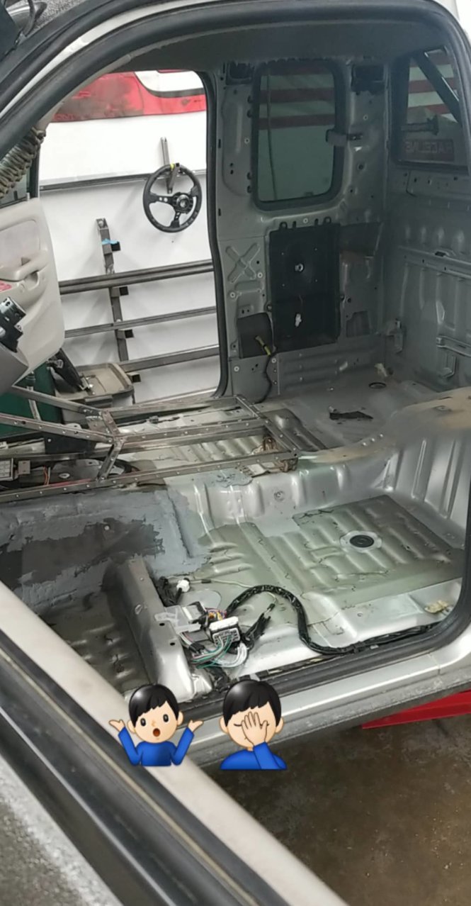

    Bad pics but interior is gutted ready for a cage and we got the trans mounted!

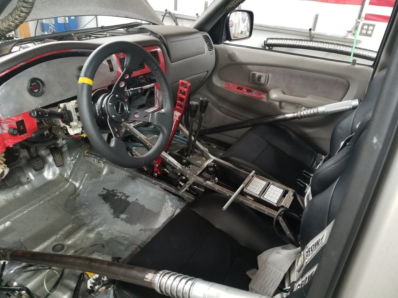

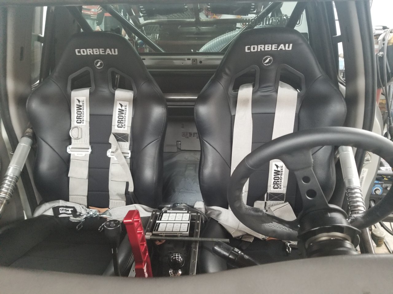

    572
    ivan
    memphis
    2002 tacoma LSA swap prerunner
    built supercharged LS, T56, Linked, caged.

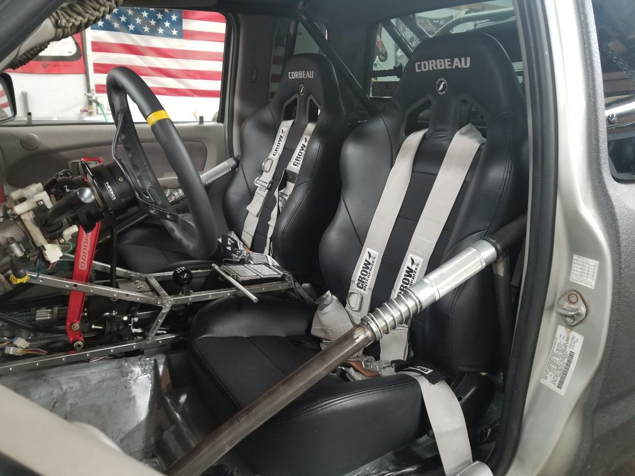

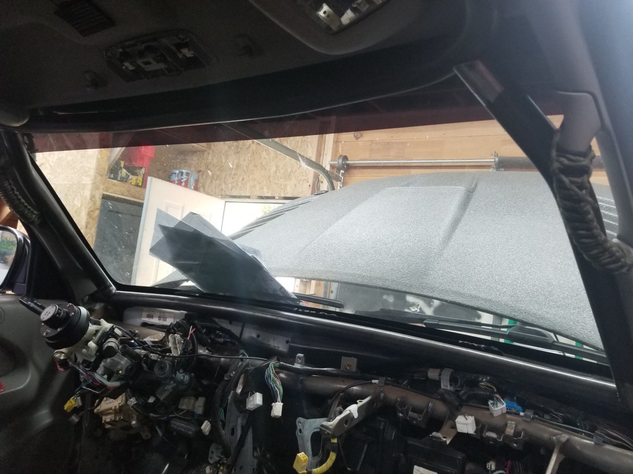

    Alright so a little update since i forgot about this thread lol

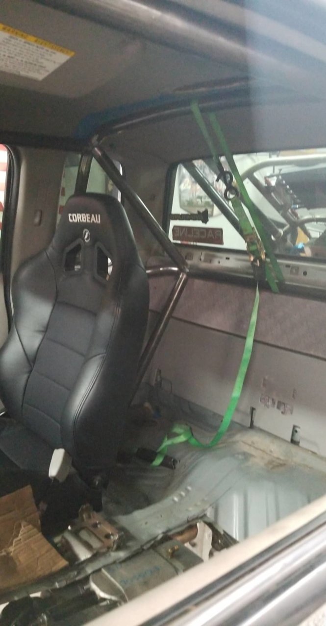

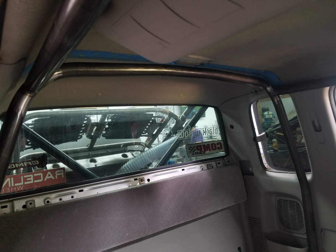

    Cage is done and welded in. The Driver seat lowered almost 2 inches from building a crazy mount, the atlas mount is all done, the floor is all welded back together and sealed. Have to mount the seat belts, install carpet, mount my handbrake, finish front driveshafts, and a few other small things. I have a 9" rear diff being built right now. Once i get it back ill build my rear end.
