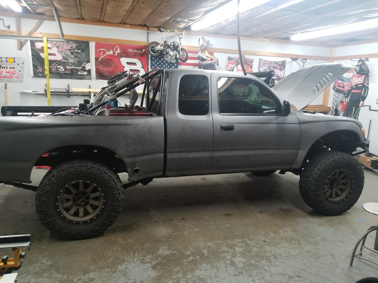

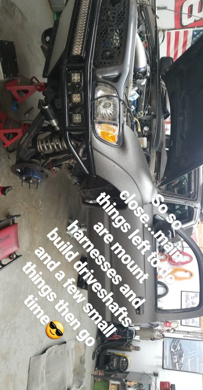

    Handbrake mounted and brake lines ran, wiring all cleaned up, re ran the fuel lines and cleaned up everything under the truck, fired it up with no issues after sitting for months, and finished up a few small details. Biggest things left to do are mount my harnesses, build the driveshafts, and get some fittings and bolts and put the windshield back in. So so close:D

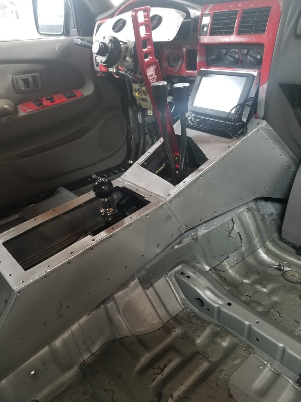

    Brake bled, console mounted, handbrake mounted, harnesses done, main thing left is front drive shafts and the rear "temporary shaft for until i finish the 9"

    So, updating this since i havent posted in awhile. Truck is "done" for now. Cage is complete, 6 speed is in and it runs great and drives so much better than with a th400. Im rolling with the stock rear end for now until i get my 9" center section built and get my housing built up. When that happens i will be giving the rear suspension a "refresh". Ditched the 4x4 because i know im just going to grenade the front diff and i dont want the headache so its leaving. Because of that i will be upgrading some of the front end components that i have been wanting to do.:Dalso i can throw as much power as i want to at it with out worry of breaking the front end:yay: but for now its mostly done for a bit. So now i have a built th400 for sale and a 2 speed atlas for sale if anyone is interested

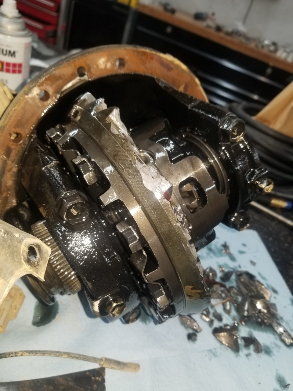

    he converted to 2wd and just blew up the stock rear end

    thank you sir! yes I left the stock rear end just temporarily while I was starting to build my new rear end. it lasted all of 2 weeks which was expected.:rofl: and I also ditched the 4x4 as I knew it would just be a headache in the future. I don't use it enough to be worried about it and now I don't have to worried about it in the future when it gets even more power.
