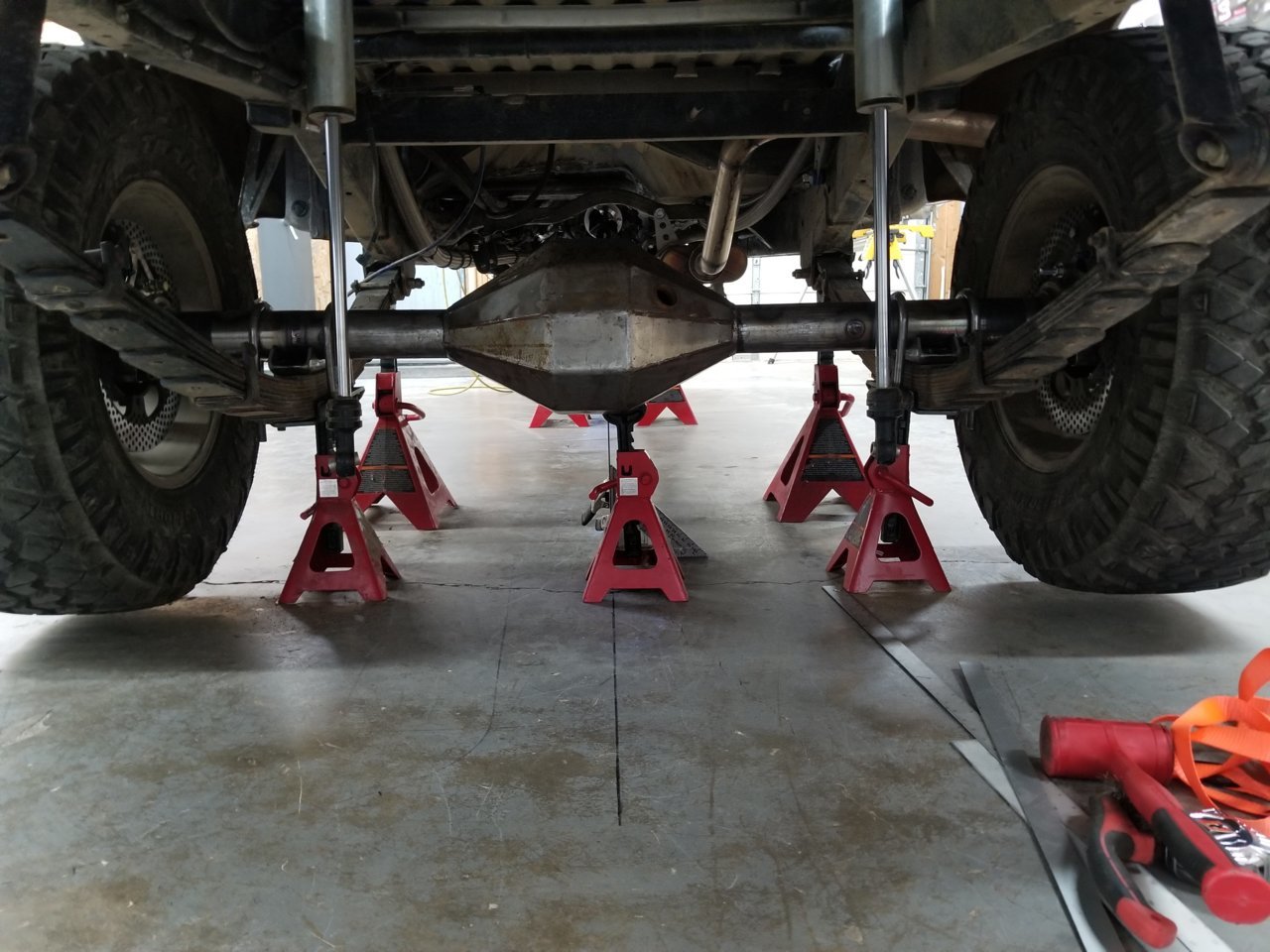

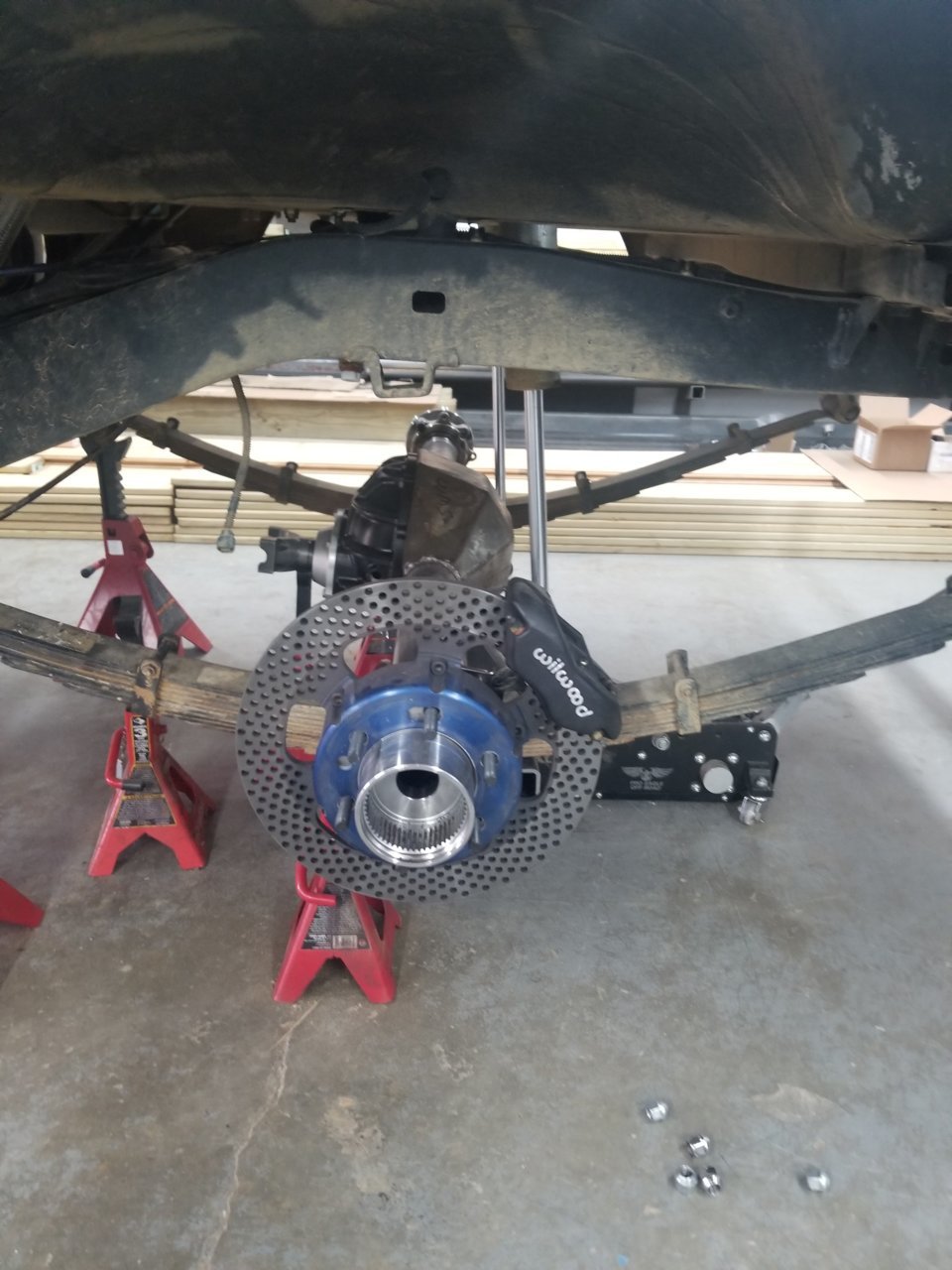

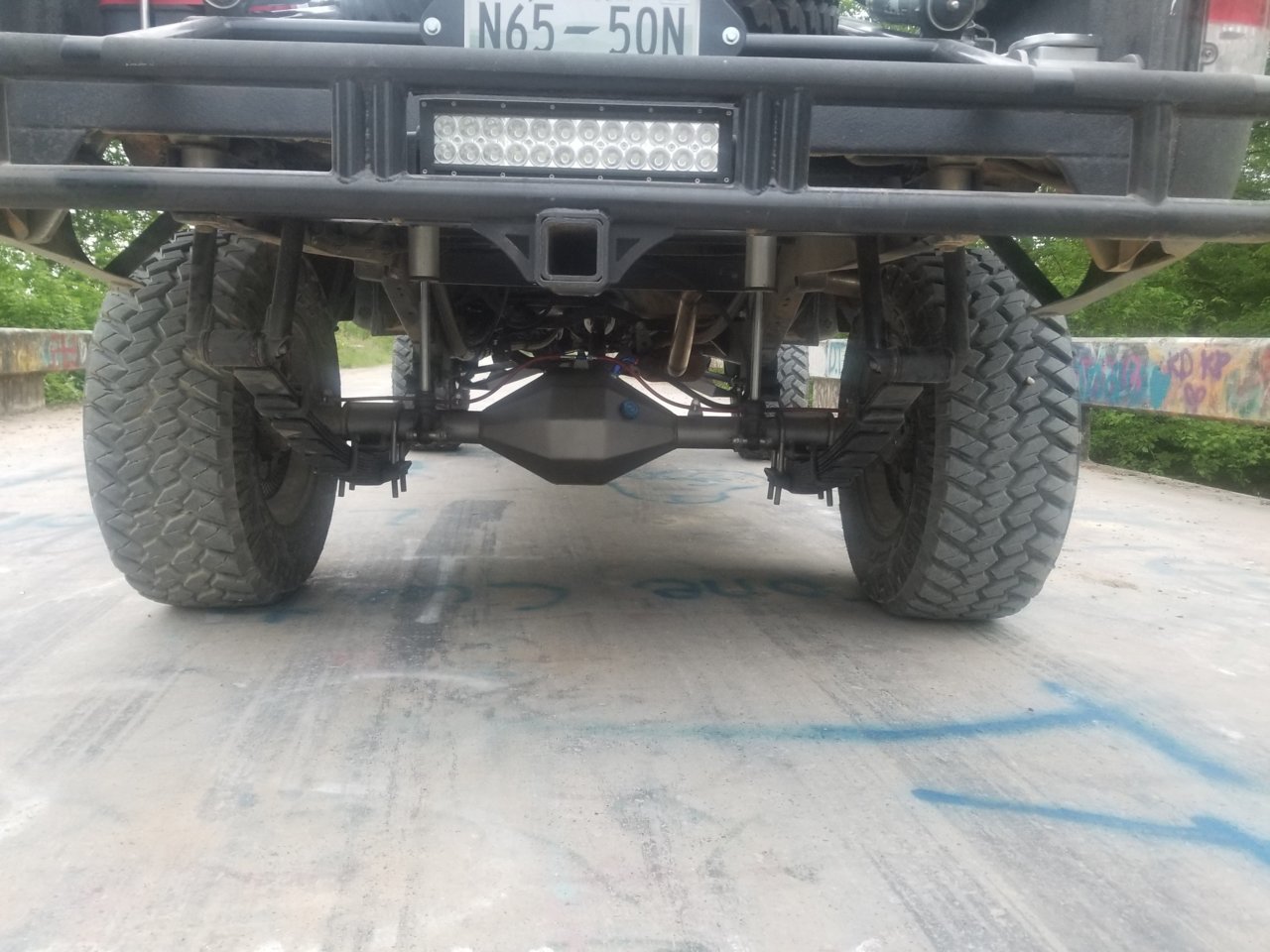

    Figured id give a small update, rear 9" is about done, waiting on 1 axle shaft and need to order 1 shorter brake line, and need to weld on shock tabs. Biggest hold up is im going on 2 months waiting on my spindles from solo motorsports

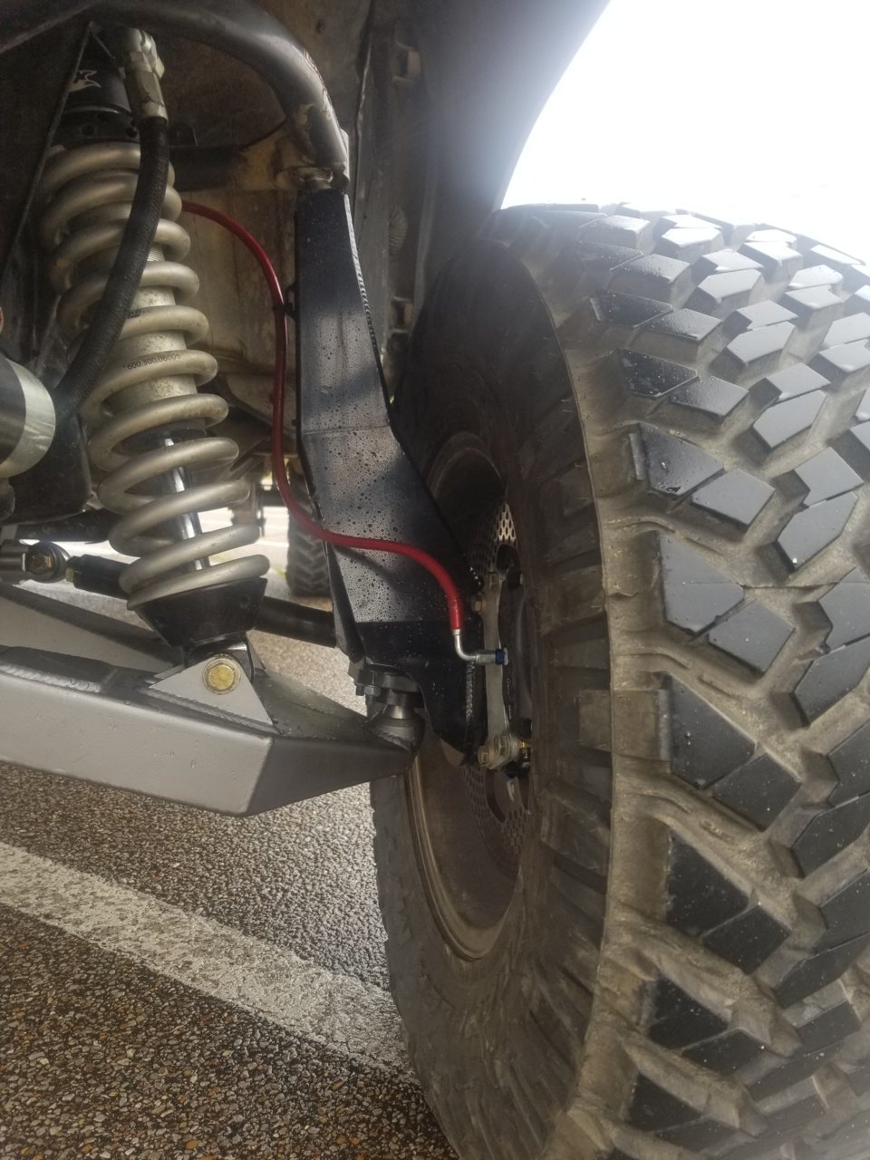

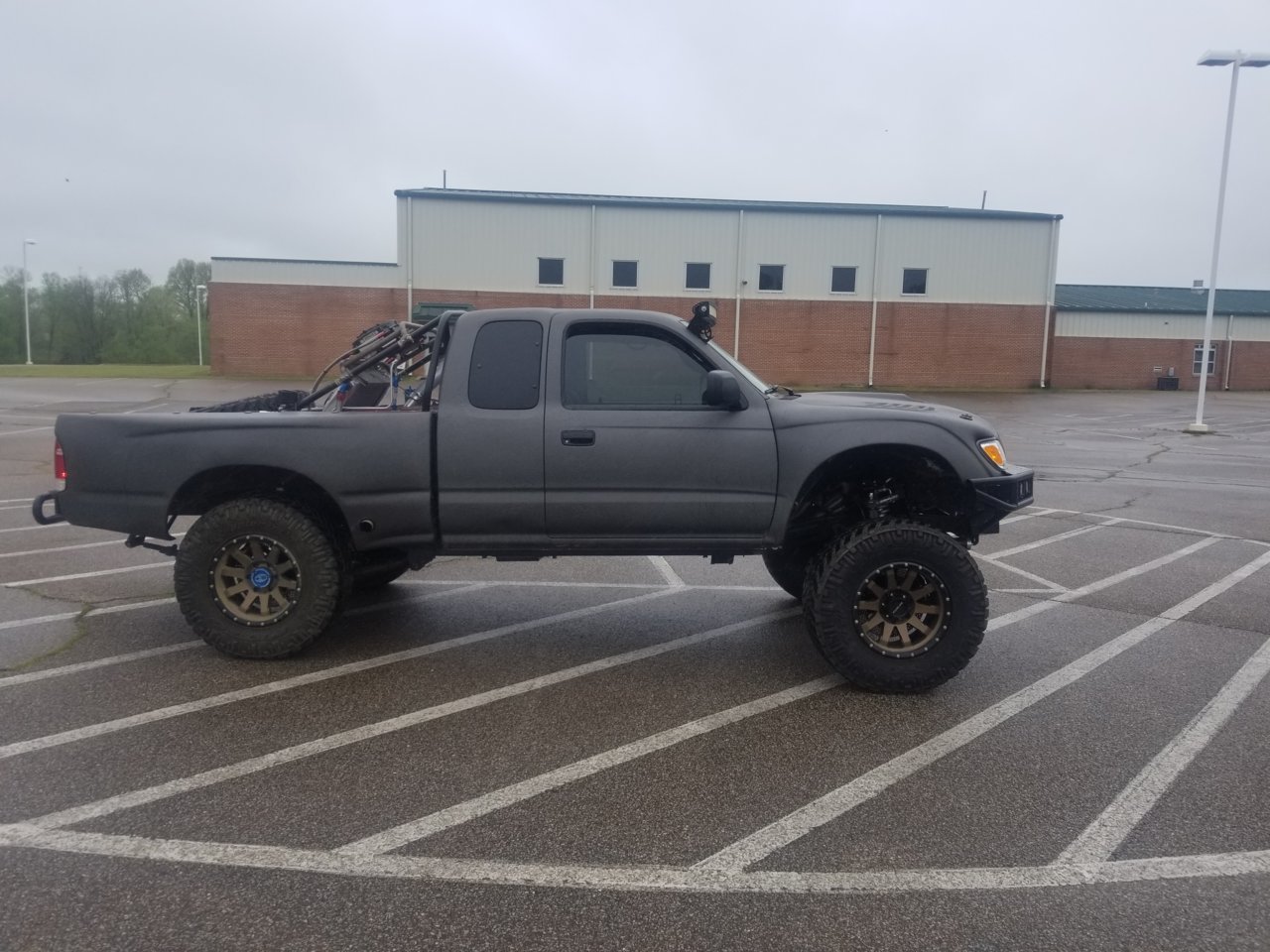

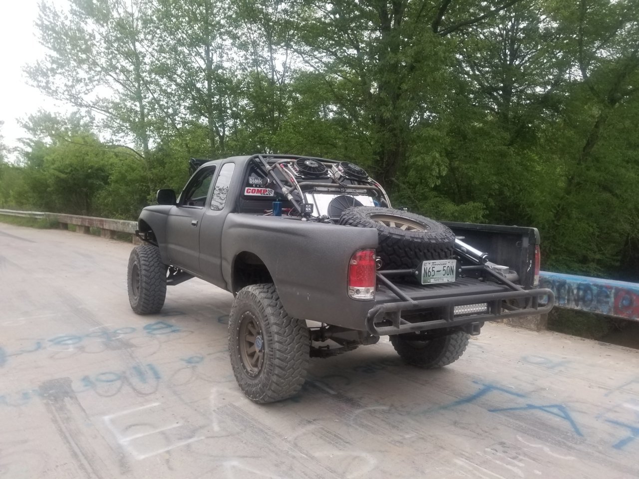

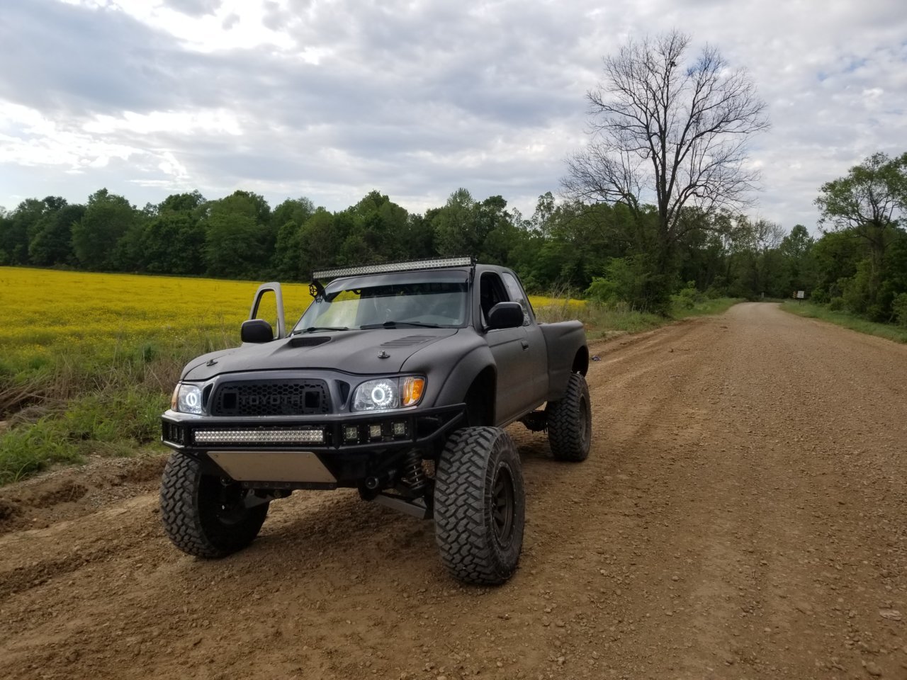

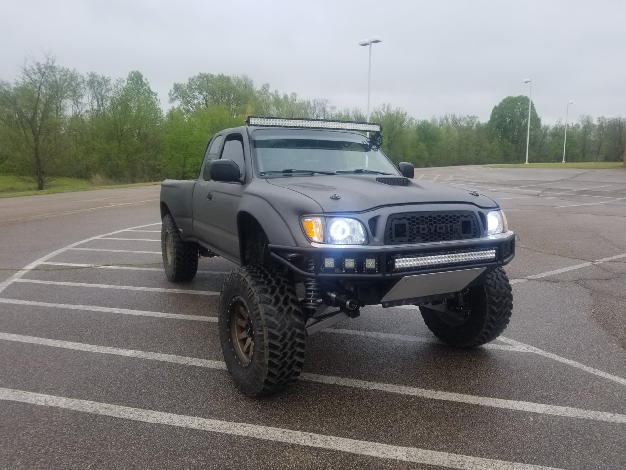

    Finally got the truck back running with the new spindles and 9 inch Ford rear end. Already got a new deaver leaf setup on the way and bypasses in the works finally. Truck does much better with a 4.88 over 4.10. Super happy with everything 20190414_114009.jpg20190414_114018.jpg 20190414_114047.jpg

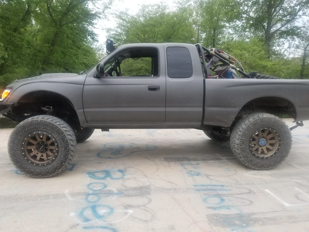

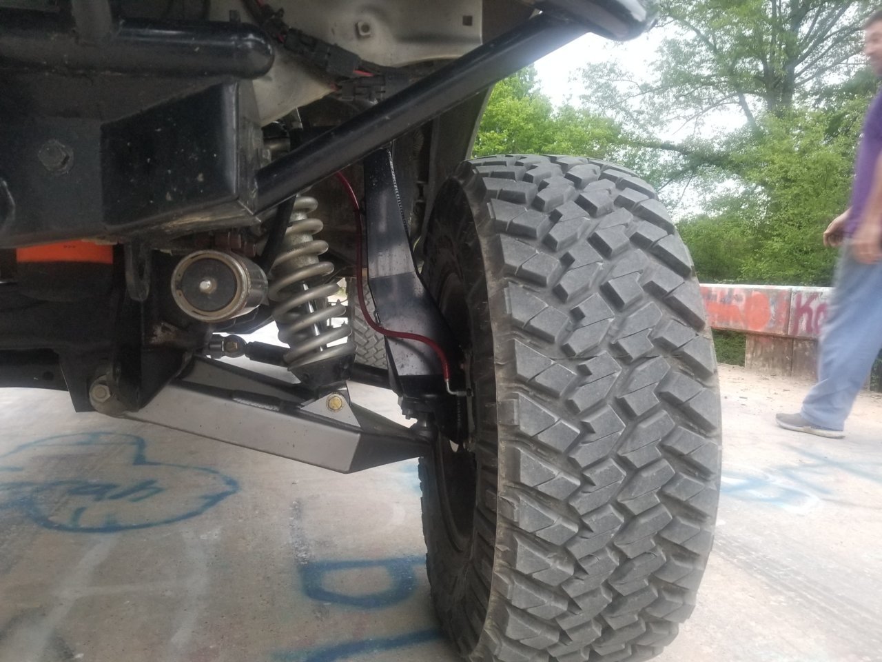

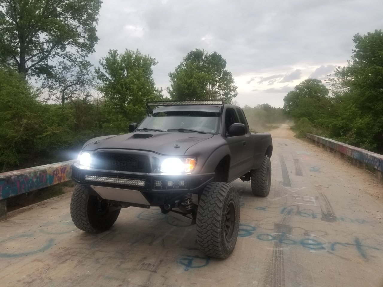

    no more ridiculous squat thanks to the new dealer h70 leafs:D:D calling accutune offroad about some bypasses next week:thumbsup:
    20190424_190109.jpg 20190424_190057.jpg 20190424_190145.jpg 20190424_190154.jpg 20190424_190134.jpg

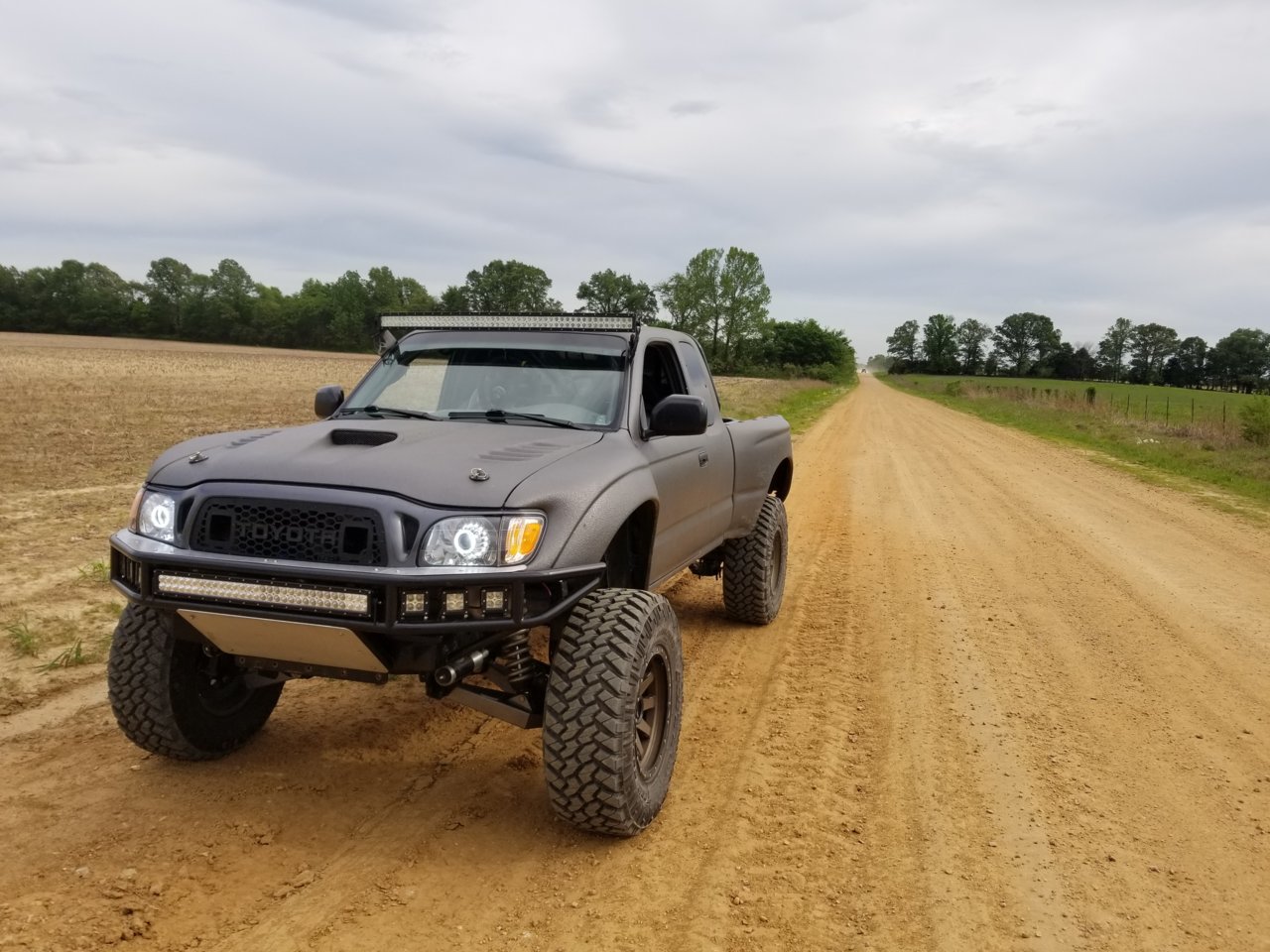

    the truck is pretty much where I want it to be for the time being. theres a few small things left that I want to do, get the AC back working, and a new much stronger driveshaft. I think a blower is in the works down the road as well:D Never enough power. thinking about going with a LSA blower setup, should make around 600-650 rwhp.

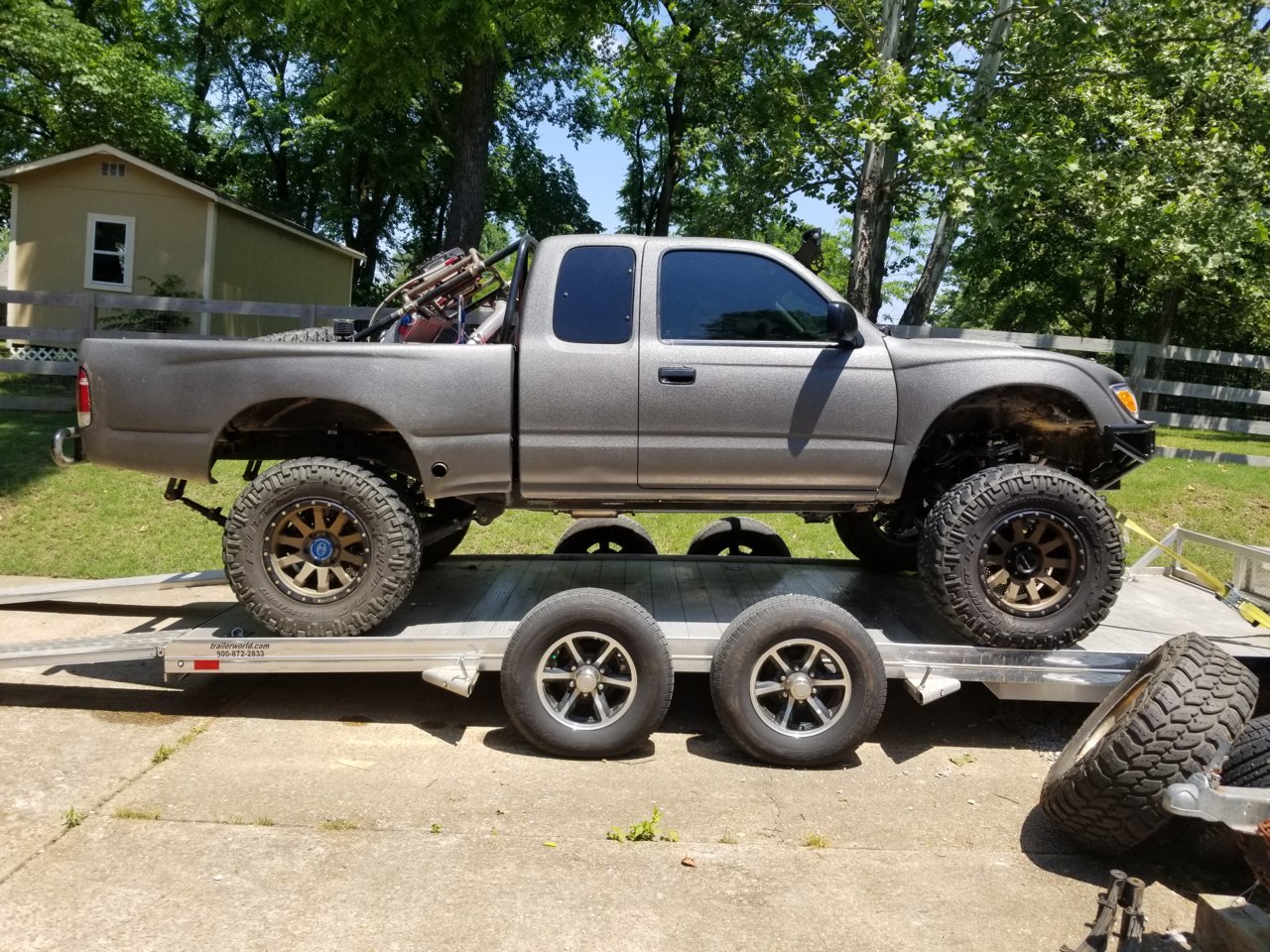

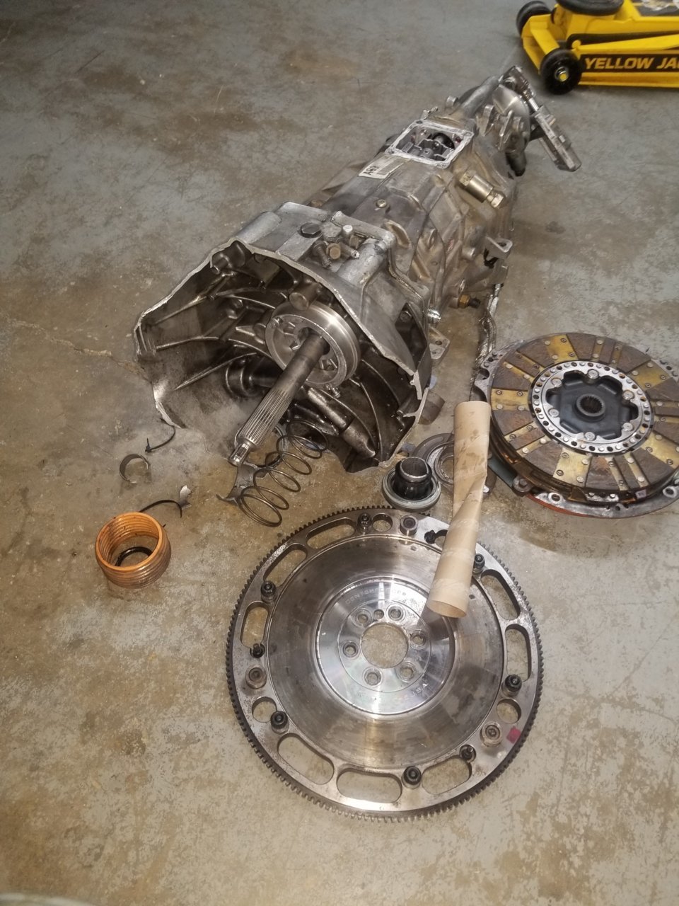

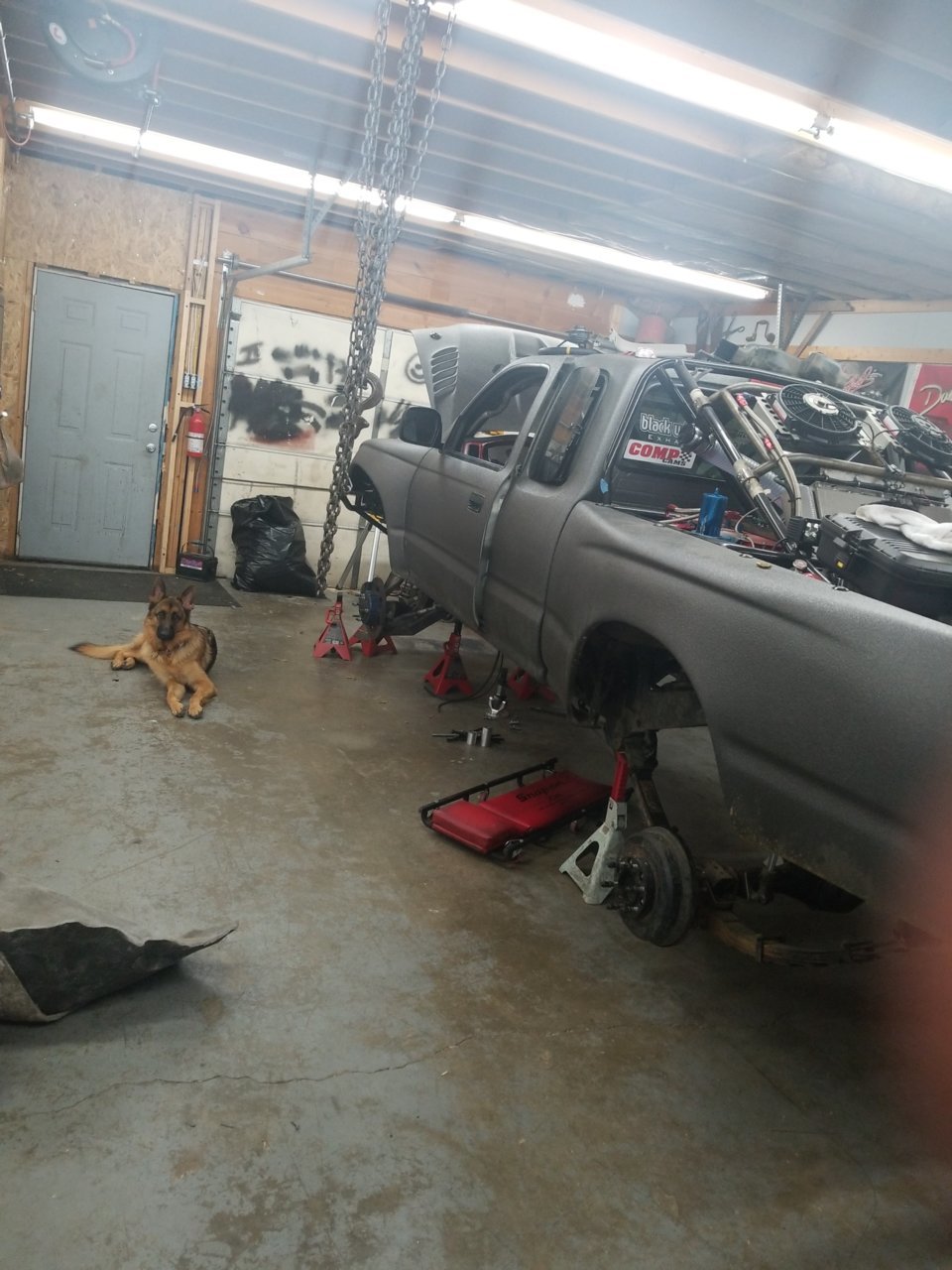

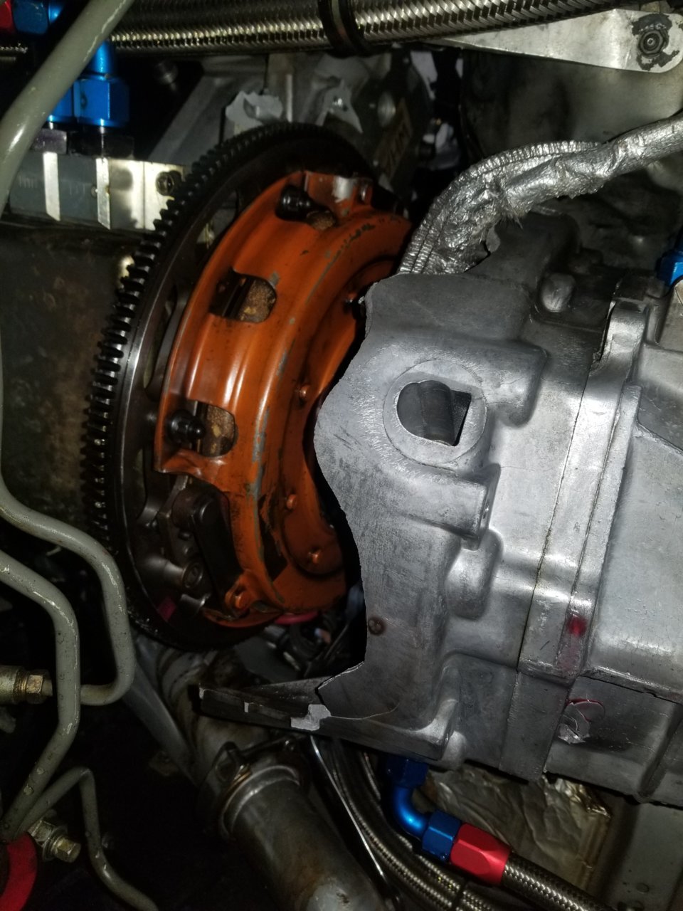

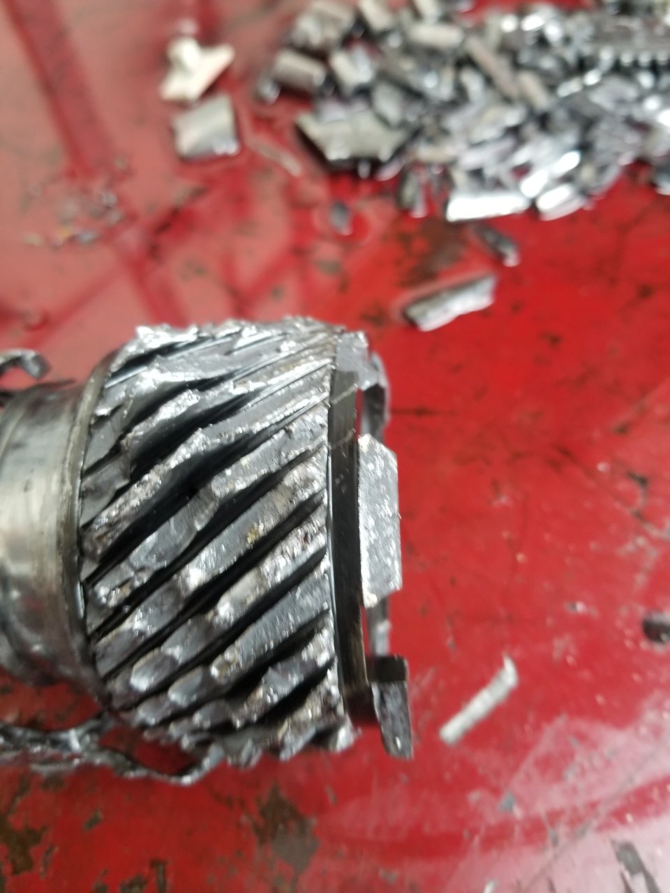

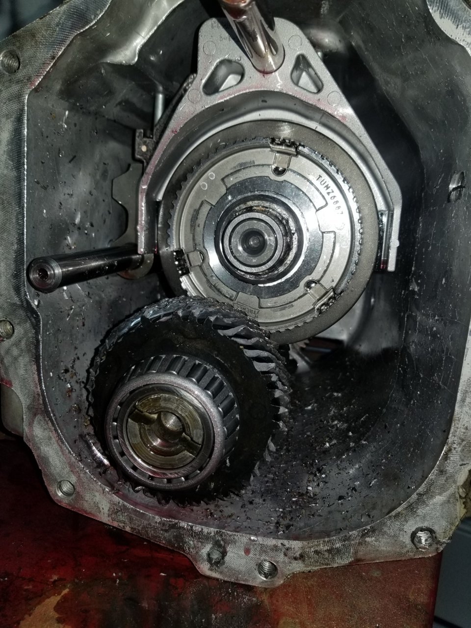

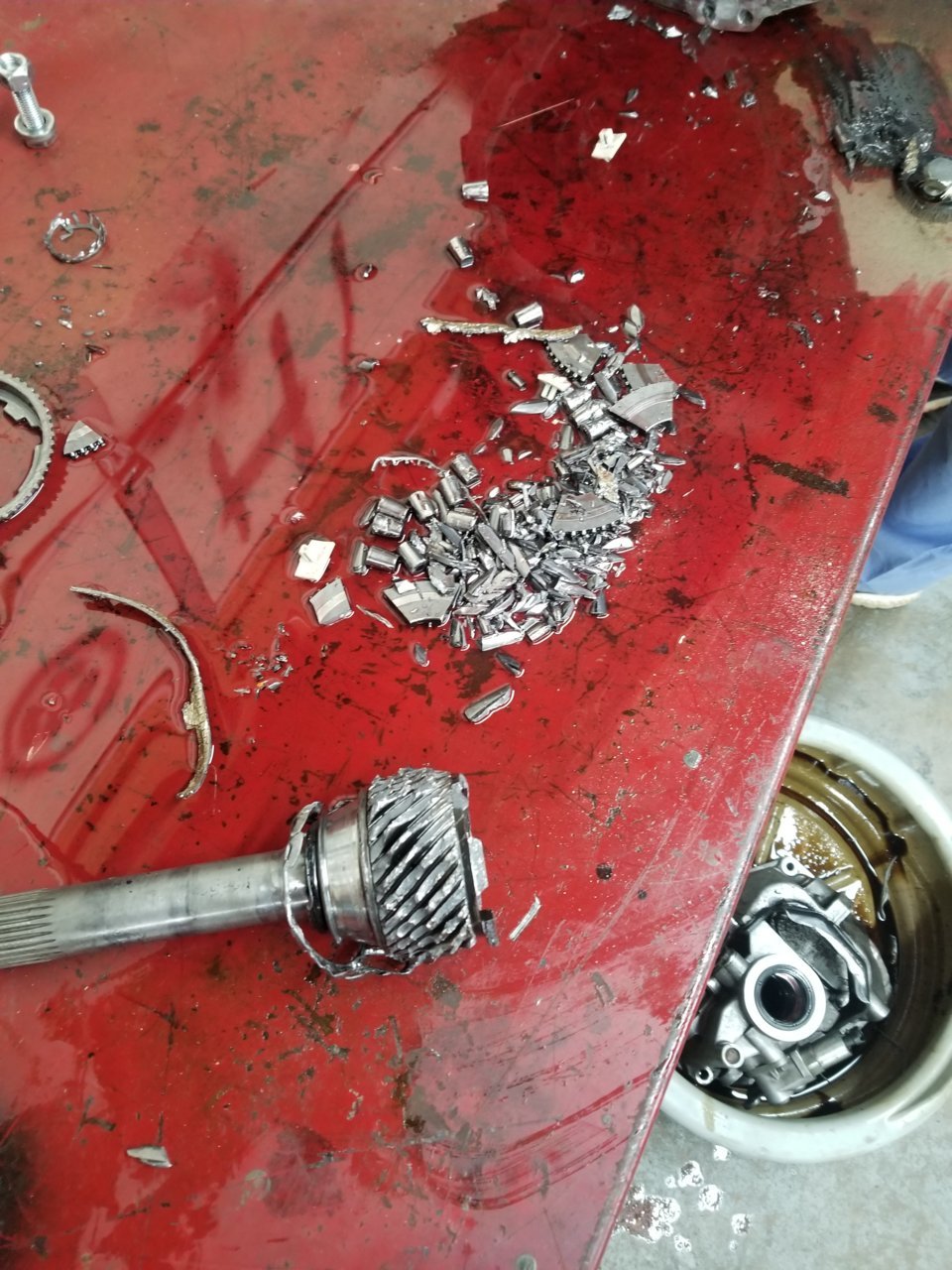

    well this is the last thing I would have wanted to post here but the tacoma had a massive failure. The trans failed and locked up on me driving down the road and attempted to rip it self out of the truck. it shattered the bell housing, destroyed everything internal of the trans, and destroyed the engine block. it ripped the starter off the block and took several other chunks with it.. I took the trans apart to try to see if I could find the fail point, I think it was a combination of the input shaft failing, and the output shaft being bent and causing a vibration that over time destroyed the innards of the trans. I had a 2.5 inch driveshaft built for it and it withstood everything but still had a bad vibration, tom woods built a custom 4 inch shaft that I installed that morning. I made it 1 mile with the new driveshaft. I think the new bigger and stronger shaft didn't take the vibration as well as the old one which put all the force on the trans which caused the explosion. time for a massive rebuild with way more power!
    20190517_144400.jpg 20190517_144223.jpg 20190516_151817.jpg 20190517_144234.jpg 20190518_135504.jpg 20190518_135515.jpg

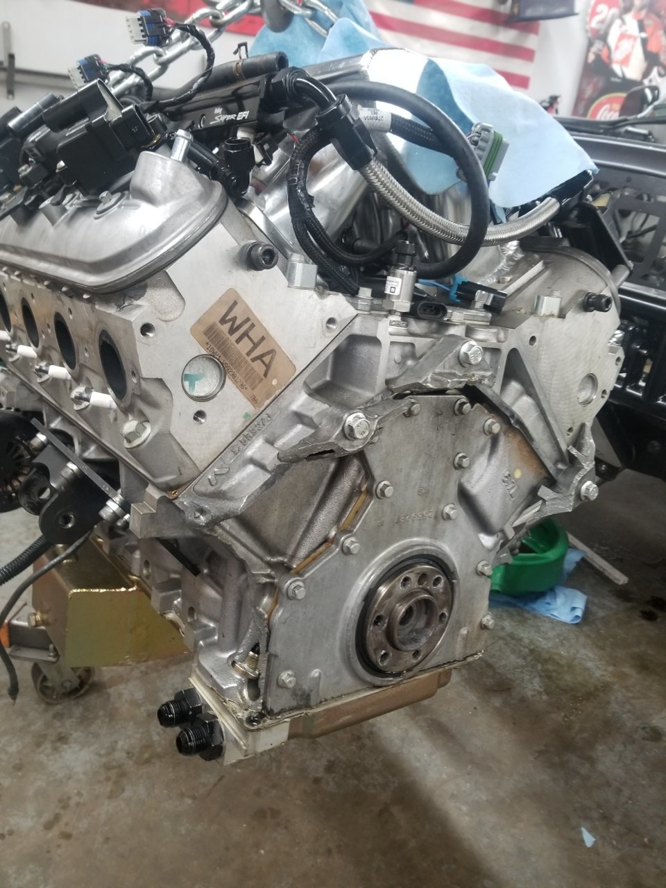

    just a little update, new motor is in the process of being built. going to be a few weeks. :Din the meantime the new trans should be arriving soon and everything should go together fairly quick!:burnrubber: nothing stock about this new engine. its going to be a whole different animal

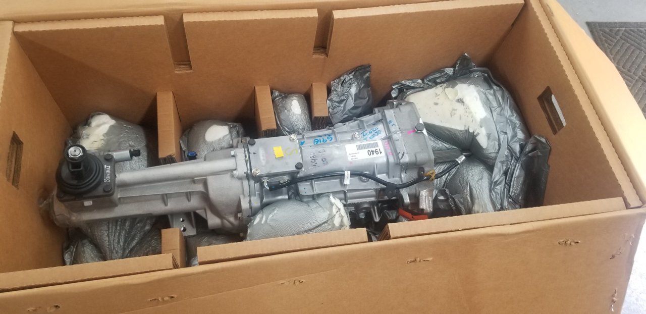

    built supercharged LS, T56, Linked, caged.

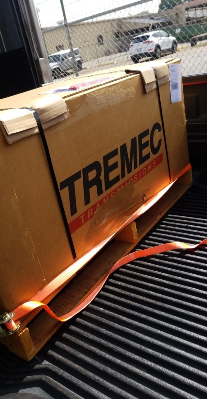

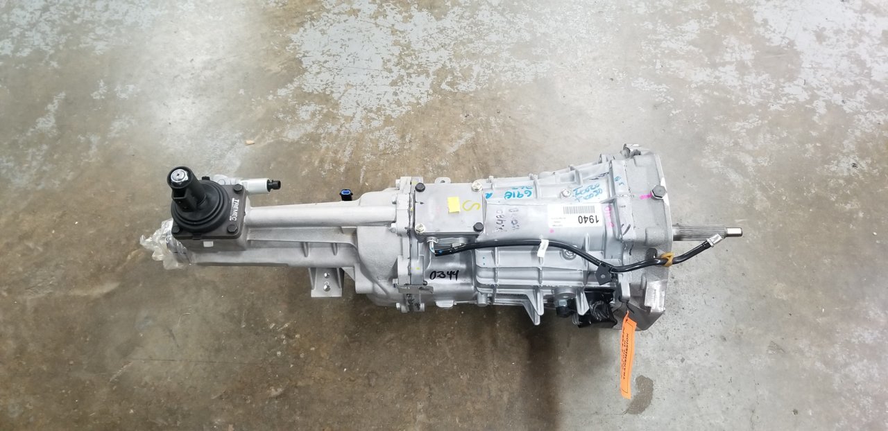

    new trans has arrived, now just waiting on the engine. going to be one crazy combination Snapchat-293428813.jpg20190611_123120.jpg20190611_130625.jpg
