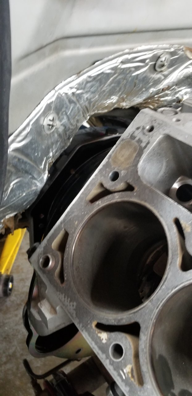

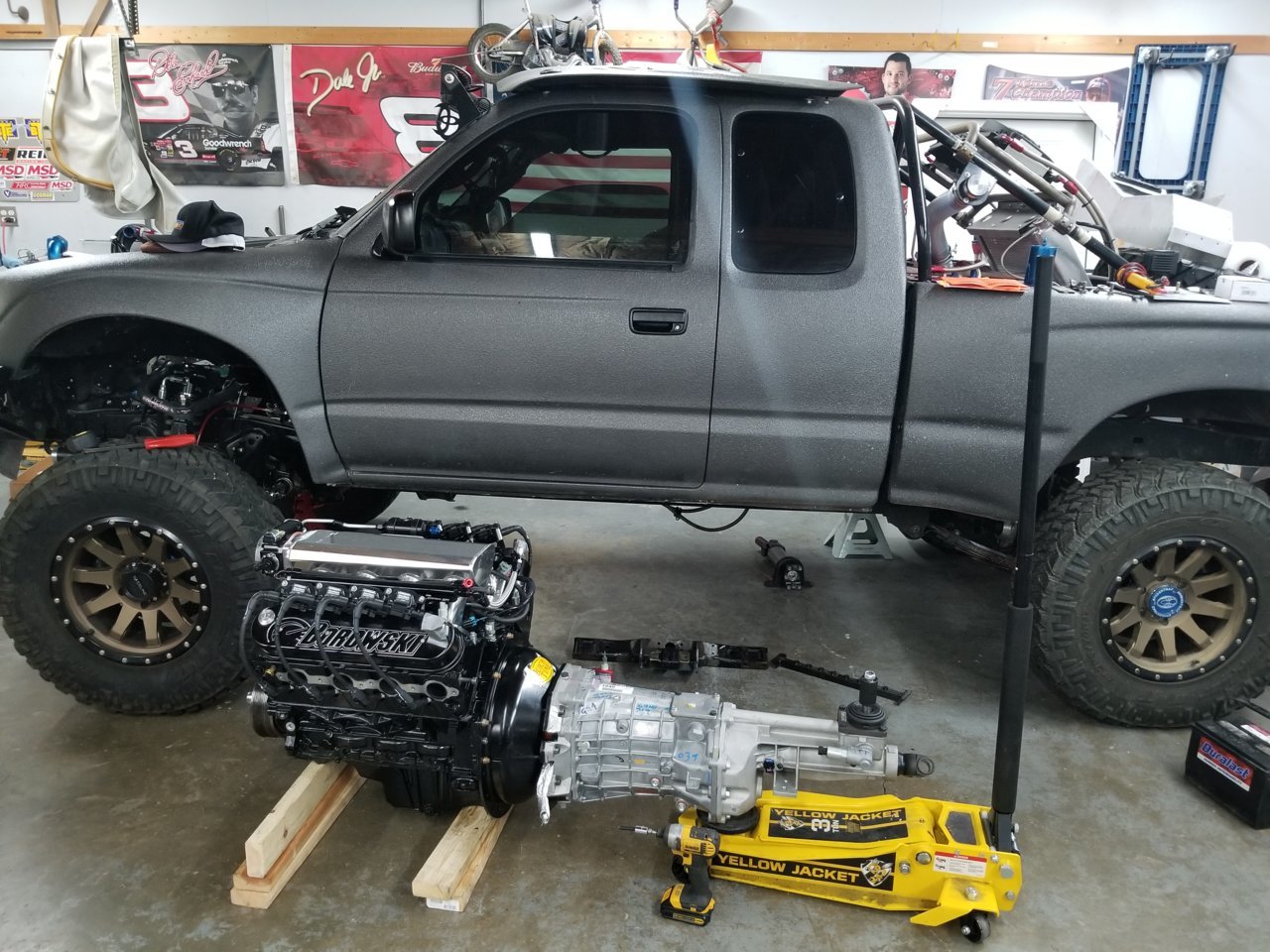

    Put the new trans in the truck with a dummy block to check everything. fits really well with tons of space. need to modify my crossmember a little bit for the trans mount but thats about it.

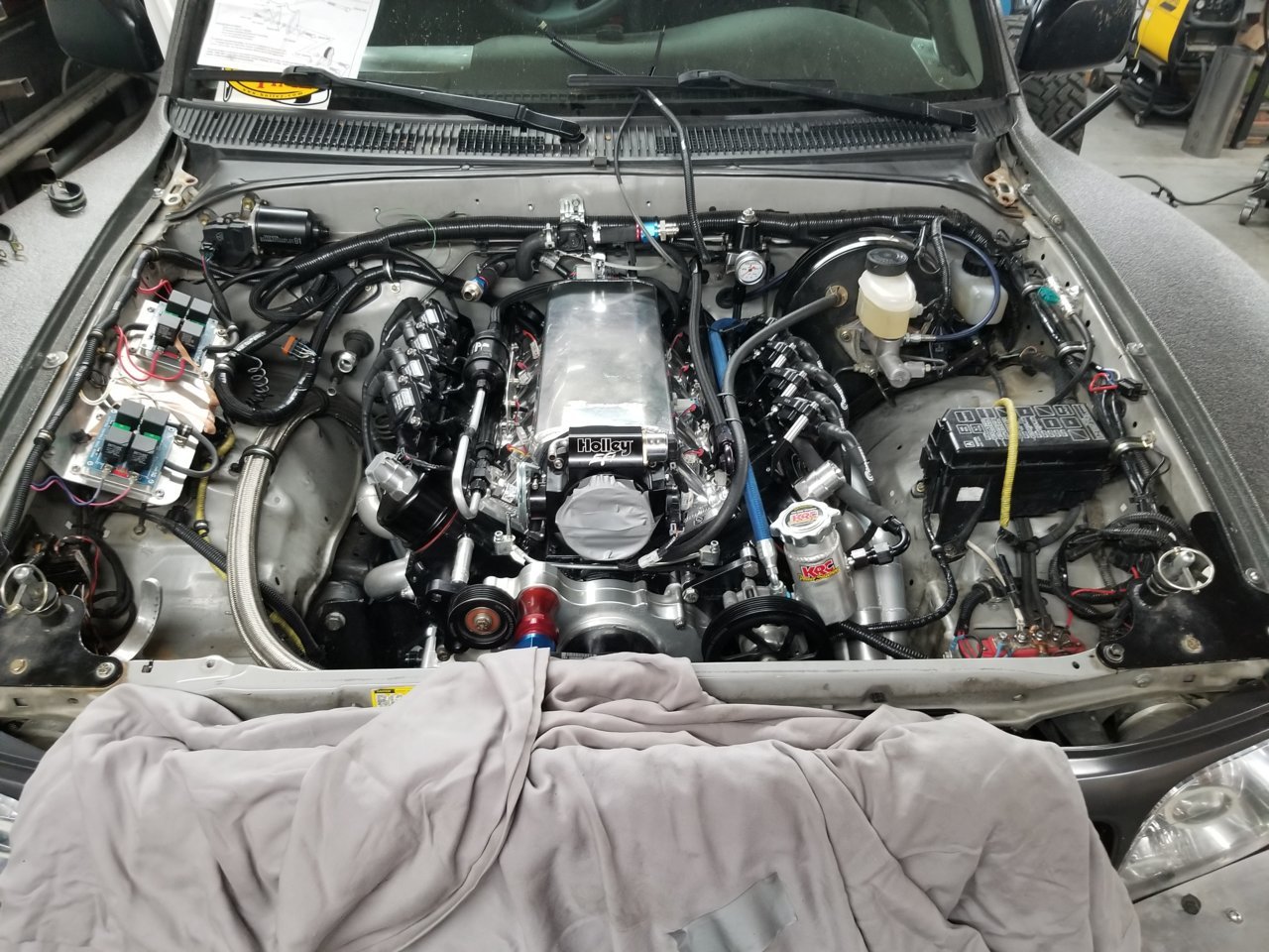

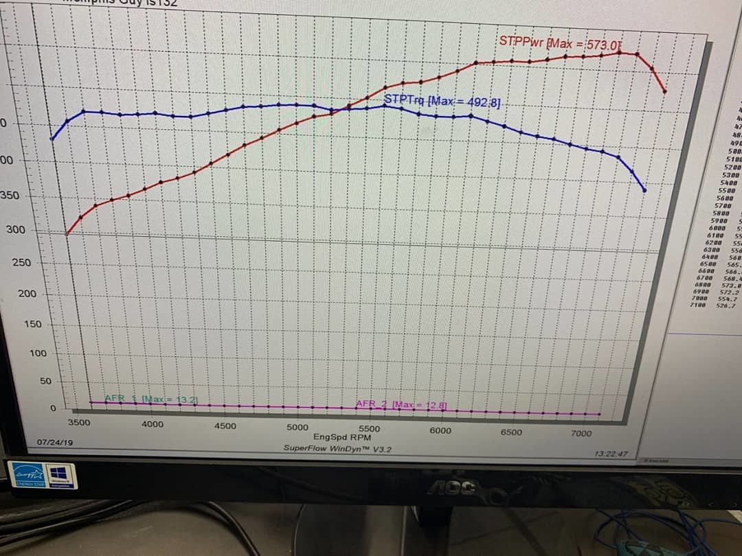

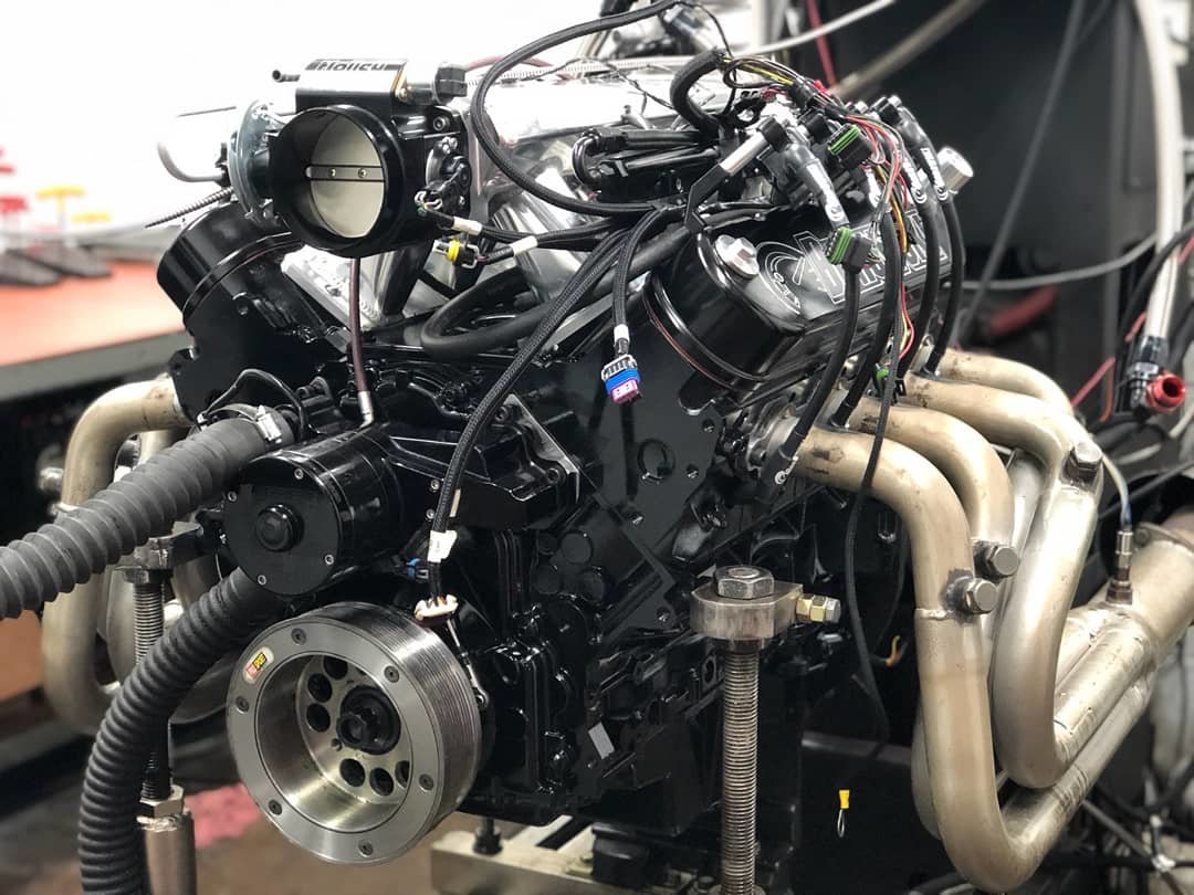

    Truck should be back together very soon! Trans is now in the truck and my engine builder just finished up the new motor. Ended up going with a more conservative engine setup than i originally planned for but this setup will be plenty to have fun with. Almost 600 hp and 500 ft lb of torque!IMG_20190724_205748_309.jpg IMG_20190724_205748_310.jpg

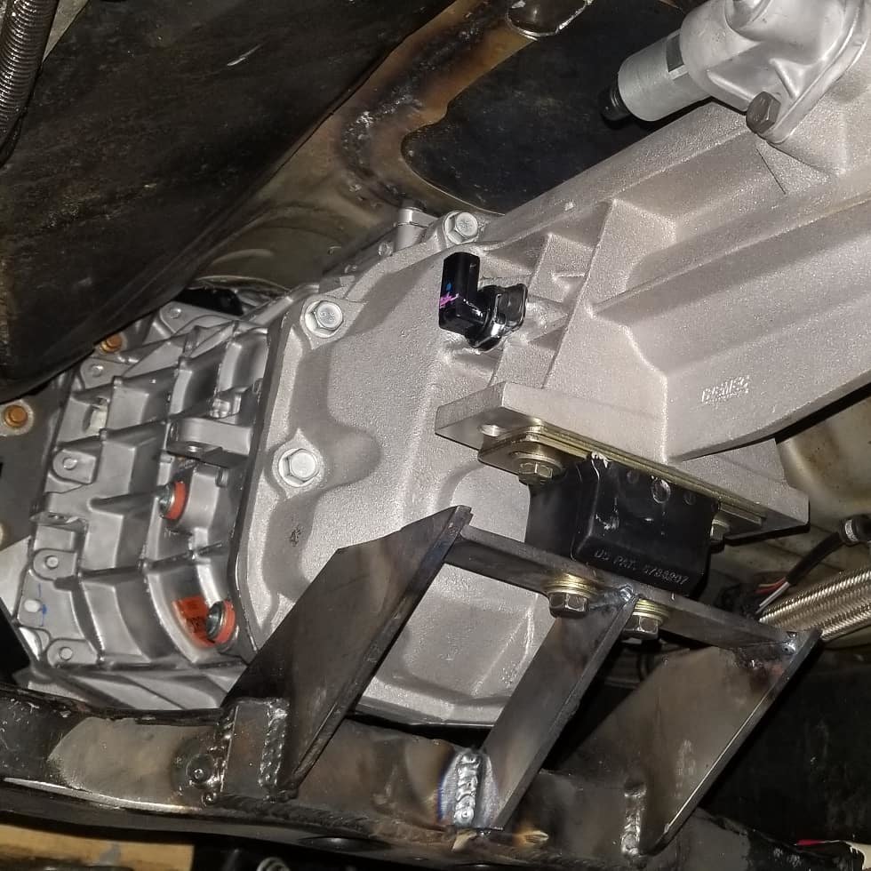

    Looks like they stacked tacks rather than doing a proper weld.

    If not tacks then it’s porosity. Both are trash lol

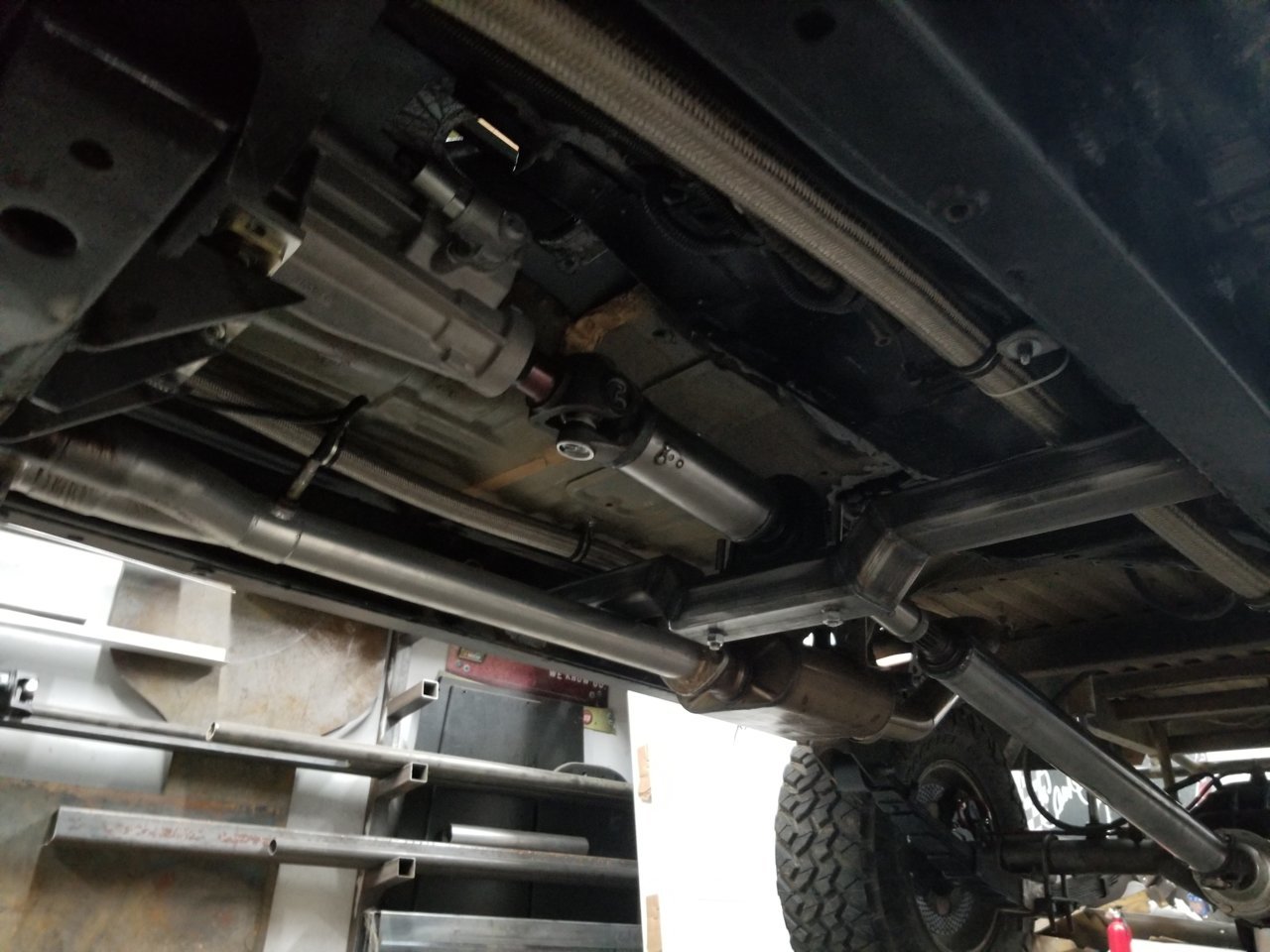

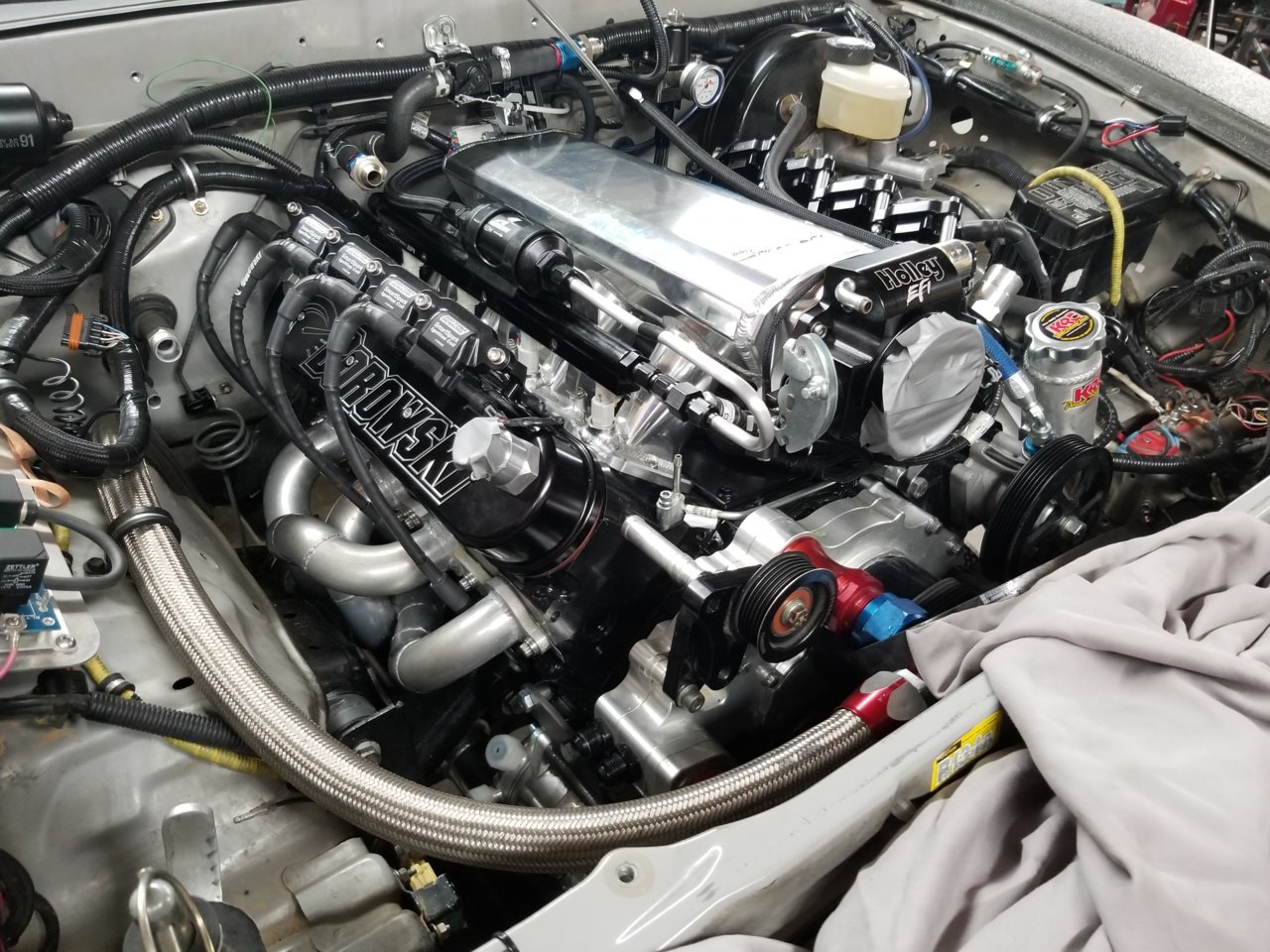

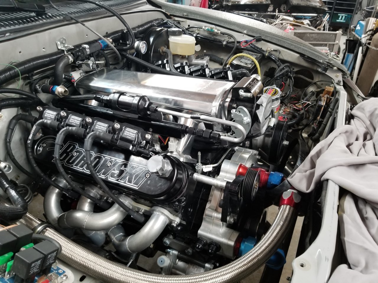

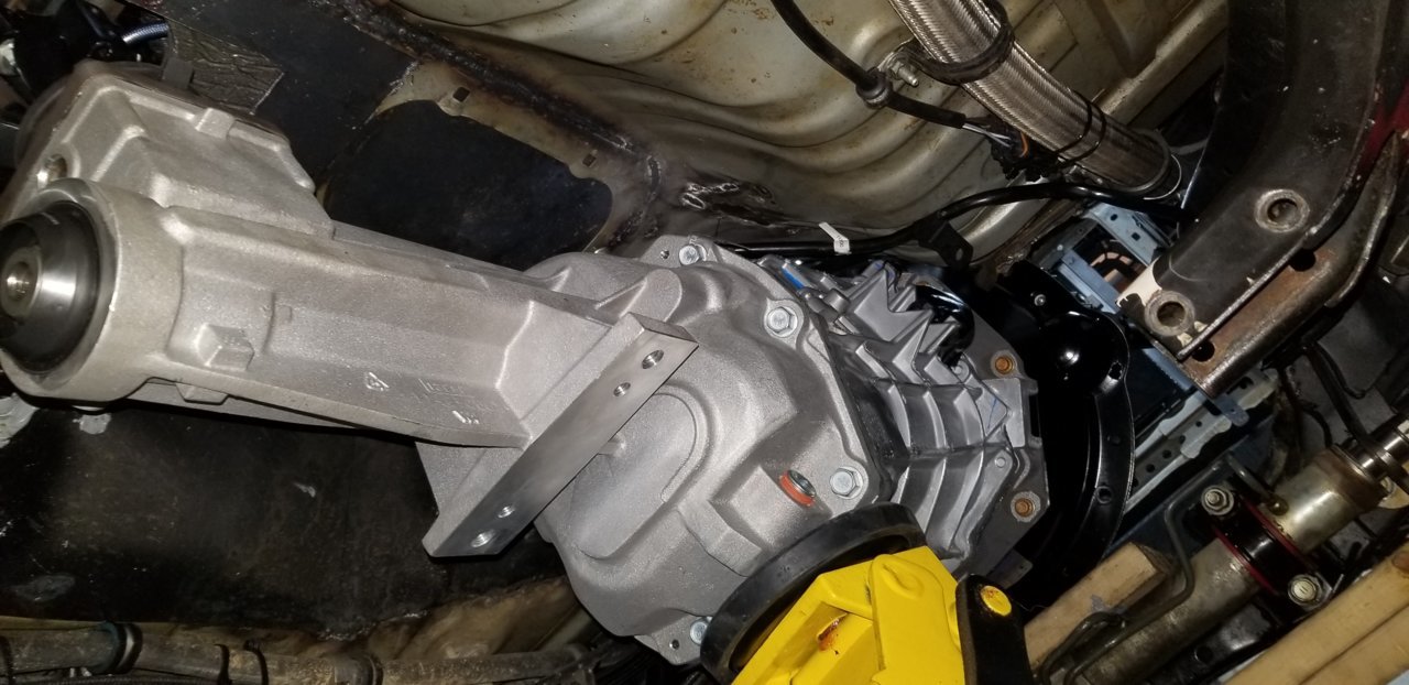

    New engine and trans are finally in the truck! built a new crossmember for the 2 piece shaft. have to install a new throttle cable and dipstick and should be road worthy.
