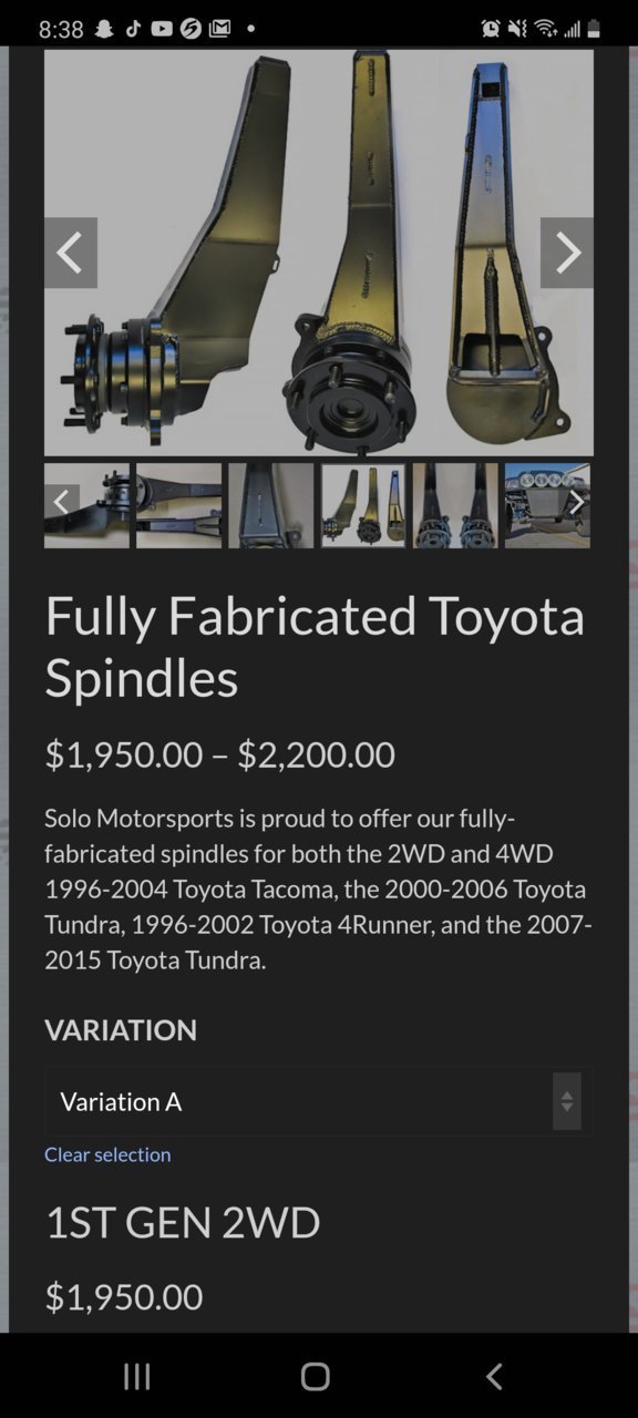

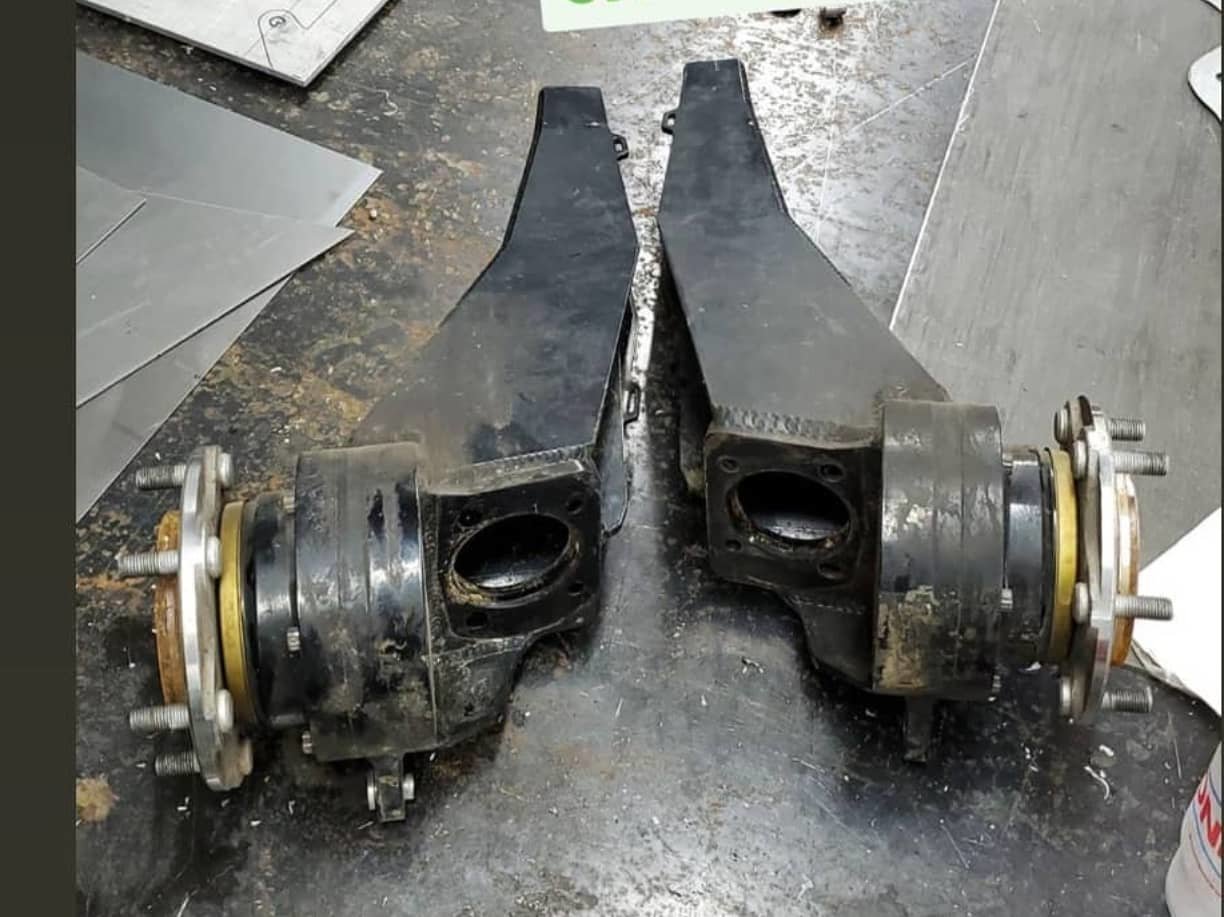

    also my solo lift spindles are for sale. asking 1600. 2k new. 3" lift for 2wd 1st gen tundra/tacoma

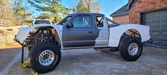

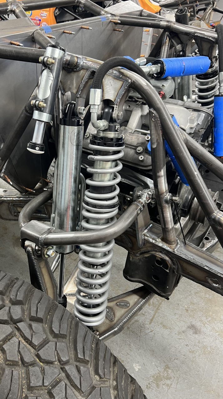

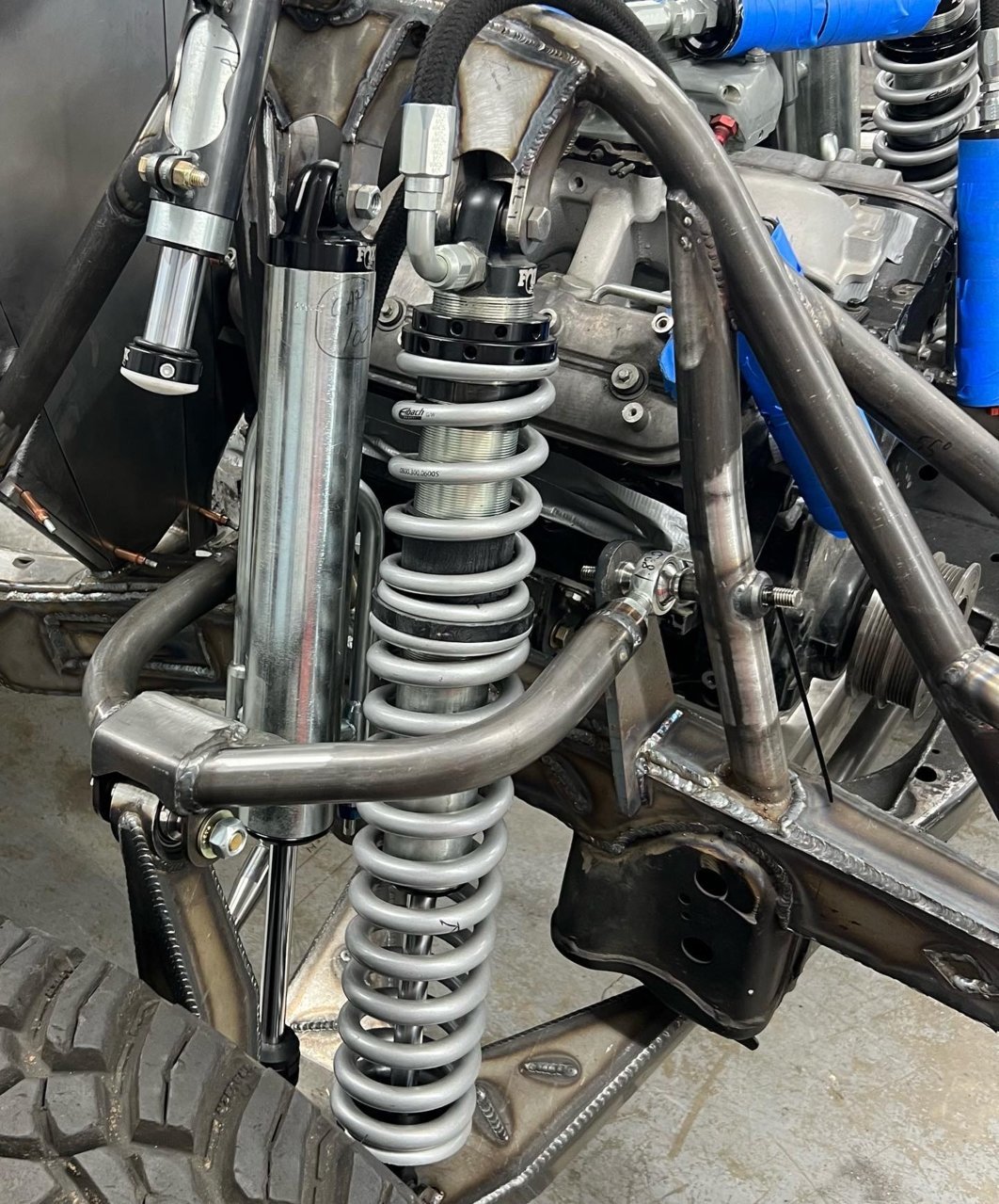

  11. Jul 7, 2022 at 7:40 PM
    #511
    Long_Travel_2002
    Long_Travel_2002 [OP] Well-Known Member
    Feb 22, 2016
    #179105
    572
    ivan
    memphis
    2002 tacoma LSA swap prerunner
    built supercharged LS, T56, Linked, caged.

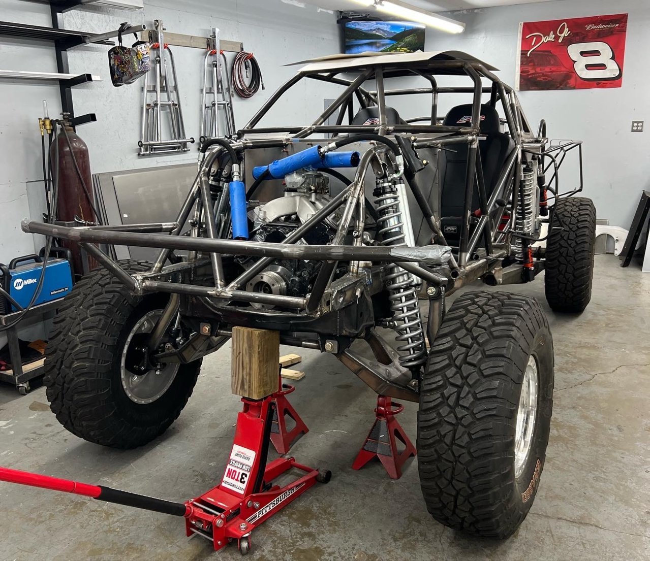

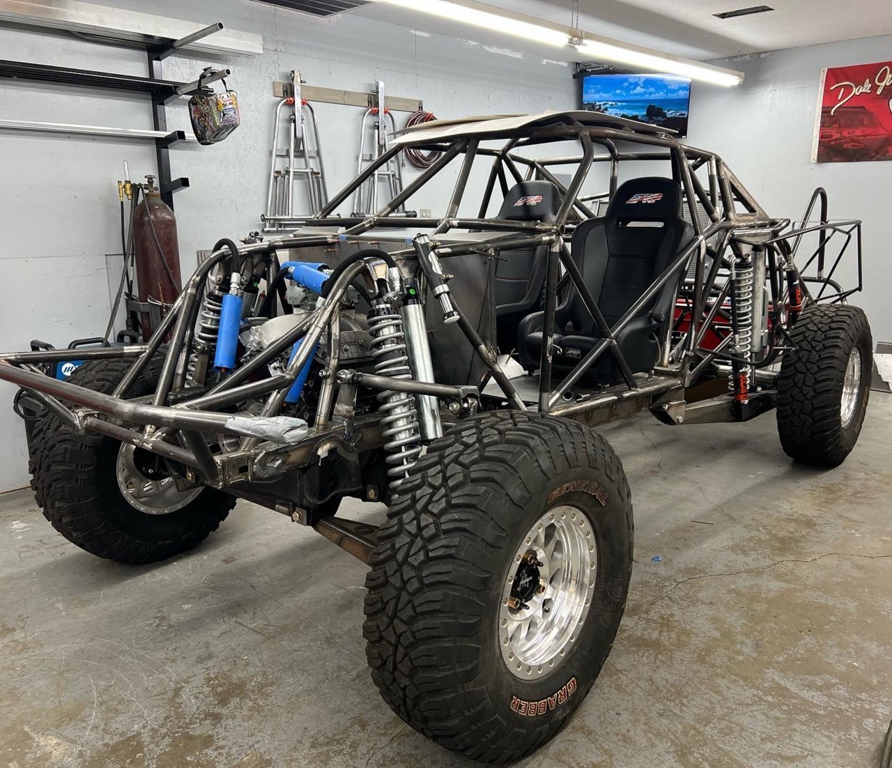

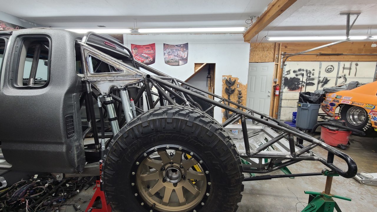

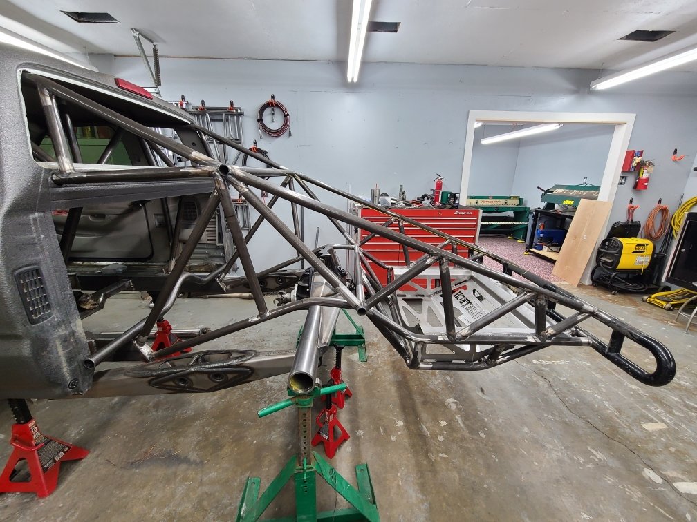

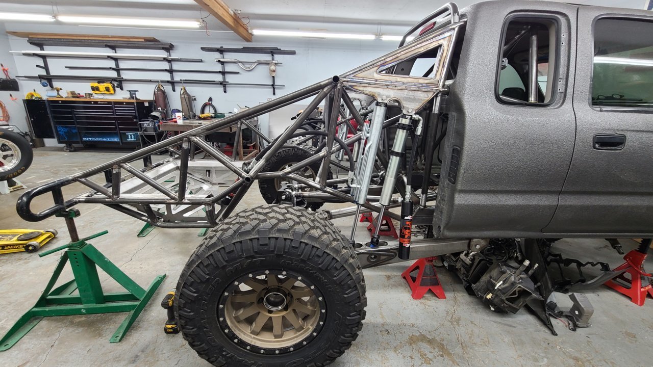

    Latest update, modified the upper arm of the camburg race kit to allow the 3.0 bypass to fit inside the upper arm, just need to finish some gusseting and a bump pad. Also got the bumps mounted. Next up is mounting the bumps in the rear and getting limit straps setup. Redid the rear lower trailing arms and added some triangulation to allow more clearance and flex. Pulls about 24-25 in the rear and around 18 in the front. Also got the fuel cell in and mounted and the spare tires setup.
    E3378575-2635-43FE-9A3A-1B7275C6B644.jpg DFCDAAB5-54AC-471D-84D3-09E0CA51C688.jpg 522B2AE9-7A37-4299-96B3-FF893736D4B9.jpg
    T.Barn, DarthPow, Glueman and 8 others like this.

  14. Jul 8, 2022 at 6:16 PM
    #514
    FlapJack935
    FlapJack935 i member
    Nov 25, 2013
    #117294
    3,196
    Jack
    Abq New Mexico
    Wannabe Trophy Truck
    Sick Gnar Trophy Truck Tacoma and King Ranch Raptor Killer
    both shocks inside the upper arm FTW. tommy is making my one off arms for my front shocks meow. front is cut off ready to redo everything
    Long_Travel_2002[OP] likes this.

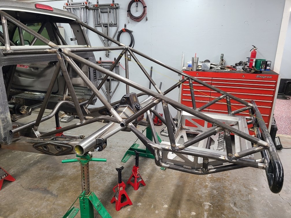

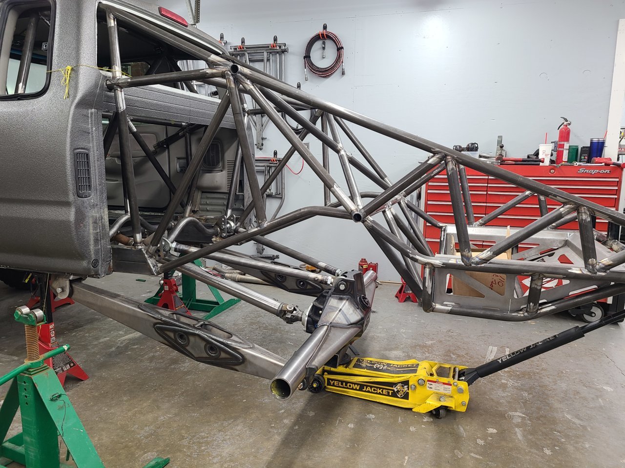

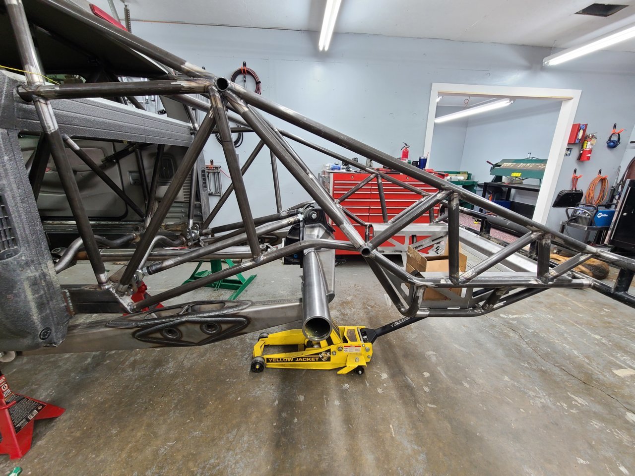

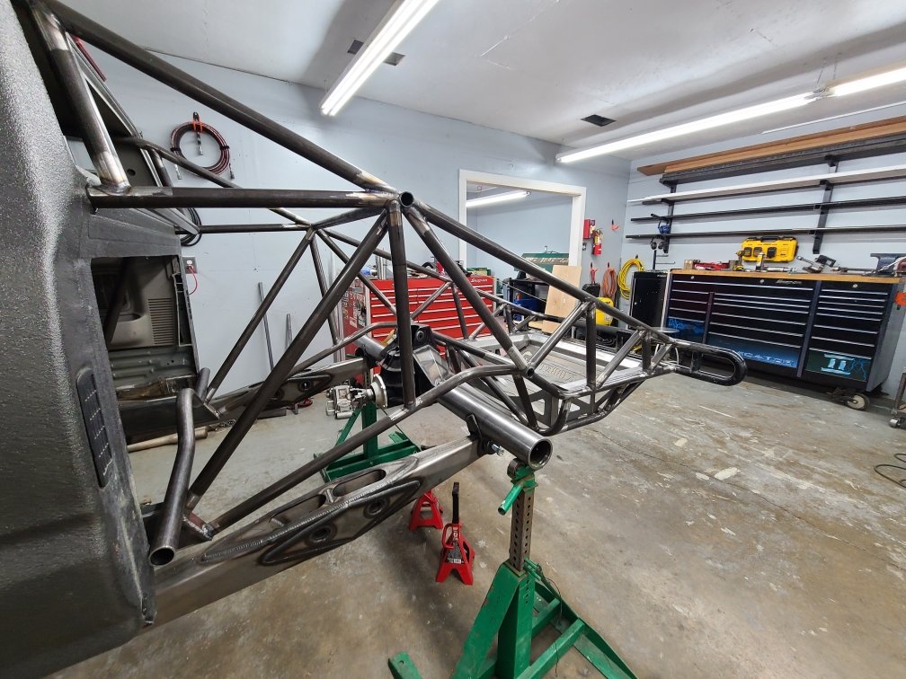

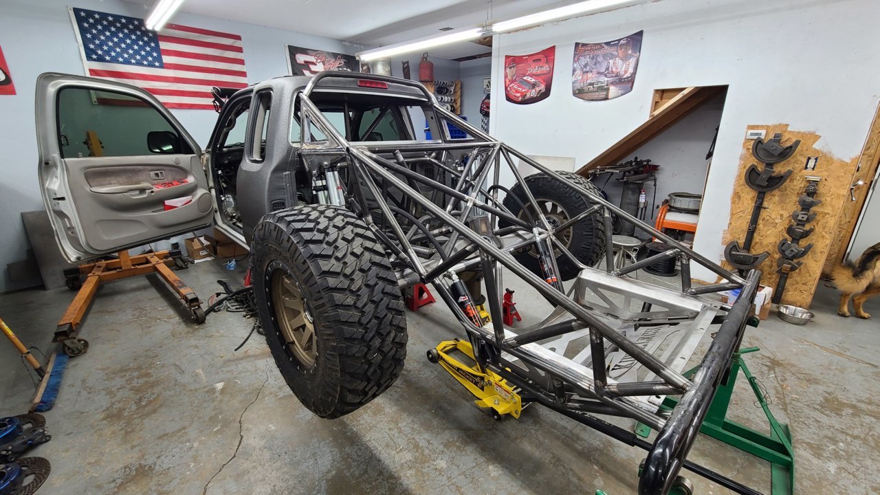

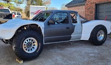

    Doing a full part out on the truck. No longer have time for it and Going a different direction.
    All parts listed are brand new with exception to the engine setup. Will be making a for sale ad but figured I’d post here as well. I don’t get on here often so if interested text me @ 901-626-0869

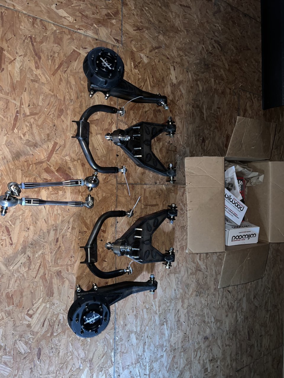

    Camburg race kit for 1st gen Tacoma $6000 obo upper arm has been modified to fit coil and bypass inside arm, mounting points are wider now that stock. Comes with their hubs, brakes etc

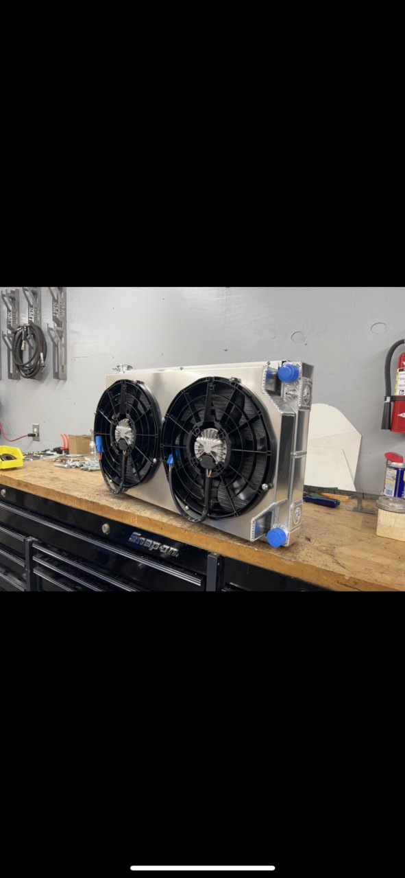

    -FSR radiator 31x19 dual pass, twin brushless fans, -20 AN fittings with tri-cooler setup stacked in from (engine oil, power steering and trans) $2000

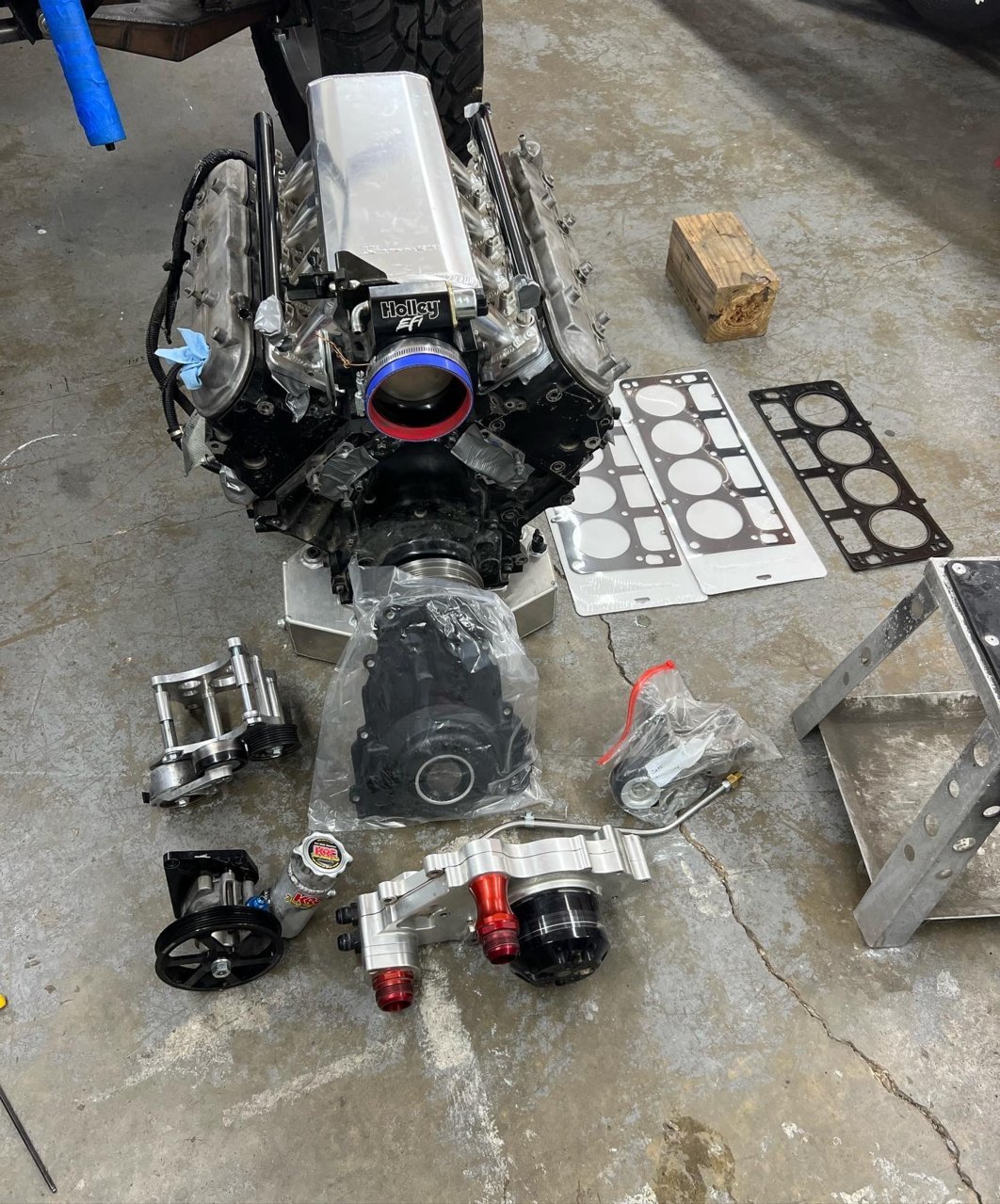

    -5.7 ls1 aluminum block

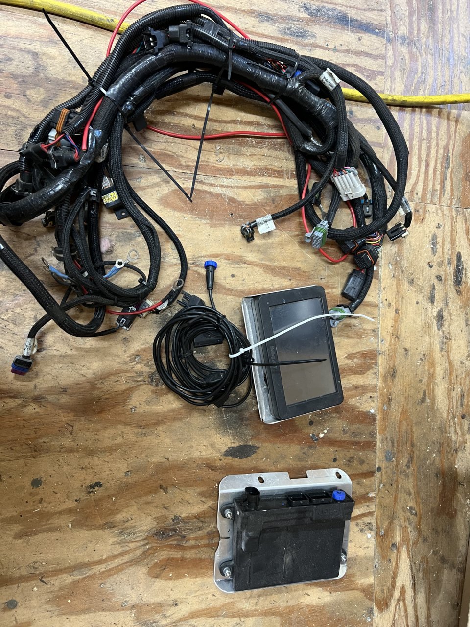

    Comp cam, lifters, pushrods, melling oil pump, dual roller timing chain, Ported heads by Borowski, Holley terminator with 7” display, Holley intake, Holley fuel rails and throttle body, 650cc FIC injectors, meziere water pump, ict billet alternator mount, krc power steering pump, sikky front sump oil pan, alternator. I will be installing a new front cover as well as putting a new set of head gaskets on this week and torquing the heads down. Started taking them off as I was preparing to stud it and install a LSA but ended up building a new motor. Motor will need rocker arms. Stole the rockers from this motor for the new build I replaced it with and never replaced them. Motor made 550 hp on Borowski’s engine dyno $6500 obo
    FASS fuel pump good for well over 1k HP with regulator and filters $650
    -Bare Chassis with cab and doors and fiberglass All 1.5 .120 chromoly and clean title on the cab. Cab is off and has no floor firewall or back wall. Make an offer

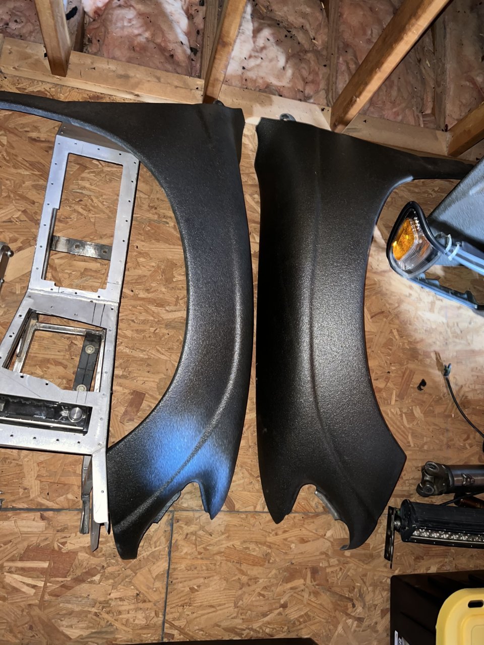

    -Adv 1st gen Tacoma fenders linex sprayed $250
    -4 willwood 4 piston calipers with spidertrax drilled rotors and hats $1000 all used
    Fox 3.0x12 triple bypasses 1” tubes $2200
    Fox 2.5x12 coilovers with springs $1500
    Fox 2.0x2 bumps $400 - SOLD
    D8FB366D-C709-4E75-96FB-88716BF531B2.jpg 058E83D5-84D7-41A5-933A-14CA8958E6E1.jpg 82FA0914-A8B4-4E0E-BB27-7E9C028F56F5.jpg 41C851A7-7517-463D-86D2-B54C9D8CE2AC.jpg BEB8D3DA-BCB8-46E2-AABC-213A655528B3.jpg EDD82814-D5EF-4F2B-8960-D44319E78A70.jpg A6B9802C-131A-4E6D-B6D7-66BB014CE9E2.jpg 46731878-9361-4BAA-9FD8-063F00131A9D.jpg
