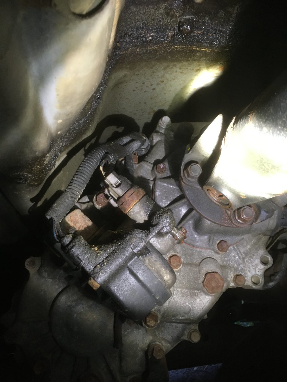

    i figured i'd go ahead and swap the trans/transfer/diff fluids and be done (for now) but no... i got the transmission fluid swapped out, then moved on to the transfer case and saw this:
    i hope you can see the picture. if not, oil is sprayed all over and seems to be coming from a black box attatched to the transfer case, on the back side by the fill and drain. i don't know the name of this part, or if it is a common thing to fail/easy enough to fix?

    Hard to tell but it might just be grease from the u-joint flinging out as the driveshaft spins.
    Gear oil from inside the t-case would be more drippy like engine oil

    I can see the picture, but I’m only seeing grease from the driveshaft U-joint as well, which is normal when they are greased regularly / correctly.

    well that's nice to hear, i'll clean it up and just keep an eye for puddles.

    100% from the u-joint. Nothing to be concerned about.

    Give it a smell. No mistaking gear oil from grease.

    It looks like you have greaseable u-joints so I'd grease them. I have the same marks on mine and I grease my u-joints at the 5000 mile oil change.

    Yep, U-joint grease. Nothing to worry about.
    I have the same stripes under my truck and am confident that is one area of my truck that will never rust.
