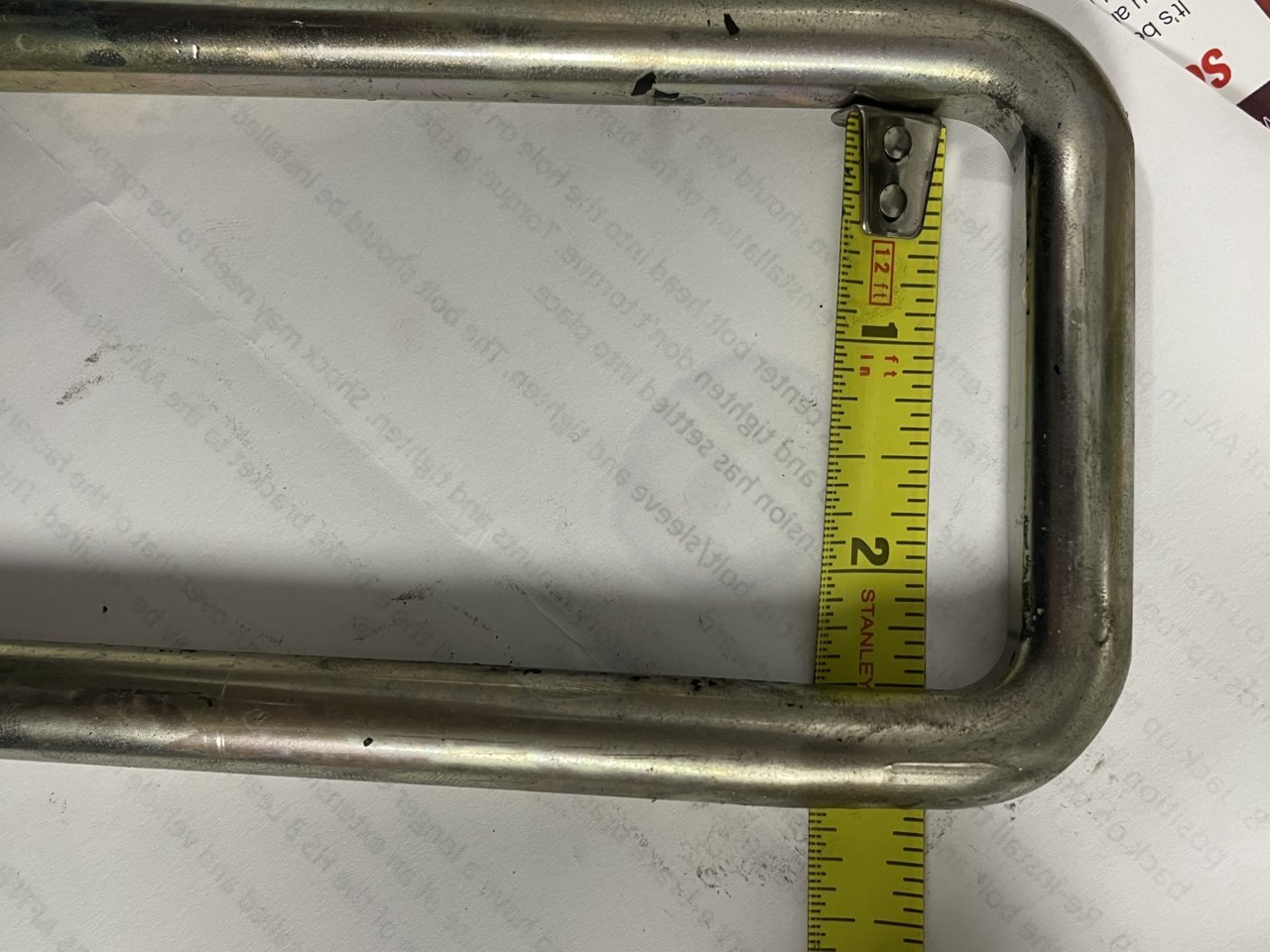

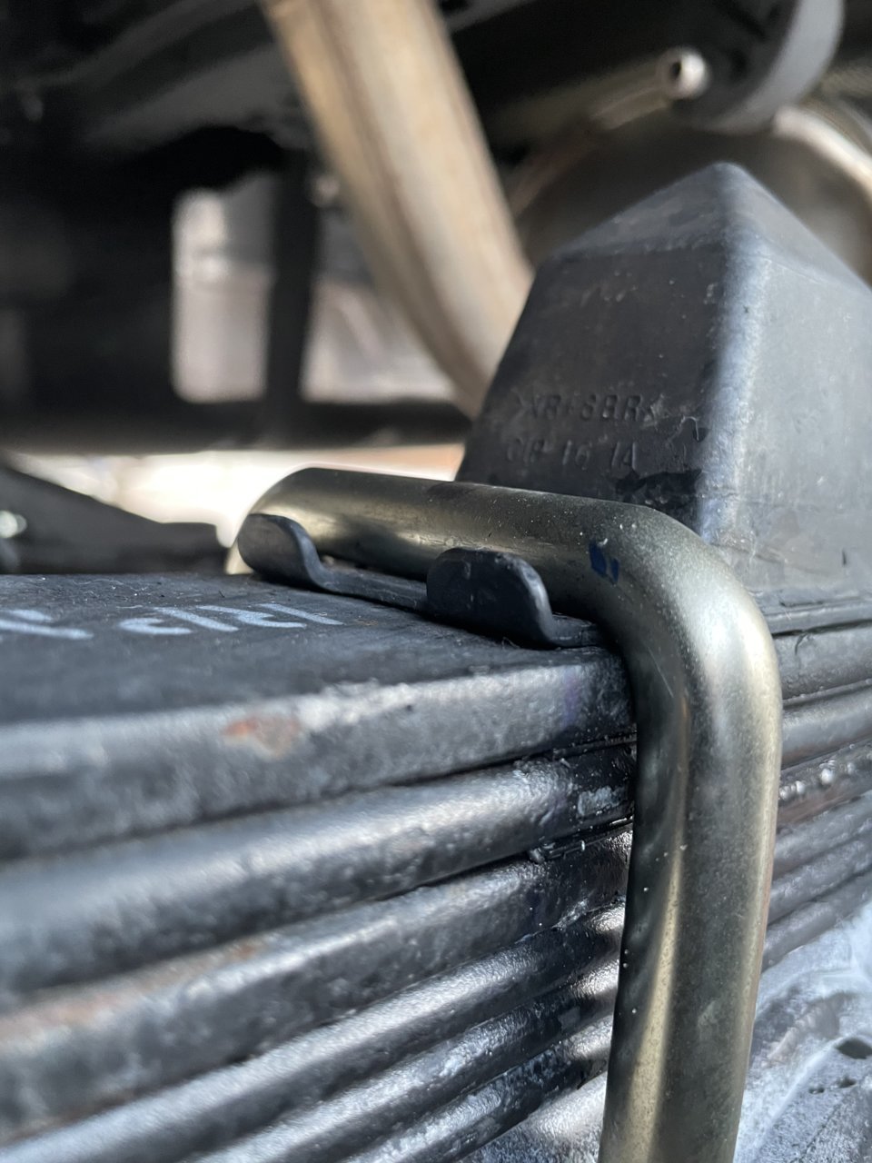

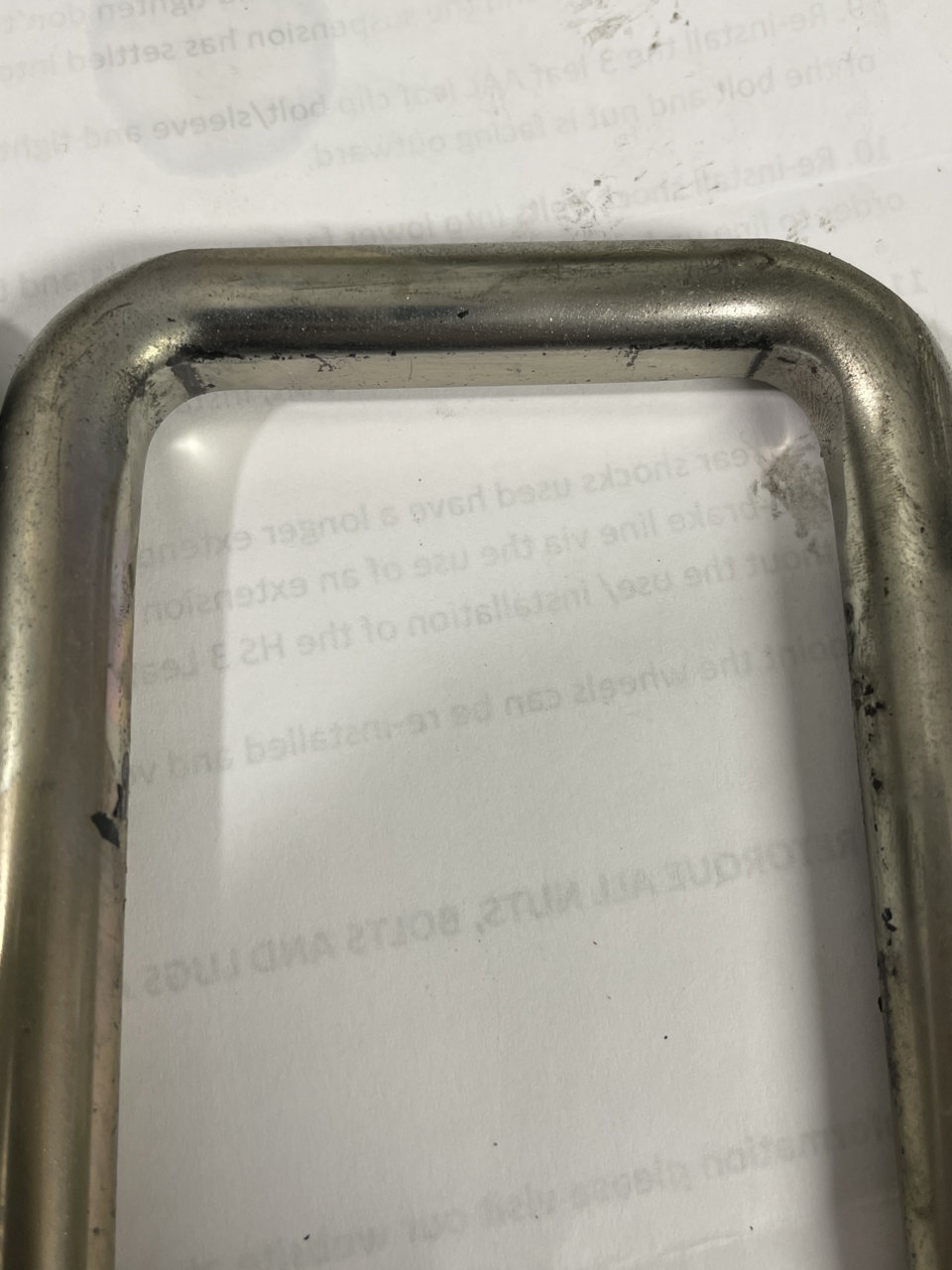

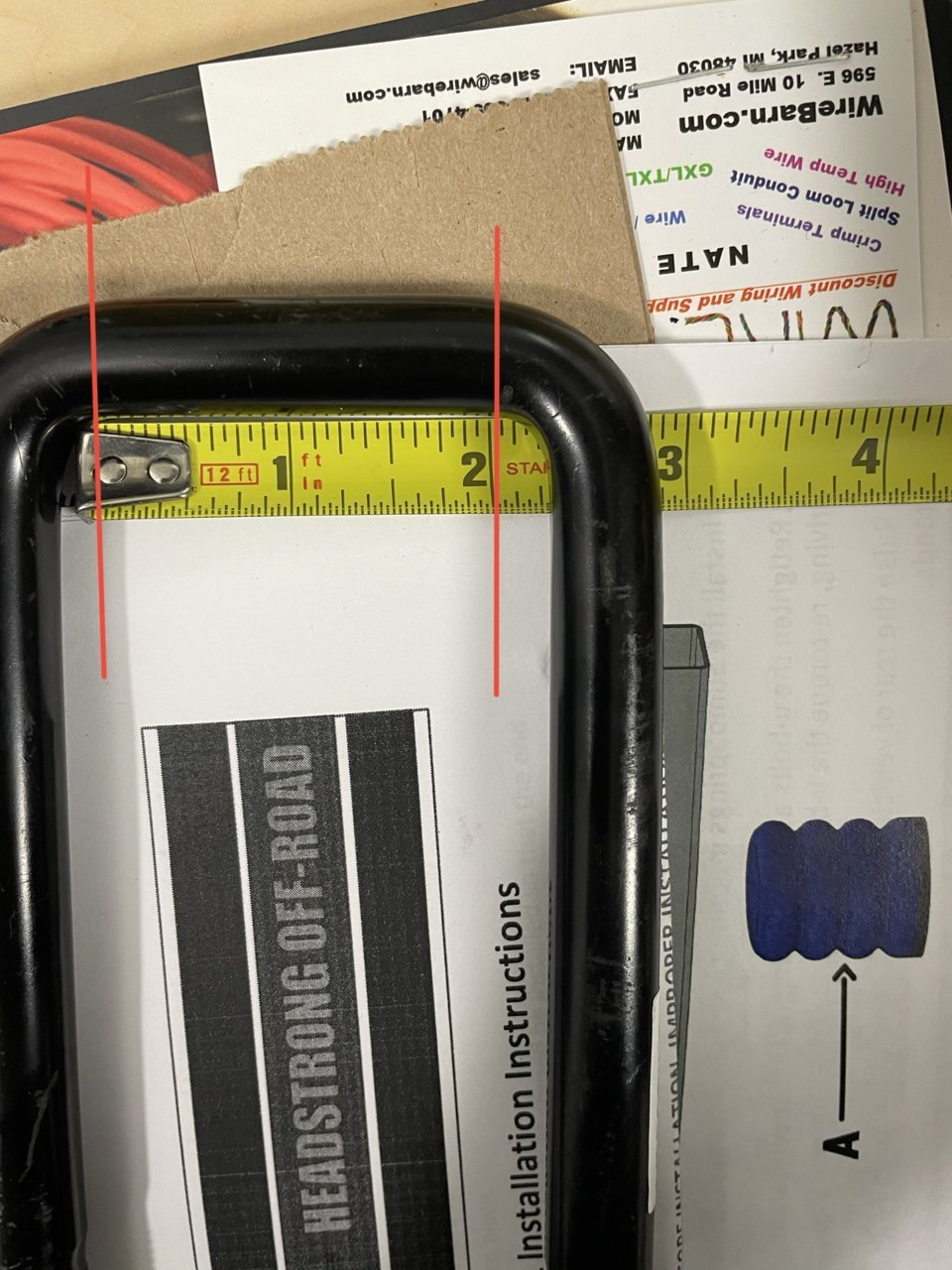

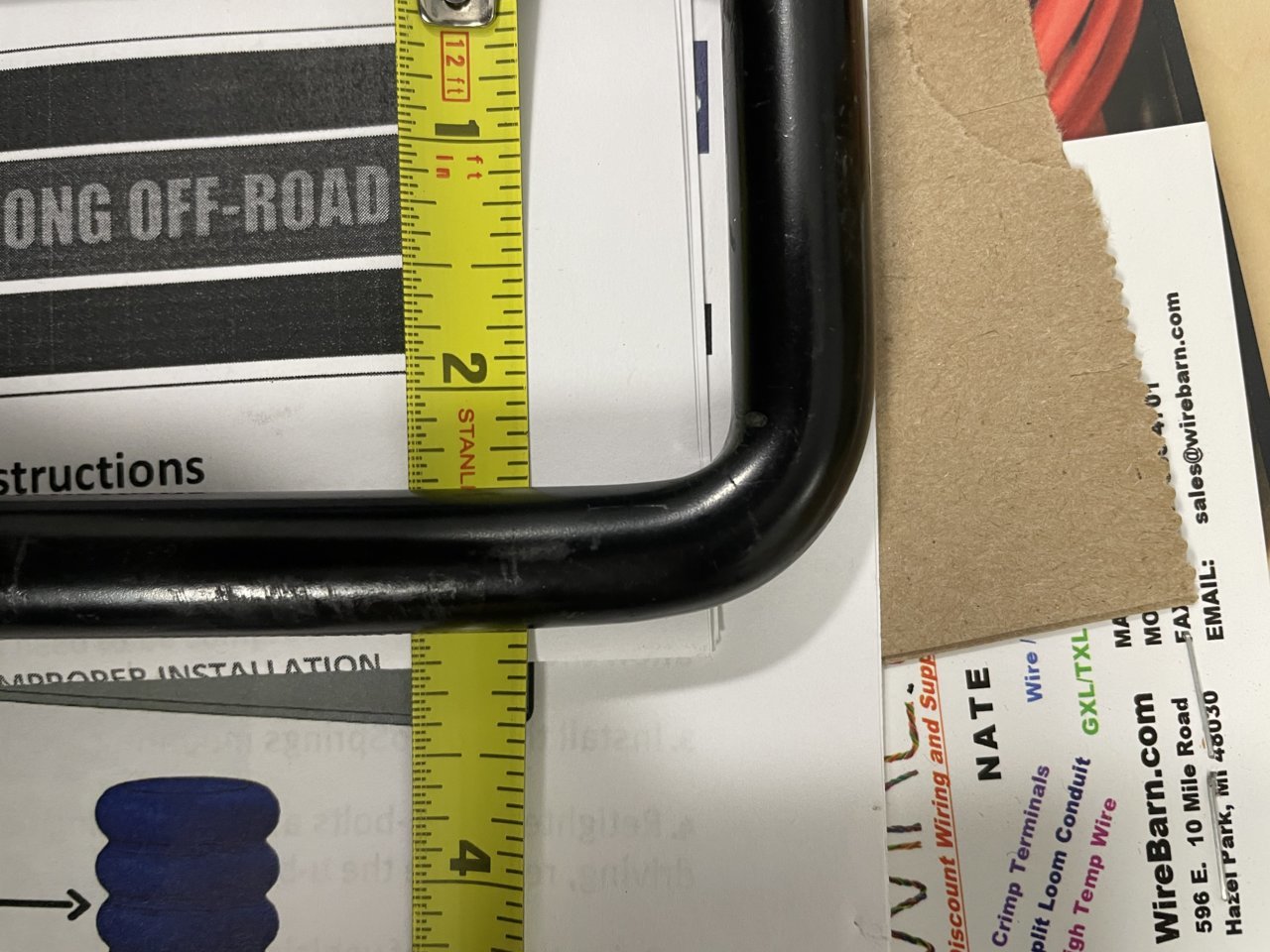

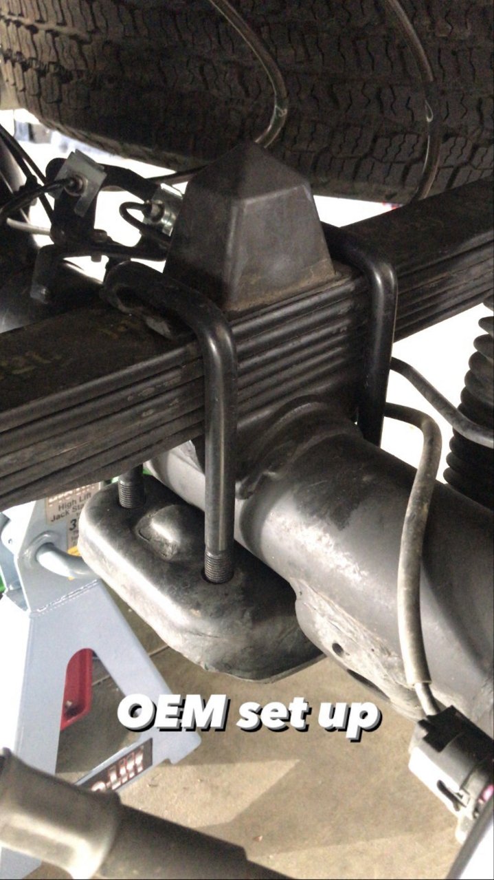

    So I’m posting here directly because of a lack of response/customer service and I dislike having to come to the forum to ask better of its vendors.
    •originally emailed 1/28 about a fitting issue with provided ubolts and sumo springs (knowing full well I wasn’t going to get help regarding the sumos) but my question was more in regards to the ubolts specifically and dimensions.
    •hs responded 1/28 with as expected no help regarding the sumos but also no help regarding the ubolts and dimensions. Only replied with the ubolt manufacturer.
    •I emailed 1/29 with pictures of the ubolts and paired with the sumos for reference and the dimensions (inner diameter) of the ubolts. Also noted I’ll have more pics and info once I tried the install.
    •no reply
    •did the install that weekend and emailed 2/3. During install I was able to compare provided ubolts to stock ubolts and between factory bumps to sumos with pictures and further clarity on the issue.
    •crickets

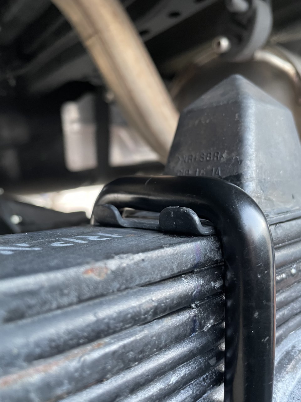

    so during my research the ubolts are to sit flat and that is not the case with the hs provided ubolts, with the sumos or with the factory bumps. They touch/make contact on the edges only, because the bend radius differs from the factory ubolts which actually makes the inner diameter smaller than the stock bolts raising it off the leaf/bump stop bracket. So I was lucky to be able to reuse the stock ubolts with the hs aal and factory bumps.
    Below 2 photos show the gap and only making contact on the edges with factory bumps (1/8”-1/4” gap)
    483680F8-C08A-4E85-9500-09E3362E3A1C.jpg E87063A1-1675-4683-9293-41A1E307ED19.jpg
    compared to stock
    Stock inner diameter (also note the bottom is flattened bend to bend)
    Ome (provided) bolt inner diameter but more specifically bend to bend. Remember it only makes contact on the curved radius part.
    what I’m looking for is a response and a solution regarding the ubolts.
    Positive- Regarding the 3leaf aal, I have always had some sort of random vibration at random speeds and after the install I actually don’t notice any vibrations anymore (not sure what could explain this?). I’m all stock with a cap that has caused me to sag in the rear and lose my factory rake hence installing the aal.
    thanks for any help
    edit/added:
    1-what torque spec for the center pin provided? I couldn’t find any torque spec from Toyota and came to tw for help- someone mentioned 33ft lbs but the spec sheet was obviously from a different vehicle with differing specs on other components (I still went 33).
    2- there is a metal plate on top of the overload spring but no mention if this metal plate is to be put on the aal or taken off with the overload spring. I left the metal plate on the removed overload spring but if it needed to be transferred to the aal I’d like to know and install it.

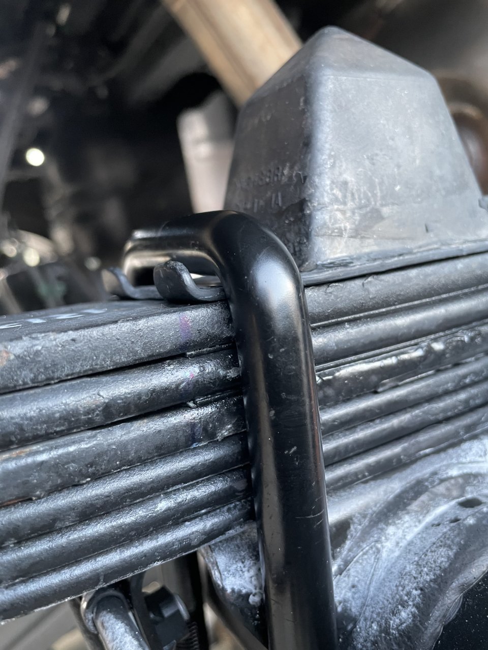

    Did you ever get this sorted out? I just installed a U bolt flip kit so I have no use for my HS bolts anymore ~1k miles on the HS bolts

    I have been contacted but nothing currently sorted. On your ubolt flip did you swap out bumps? If so, care to dry fit the bolts over the stock bumps and check if it rests flat or has a gap?
    Edit: another user reported back that they didn’t have any gaps on their recent install.

    Sorry for the late reply. Here’s a pix I took, albeit shitty iPhone 7 quality, of my stock bump stop with HS bolts and there’s no gap... lmk if you want the bolts :thumbsup:
