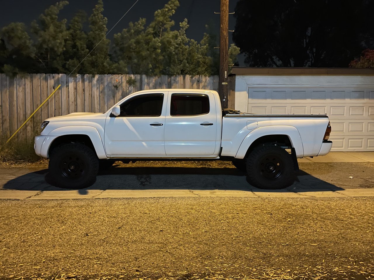

    Got mine on thursday and then a few days later decided to order the 1/2" shim lol

    Got mine installed today. Was fairly simple. And gave me back a slight rake in the rear. Picture looks level but the rear is about 0.5in or so higher than the front.

    i installed it on mine. Without it I think I would have been just barely level with the front.

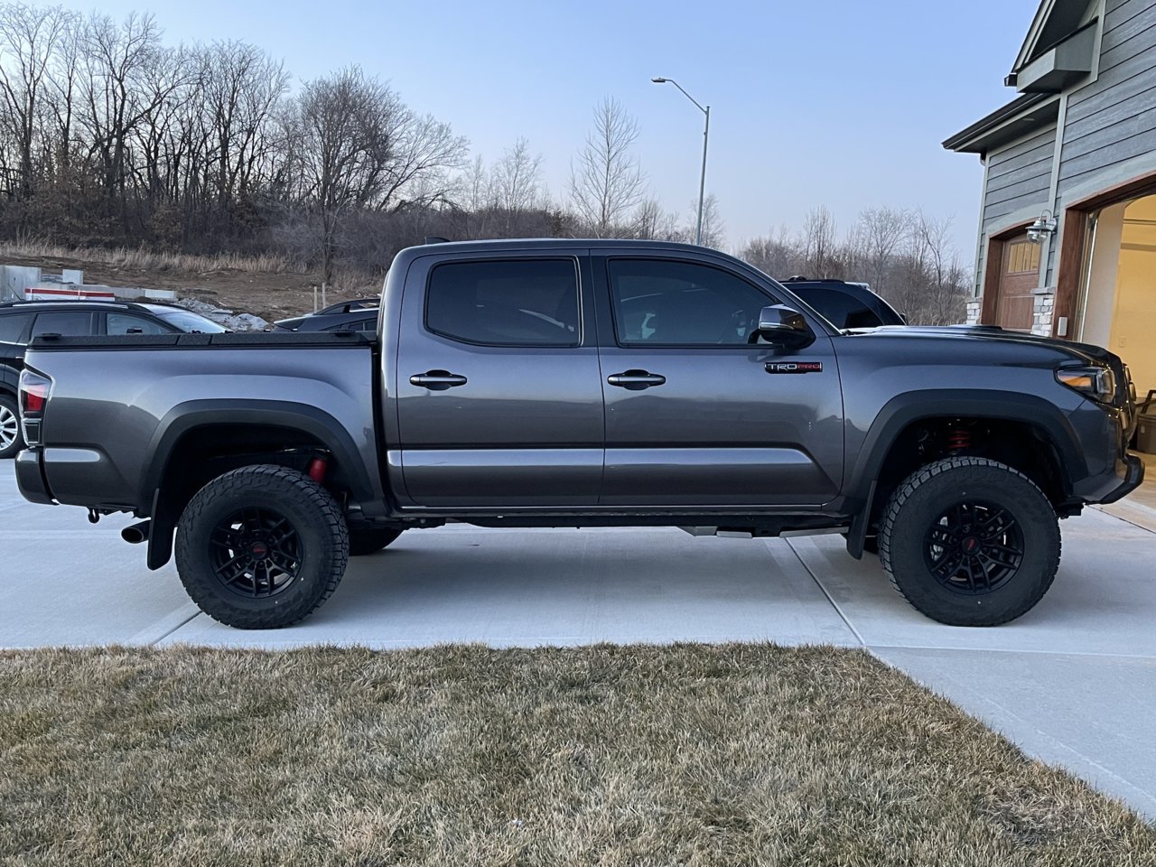

    I have the Westcott lift. Had the block in the rear. Decided I wanted a little bit more height for when I am hauling my tools.
    I installed the headstrong add a leafs tonight and it went well. Super easy.
    I removed the Westcott block and removed the overload leaf.
    Seems to ride pretty well just the small amount I drove it.
