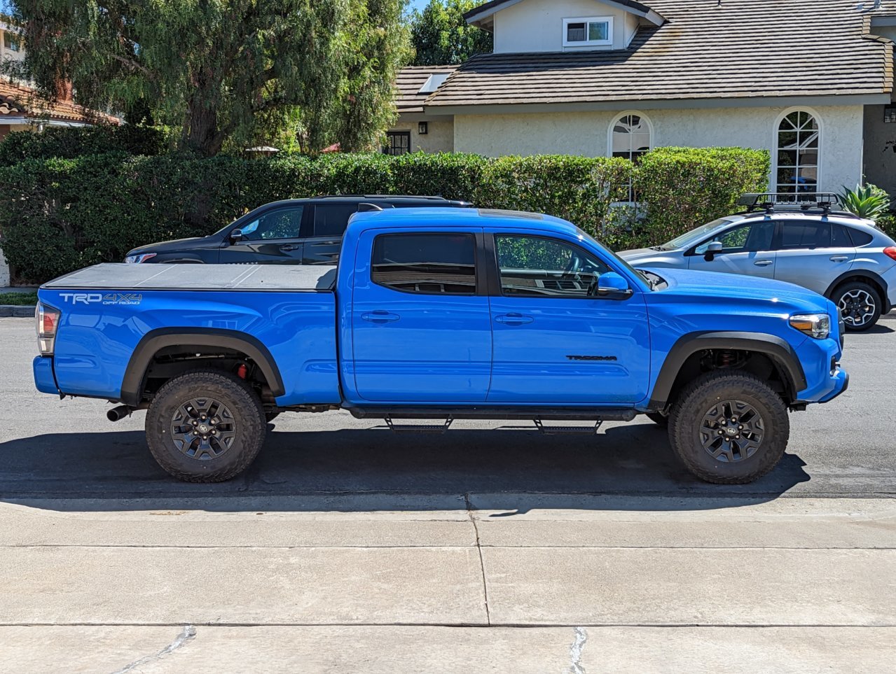

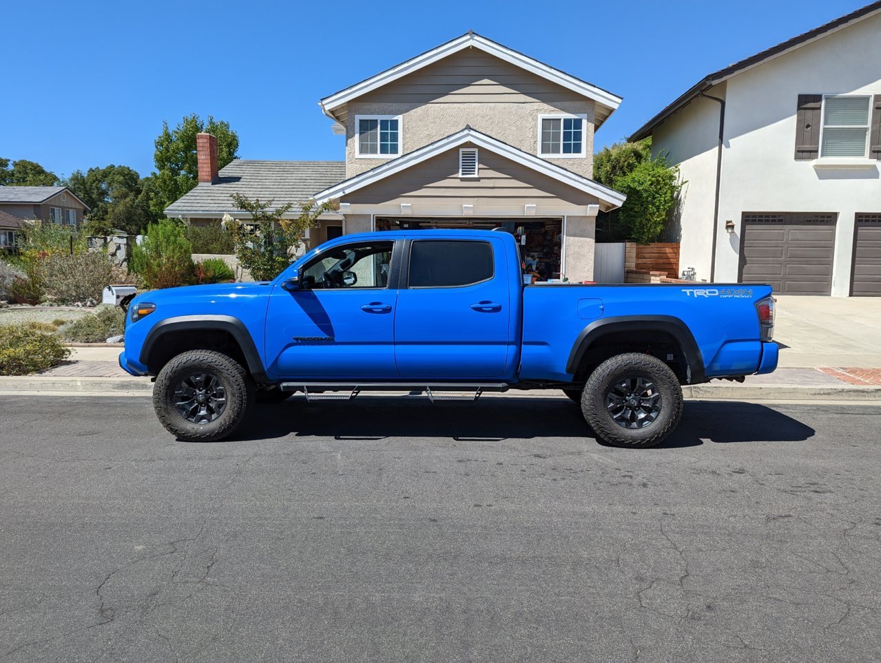

  13. Jan 17, 2023 at 10:47 AM
    #253
    rybern
    rybern Well-Known Member
    Apr 3, 2017
    #215281
    2,689
    N Alabama
    2025 TRD OR & 2000 SR5
    Looks great and thanks for sharing these photos. I just ordered 5100's and plan to run the 4th perch (1.55") up front and was thinking about this pack for the rear. A simple 1.5" lift. Did you need a pinion correcting shim?
    P8trit likes this.
