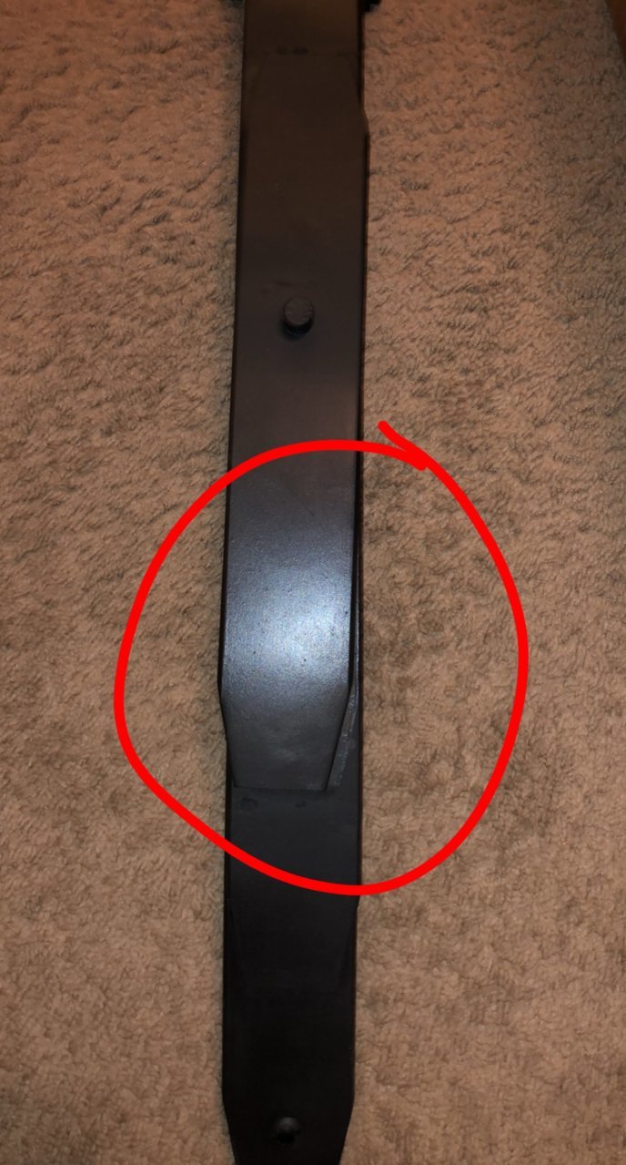

    I received my AAL yesterday, fast shipping. Is it normal for the leaf's to be kind of off-centered and not perfectly lined up?

    You mean one side longer than the other when comparing distance from the pin? Yes, absolutely.

    no I mean how the three leaf’s are stacked, the bottom one is tilted a bit.

    I'm assuming when I install it I can just tap the the leaf with a mallet?

    Ah, yeah you can move em back into place. They should be properly seated.
