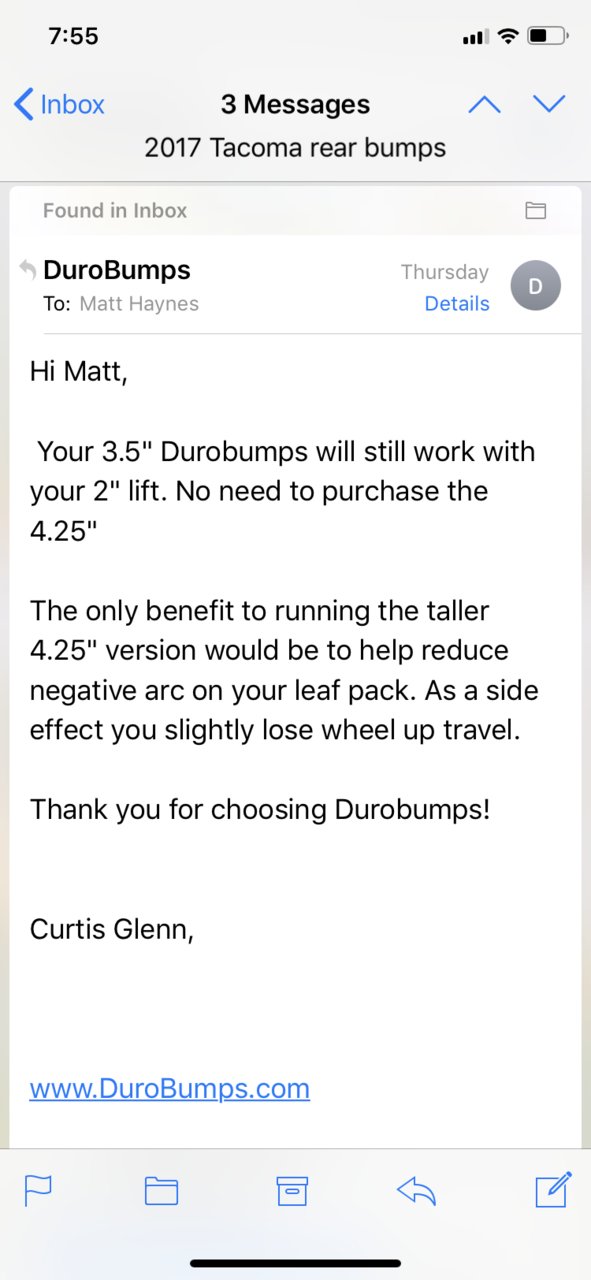

    I have the 3.5” duro bump for my 1” block. I just ordered the new AAL and 1/2” shim, I emailed duro bump and asked them if I would need to get the 4.25” and they said no, the 3.5 would be fine. But their site says the 4.25 is for a 2” lift.

    This is what they said.

    Thanks for posting, I reached out to them too... I think I’ll just stick with the 4.25 and the 8.85 ubolts that I ordered lol

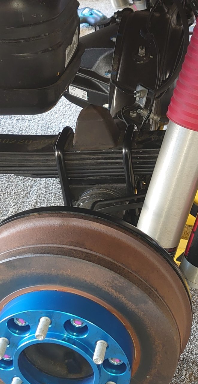

    There's a bit of confusion here, I think. The 3 leaf AAL kit will provide approximately 1.5" of lift. The 2" version is the exact same AAL, but you just need to add the half inch "shims" to complete the full 2" of lift. The "shims" are basically a very small lift block - they are the same thickness as the factory overload spring, but they are not as long, so they don't stick out further/longer than the smallest/bottom leaf in the AAL. They are perfectly flat, so they do not change the angle of the axle the way a traditional shim would, and they actually attach to the bottom of the leaf pack (and become part of the leaf pack) using the center pin, rather than simply being sandwiched between the bottom of the leaf pack and the top of the axle (the way a traditional shim would be).
    I purchased the 3 leaf AAL and the extra half inch "shim," and installed them about a week ago. My rear measured 37" from the floor to the bottom center of the fender well, and 21.5" from the center of the hub to the bottom center of the fender before the install. I just measured again (waited a week and a few hundred miles for everything to settle), and it's currently sitting at 38.75" from the floor to the fender, and 23.25 from the center of the hub to the bottom of the fender. So I got about 1.75" of lift from the setup with the extra half inch "shims," and I am running about 250 extra lbs in the rear vs. stock (diamondback HD cover, OEM cargo divider, and toolbox inside the bed loaded up with some gear). I do not have any driveline wobble or vibration at all, so I will not be adding any extra shims to correct the pinion angle.
    Here is a photo of my leaf pack with the AAL and the extra 1/2" shim installed. You can see the shim at the very bottom of the pack, where the overload spring would normally be. They are not angled, like a traditional shim. Just a very small lift block.
