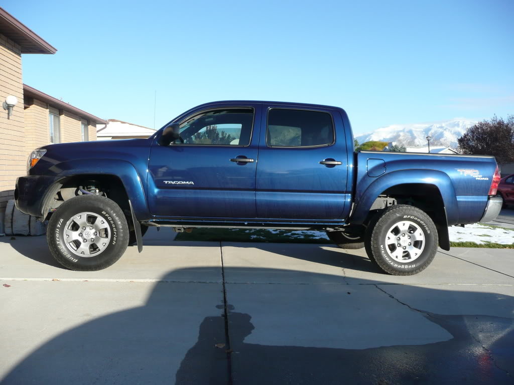

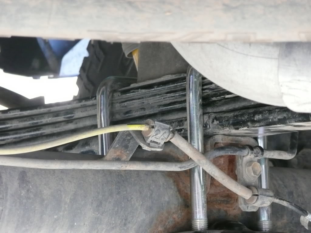

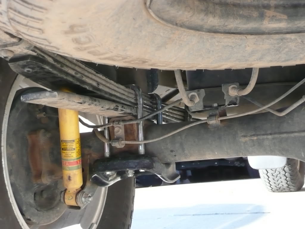

    There is a new AAL available from ToyTec for trucks that have had the rear TSB done. I received mine today and installed them this afternoon. They lifted my truck about 1.5" on top of the 1" from the TSB. They ride great! Toytec hit the nail on the head with these! ToyTec has some in stock for those that are interested. They will be priced the same as the other AALs ($79.99) Here are a few pics of mine installed. (If you want a discount, PM Neubs over on TN)

    What did you use to lift the front? This is what I am looking to do with my '09

    Did you have to replace the U bolts.

    Yeah, you have to get longer U bolts whenever you add a leaf.

    EDIT: That truck was in need of a serious tire rotation at the time this pic was taken! The front tires are completely rounded off on the edges while the rear ones look nice and meaty!!!
