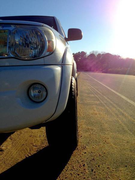

    Here's my DC with FNWheels CounterSteer TypeX 16x8 with 4.5" backspacing and 0mm offset. I think they are a perfect fitment - not too much and way better than stock.
