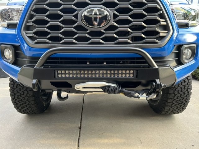

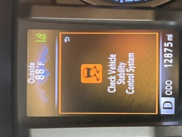

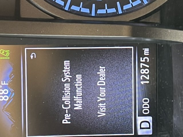

    Put an SSO hybrid winch bumper on..now I’ve got these two errors:

    Disconnected the grille sensor with the battery still connected. Or haven't plugged it back in at all. Might get lucky and reset it with a scan tool that does ABS. The INNOVA 5210 can sometimes reset those lights.
