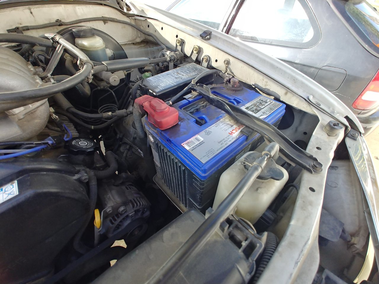

    I’ve seen a lot of battery talk recently and I am also in the market, so I thought I’d jump on the band wagon. When I got my truck two years ago I installed an Interstate MTP-35(?) what for the CCA’s and all, as well as the decent success that I’ve had with Interstate batteries. However the Interstate doesn’t seem to like the vibration and bouncing on rocks and washboard’s. As I began to research Absorbed Glass Mat (AGM) batteries, I learned that Optima’s quality has taken a nose dive, Odyssey’s are a decent option, and Northstar’s have an almost cult following. When using Northstar’s battery finder tool the two options that show up are NSB-AGM 24F and NSB-AGM 35. Long story short the 24F is a slightly bigger battery with a significantly higher amount of “angry pixies” and a heaps more chooch factor. So my question is has anyone strapped a 24F battery under their bonnet, in a first gen with any success? Further more, did you have to make any mods or adjustments?
    The 35 measures: 8.54” height, 6.76” width, 9.45” length
    The 24F measures: 8.75” height, 6.77” width, 10.87” length
    (Note: A 35 is the standard size for a first gen) A69F5143-7CD0-4991-8392-3A88593B3778.png
    Further more, try as I might I can’t seem to close the hood when I climb into the engine compartment to take measurements.

    That battery is made by Odyssey my friend, and I have the Odyssey version of that in my 1st gen its called a pc-1500r, the r is for reverse terminals.

    The length and the width of these match it appears the 24F is about 15/16” taller. How well does the length work in your truck?

    Its fine it doesnt move, mine is the same specs except height. I had to buy the adapter to raise my battery. The battery is a powerhouse. Mine does hang alittle more into the engine compartment than stock a battery as will that one but the bottom will taper to fit perfectly.

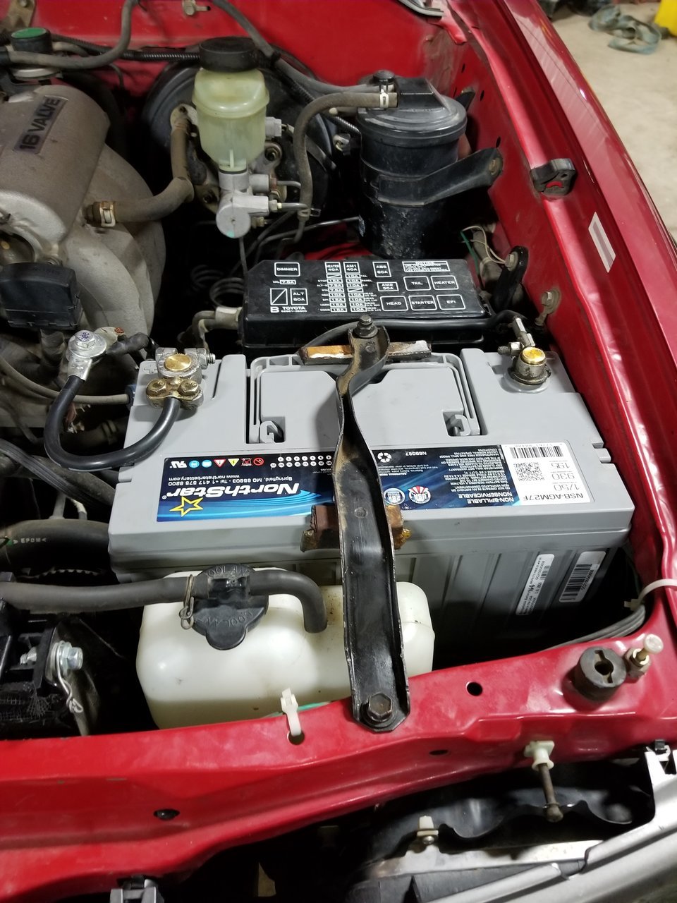

    if you do pick up one of these batteries, make sure they give you a fresh one. They have date sticker(seen in the pic). You would want it within a couple of months of purchase. I learned the hard way. I have 3 cars and they all run AGM Bosch / Exide battery. But the last battery I bought for a civic, I didn't check the date. It was sitting on the shelf for almost 2 years before I bought it. I ended returning the battery as it died in less than a month. It really sucked too, because I thought I had an electrical gremlin. Anyway, when I went to exchange they couldn't believe the battery was that old but receipt said otherwise. No question's asked for the exchange no fuss, sucked I had to pay 1.99 disposal fee.

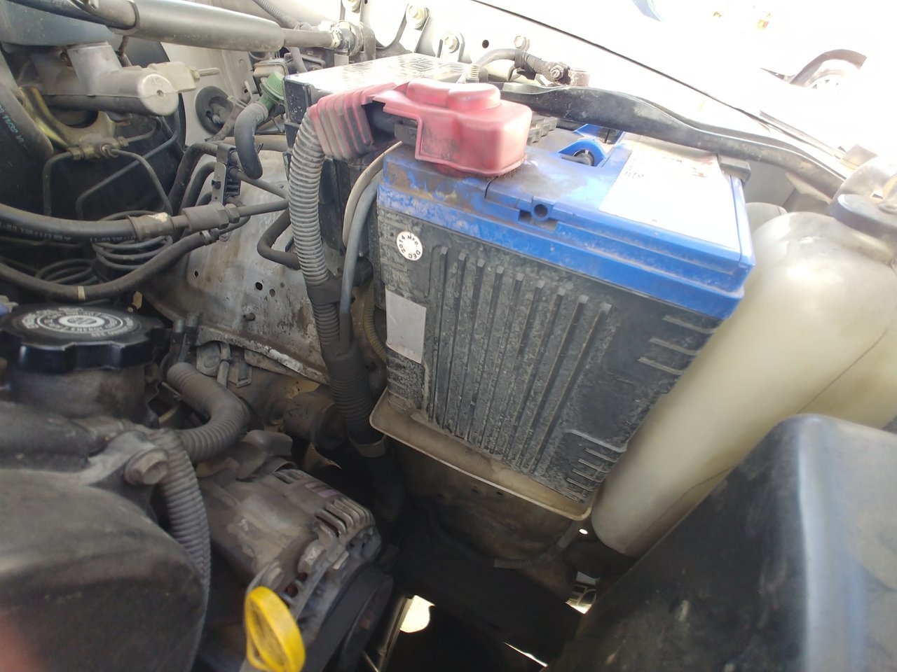

    I Just put this 27f in mine fits good. I did take the tray out because it really deoesnt do anything.20180109_180128.jpg

    It looks like you had to modify the positive cable connection to reach the post on the battery.

    Mine was modified before because it had the wrong post config. It wouldn't be that hard to do if it didn't fit. I'm certain it would fit regardless.

    I run that exact battery, two of them in fact. It fits like it was meant to be there with no modifcationof anything, The stock wiring fits perfect.
